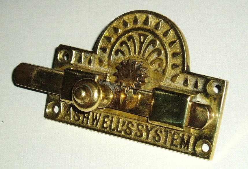

      I need to make copies of a small brass knob (approx, 30 x 18)
      This is for an antique Ashwells toilet lock
      Any advice greatly appreciated

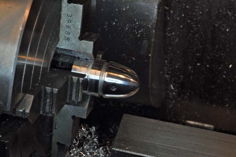

                    Ian,
                    I'd use a mixture of conventional topslide tool and parting tool to turn the major diameters and then switch to the George Thomas quick action hand rest to fill in the curves with a hand graver. The GHT graver design is reversible in its handle – one end is ground to a diamond point for convex surfaces and the other end is semi-circular for concave surfaces.
                    Like I used on this spinner nut:
                    HTH,
                    Rod

                      Thanks for the advice everyone. I should have made my original post a bit clearer – I need someone to make them for me (I don't have a lathe and have never studies metalwork – I'm a carpenter)

                          To me that looks like a brass knob turned with a hole down the center and a rivet to fix it to the slider? Maybe a lot easier to make and fix. It would have been slammed back and forth quite hard!

                            No, it's threaded and screws into the sliding bar

                                  Presumably the gear turns an indicator on the other side of the door?

                                    Yes, it has a brass bezel on the outside of the door with vacant/engaged on an enamel sign
