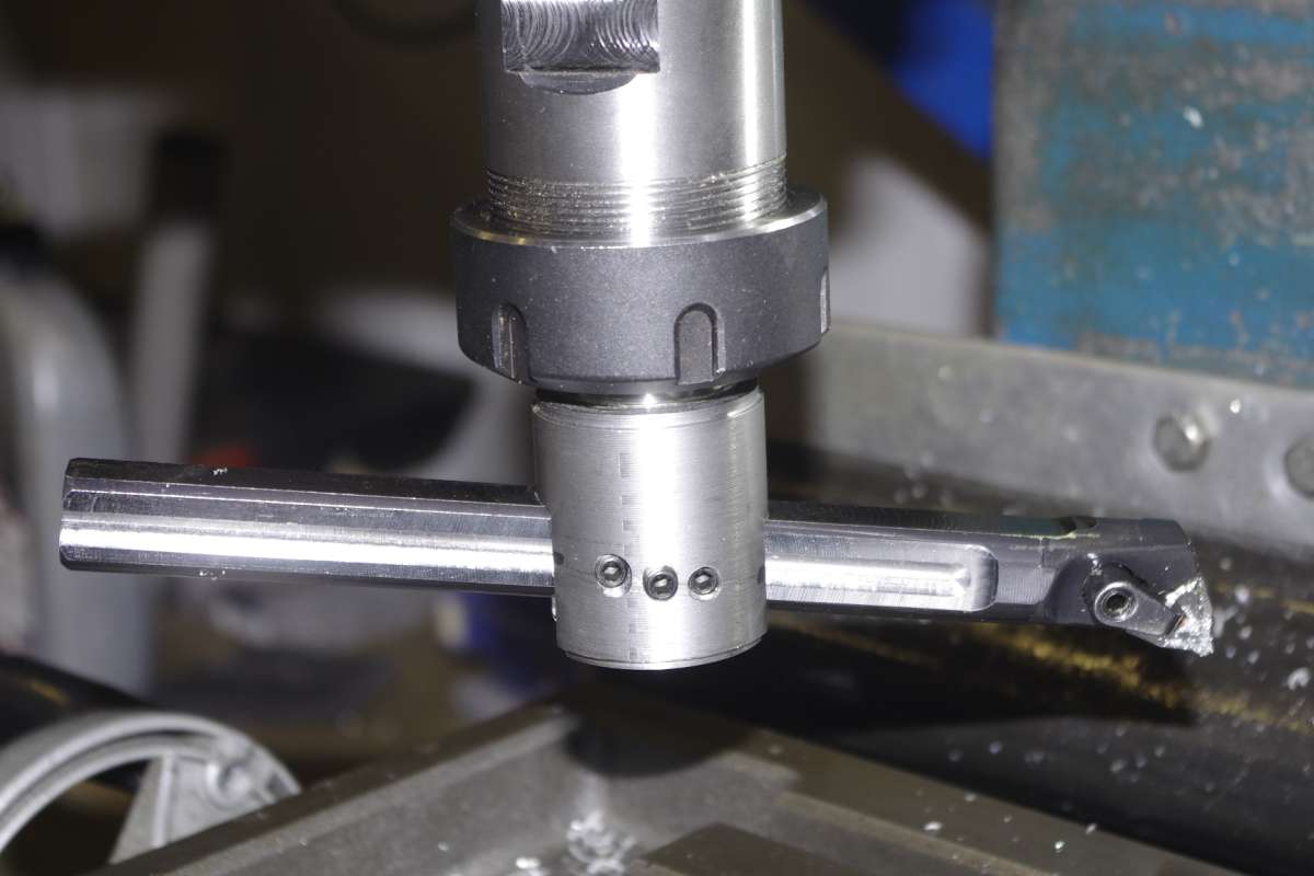

              I made an extra for the flycutter that I made from a 20mm boring tool which takes WNMG08 and WNGT08 inserts. It is to swing an indicator for tramming the head as well as possible. I don’t have a picture of the indicator being used at the moment._IGP3580e.

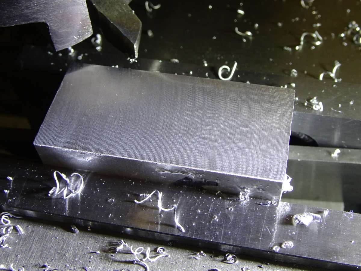

                #838167

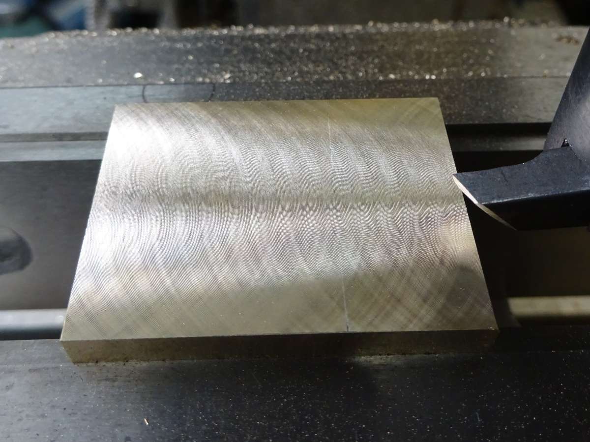

                  Couple of examples of the pattern produced when the trailing cut intersects with the leading cut that Graham mentions both on lightweight flexible far eastern machines.
                  P 49
                  Photo 87

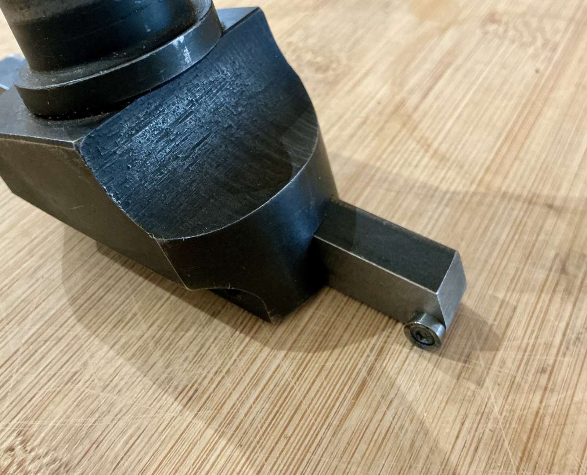

                      On Pete Said:
                      Unfortunately there no longer in production, but I bought a specialty fly cutter that uses the round RCMT replaceable carbide tips, mine have a inside bevel towards the center mounting hole inside the carbide tip, and a further but slight back lean in the tool shanks tip pocket making them very positive cutting. While it still back cuts a tiny amount, the cutting action is almost always smooth and even.
                      It’s design is efficient in cost as well since that round tip can be rotated a bit each time it dulls, or the few times it’s rarely chipped a cutting edge.
                      I made two of these for my fly cutter. One takes a polished RCGT0602 insert for cutting Aluminium Alloy and the other uses a larger insert for steel.

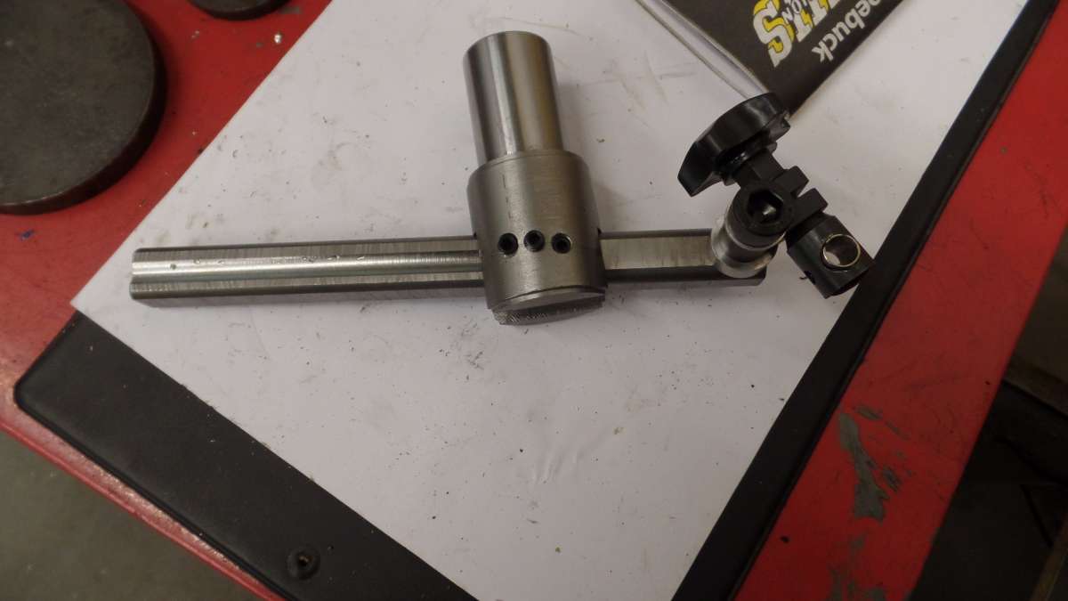

                            I remembered to take a picture of the fly cutter arm which holds the lever type indicator for checking the tram.
                            SAM_1213

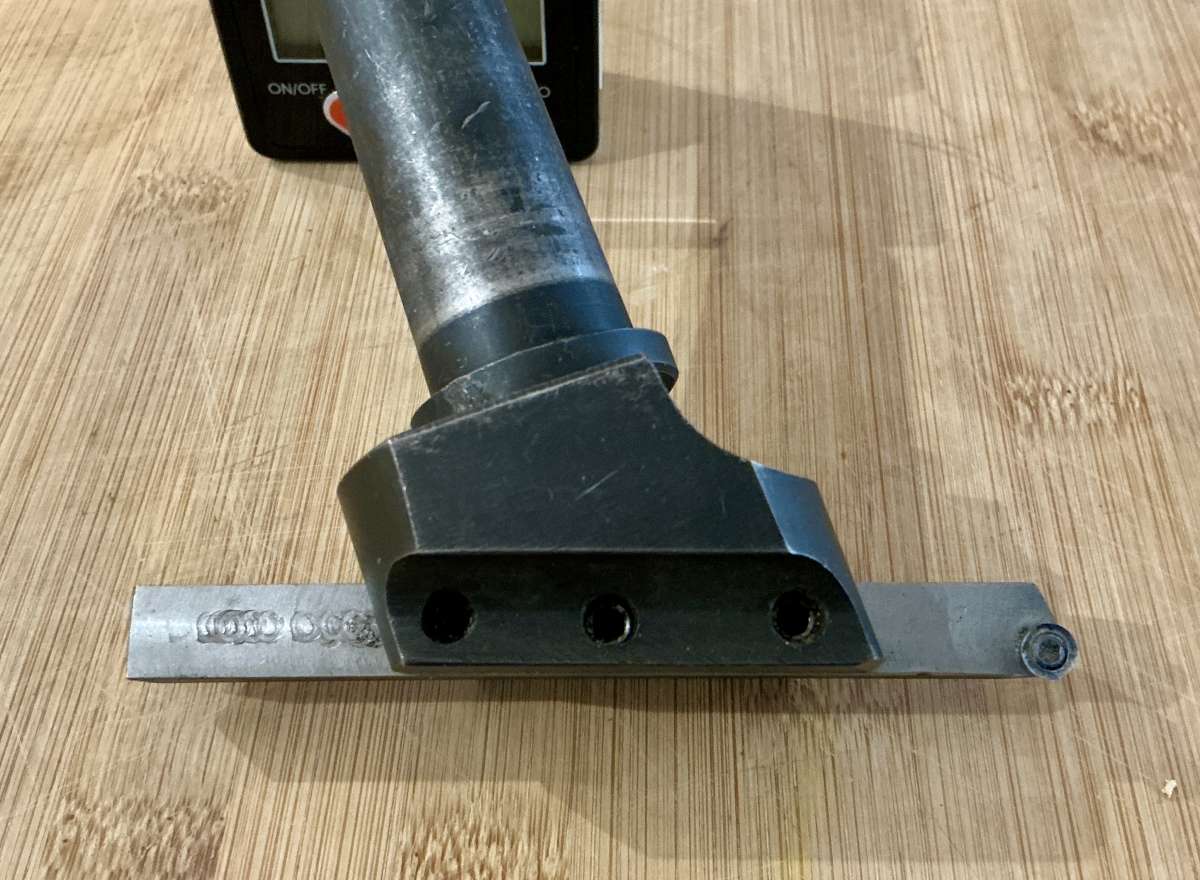

                              I don’t know the optical reasons that create it Jason, but your first picture shows a very slight hint of a rainbow coloring or shading. It doesn’t always show up, and the surface seems to need to be angled just right to the light source. But I’ve seen the same a few times when the surface is extremely flat after fly cutting with a very fine and consistent feed rate.
                              Thanks Vic, those mostly intended for aluminum lapped and polished inserts have been something on my list to try with my own fly cutter. I thought they might, but nice to hear it confirmed they do make a noticeable improvement even with a fly cutting tool.
                              Fwiw, the one I bought was made by a North American company called New Dimension I think? Unfortunately there’s no brand name on mine and it was bought long enough ago I’m not fully confident I even got the name correct. Not important since they seem to have disappeared about 15- 20 years ago anyway.
                              But or in case it’s of any use, the measurement dimensions I just did on mine. It seems to have what appears to be a pressed in 5/8ths dia. tool shank, 2-1/2″ diameter main body diameter that’s 1-1/2″ long with two flats created by removing 1/4″ of material from each side to keep it balanced. And with the usual 3 set screws holding it’s 1/2″ square tool shank in place. That insert holding tool shank is 4.925″ long on mine.
                              Unlike most fly cutter designs, the body is slotted horizontal for the insert tool holder and not angled down towards the work. I also should have mentioned that insert holding tool shank is double ended. The one end takes those RCMT inserts, and the other is set up to accept the usual TCMT triangular inserts with a center mounting hole. If I was wanting to use inserts on any fly cutter and since my version doesn’t seem to be available any more. I’d definitely copy there design even if I had to reduce it in size a bit for smaller mills since there’s also RCMT inserts that are as small as 6 mm in diameter instead of the much larger mine uses.
                              And I’d want to have the ability to use the two different shapes of inserts either by having it dual ended like mine, or probably better, just making up a second insert holding tool shank. I’ve even used mine a few times with home ground 1/2″ square HSS to do form milling. There’s really nothing on mine that couldn’t be duplicated almost as well by anyone wanting to make there own using my imperial or converting to metric dimensions, or even reduced to more suitably sized for smaller mills.

                                I just used a piece of mild steel to mount the insert. There’s no relief needed (but you can add some extra if you want) as it’s built into the insert. I just relieved the back of the bar a little.
                                IMG_8136IMG_8137

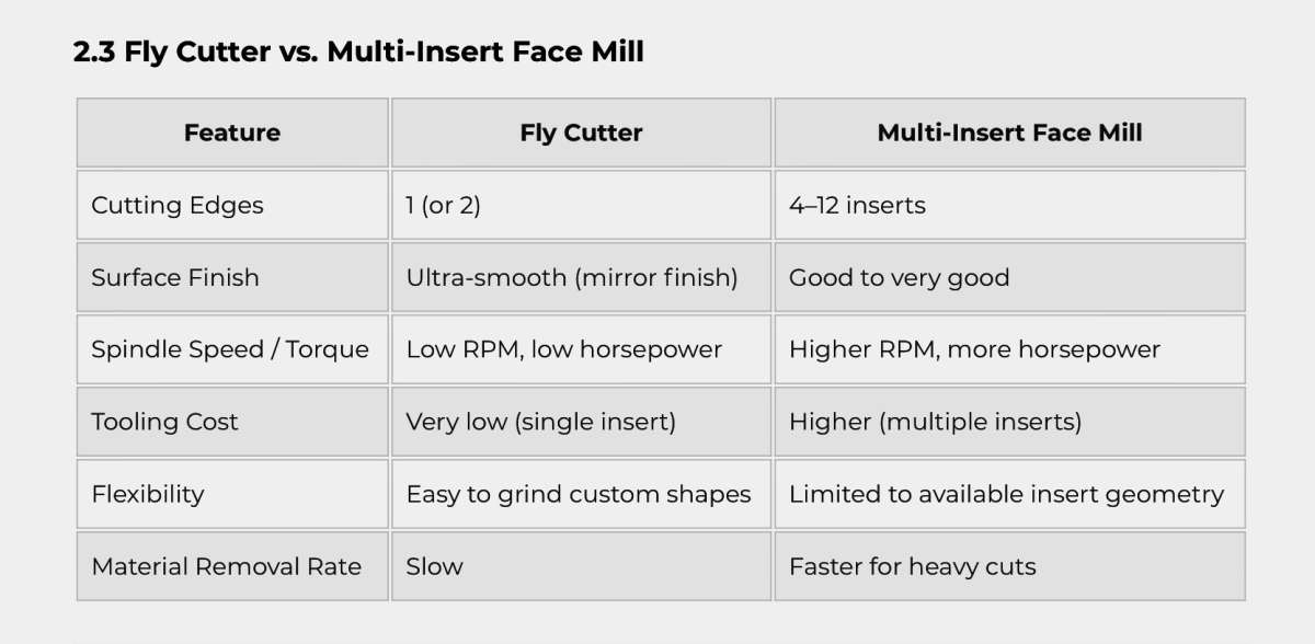

                                                  Couple of things about that article,
                                                  Opening statement. Some people may well think of facemills being the big one they show. But if you look at the link I posted to a suitable facemill for Greensands small machine you can see that I at least don’t think of them as that big. Smaller diameter means less inserts cutting at any time so less power needed and smaller diameter means better mechanical advantage for a small machine. That superfly is certainly not swinging the same radius as the big facemill.
                                                  As they say a flycutter is slower due to only having one cutting edge so for the same given chip load the feed needs to be slower than a facemill. This is OK of their CNC machines where the feed is powered but it is not easy to feed at a constant slow speed by hand. They also have faster spindles than a lot of manual machines which again will mean feed rates have to be reduced further on manual machines unless fitted with power feed.
                                                  I don’t get the bit about insert facemills being expensive. Their Sperfly also uses a milling insert. Once again for the same chip load and piece of material a single insert will have to remove 5 times as much material as each insert in a facemill that takes 5 inserts. Common sense should tell you that the single insert will wear at 5 times the rate of the flycutter inserts so you would need to replace it 5 times more often. So cost is equal.
                                                  As for running out of insets and waiting for replacements. That is simply down to the user not thinking ahead. If you can’t plan to have a replacement set to hand then you are just as likely not to have the single one for the flycutter to hand either. Is that really even a problem apart from sales talk as you can always run a facemill with less inserts or you can dig your old flycutter out and run with HSS or a lathe tool.

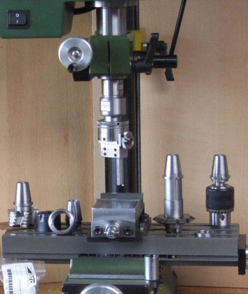

                                                    I use 40mm diameter HSS face mills on the Proxxon mill to square up stock, insert cutters do not do well on this machine.
                                                    Fig Proxxon Bayonet tooling
                                                    I only ever use a fly cutter to sweep a large surface that needs to be flat and with no steps in the machined surface.
