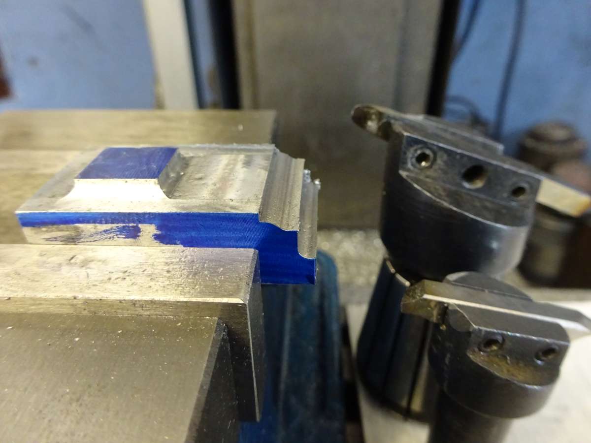

        Regarding Pete’s comment about more use of the cutting edges, the other thing you can do with facemills depending on the type is machine upto an edge or even machine an edge so a bit more versatile than a flycutter that is generally regarded as a tool for clear flat surfaces.
        The other thing with a flycutter is you get a very interrupted cut which if on a small hobby lathe that may have plastic gears does not do them a lot of good as they are constantly loaded then unloaded.
        With a facemill provided to are not using it on too thin a piece of work at least one insert will always be cutting so you get a much quieter life. Certainly found that with my geared (metal) head X3.

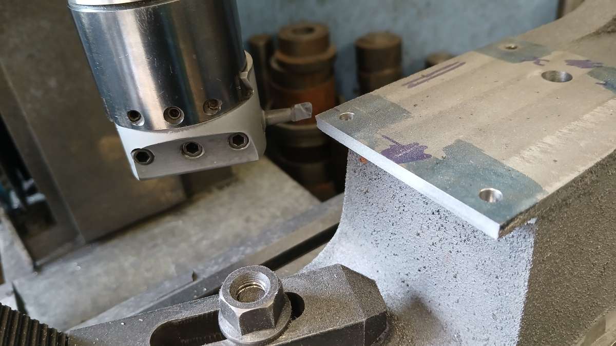

                    Oh the other thing that is a bit strange. Usyally as the diameter of cutter increased we tend to reduce the spindle speed to keep the cutting speed the same.
                    He has the 7″ swing flycutter at 700rpm = 390m/min cutting speed
                    But the smaller 3″ facemill is only running at 580rpm = 138m/min cutting speed.
                    Can’t think why that would be unless trying to show the flycuter is faster, What do you think Vic?
                    As for upside down cutting Been there and done it. Though I used the boring head as I don’t have a flycutter body that holds the bar horizontal like he has. I’m machining the underside of that overhanging lip. Tool ground to leave a fillet at the junction and angled to clear the slope of the face below.
