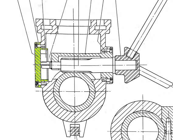

                        Nigel, is it possible to post / provide a link to a picture of the spring housing arrangement..?

                              I’ll see what I can do, but I doubt it would be any more informative than the manual’s diagrams.
                              Essentially the spring is wound into a cylindrical case with a flat disc cover held on by three screws. The inner end of the spring in slotted into the pinion shaft; the outer end seems to be connected to the cover.
                              Adjusting the tension entails removing the screws and rotating the case – a very fraught procedure.
                              (Many bench-drills used something like a ratchet arrangement in the cover, but this milling-machine is not that sophisticated!)

                                          It looks like the cover has an extended rim on the inside to form a housing for the spring – once in a relaxed condition it should stay there unless carelessly handled…
                                          VMC Quill Section
