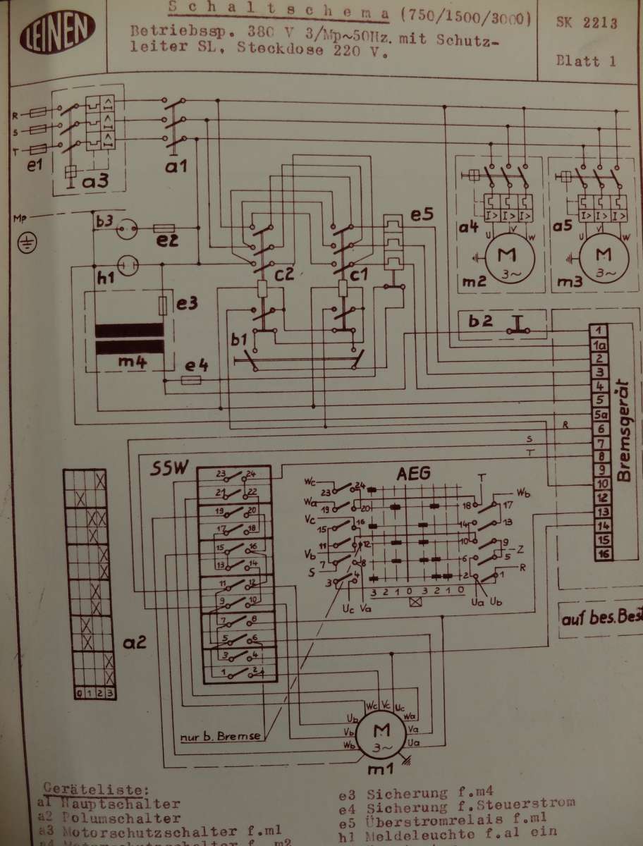

Hello Hans
Yes, please do send a copy of the wiring diagram. I know it’s hard to take a picture of the nameplate … on my lathe there is a hatch at the back that provided the best access, but it still took a few tries with my phone to get a photo I could use. I haven’t tried pulling the motor out of its cabinet, and would rather not, or at least not yet.
Thanks in advance
Jim

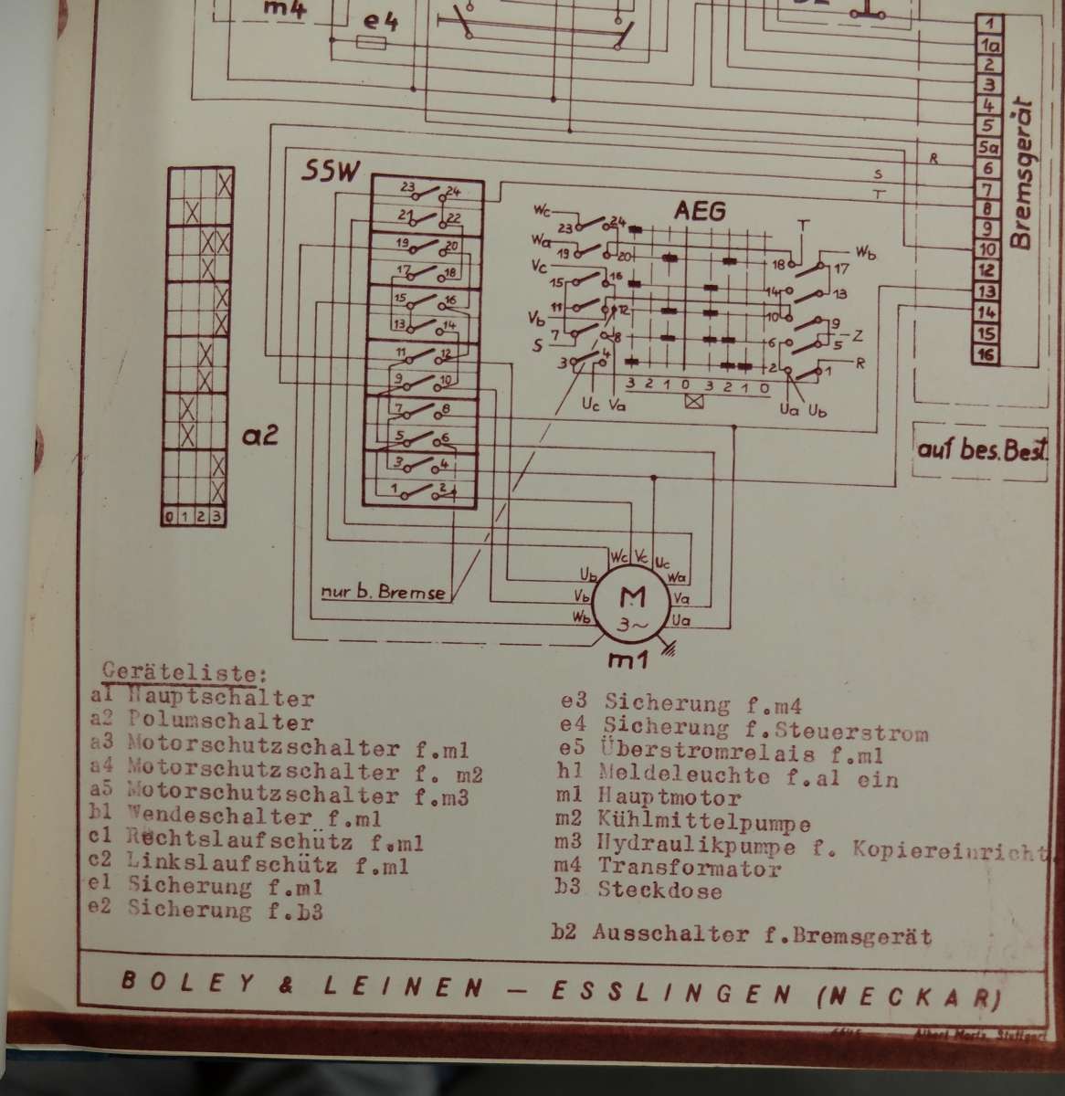

Hello Jim
here the page from my Leinen manual. Perhaps it is helpful. Unfortumately I can’t take a pictore of the motor. The access door is blocked by a heavy table.
Kind regards,
Hans

I’m pretty sure the “delta dash dash” symbology on the first line of stamped data on the motor plate indicates that the six individual windings are in two 220V in series for each side of the Delta. This gives the 440V operation.
It should be possible to connect the windings in parallel fro each side of the delta allowing the use of a standard, no voltage step-up VFD. This allows frequency increase for the higher speeds.
If a get a quiet moment I’ll try and sort out the winding switching on the circuit diagram and see if connection is possible
I must admit I struggle with some of the industrial cam switch diagrams.

Hello to all, and yet again thank you for the lively and interesting discussion.
While I’m waiting for my first appointment with Enedis to see about getting 3-phase 400V installed (July 10), I’m still wondering about all this. Mostly I’m impressed with how little I know. Anyway, I’ve just been comparing the wiring diagram from Hans with my own. His diagram says it is for 380V, while mine says it is 220V. Otherwise, they are pretty much the same, except his has a transformer (to provide, I think, 220V for the plug in and light) and mine doesn’t. I don’t know if this is significant. Copy of my wiring diagram follows.
Jim
Jim, If the drawing you have is correct, the outlet socket would have 400V across it on a 400V 3ph supply. That presents a serious danger.
Hans’ drawing shows it (poorly) as a phase to neutral connection giving 220V.
The Transformer in the drawing Hans has supplies the coil voltage to C1 and C2. (probably 220v but maybe 110v or 24v)
If the motor really is 220v 3ph it will need a 220v 3 phase supply,

Out of interest, I scribbled some calculations which suggest it may indeed need a 220V 3ph line voltage. Don’t take my word for it; I’m sure others will confirm or refute.
For example, starting with an assumed line voltage of 220V:
Speed 1:P = (sqrt)3.V.I.cosphi = 1.73 x 220 x 7.1 = 1.68kW, implying 53.7% efficiency given a nominal 0.9 kW rating.
However, the same speed evaluated at 400V gives only 29.5% efficiency.
In summary, comparing efficiencies at the three speeds, at the two different voltages:
Speed 1: 53.7% at 220V and 29.5% at 400V
Speed 2: 67.5% and 37.1%
Speed 3: 72.7% and 40.0%
On that basis, the motor looks to be intolerably inefficient if a higher line voltage is assumed.
