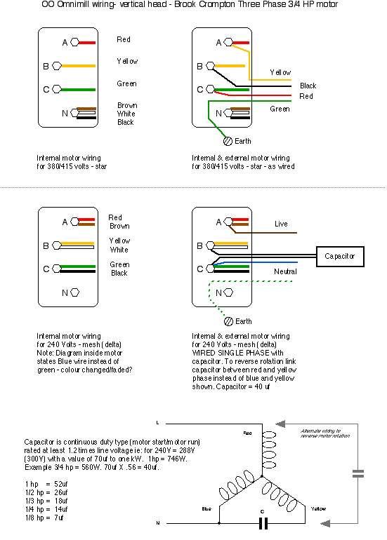

                        I’m not sure if this helps, but just to say I ran my old 3 phase Elliott Omnimill on 240V single phase quite happily until I sold it on.
                        it was a long time ago but I followed the instructions I found online about changing the wiring in the motor junction box and adding a large capacitor in the circuit. Apparently you only get about 80% of the motor power doing this but I didn’t notice this on the Omnimill, it worked just fine.
                        IMG_2923

                          Running a machine with 3 phase motor on single phase with a capacitor may seem OK but only if you haven’t used it on a proper 3 phase supply. This and the other advantages of a VFD make it a bit  pointless using anything other than a VFD.
                          The capacitor solution (Steinmetz) is OK for coolant pumps and fans, not main drive motors.
                          Oh and why does your circuit show a star connected motor when it wired delta?

                            Rubbish.
                            Using a capacitor to generate the third phase works perfectly, since you never run the machine at 100% load then the final tweaking of the capacitor to get a balanced third phase isn’t needed.
                            Why? The power factor of the motor inproves as the load increases, so the phase angles alter, so the real, not imaginary, power provided by the capacitor also chamges, providing the extra current to take the load. Read any book on how an incuction motor works, circle diagrams etc. The current taken from off load to full load hardley changes, the power factor does.
                            Oh, and I have used both a static inverter and three phase, no difference.
                                  That’s easy to say when you have the money. I saved up to buy the mill and couldn’t afford an extra couple of hundred pounds to buy a VFD or change the motor. It cost me £12 to buy a capacitor and I did a lot of good work on it until I sold it on when we moved house.
                                  If anyone else doubts this works perfectly well, the topic is covered in one of the Workshop Practice series on motors. As I remember the topic is covered in quite some depth.
