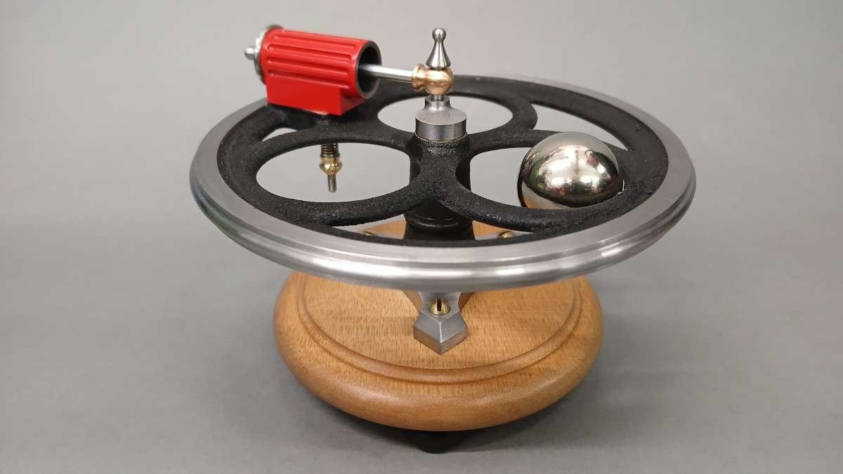

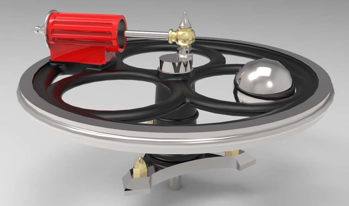

      For some time I have fancied making an engine with a horizontal flywheel but never found anything that took my fancy. There is an old design for a marine engine that was tempting but not the nicest looking thing. Anthony Mount did the Whitmoore & Binyon but you can’t really see the flywheel on that. Howeve while looking through some old copies of Dampf Modell magazine for something else, this photo caught my eye and that was all it took.
      original orbital
      A bit of time spent with Alibre and I came up with this design. It is 11mm bore x 13mm stroke. Flywheel is 115mm dia x 6.75mm wide (to suit the offcut of thick wall tube I had) Alibre has the option to show the ctr of mass and by looking at this while trying a few different ball bearing diameters I got the design almost perfectly balanced, it does change as the engine rotates and the piston moves in & out.
      3d

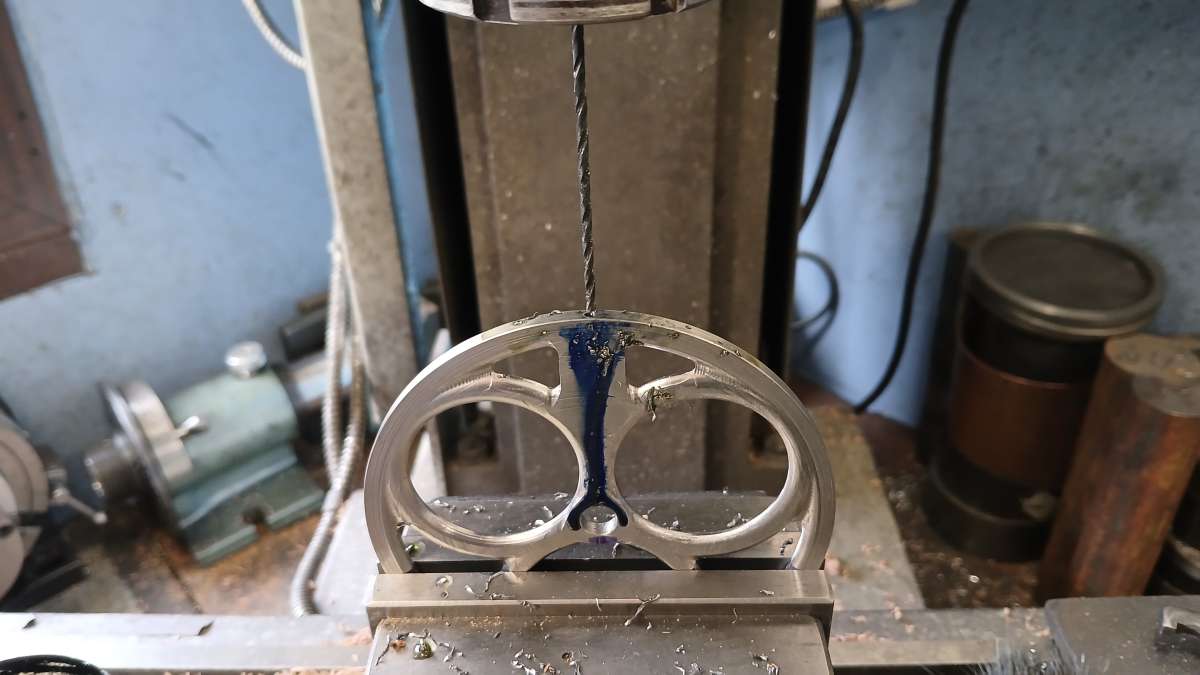

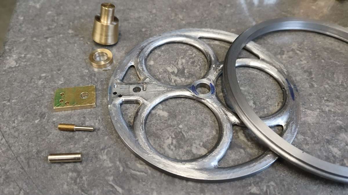

      The “spokes were cut on teh CNC from a disc of 4mm thick steel and then the various steam passages added on the manual mill. Here I am using a long series drill to get air from the hub to the cylinder.
      20260531_083030

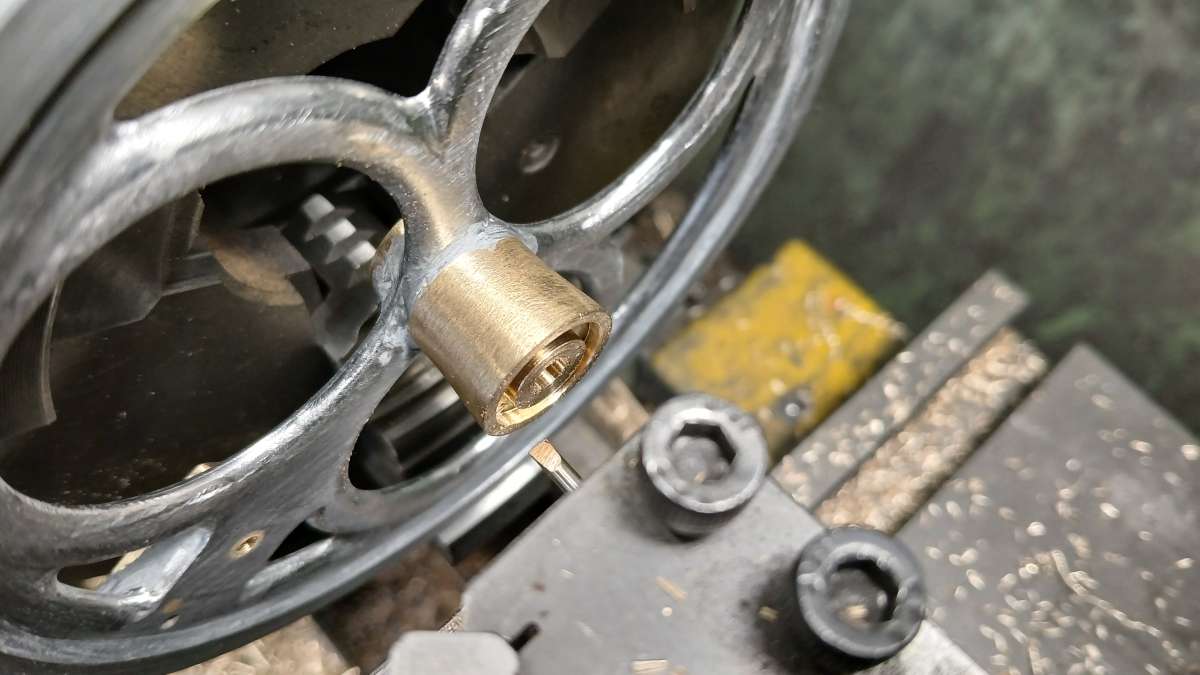

      Some further milling diverted the air around the cylinder pivot which had a bronze insert fitted. The hub was made up of two pieces of brass and the rim from the above mentioned offcut of thick wall tube. All assembled with JBWeld and then finish machined
      20260602_134640

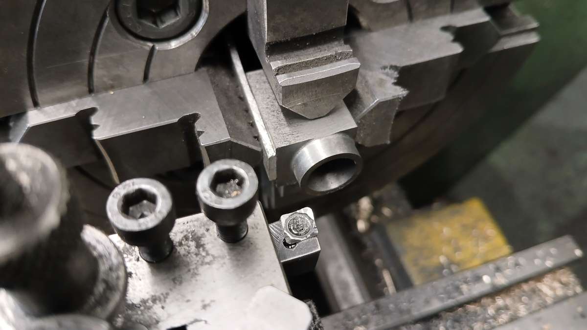

      A 2mm drill shank was ground to make a cutter to form an annular groove in the bottom face of the flywheel which allowed air to flow from a hole in the base during the full rotation of the flywheel.
      20260605_142939

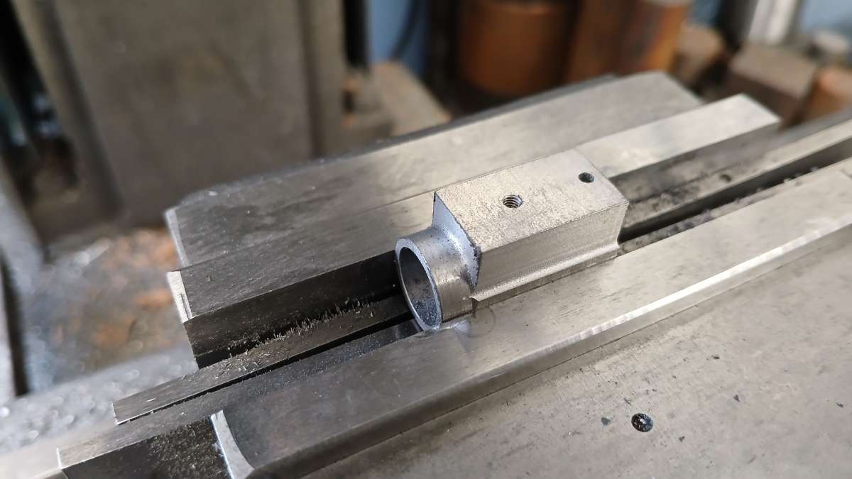

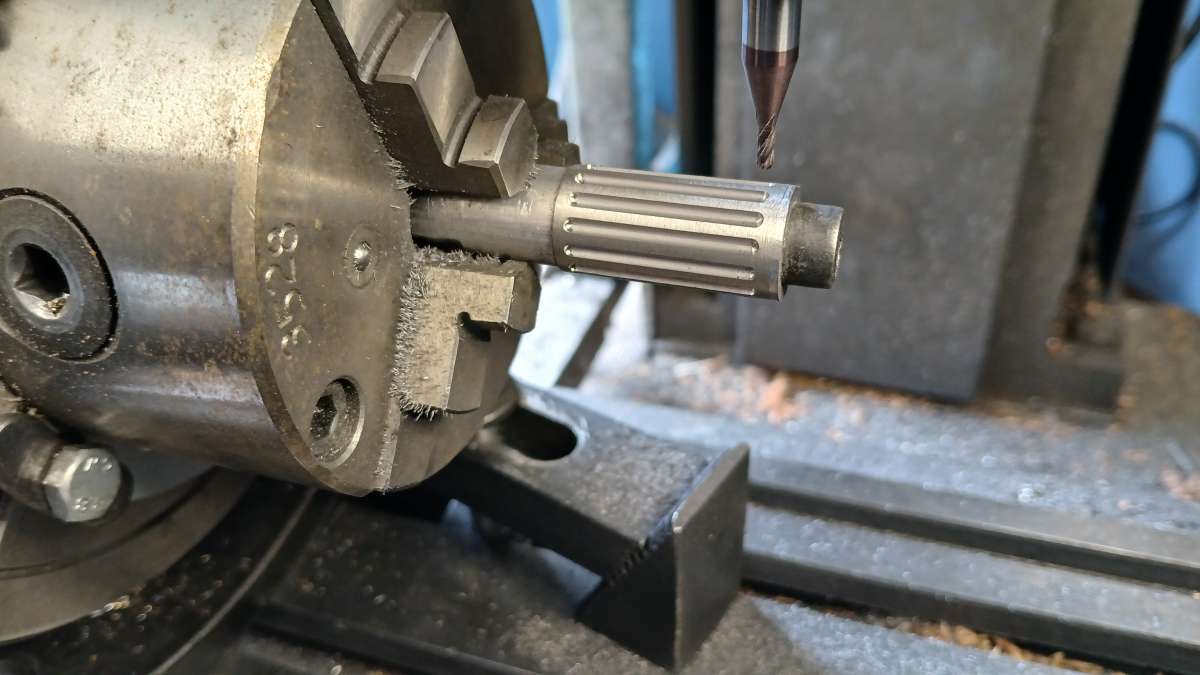

      The cylinder was much the same as the other small oscillators I have been making recently which start a sa rectangular block that is bored & turned
      20260606_084108
      Then the holes added and port face milled to width
      20260606_090457

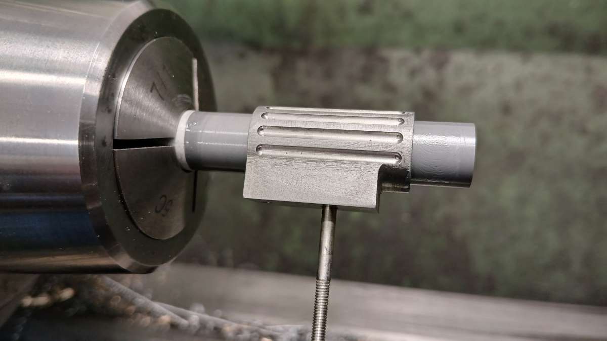

      I also milled some decorative flutes with a 2mm ball nose cutter.
      20260606_104559
      The last job was a quick lap with 600g silicon carbide powder and oil mix
      20260610_144037

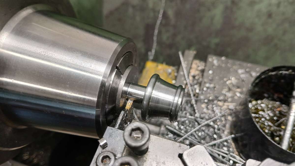

      The base boss like the cylinder end cover and crank pin cap were turned with a mix of conventonal turning tools, form tools for the balls and some freehand graver work for the concave parts.
      20260606_143957

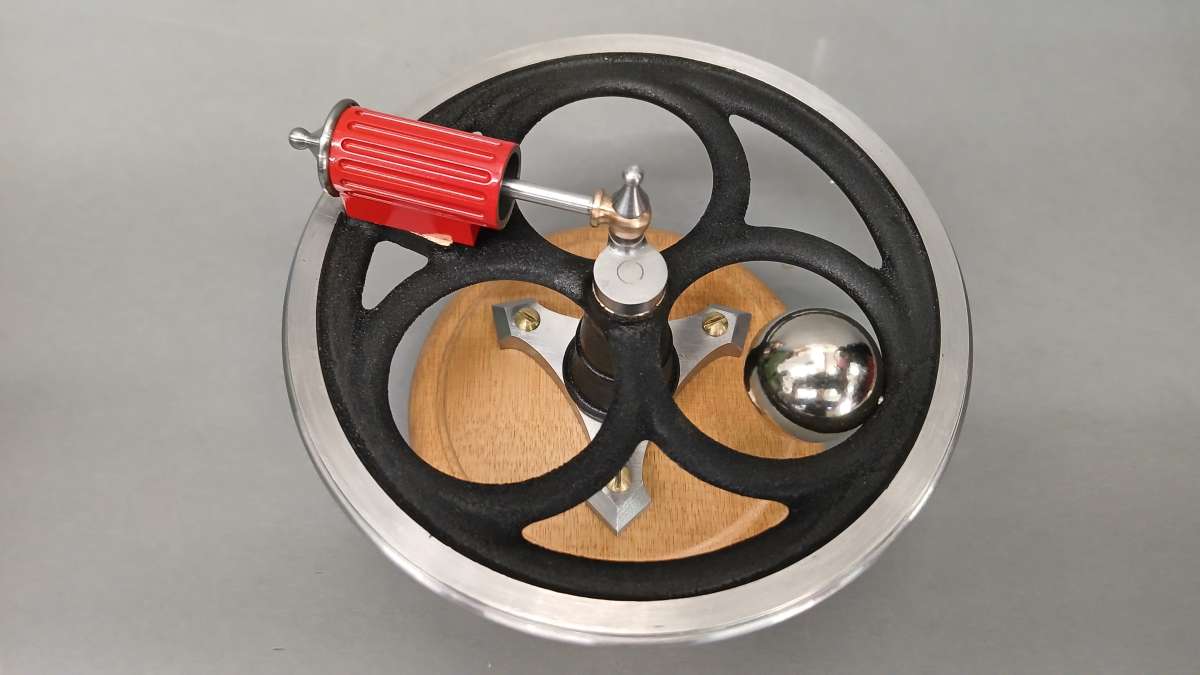

      #852171

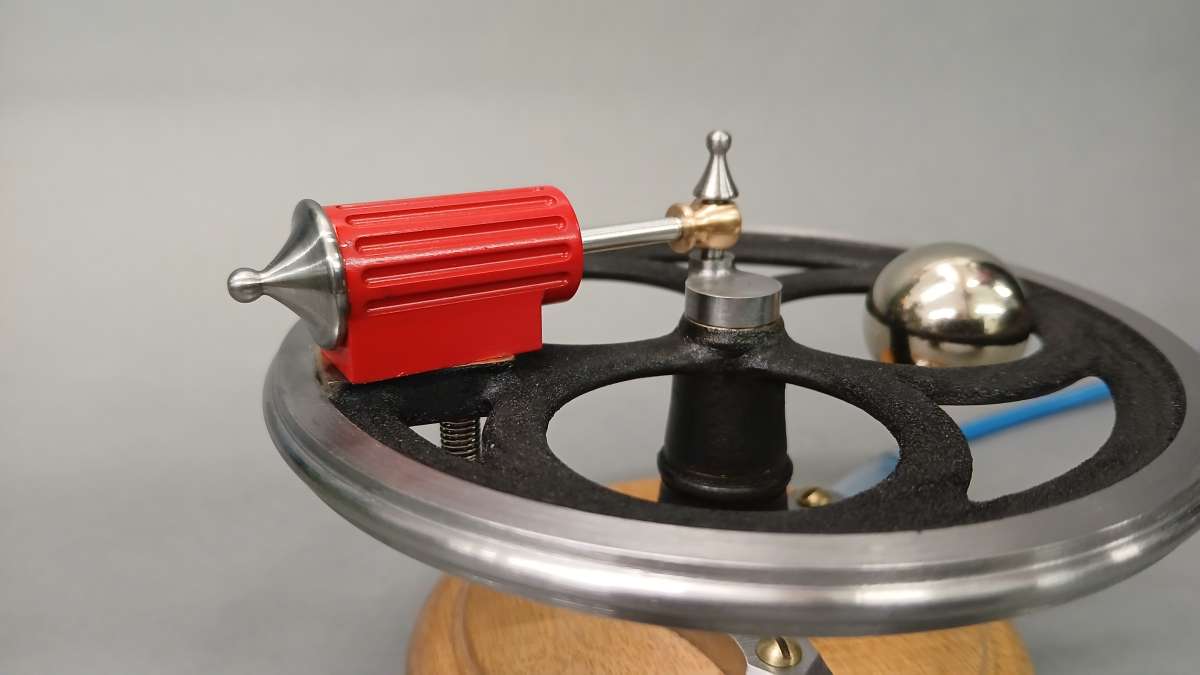

        I used some VHT wrinkle finish paint for the “cast” surfaces altough it did not wrinkle as well as it has done in the past. The Cylinder was done with Fial “orange red” and the rest left bare.
        An offcut of Paranna pine provided the base which was finished off with three ebony bun feet.
        20260615_183659
        20260615_183736
        20260615_184000
        Alibre seems to have got it right as there is very little tendency for the engine to want to start dancing around the bench. However it is very much a “stationary” engine as once running all that work becomes a bit of a blur, even the slowmo at the end of the video does not capture it very well.

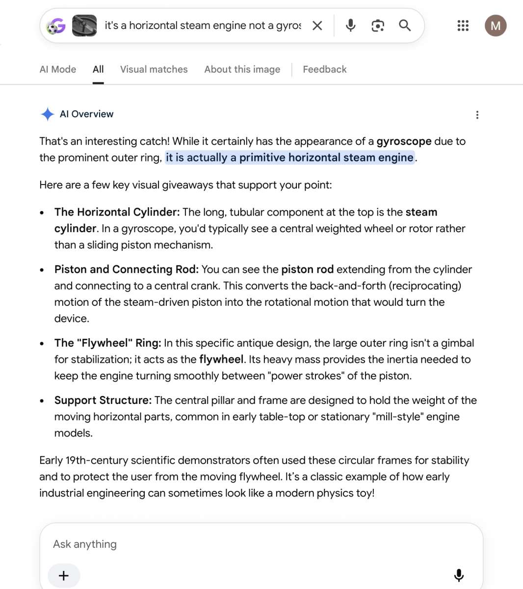

                  High Speed drilling machine, anyone ?
                  …. I wonder what the original’s intended application was.
                  #852204

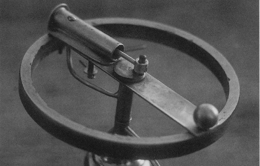

                    Google’s AI image search needed some help, but actually appeared to have learned from my hint:
                    IMG_1735
                    #852206
                      Thanks for the comments, even though according to AI it is a Primitive engine.😂
                      I don’t think there was a specific application, the article that the photo was in featured the models of a German cartoonist, Klaus Kock, better known for his steam powered fish.

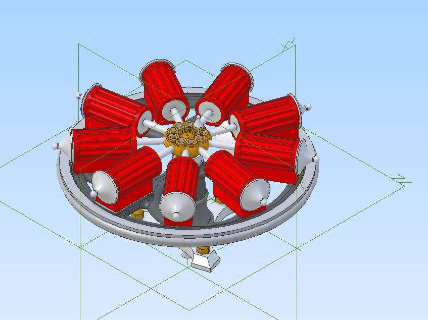

                                        On Martin Johnson 1 Said:
                                        A multi cylinder version would much improve the slow running which would be hypnotic to watch…………
                                        Martin
                                        Here is a quick idea of what a 9-cyl might look like, looking forward to seeing yours running slow😈
                                        orbit 9
