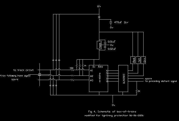

      We had a big thunder storm last week. When we switched the signals on today at least 5 of them are either not working properly or are dead. I lost the will to live after taking 5 down. Oh joy, oh rapture. Got to get them working again before our next public running, so I’d better get my skates on

                                    Robert, I’m back from holiday. Before I warm up the soldering iron, is this what you mean? The diode in the supply to the 7805 is to prevent damage when some clown (me) connects it up the wrong way. I suppose it’s superfluous with the new diodes as they will short out a reverse connection. The Arduino is looking for 0-1.7v, 1.7-3.4v and 3.4-5 v to indicate track occupied, clear, faulty connection so I’ll have to alter the settings a bit as the 100 ohm resistor will alter things a bit. In reality I’ve only got a month to rebuild 8 or more signals, so this will be a later add on.

                                      Almost, the 100R resistors should be between the external circuit and the diodes and the cathodes of the top diodes should go to the 5V supply not the 12V.
                                      The idea is that that any excessive voltage at the input is diverted to the supply rather than the input of the chip.
                                      Robert.

                                        I would choose much higher value of resistor than 100Ω but taking into account leakage when the track is soaking wet. In my view the input protection diodes need to be Schottky type.
                                        Are you sure you need to rebuild eight or more signals? Have you tested each one? Or is it obvious that each one has been damaged?
                                        Leave that diode in series with the 12V supply.
                                        I assume one of the 1kΩ resistors needs to go to A3 instead of to A2.
                                        We need to consider lightning hitting the ULN2003 from the preceding distant signal.
                                        I suggest using sockets for the Arduino and ULN2003 so they can be easily replaced if lightning strikes again.
                                        The three-level (ternary) signalling seems sensible but i do not see anything in your circuit diagram that supports this.

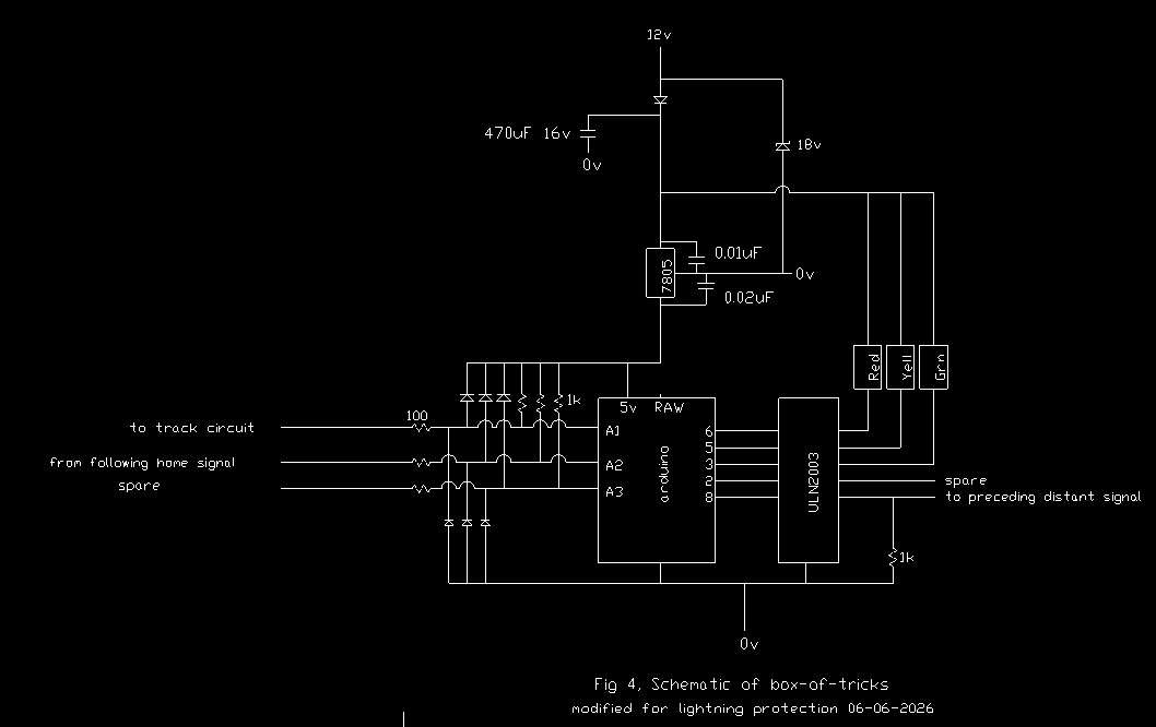

                                          schematic amended, and I’ve worked out how to fit the extra diodes/resistors (I think) by using the other side of the board
                                          Can someone suggest a wattage or part number for the 18v zenner?
                                          Cabling is domestic 1 sq.mm. twin and earth. Changing that is too big a job
                                          I’m fitting sockets for chips
                                          I hope 1n4001 are OK, I’ve got loads, but Scottky aren’t that expensive (1N5817, 1A 20V) if they would be better. FWD volt drop 0.45V, which isn’t a lot better than 1n4001
                                          At the far end of a track section there is another 1k resistor across the track, so if unoccupied there is nominally 2.5V at the Arduino input, if there is a train there will be 0V, and if there is a broken connection there is 5V. With the added 100 ohm resistor these values become 2.62V, 0.45V, 5V, so I’ll just adjust the ranges to suit. The usual reason for broken connection is that the track maintenance crew forget to put the jumpers back between rail ends when they’ve been messing about
                                          Not had any problems with leakage across sleepers, which are plastic. The aluminium rails quickly develop a coat of oxide, and rain water isn’t that conductive anyway.
                                          Thanks to everyone who has contributed

                                            what I don’t understand, although I’m sure it’s right is the statement “any excessive voltage at the input is diverted to the supply“. It can only go back to the 5v line and then be blocked by the 7805? Or will that back conduct? Even tho’ I’m getting old I like to learn.
                                            At least 5 of the signals were showing spurious indications, so I’m assuming at least the processors are blown. I ran out of time to check the other 3 in the series but I’ not hopeful. I’ll know later today. I’ll do some testing to see whether the 7805 and ULN are blown before I rip it all apart

                                              I do not know what microcontroller your Arduinos are using but taking for example the ATmega32U4, then all inputs have protection diodes incorporated. This is reflected in the specified absolute maximum ratings for input pins of -0.5V to Vcc+0.5V (with respect to ground). I expect these diodes have very limited transient current handling capability. That is why I suggested use of Schottky diodes.
                                              We ought to consider what would happen to the Arduino’s 5V supply if a surge current passes through one of the protection diodes that is connected to 5V. Would the 5V supply go above the 6V maximum rating of ATmega32U4? I would therefore be inclined to add 5.6V zener protection (with a resistor).
                                              I note that the connection to the preceding distant signal remains unprotected.
                                              We ought to consider that these circuits are probably not powered up when there is lightning nearby.
                                              I still maintain that using much higher resistor values throughout would give much better protection against lightning transients.

                                                  I suggested 100R as a compromise value not knowing the exact circuit in use. With the circuit shown 1k in series will prevent correct operation of the circuit. A 1N4007 is rated at 45A for a 1ms square pulse. with 100 R in series this is a 4500V pulse. Thus 100 R is adequate to limit the current through the diode.
                                                  The problem with Schottky diode is their low reverse breakdown voltage. I’m aware that most microcontrollers have “diodes” between most pins and the supply rails. Typically these are parasitic rather than designed in. Adding the 100R and 1N4007 diverts most of the energy to the supply and provides a current limiting impedance considerably reducing the stress on the much smaller junctions on the microcontroller. Even better protection, for the input circuit shown, would be to add a 1k resistor between the existing 1k resistor and the pin of the microcontroller.
                                                  The energy from the spike at the input is partially converted to heat in the 100R resistor and partially absorbed into the 5v supply network raising it’s voltage slightly.
                                                  A 5V6 Zener diode across the micro controller supply pins is a good idea for additional protection.
                                                  Robert.

                                                      So it’s not as bad as I thought, only 7 blown signals, not 8. At least one of the signals has a blown 7805, which is outputting well over 5v, so what’s happening to the inputs on that one is a bit irrelevant.
                                                      To incorporate the mods suggested would mean a new pcb, and I’ve already got 9 spares. I’ve also got time restraints, got to have them up and running for next public running, so I’ve decided to just fit sockets for the time being. Nano from AliExpress is only about £2, it’s just the pain of fitting them
                                                      On the mk4 board when the panic is over, is it worth a resistor in the feed to the processor, to drop the voltage to 8v, then a beefy capacitor to mop up spikes? Any mileage in passing the inputs/outputs through ferrite beads?
