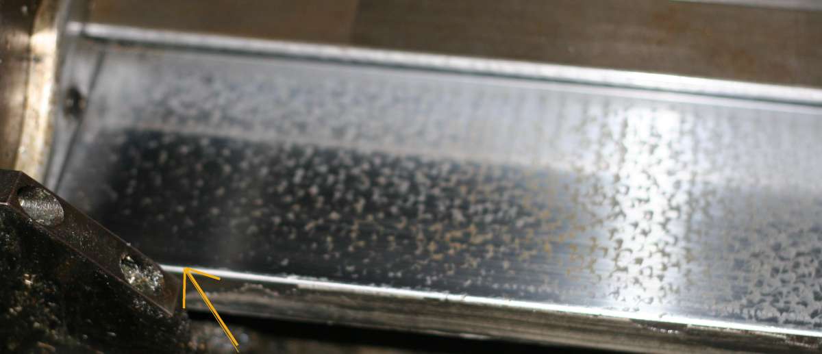

      Hello,
      I got the Interact into its place and started to clean.
      Some photos. They show some wear on the slide that transports the table inwards and outwards at the arrow.
      It is not so bad on the other side. The oil marks or scrap marks can be seen to decrease.
      On a scale of 1 to 10 where would this amount of wear be put? (10 being terrible).
      I don’t think it’s too bad. The ‘ways’ are supposed to be chromed on these machines. Is the chrome still there?

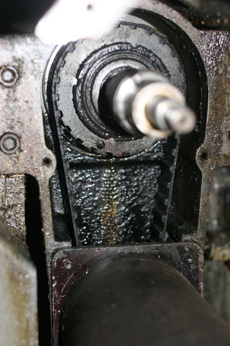

      There is oil on the belt that moves the table from side to side. Is this normal? The belt that moves the table inwards
      and outwards is bone dry.

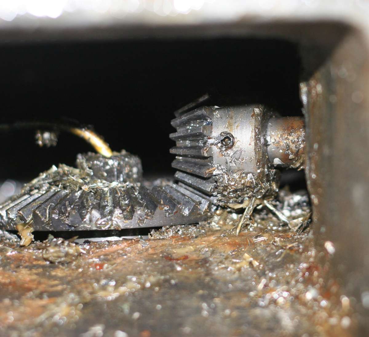

      There is a pile of chips in the cavity that holds the cog wheels for moving the knee up and down. I will have to clean.
      What is the best way to get at this area. I am thinking to remove the motor that moves the table inwards and outwards.
      I thinik you can get at the cavity that way. It’ s big job to take off the table.
