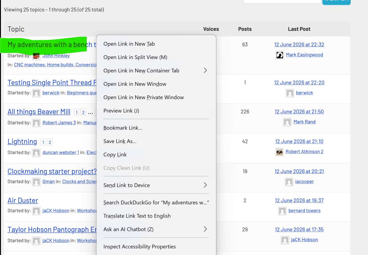

            On Nigel Graham 2 Said:
            Err, you can’t readily refer back up-thread once on a new page, but someone asked if a previous owner had managed to bend the quill.
            Nigel,
            If you Right Click where I have highlighted in green, then click on “open in a new tab” you can easily look at the post in a separate tab, and flick between reading and writing, in the two tabs.
            Screenshot 2026-06-12 223850
            Mark.
