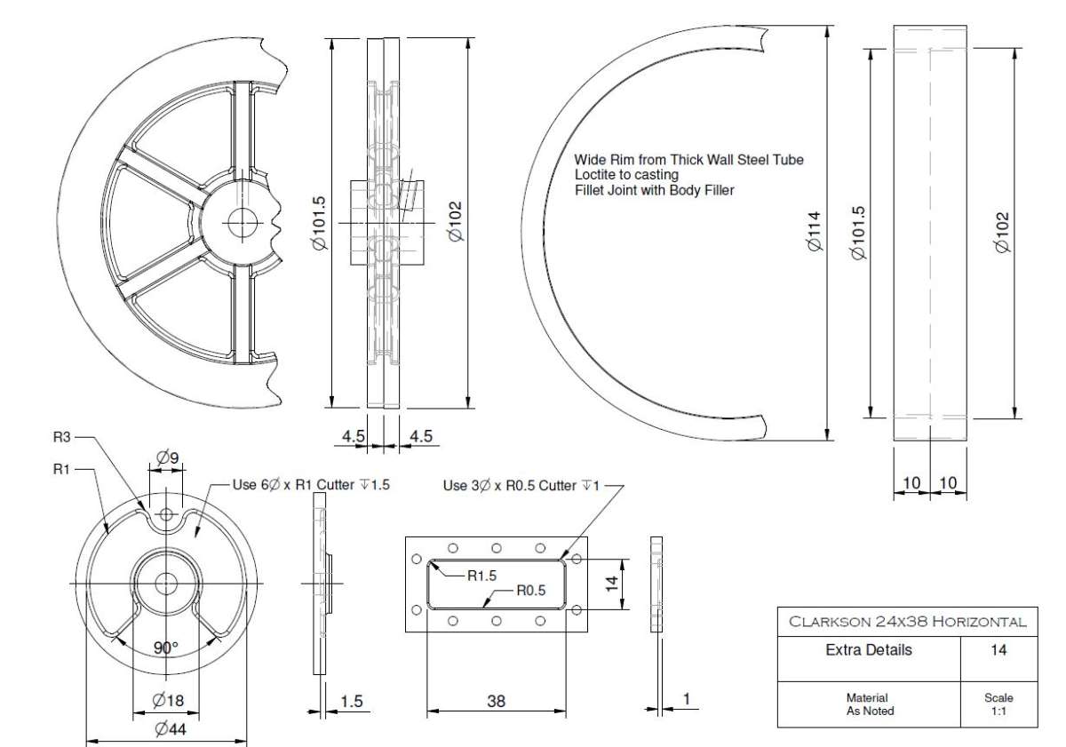

      EDIT 17-02-2026

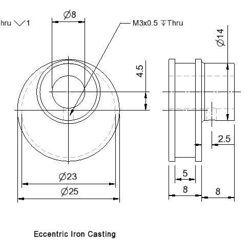

      With the arrival of Issue 4774 I will bump this thread back to the top and start adding some additional photos that did not make it into the magazine article.
      While most of you seem to be entrenched in the tea room I’ve been out in the workshop.
      Having felt for a long time that anyone looking for their first casting kit will get lead down the imperial route even though it may not be familiar to them I decided to redraw the Clarkson 1″ x 1.5″ Horizontal in metric and while I was about it sort out the few anomalies and missing details that the original drawings suffer from.
      An updated metric drawing set should soon be available from Blackgates, the castings are available now. It’s not a bad buy when compared to a similar size Stuart No 8 and the cost of materials and fixings is still not going to bring the cost up to that of the Stuart. Build should be in ME at some time in the hopefully not too distant future.

              Thanks for the comments
              At least with the new drawings you should actually have dimensions to read as many times as you like rather than them being completely missing or simply not possible to achieve from the actual castings. But as my lathe is imperial and does not have a DRO I can confirm that the world is not going to end but I should inform you that it is not flat.
              I’m not quite sure yet whether Blackgates will supply both sets of drawings or give the buyer the choice of the old imperial or my new metric ones so those with old iron need not have to take their socks off.
              As Hopper says more of the hobby machines are coming with just a metric option and the same goes for tooling and equipment with metric being more readily available at reasonable prices.

                Just a quick update to say that Blackgates are now able to supply a set of my metric drawings which comprise 14 A4 sheets, one GA one with 3D views, and the remaining 12 of the individual parts. Just mention you want the metric ones when ordering a set of castings.
                I’m also half way through writing up the build which will go into ME Mag and I will also give Blackgates permission to include that with any future kits sold.
                In time I will also do a set of drawings for the vertical as I now have a set of castings for that, not sure when as another little Clarkson has caught my eye and is now nearer the top of the list.

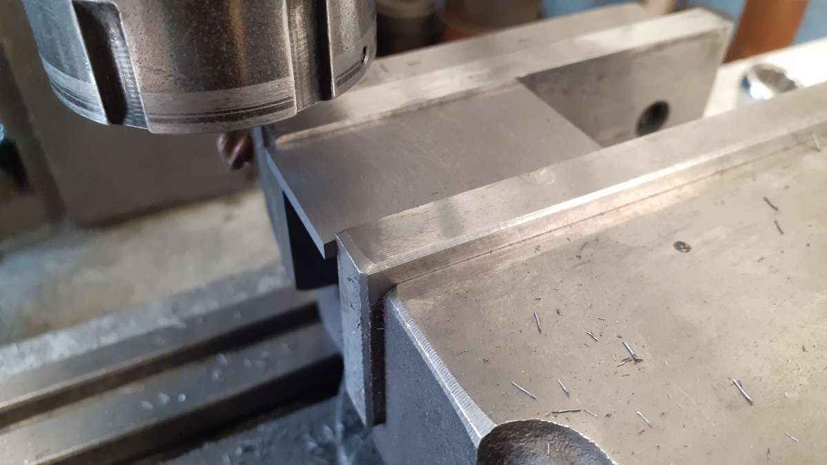

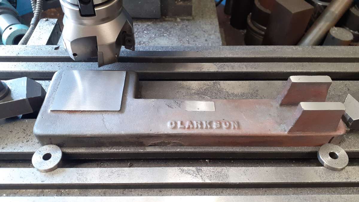

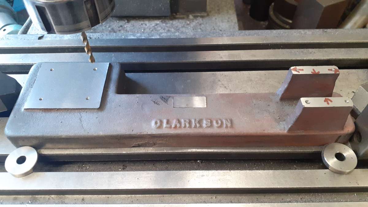

                  Additional photos to go with part 1 of the article in issue 4774

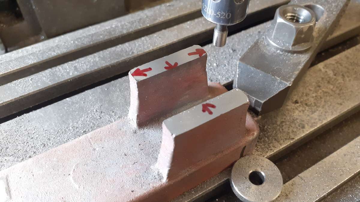

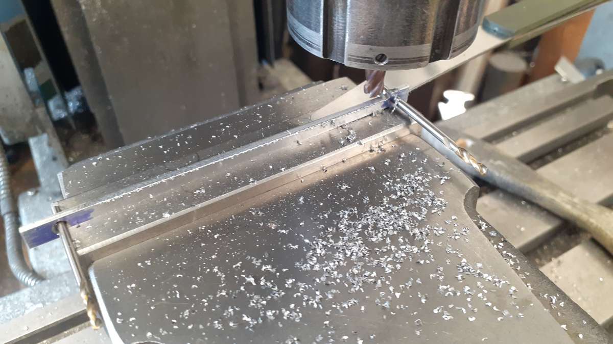

                  A square on view of the first cuts to the bed plate. The two Sharpie marks indicating where the locating buttons are touching can also be seen more clearly.
                  20240612_140153

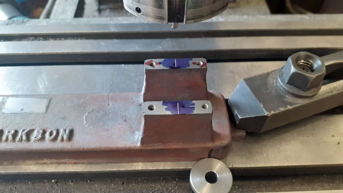

                  Locating the datum point with an edge finder – between the pedestalls and mod way along them.
                  20240612_140716

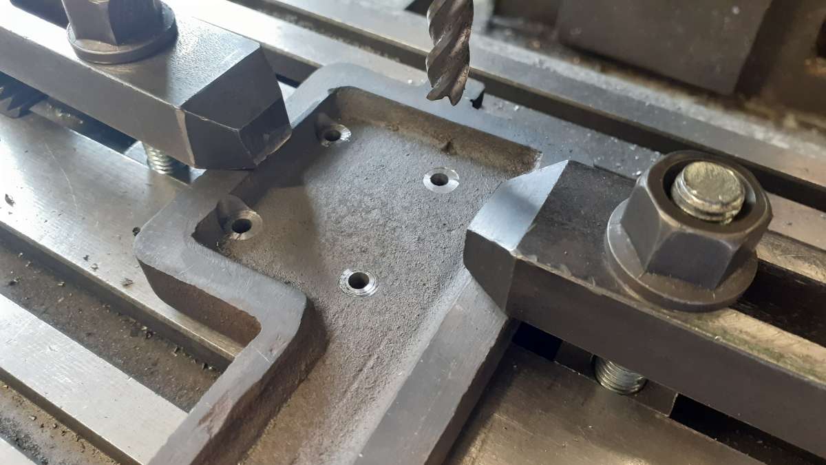

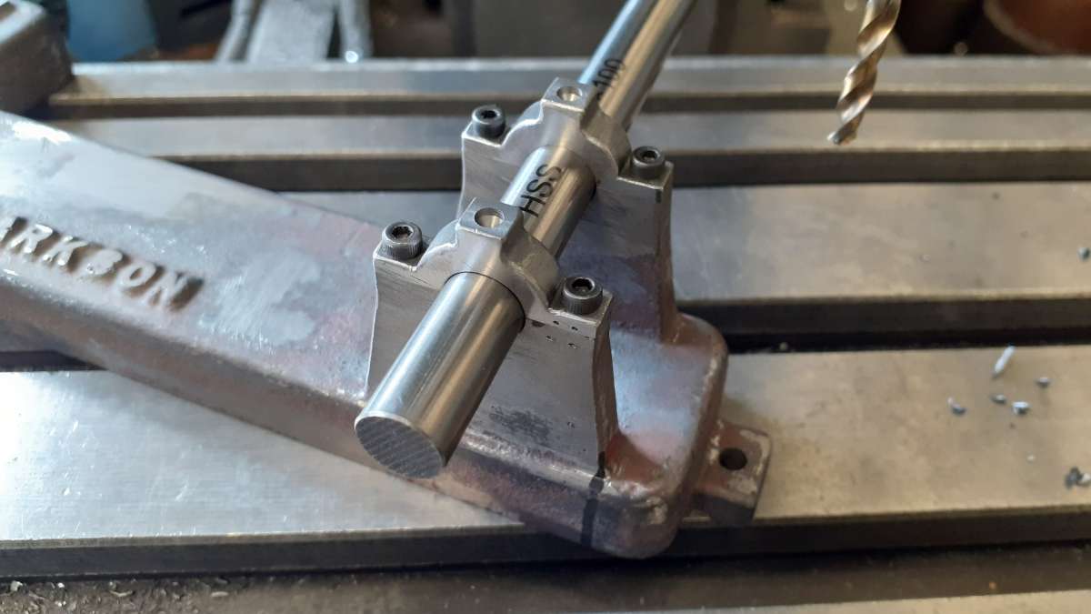

                  Cylinder mounting holes and bearing cap holes spotted prior to drilling
                  20240613_090256
                  Marking the bearing ctr line by dragging the end of a spotting drill over the machined & blued surface
                  20240613_092334

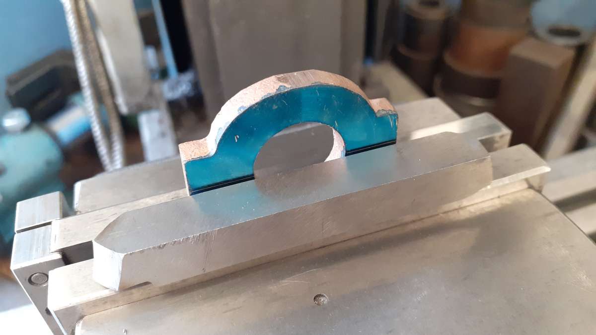

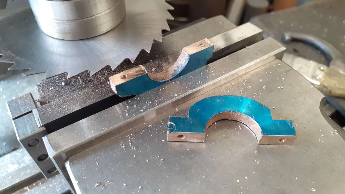

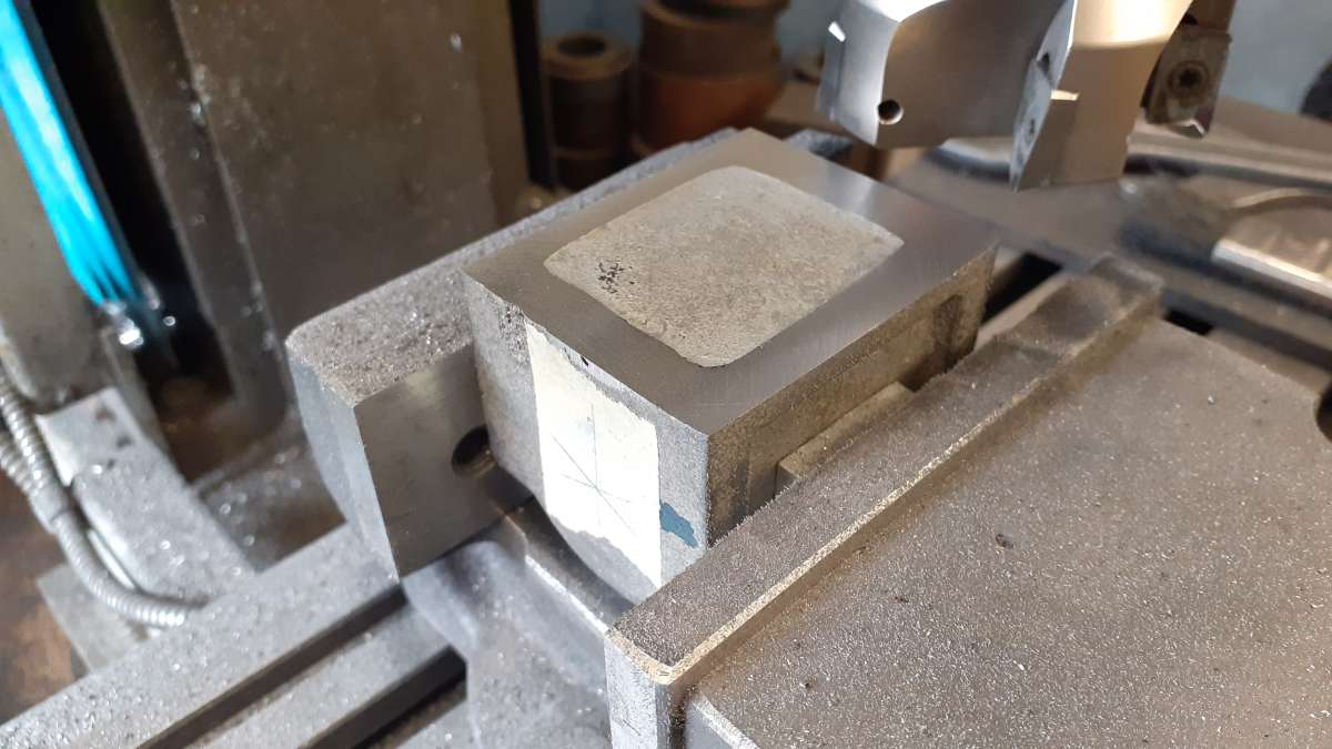

                  marking the posistion of the saw cut to split the bearing cap casting into two
                  20240613_142124
                  A light skim cut to clean up the sawn surfaces
                  20240613_142802

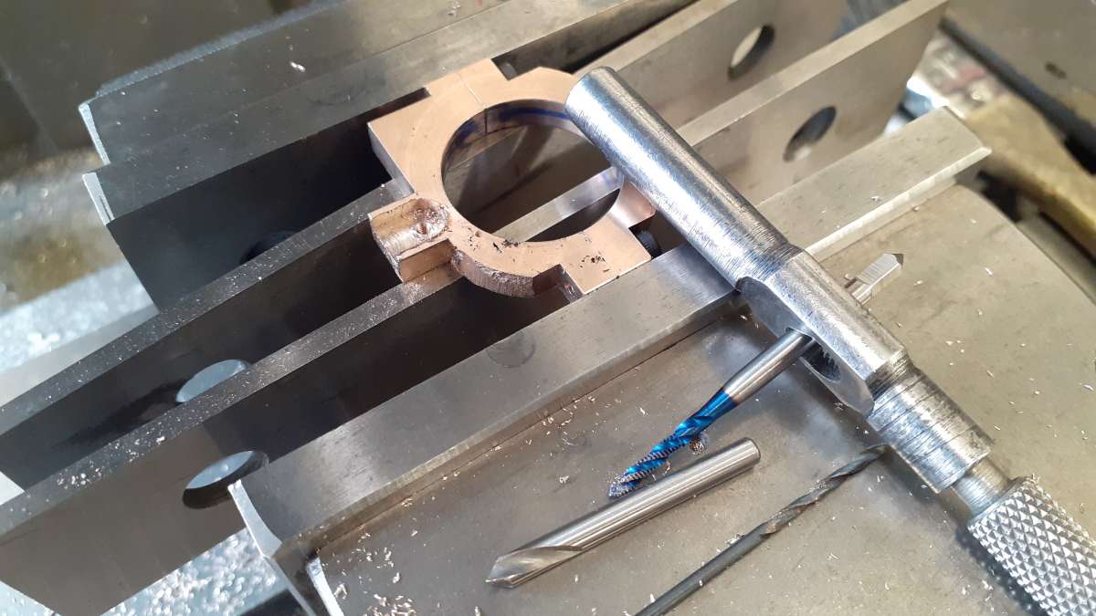

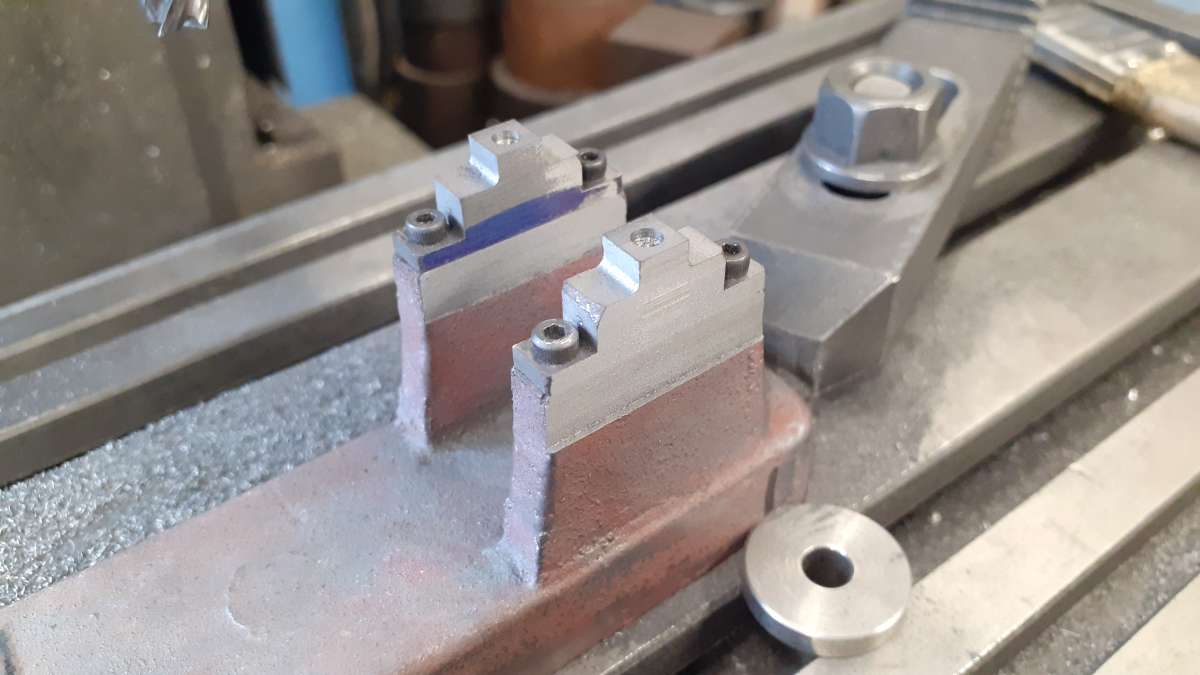

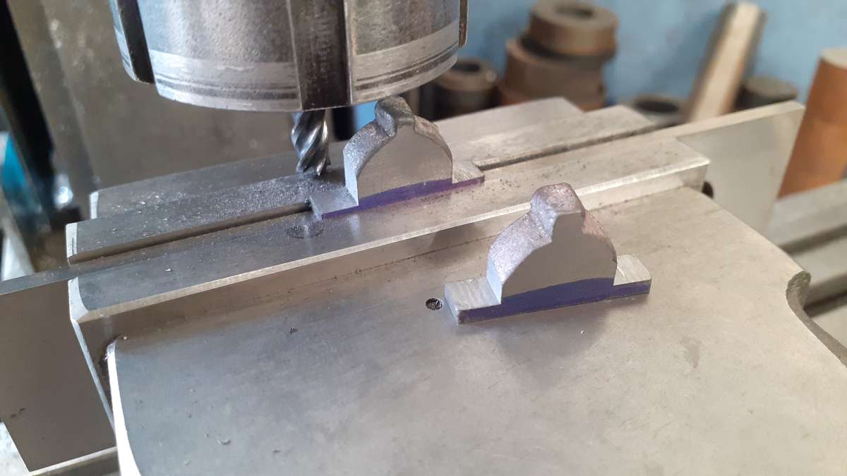

                    #838080

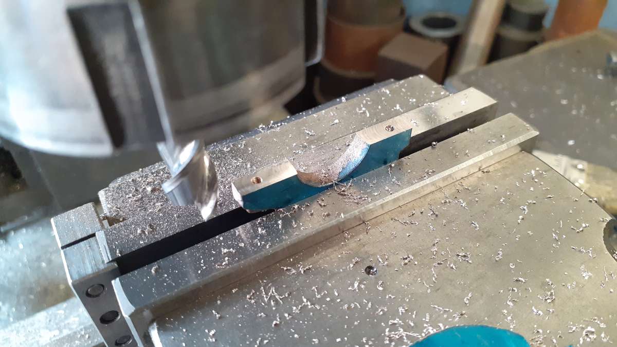

                      Milling the oil pocket to width and height with a 1mm corner radius 6mm cutter to leave a small fillet
                      20240614_092010

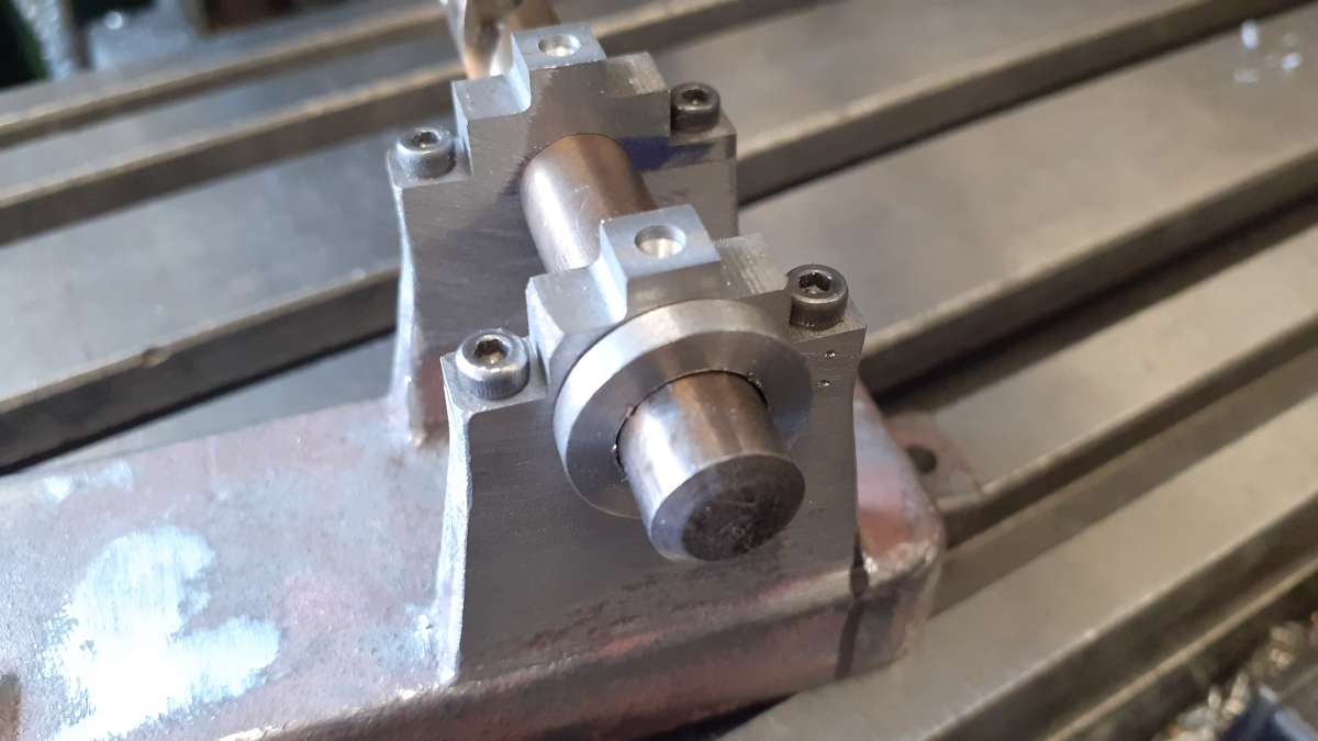

                      With the caps now screwed into place they and the tops of the pedestals can be milled to width
                      20240614_094103
                      The casting is now held on it’s side and a wobbler used to locate the previously scribed ctr line.
                      20240614_133840
                      The bearing holes being reamed to 10mm diameter although they could also be bored
                      20240614_135121

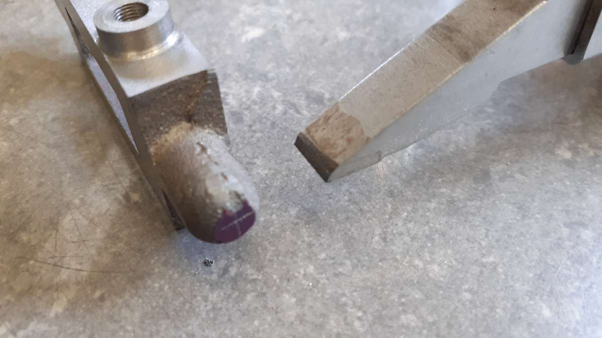

                      using the shank of a drill to locate a filing button the curve of the cap can be marked prior to filing.
                      20240614_141442
                      The last job on the bearing caps if to knock off all the corners with a needle file to give a softer cast look.
                      20240614_144510
                      Next time I will describe the Cylinder and its associated parts.

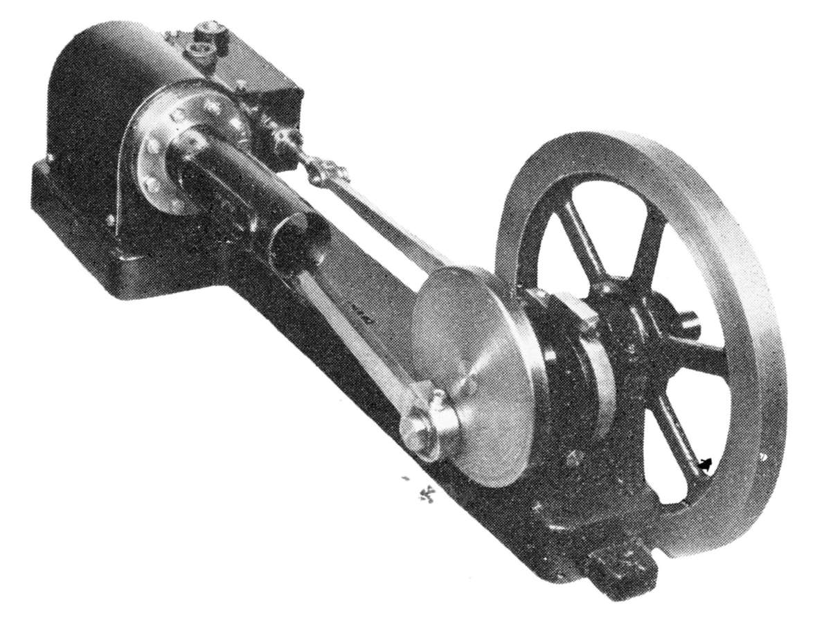

                      #840494
                      John Purdy
                        @johnpurdy78347

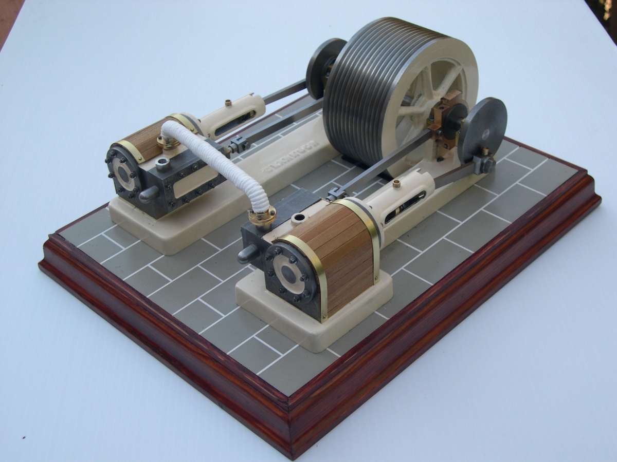

                        Jason
                        I see you have modified the original Clackson flywheel to make it a little more prototypical. I always though the the original looked odd, being so thin!
                        Quite a while back I made the compound from a set of old original Clarckson castings I acquired 2nd (3rd/4th./?) hand back in the early ’90s.
                        On most there was minimal to no machining allowance, requiring very careful set up, and there were a lot of chilled areas.
                        The bearing caps, in particular, were unusable as the as cast dimensions were considerably less than the finished dimensions. Would have been very frustrating for a beginner’s first attempt.
                        I hope the new castings from Blackgates are of better quality than the originals.
                        Clackson Single
                        DSCN3146
                        #840508
                          Nice looking compound John.
                          I also feel that the flywheel is rather thing, I wonder if they came up with the compound first where the two flywheels work OH in combination with the separate drum. They may then have decided to do the single and simply used the same casting, hence it not looking quite right. It does run with teh skinny one but is smoother at low revs with the heavier rim.
                          I don’t know if you have seen the article which has now started in the Mag but I give options to use the flywheel as supplied as well as a drawing at the end for modifications including the larger rim, recessed face to the valve chest and similar to the crank disc to give a counterbalanced look.
                          extras
                          This was built from a set of compound castings that were missing a few bits, like yours an old set of castings. I had heard that they were known for being hard, some initial clean up cuts were not a problem but I did take the precaution of cooking a few of th ethinner castings prior to machining and had no problems.
                          The drawings I have done are not just a mathmatical conversion but redrawn to suit the actual size of castings and I was able to get all the parts from them. Several alterations along the way for a better look too including things like avoiding the need for that clearance notch in the end of the trunk guides

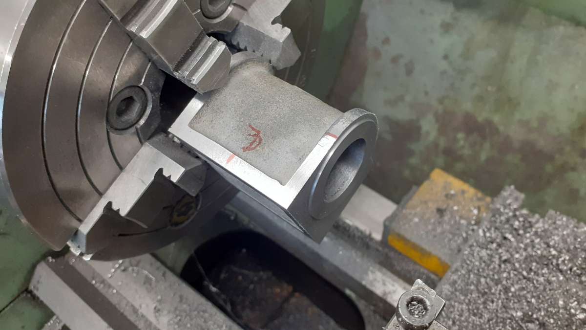

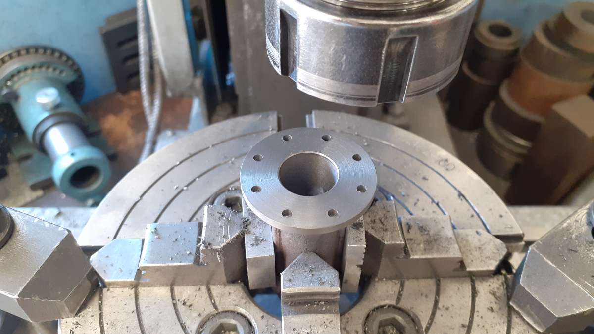

                              A few more extra photos to go with part 2 which is in issue 4775

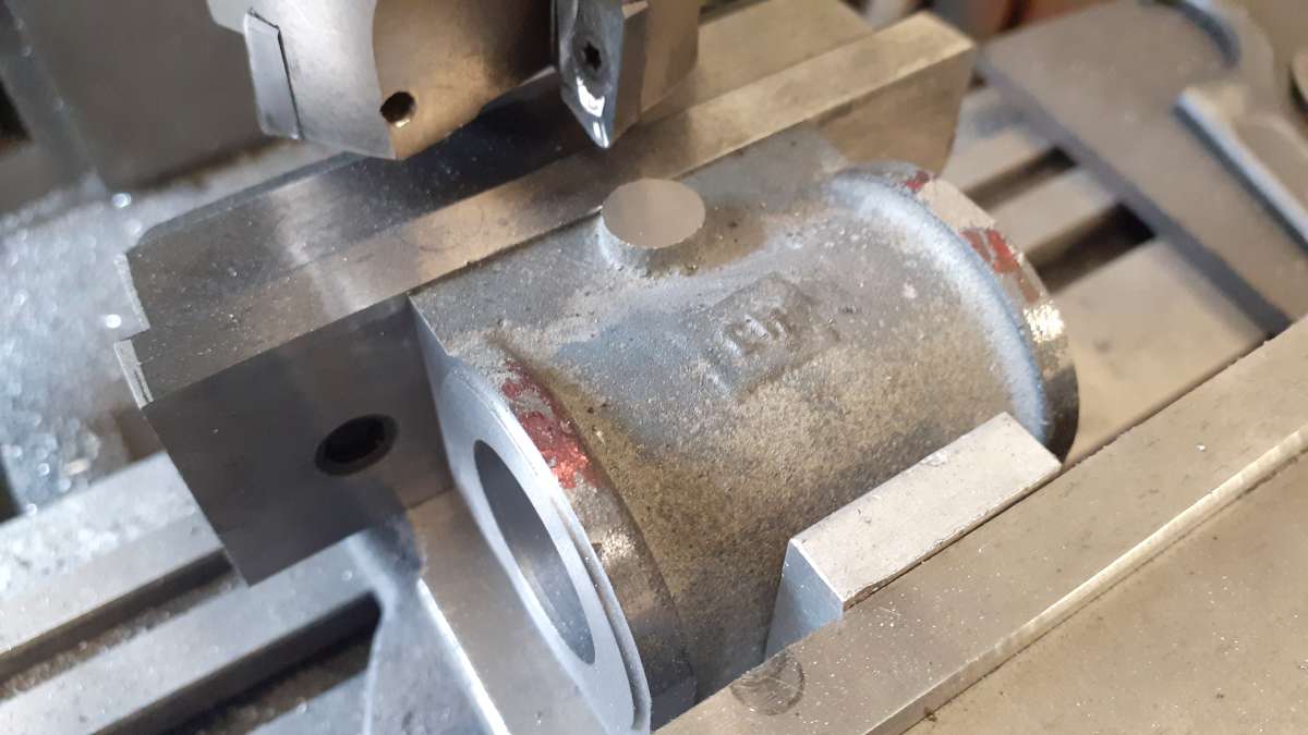

                              Initial skim cut to just clean up the port face
                              20240615_113656
                              Then a clean up pass of the bottom surface
                              20240615_115034

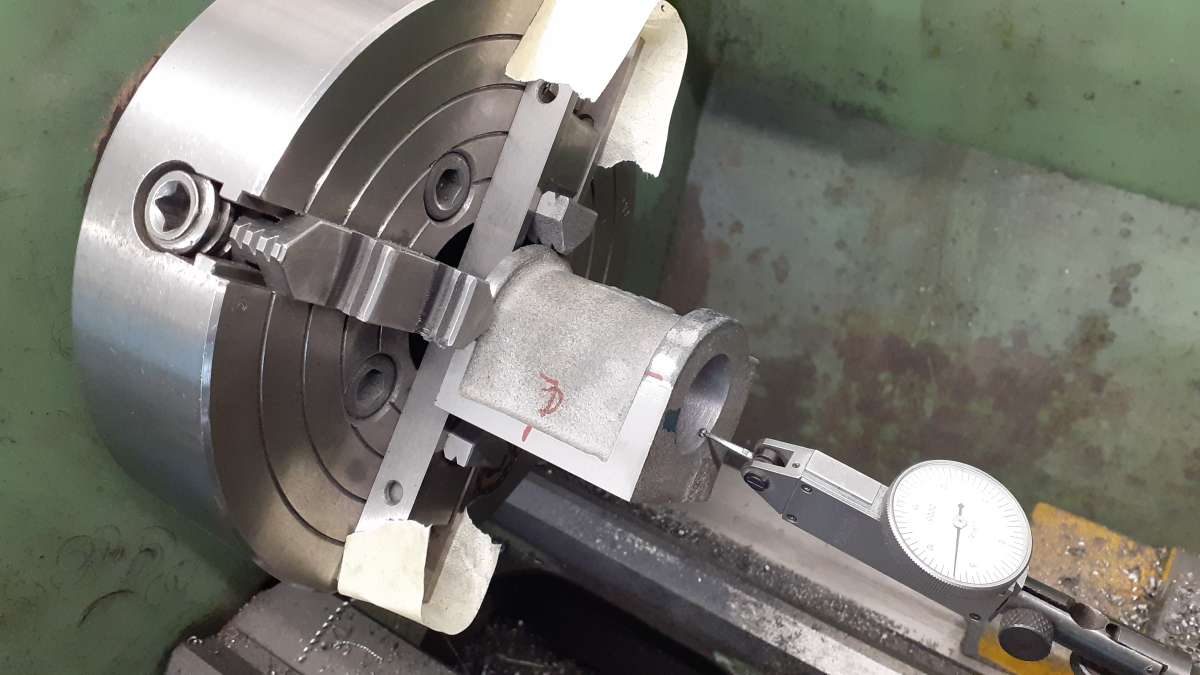

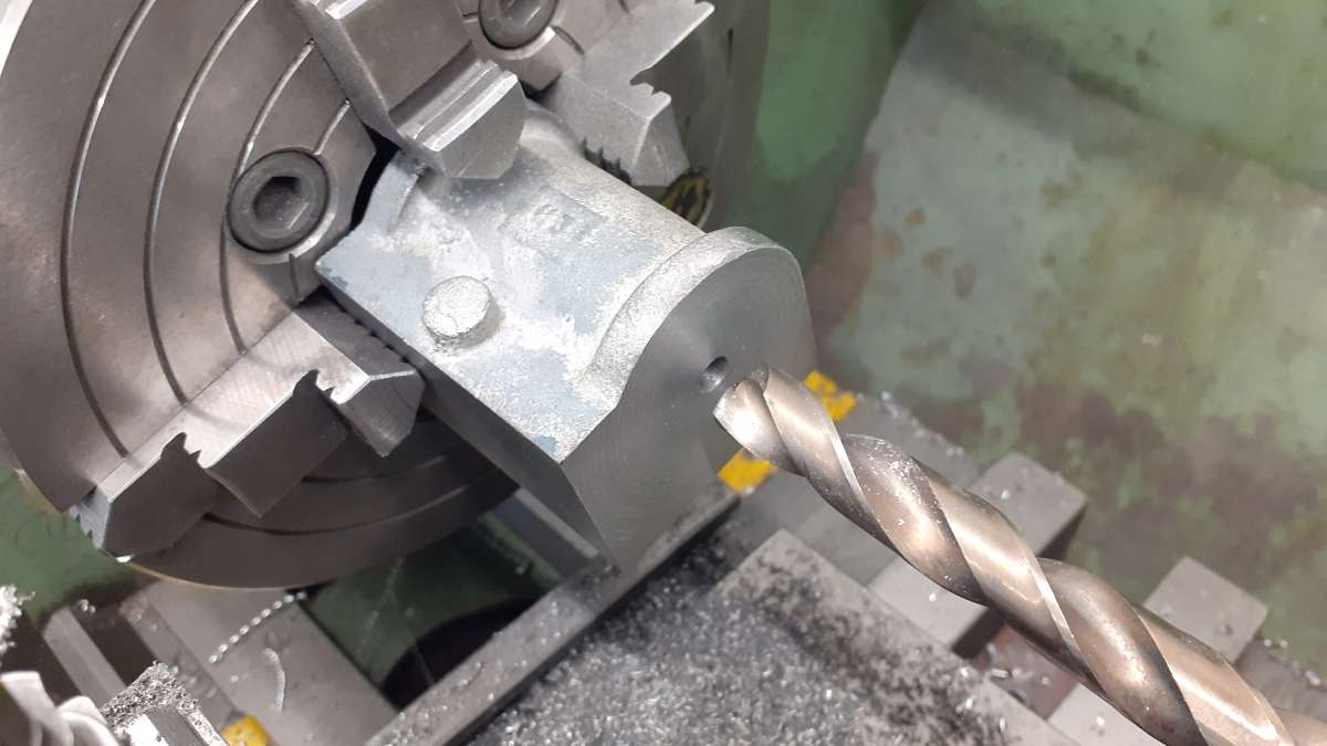

                              Checking the casting is square to the chuck face while clocking in the ctr mark
                              20240615_121810
                              Skim cut off the cylinder end then start drilling out so you can get a boring bar in.
                              20240615_132722
                              Casting held the other way round and clocking in the bore prior to turning the second end
                              20240615_143541
                              Second end turned
                              20240615_145131
                              Bottom face after final milling
                              20240615_150122
                              Port face after final milling
                              20240616_084312
                              Milling the exhaust pipe boss to length
                              20240616_085330

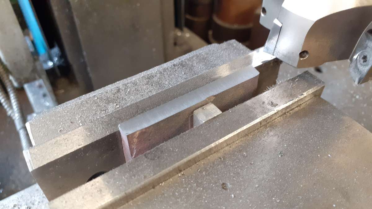

                              #844850
                                With part three now available here are some additional photos to go with that.

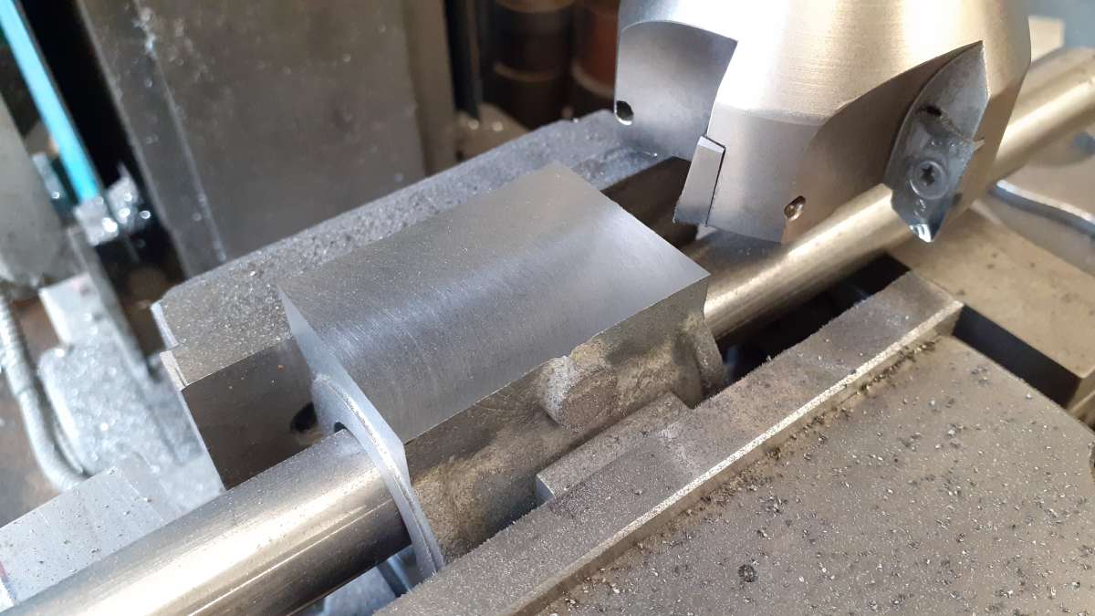

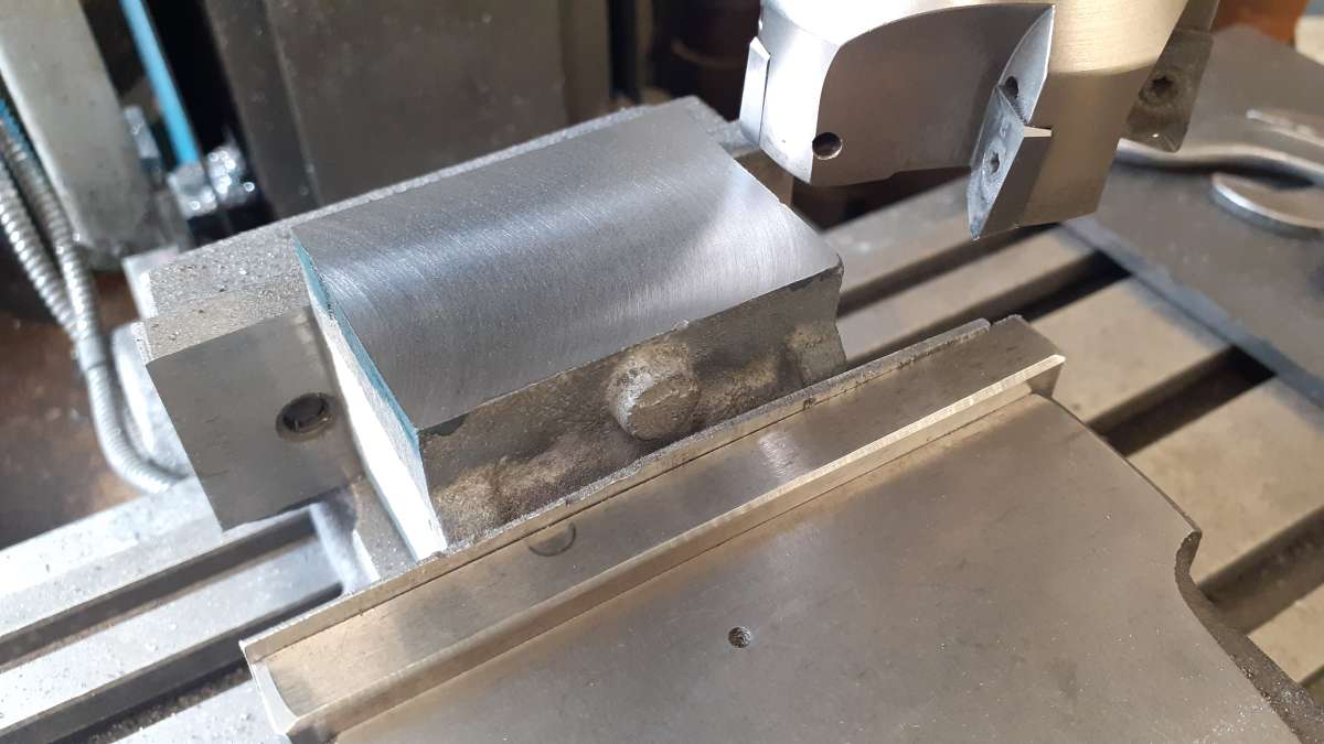

                                Cleaning up the first face of the valve chest, aluminium packing used to take up any irregularities in the cast surface and also allow jaw pressure onto the main edge not just the inlet boss.
                                20240616_140124

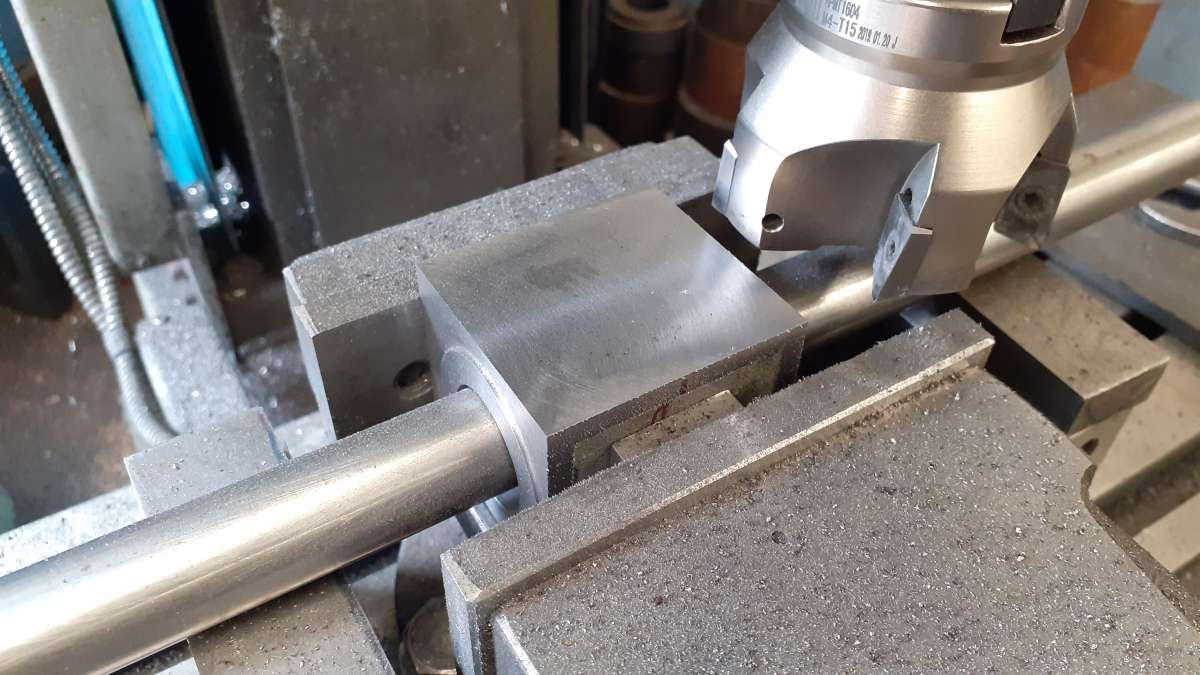

                                A similar operation for the opposite side with the previously milled face tapped down onto parallels
                                20240616_140758
                                Lastly the bottom edge is cleaned up
                                20240616_144041

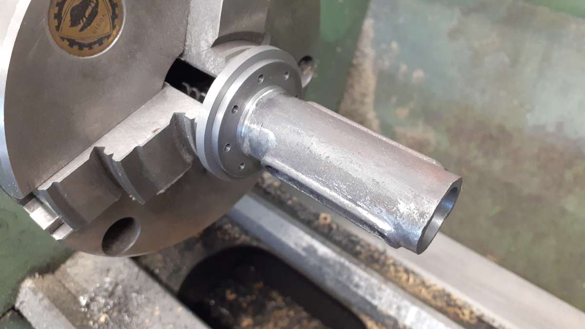

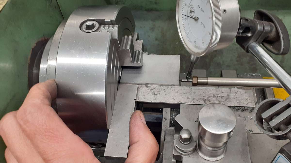

                                After doing the top edge in the 4-jaw the ctr of the rod guide can be marked
                                20240616_144655
                                Back in the 4-jaw to set the mark to run true before machining.
                                20240618_113812

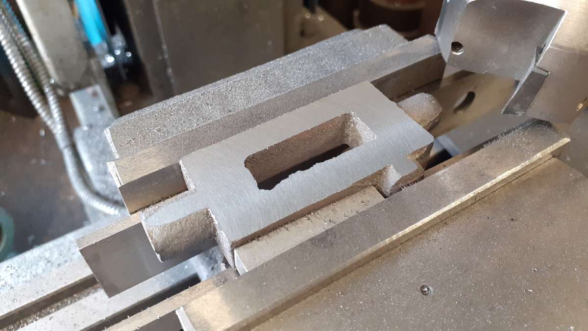

                                The inside can then be milled to size, come in from both sides unless you have  along reach cutter
                                20240618_122043
                                Clean up the cover to match the O/A size of the chest
                                20240616_145530
                                20240618_140637

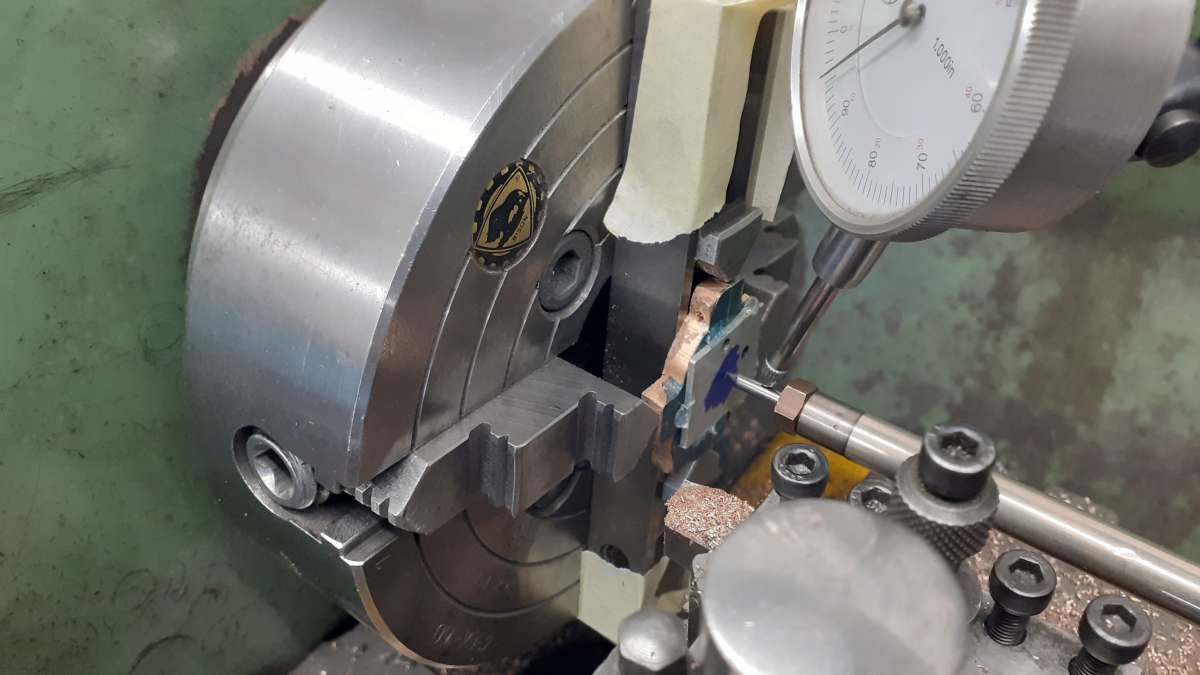

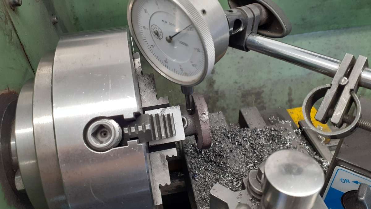

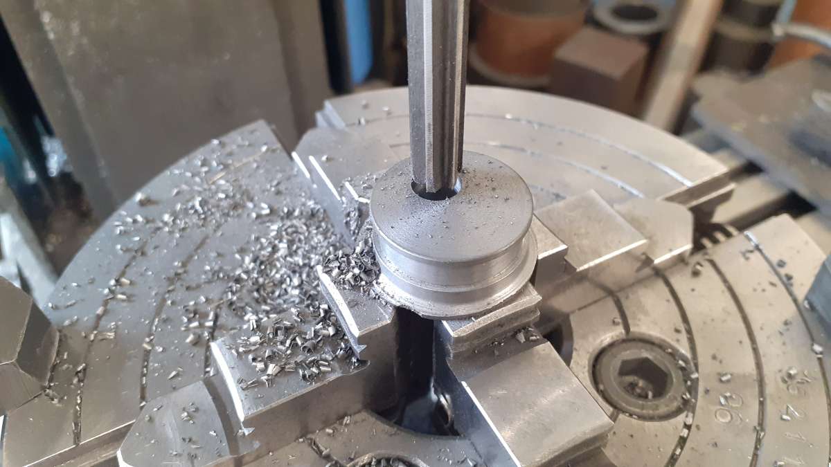

                                #844879
                                  Clocking in the trunk gude with the indicator on the smaller diameter behind the flange

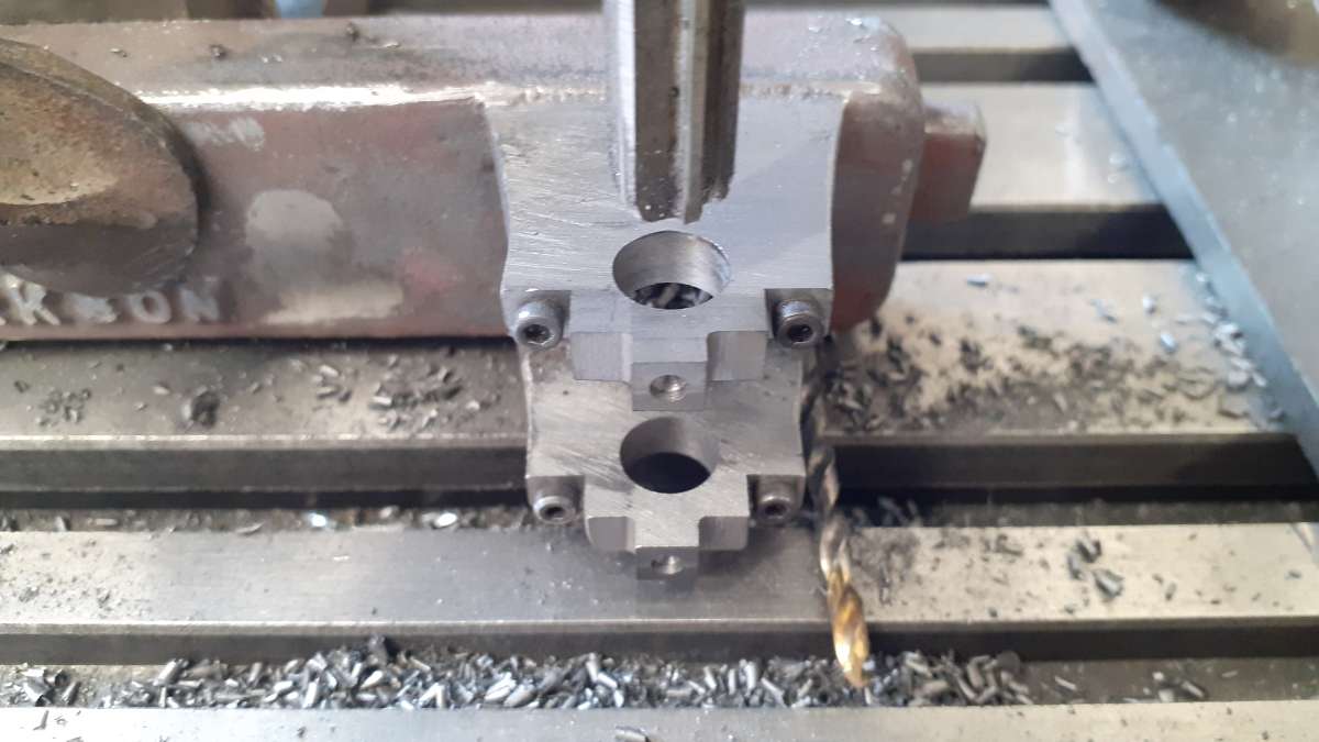

                                  20240620_110907
                                  Part left in 4-jaw and moved to the mill for drilling the holes
                                  20240620_144000

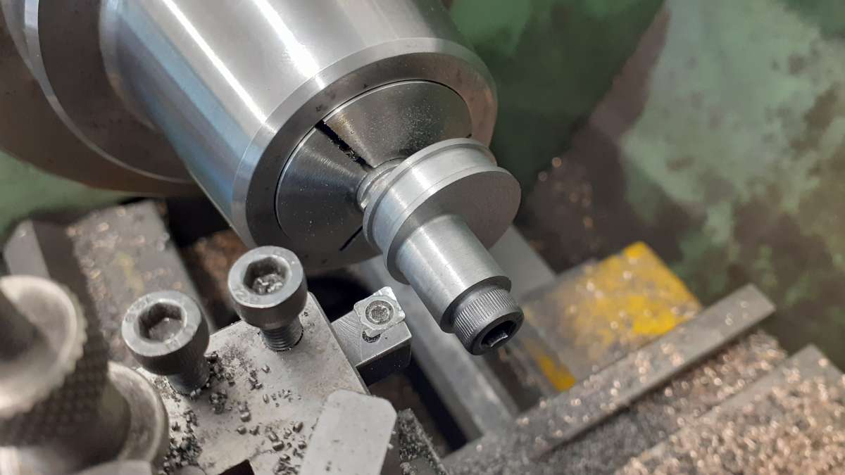

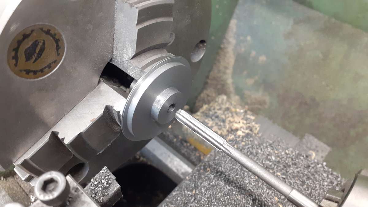

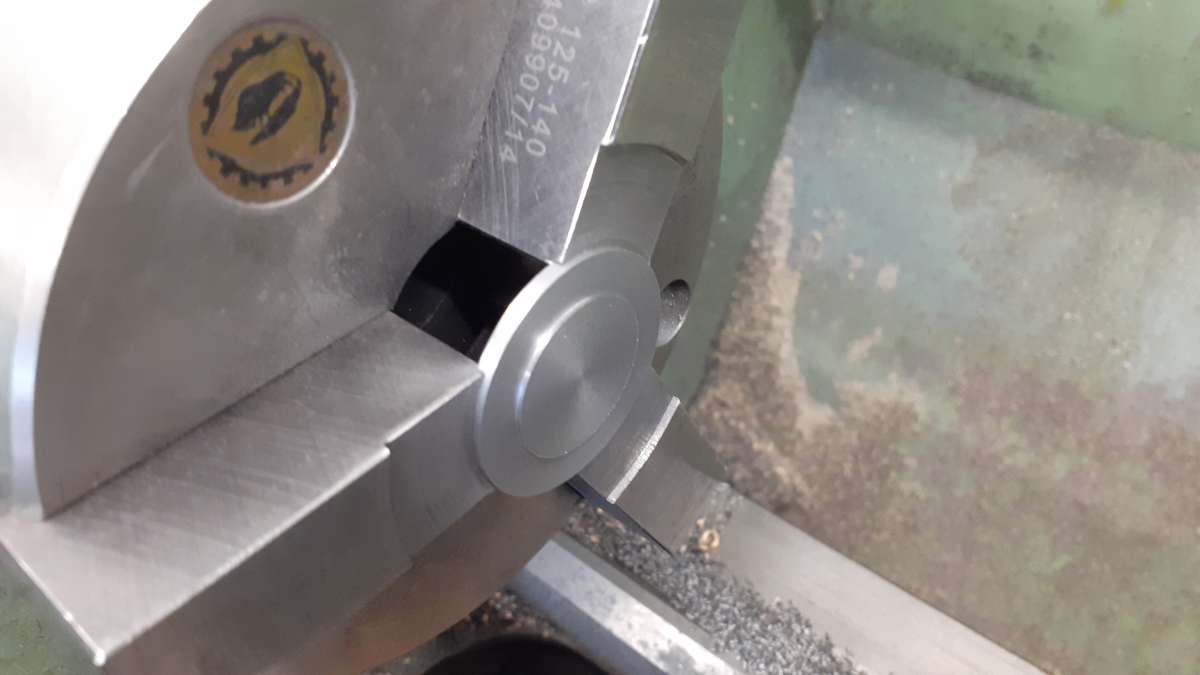

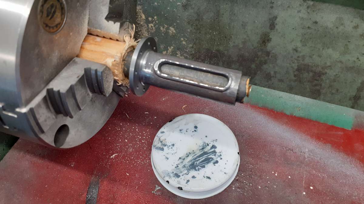

                                  Lap made from a simple wooden dowel coated on 600g silicon carbide powder and oil
                                  20240621_105427

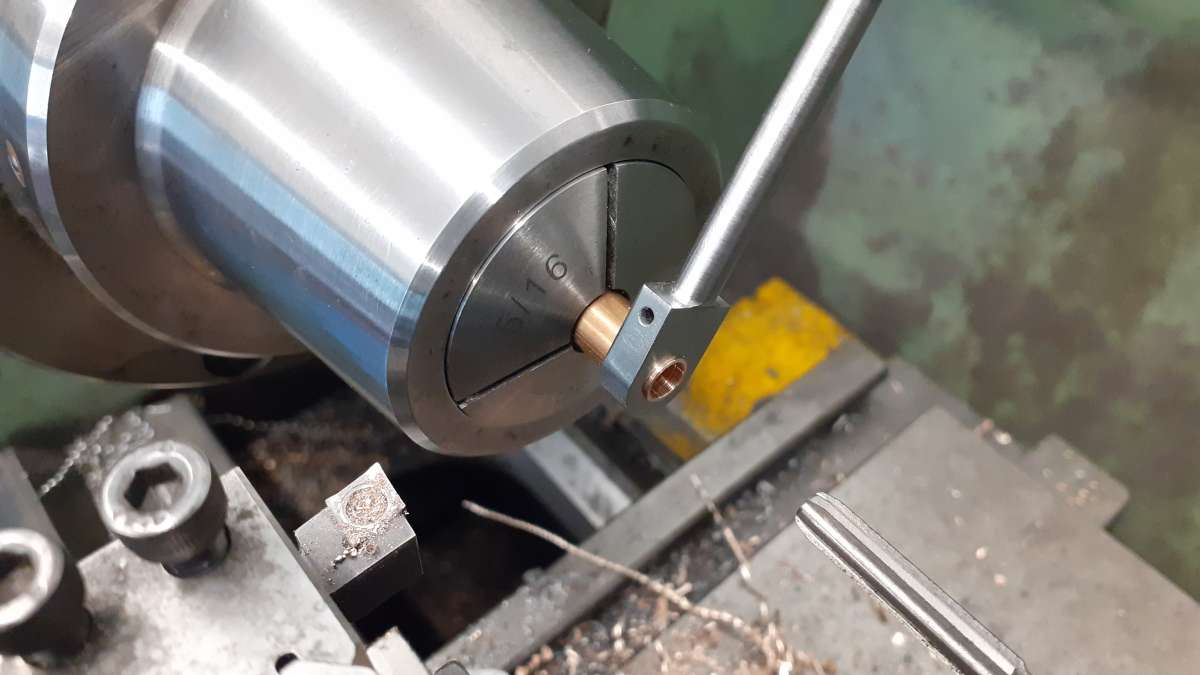

                                  Turning back cover spigot to fit trunkguide
                                  20240621_112017
                                  Test fitting
                                  20240621_112027

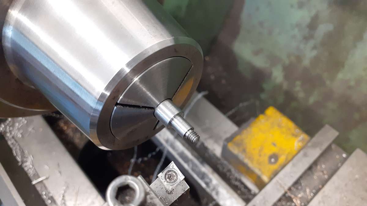

                                  Reming piston rod hoel ofter spotting and pilot drilling
                                  20240621_112729

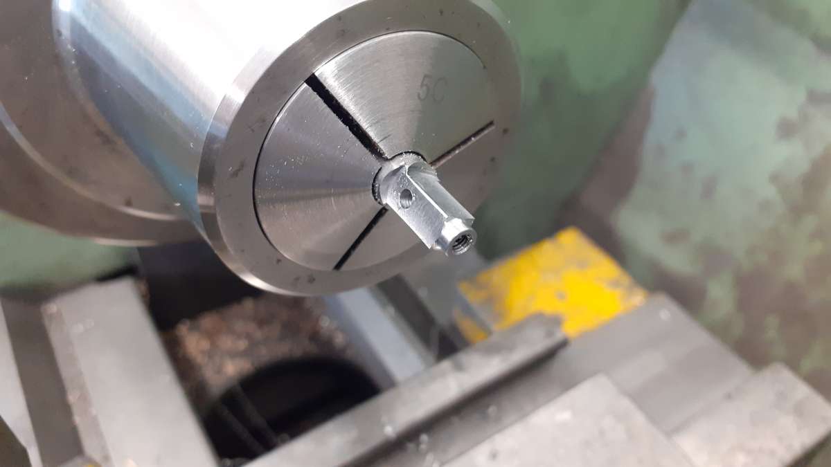

                                  Front cover spigot being turned using softjaws to hold thin work without wobble
                                  20240621_115253

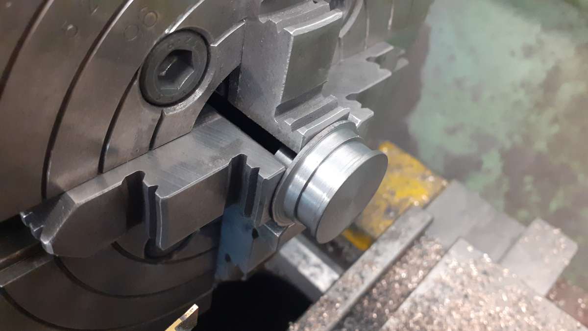

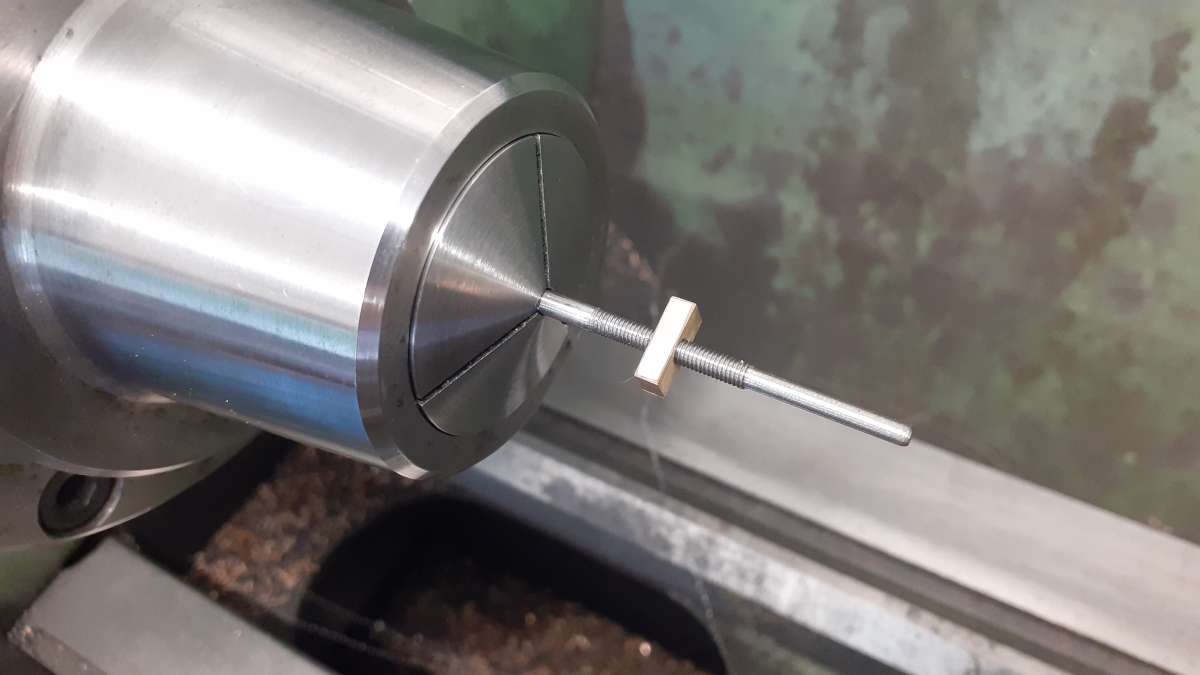

                                  #849161

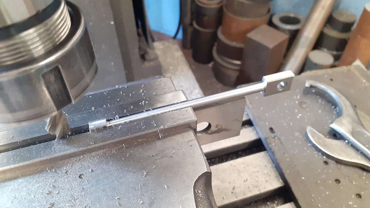

                                    testing the nut on the valve rod thread
                                    20240627_092745
                                    Turning the end of the clevis and threading.

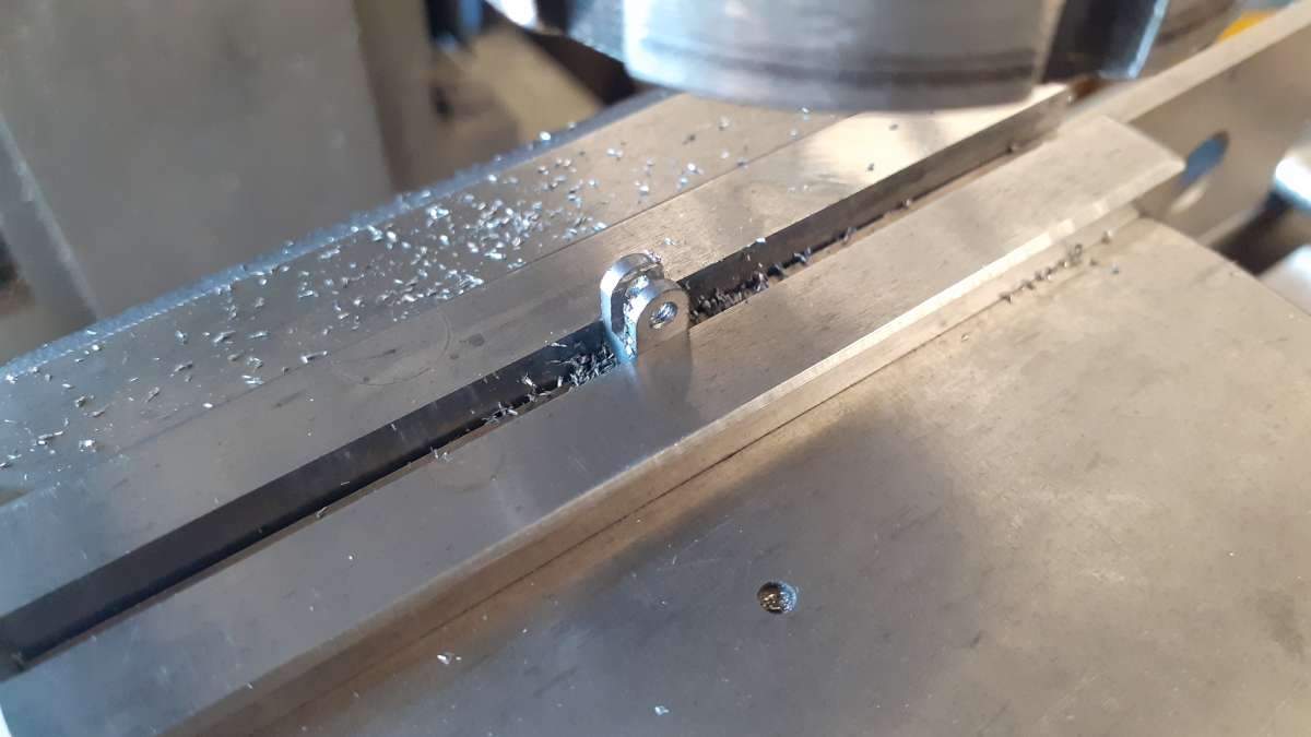

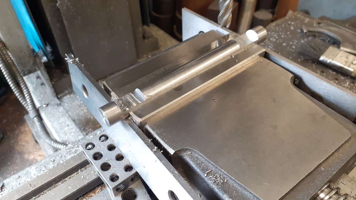

                                    20240627_103546
                                    Milling the slot in the clevis
                                    20240627_111129

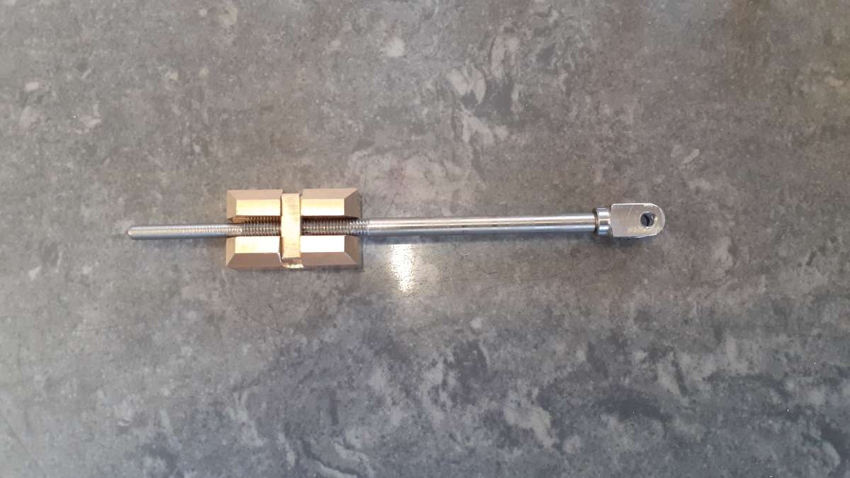

                                    Completed valve parts

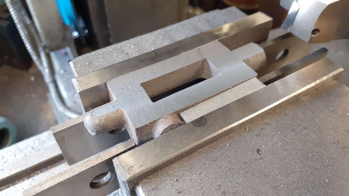

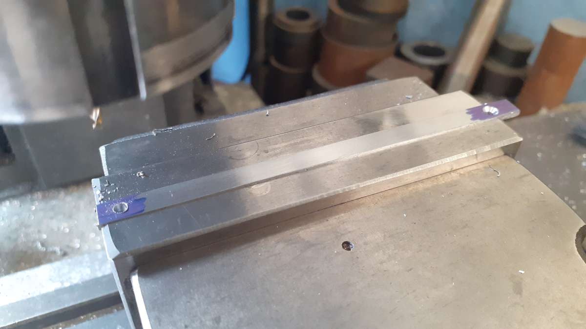

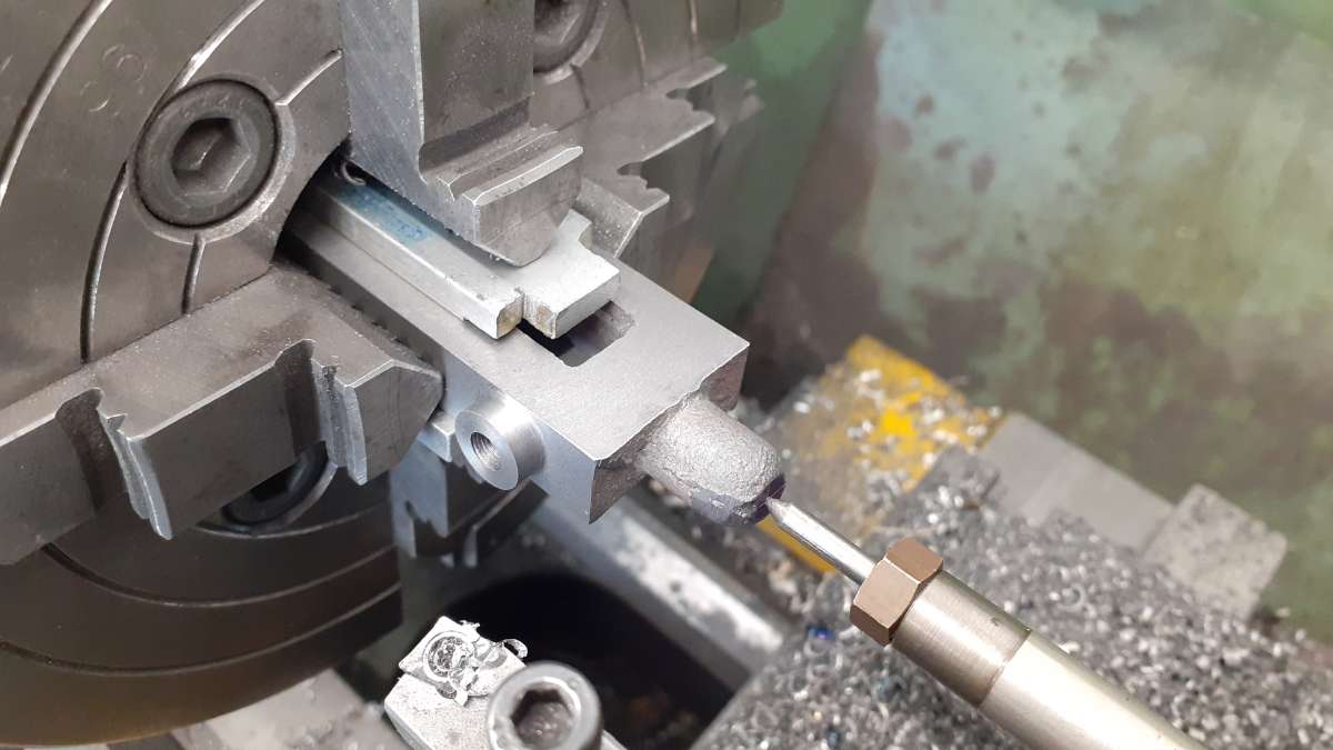

                                    20240627_111413

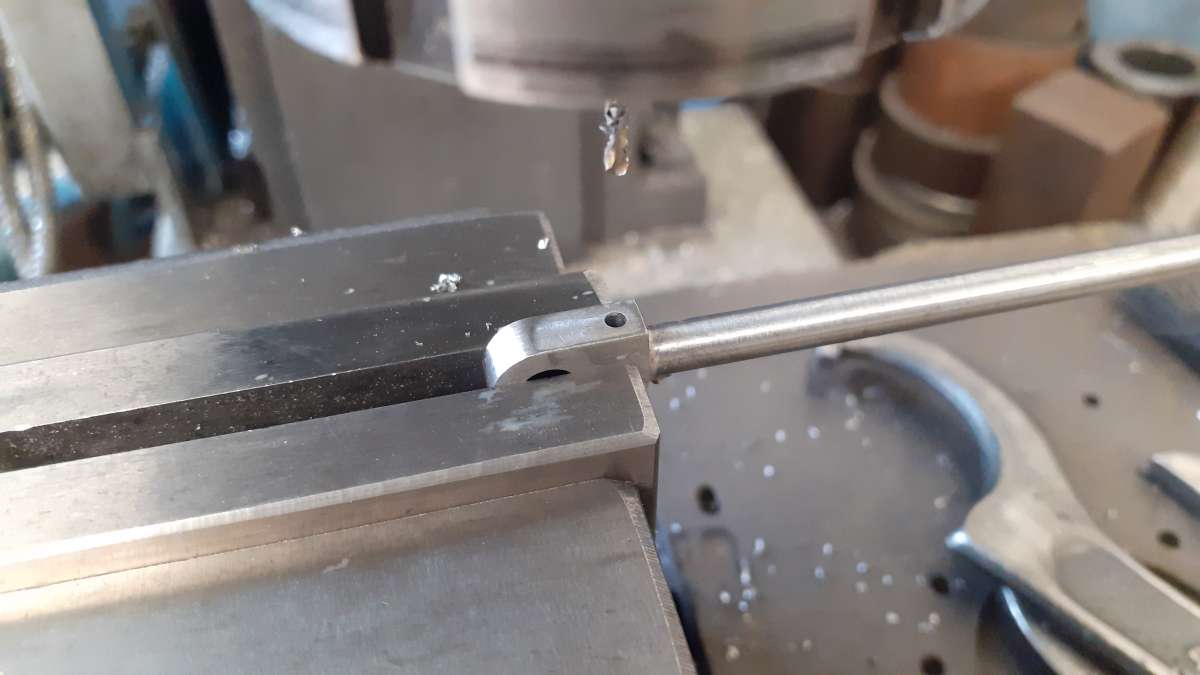

                                    Making a start on the rectangular end sof the conrod
                                    20240705_141532

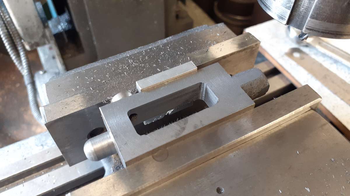

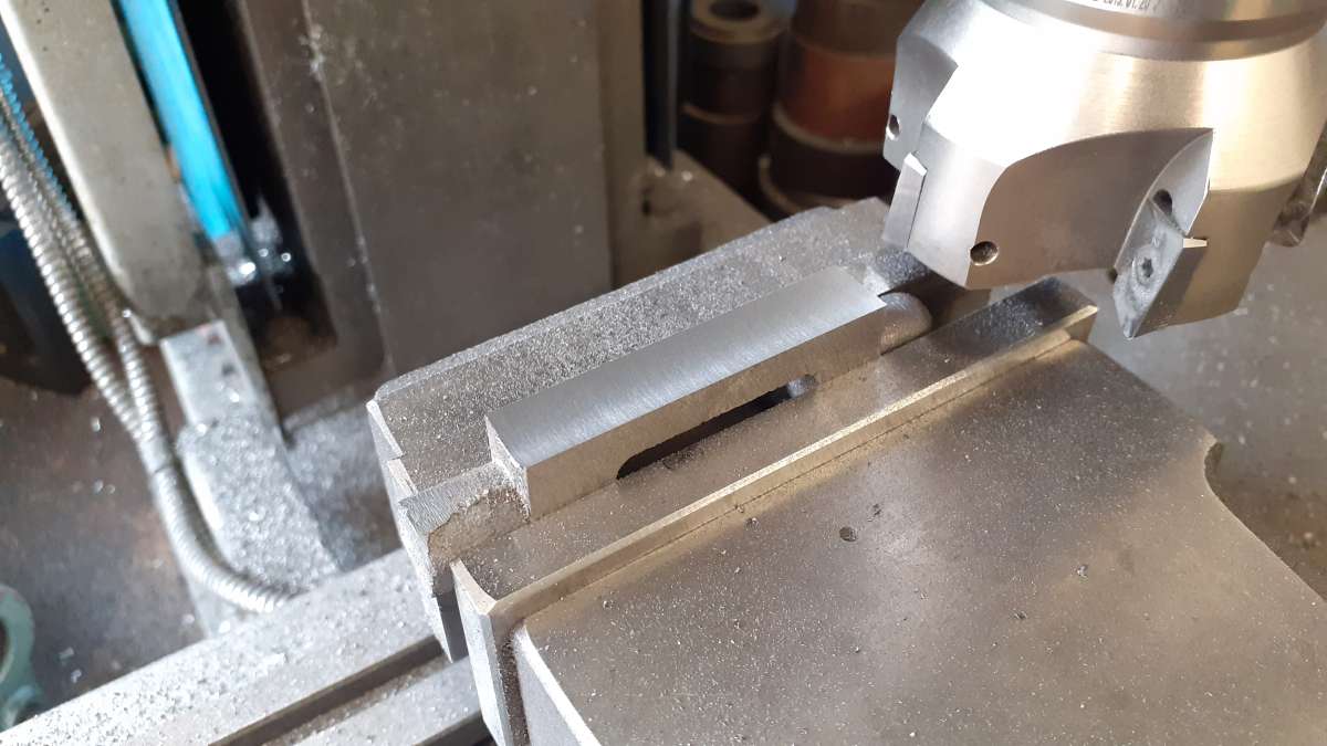

                                    Milling to width after turning
                                    20240706_135538
                                    Adding the dummy bolt hole
                                    20240706_141952
                                    Test fitting the bearing in it’s hole
                                    20240706_143115
                                    Working on the crankpin
                                    20240706_145507
                                    #849258

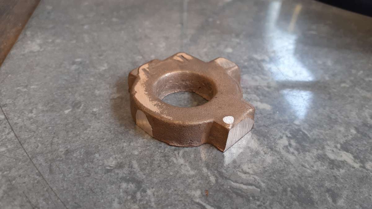

                                          Anyway on with the additional images, this time related to the eccentric parts.
                                          The raw casting.
                                          20240629_133417
                                          Cleaning up the first side before reversing in the chuck to do the other side

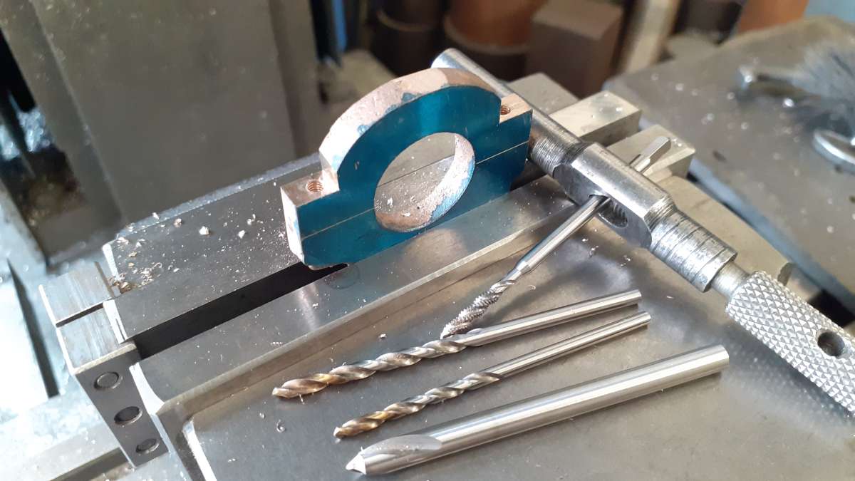

                                          Spot drill, tapping drill right through, clearance drill part way and thread
                                          20240629_143829

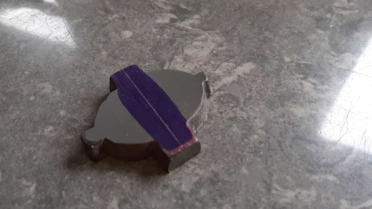

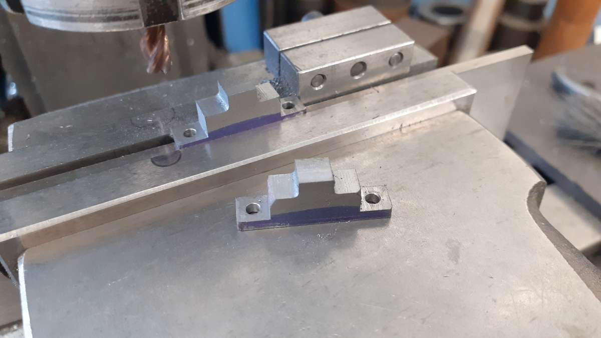

                                          Sawing in half
                                          20240629_144558

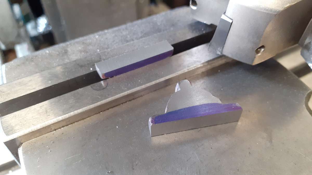

                                          Cleaning up sawn edges
                                          20240629_145038
                                          Clocking the dubby ctr location to run true. Masking tape to stop parallels falling out a schuck is rotated by hand. REMOVE parallels before machining.
                                          20240630_084457
                                          Making a start on machining the outside
                                          20240630_092831
                                          Pocket for the rod

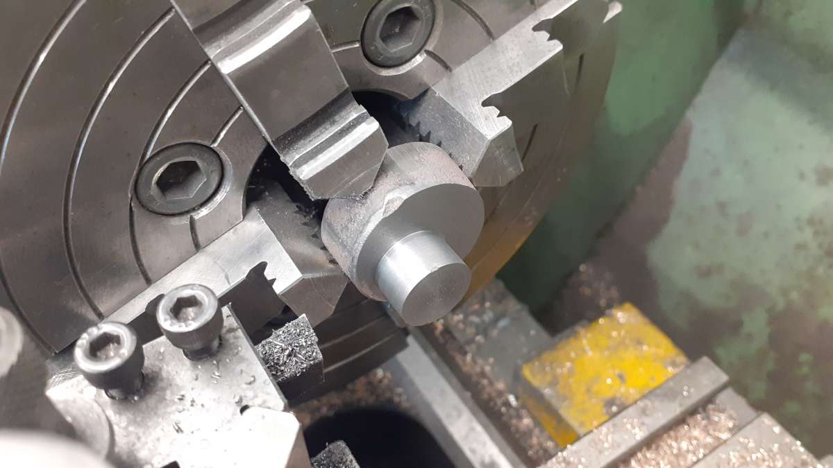

                                          20240702_141156

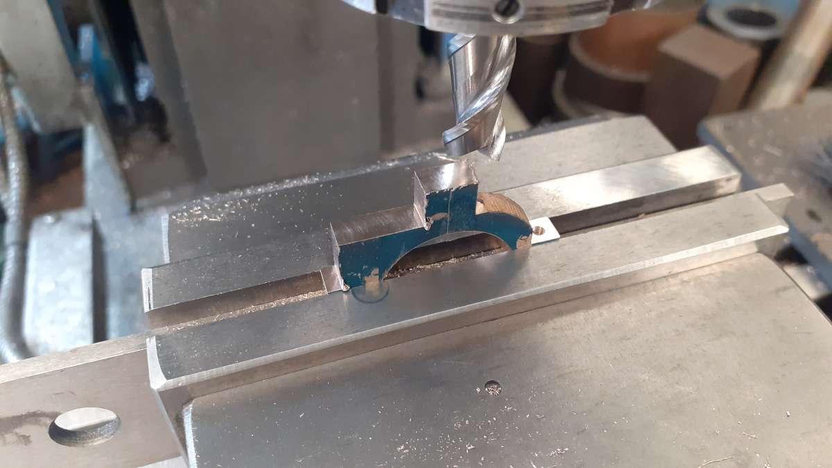

                                          #849283

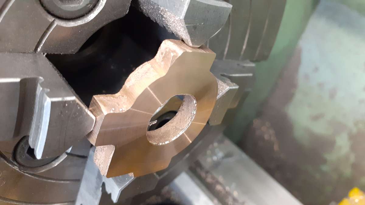

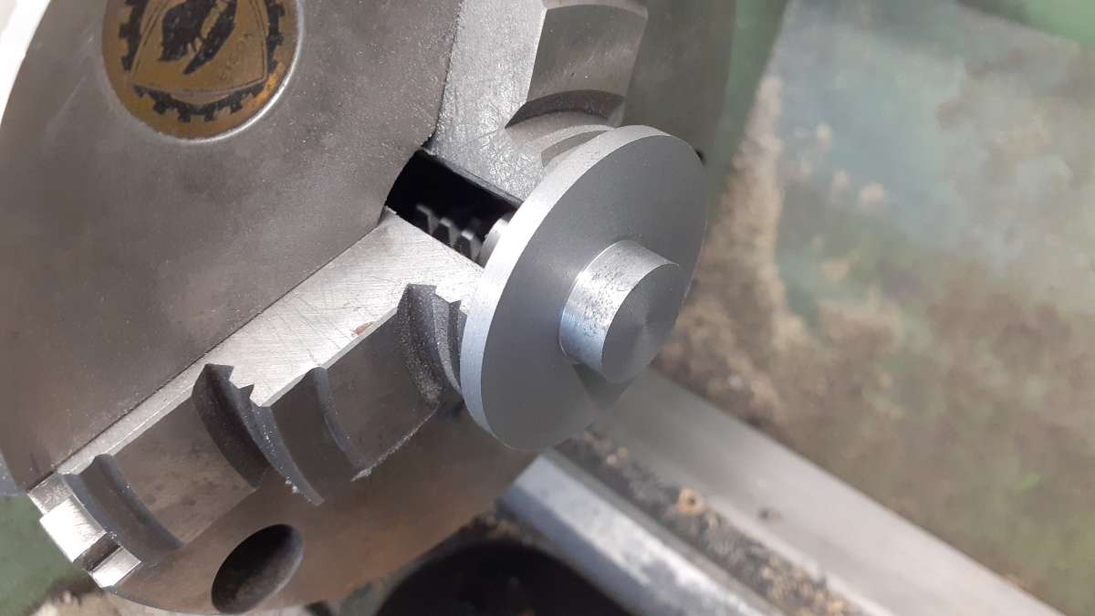

                                            Cleaning up the eccentric’s spigot
                                            20240630_110726
                                            Now with something decent to hold the eccentric can be turned
                                            20240630_113724

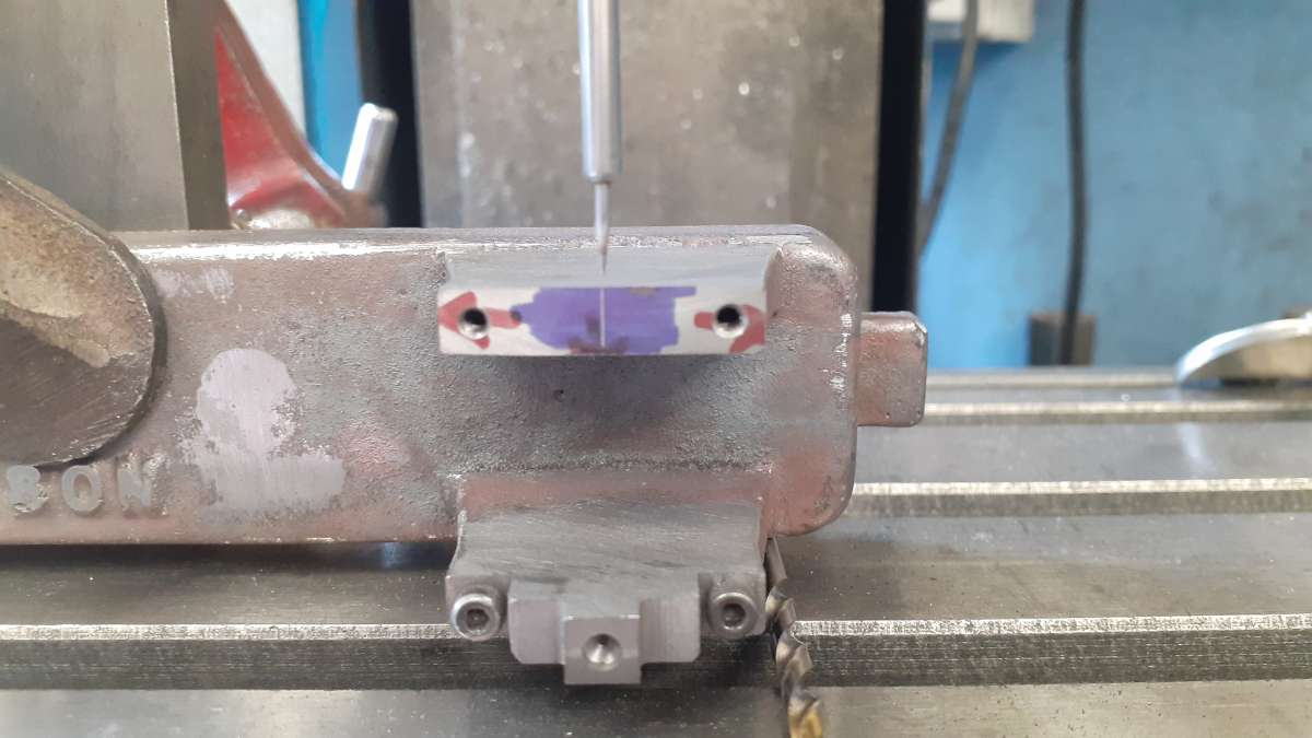

                                            Transfer chuck to the mill, locat ctr and then offset by the throw, spot – drill – ream
                                            20240630_115631
                                            Hold on arbor to finish the spigot and back face of the eccentric
                                            20240630_122137
                                            Drilling the holes in the end of the rod
                                            20240703_135140
                                            Drill bit sin hole sto support rod at required angle
                                            20240703_140734

                                                There are many ways to find an edge and many tools that can be used to do so.
                                                20240612_140716
                                                In the photo I am using an electronic edge finder which lights up when the end of 0.200″ diameter touches the metal and completes the circuit making it light up. Not quite clear but I am touching the vertical sid  sof the casting with the edge of the cylindrical end of the finder.
                                                By touching on one side and noting th ehandwheel reading (or zeroing a DRO) and then touching the opposite side to get a second reading. You can then half that distance to determine where the centre is.
                                                You can also locate an edge but touching against that, zero teh handwheels and then you know the ctr of th espindle is half the diameter away from the edge .
                                                Other edge finders kick off to one side when the spindle is half their diameter from the edge. Or you can just use a piece of metal of known diameter such as the shank of a cutting tool. Bring that upto the edge until it just grips a piece of thin Rizzla (cigarette) paper.

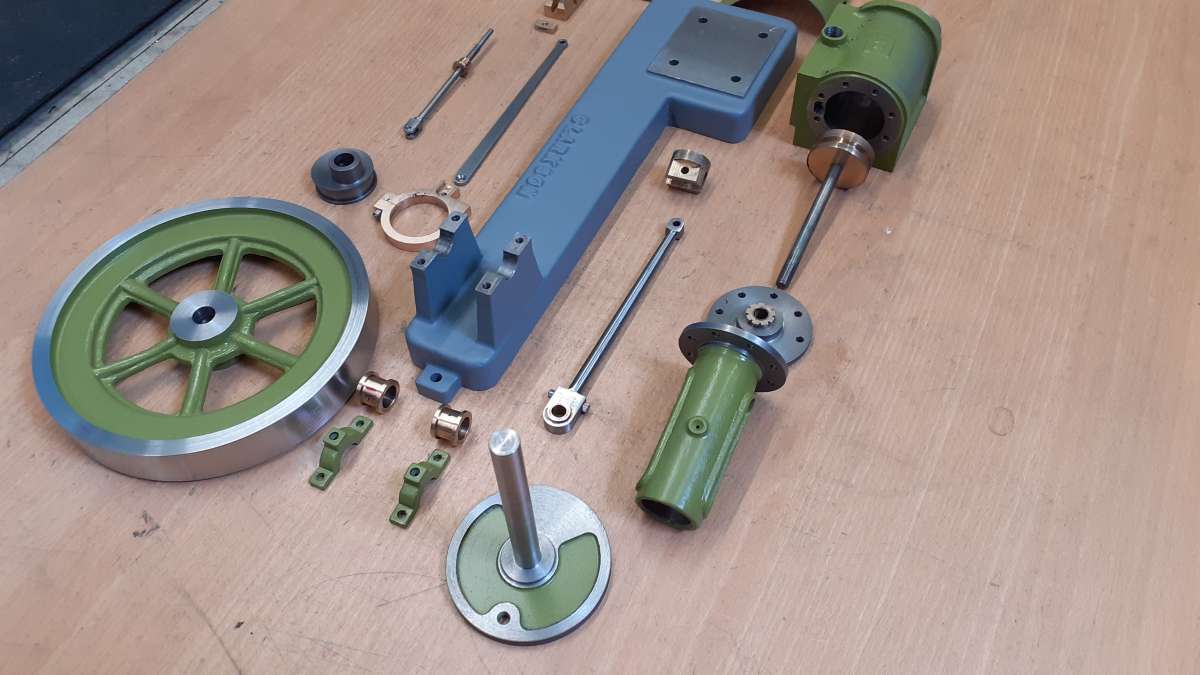

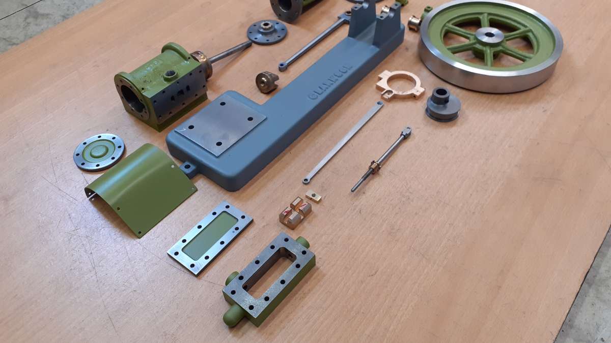

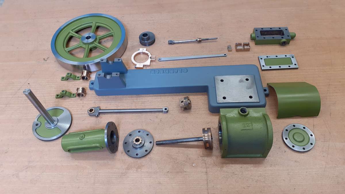

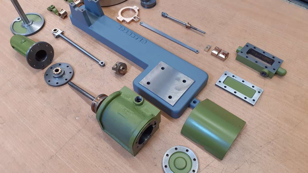

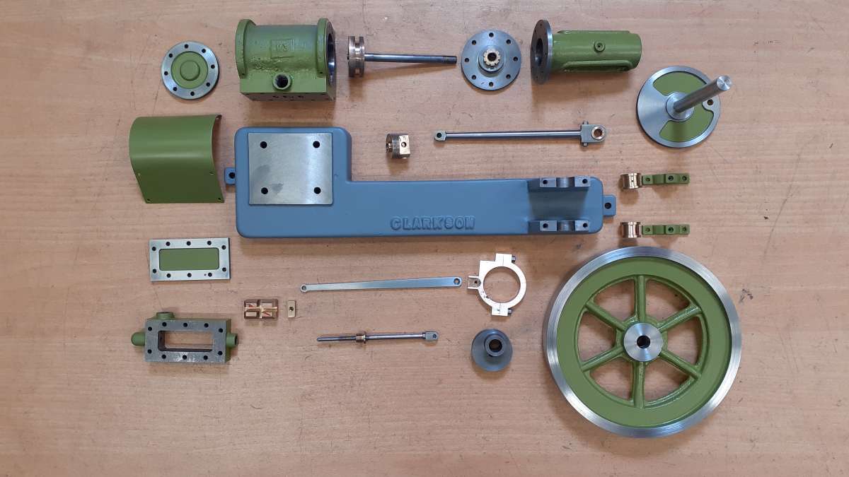

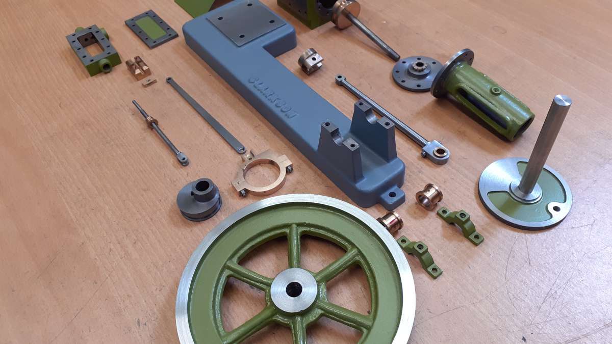

                                                  It looks like I used all the photos that I took of the various items covered in the last part of the series so won’t be posting any of parts being made.
                                                  I do have a few more view sof the painted parts prior to final assembly so here they are.
                                                  20240713_143400
                                                  20240713_143429
                                                  20240713_143437
                                                  20240713_143447
                                                  20240713_143453
                                                  20240713_143506

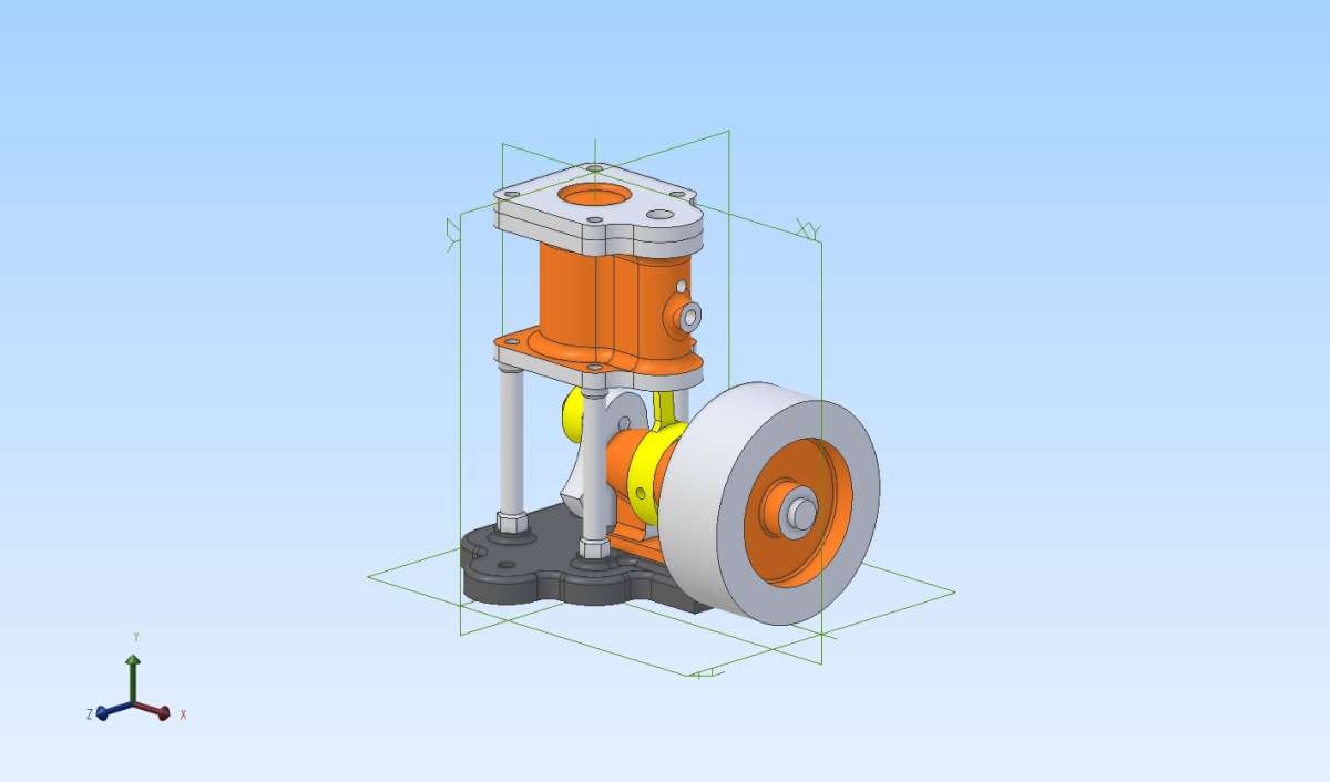

                                                  I did subsequently make the vertical version and am just waiting to hear from Editor Neil if he has future space in the mag for an article about that. It won’t be a full build but just concentrate on the different castings eg box bed, standards, trunk guide and part of the clinder. If there is no room at the inn, I will post it on the forum. There is also another set of Clarkson drawings on their way to me for what must be quite a rare engine as I have never seen it in the flesh or even a photo.
                                                  #853154

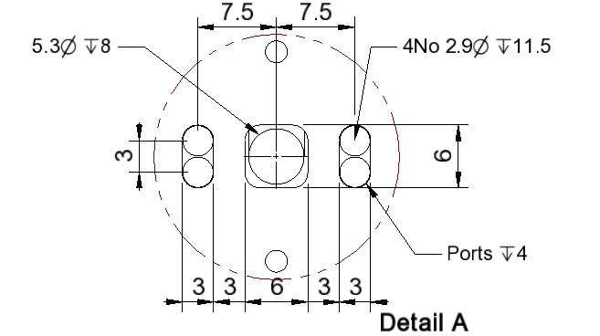

                                                    A reader ha spointe dout a couple of error son the published drawings. It seems most of these relate to an older version of my drawings being published rather than a subsequent revison.
                                                    Blackgates have the revised drawings so anyone buying castings from them should not have a problem but below are a few screen shots from the latest revison that cover the points raised, some of which have already been covered in this thread.
                                                    Base casting, hole for bearing should be 10mm diameter to match the bearing and cap.

                                                    Cylinder oval ports shown with a diameter symbol which should have been a depth arrow indicating they are 4mm deep not 4mm dia. the other dimensions of the oval shape are still correct at 3mm x 6mm.
                                                    Not mentioned by the reader but the exhaust passage is now shown as 5.3mm dia not 4.5. Don’t worry if you have already drilled it 4.5mm as that still gives a cross section greater then that of the two 2.9mm holes from the cylinder.

                                                    The original Clarkson eccentric without a boss was shown but the boss on the casting should be used as it stops the crankshaft freely moving sideways. 25mm OD not 26 as mentioned in the text.
                                                    clark rev c
