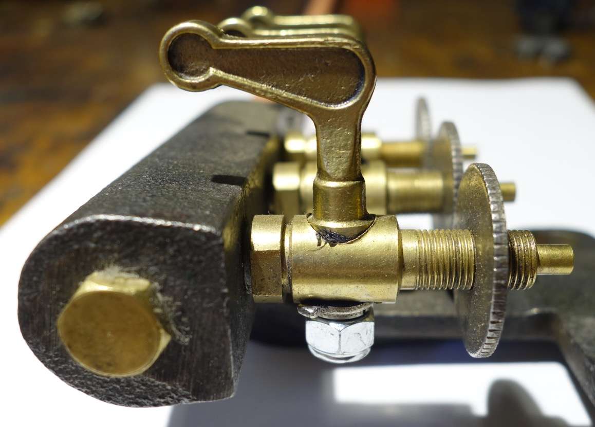

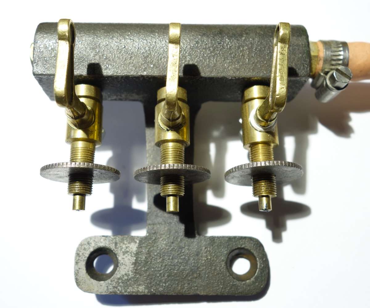

      Hi, I’m new here so please bear with me. I thought this should perhaps be be under Help of Assistance, but though it best to start here.
      Vintage three ring burner.
      Gas Tap Valves.
      I’ll get right into it…

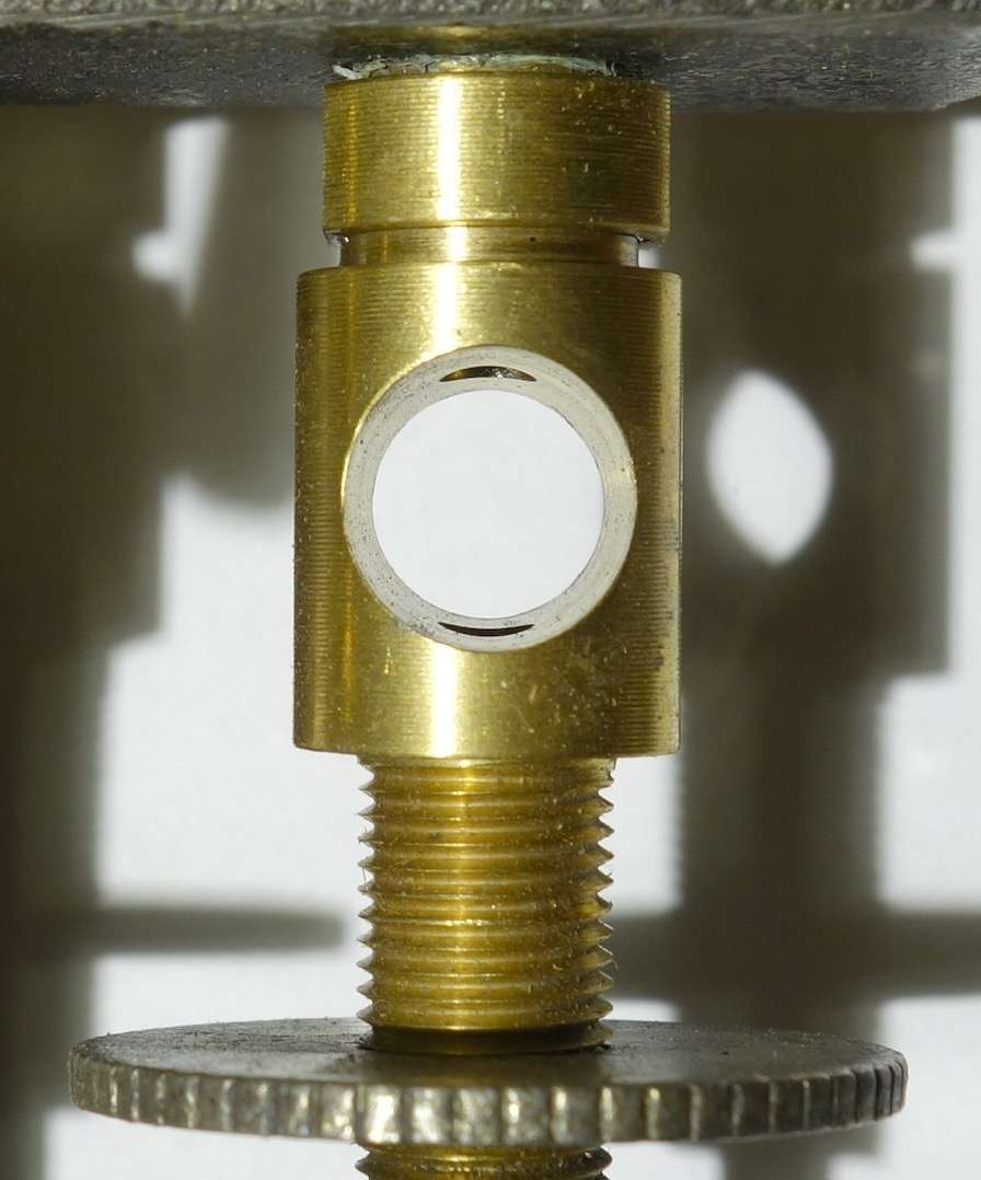

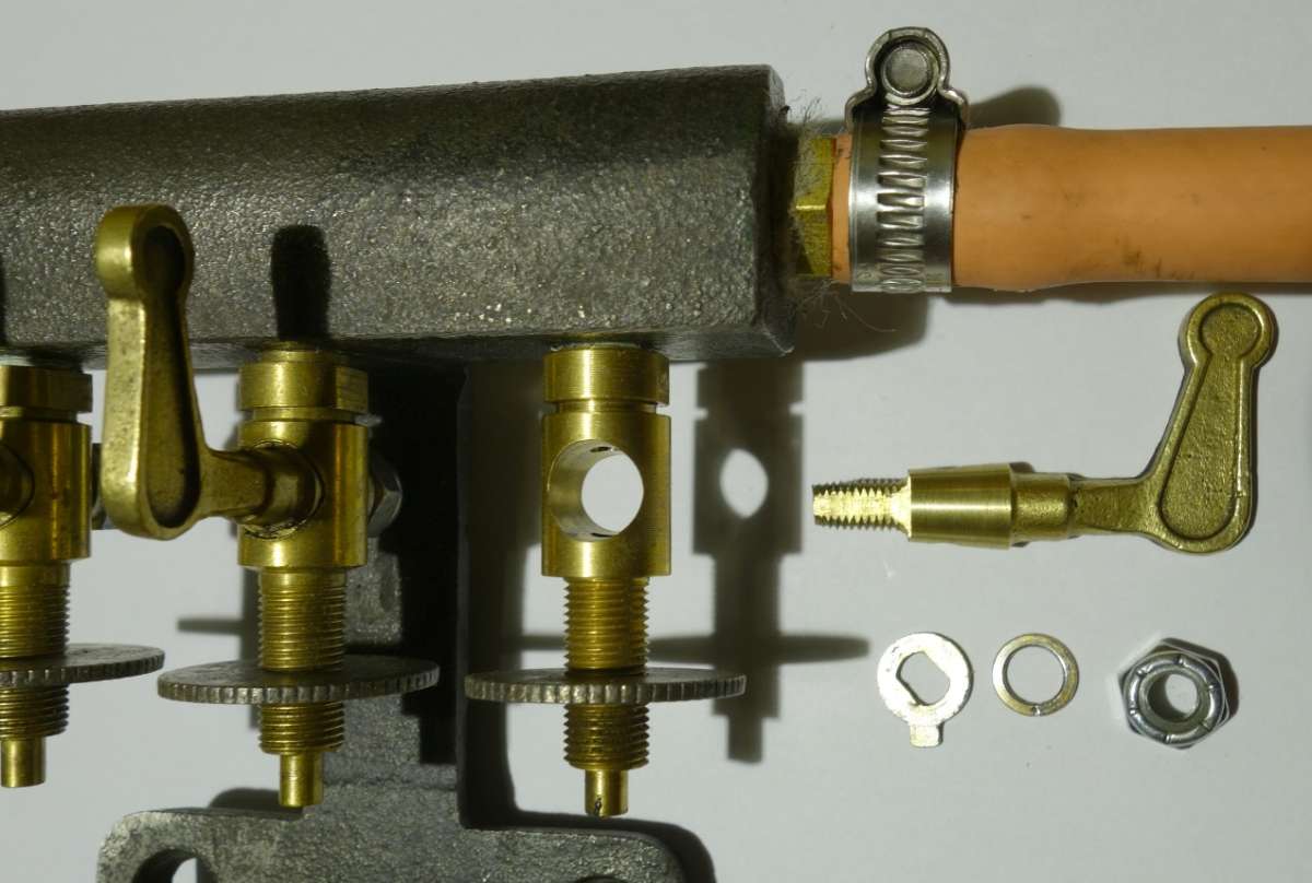

      The valve barrels with their tapered tap valves, are what I’m looking to find a solution for. One of these had snapped off at the valve bracket. Fortunately, knowing a few folk in the business, some friends were able to machine up a replacement brass barrel in their spare time. Fitting the existing male taper ‘key’ valve to the new female taper has been the challenge. That part is machined, I’m now looking to find how to get the tolerances of the whole tapered valve/s to slip fit perfectly.
      The construction of the valve is a brass barrel with a tapered hole into which the male tapered ‘key’ valve fits to create a gas tight fit. This is operated between on and off through a 90˚motion. This ‘key’ valve is held in place with a UNF1/4 thread, a tag washer, a spring washer and captive nut.
      A 1/15 ratio reamer taper which is a taper of approximately 3.8˚ from the axis, was used to form the new barrel taper, but these are approximations that I do not have the metrology to attain exactitude, and have yet to find how to make the slight discrepancy of taper angles between old and new, slip fit to tolerance. I have tried various specialist gas related sealers/ lubricants and tapes which have improved matters, but a tiny amount of play is still present.
      Forming ideas for the slip fit went as follows: some lapping paste, maybe >400grit, but the thinking was that that would ultimately deform the planes of both conical tapers, abrading the old as well as the new, deforming the original reference. On to the next idea!
      The next idea was to temporarily glue (with bearing retainer) emery paper to the ‘key’ tapers which are original and in good condition, having no light coming through on a flat test of their planes, these could be ‘former’ to the newly machined barrel taper. The difficulty was that emery paper could not be gotten thin enough to reach the lower, narrowest part of the new barrel taper hole in that arrangement. This re-profiling using the ‘former’ idea was done by hand, concentricity was a concern, but after several sessions of minute material removal, this did make a difference improving matters. Once assembled the leaks had reduced to small ‘buds’ when ignited, but not gas tight, and as you might conclude, that’s not acceptable. The relative height of the key tapers in operating situ and making these tapers deeper or altering the original ‘key’ tapers in any way did not seem wise, so the project was shelved.
      The narrow taper ø is 8.9mm probably aiming for 11/32″, the wider taper ø is 10.4mm engineered for 13/32″ across 1/2″
      My lack of equipment to accurately measure and then hone (if thats the right word) very particular conical taper angles is the challenge. With the right equipment, it’s a twenty minute task for three valves.
      A full length male taper without the hole of the original, with the exact same angle with an even abrasive applied that could fit in a chuck, was as far as my thinking got.
      This is the last hurdle on the restoration, which I would really like this not to become a door stop!
      So here I am, hopping to impress upon some one with more experience than my self what the solution may be to getting these taper valves gas tight?

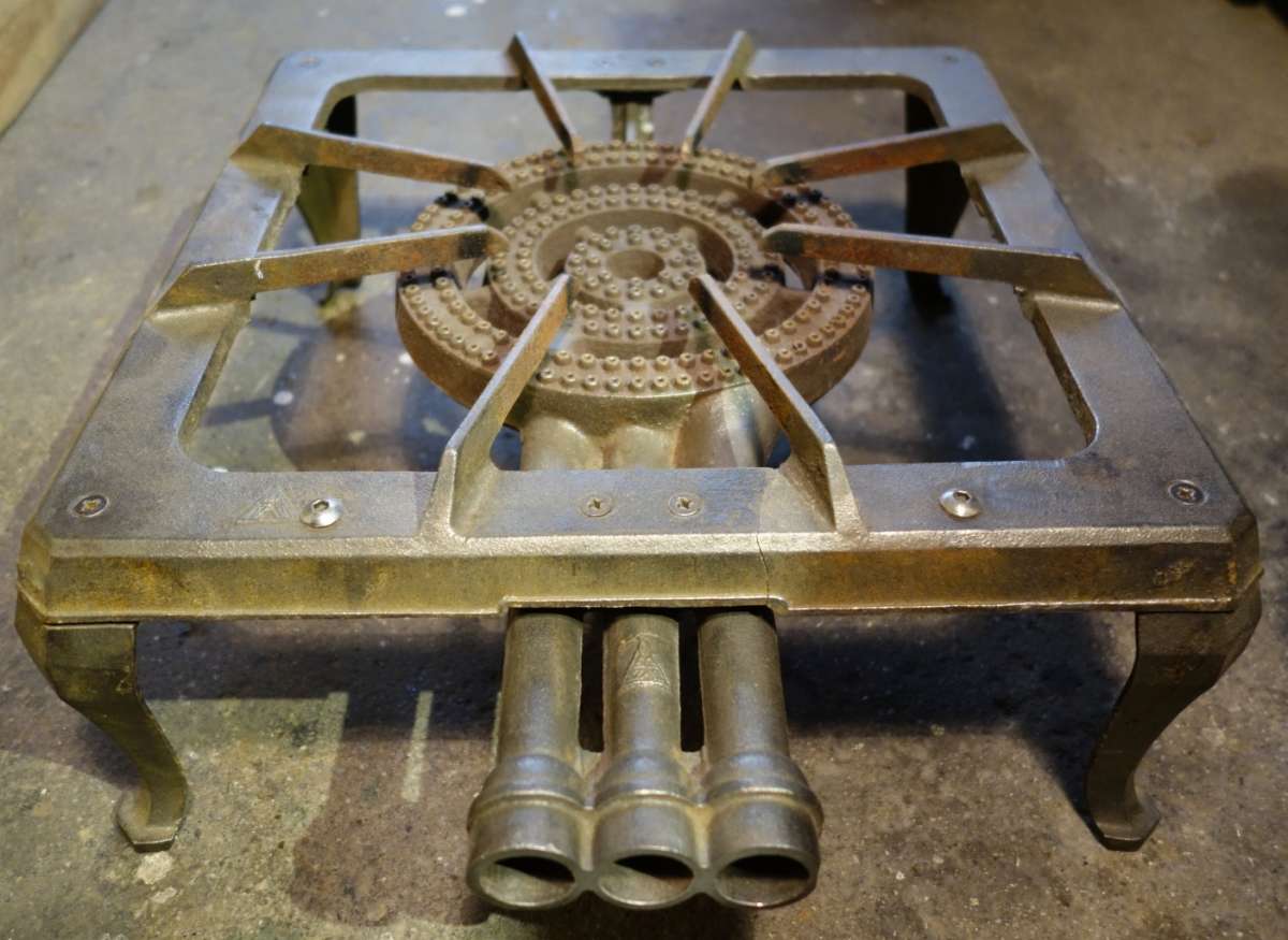

      General assembly:
      Frame 18″ cast
      Burner, cast
      Valve bracket, cast
      Valve barrels, brass
      B

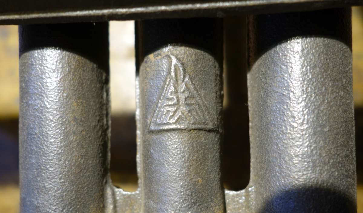

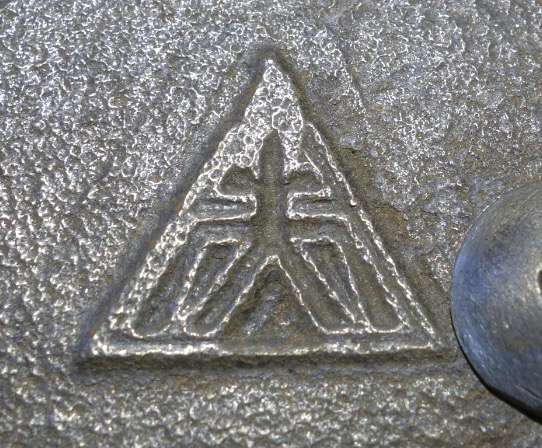

      Foundry Logo?, manufacturer unknown
      C
      As you can see most of the work is done, it’s no longer a ball of orange rust. It now stands. It blows clear, it has valves and all leaks have been identified and sealed with the correct compounds.
      D
      E
      F
      This is the new valve internal that requires a slight internal re-profiling as mentioned above:
      G
      The air intake/ oxygen mix adjusters are quite loose due to being thin, I think 1/6″ from memory, they have a habit of rusting up.
      They could do with being 1/8′ thick in brass with a interference fit for stability, this would complete the refit.
      #852614
      Diogenes
        @diogenes
        EDIT – aha, now there are pictures – not sure how useful the info below will be..
        Usual way of dealing with these sort of jobs is –
        At the same time as new male pintles/tapered valve inners are made, a blank for a reamer should also be turned-up; i.e. at the exact same topslide setting – this can then be milled to just below the centre-line to produce a ‘D’ reamer that will produce a seat for the valves. I’d make it in silver steel and then harden it – it can then be stoned and polished with the objective of giving a satisfactory finish to the seat.

            First of all, try using engineer’s blue, or a blue or black spirit-based marker pen, to find out where the components are actually touching, e.g. at the wide end, narrow end, just in patches, etc. The best course to follow rather depends on what you find.
            I’m presuming the ‘keys’ are original – do you know whether the tapers on them are in good condition?

                There is no way to make a gas-tight seal between two mismatched tapers without proper workshop equipment. Give up while you are ahead before you have an explosion from leaked gas.

                  You have the existing male valve. Mount that in a lathe*, dial it in true, copy its taper onto a suitable lap and finesse the new female taper.
                  I think the same design is used in steam fittings, so past writings from this hobby would show you some ideas (see searchable magazine index).
                  Commission your business associates to make another barrel on which you can refine your technique. Or borrow the reamer and make the initial tapered hole yourself on a piece of scrap.
                  Minimal equipment – the same dial indicator used for concentricity is used for taper copying.
                  Tapers rarely need measuring, but often need matching.
                  The nylok nuts on the tapers may be inappropriate for a hot environment.
                  I suspect you may be using ‘vintage’ in the eBay sense. As you can see above, they are univerally called a ‘boiling ring’.
                  * because of the handle it is difficult to hold. Hot glue lumps of wood to it and use four jaw chuck.

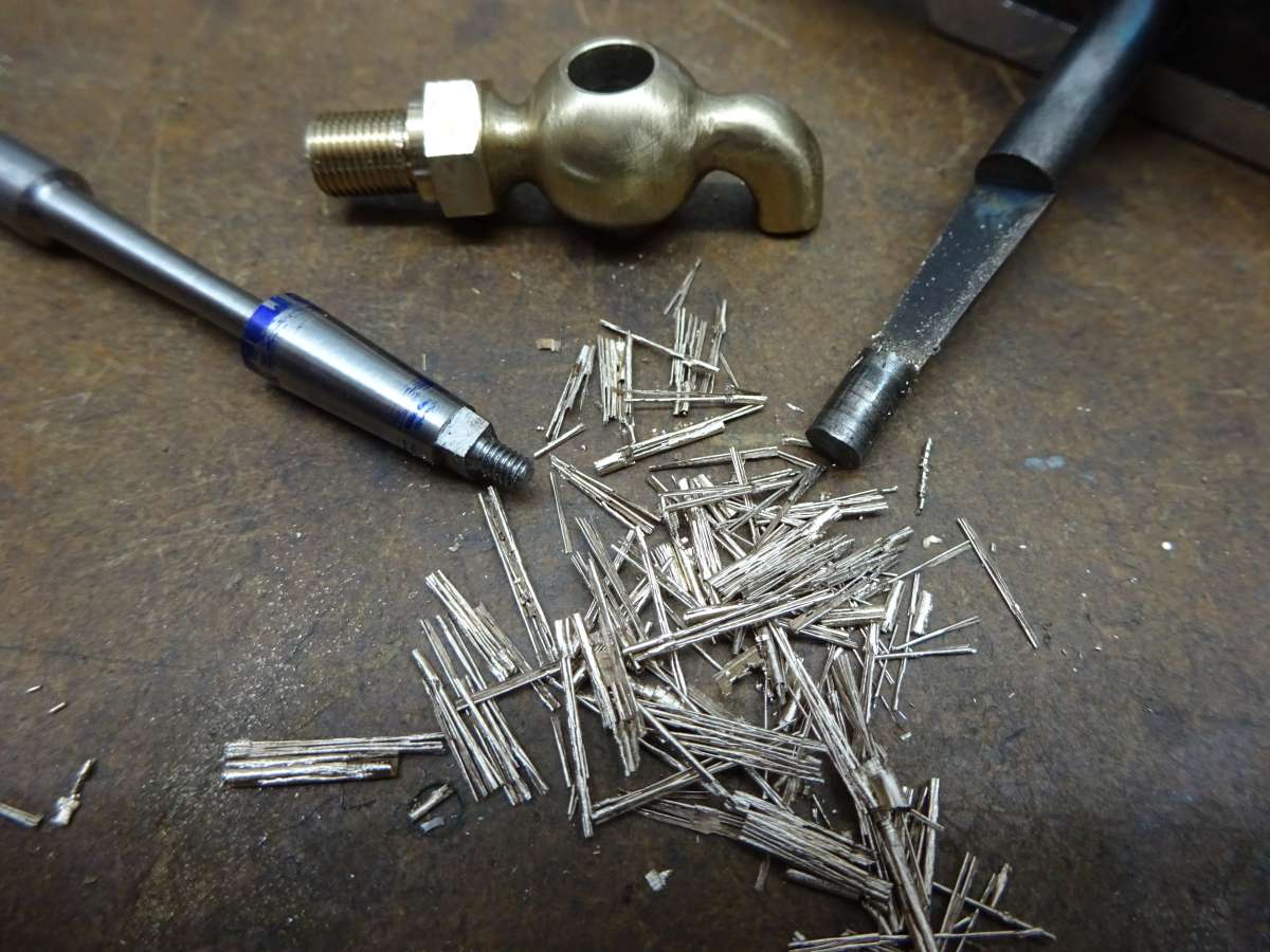

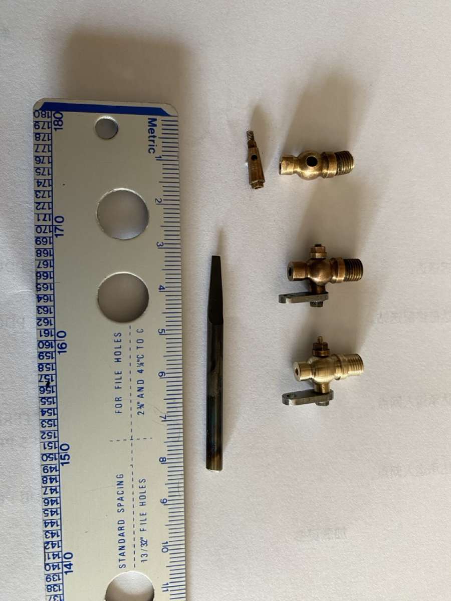

                  #852640
                  Speedy Builder5
                    @speedybuilder5

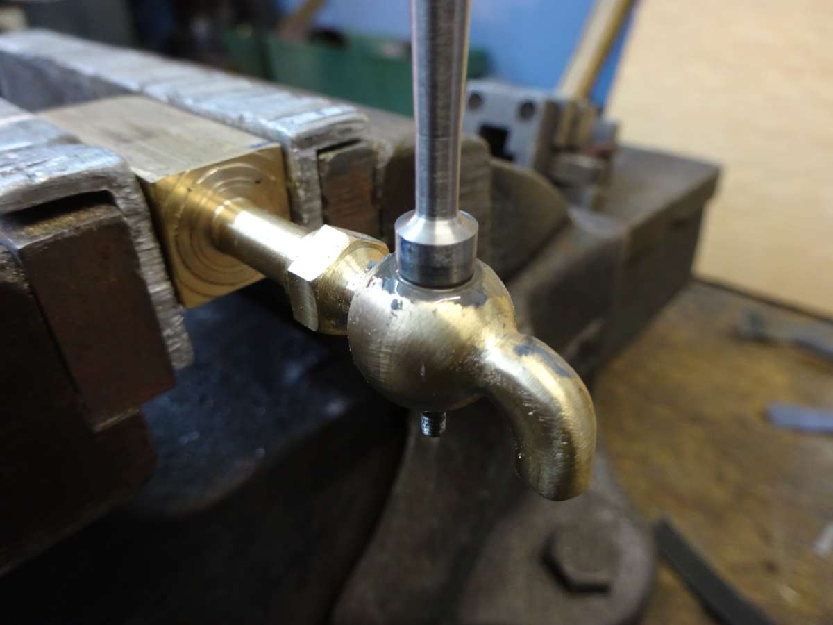

                    Dee, here is one I made earlier, just over 1 cm long, shown with the ‘D’ bit reamer.
                    Drain Cock Build Large
                    #852641
                      Although skimming the cocks and making a reamer at the same setting to recut the valve bodies is the way to do it, I am not sure there is enough metal to do so. Looking at the OPs photos the cock’s taper is already right down into the valve body and due to the taper ratio only a small amount taken off will see the cock go a lot further into the taper.
                      A taper reamer in action
                      DSC00511
                      Final lapping of teh cock into the valve
                      DSC00514

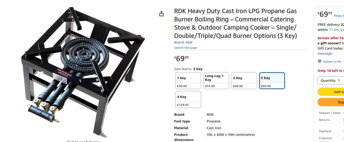

                        You have made no indication of the use of this burner. In the UK there are safety regulations around gas equipment maintenance. Even if it is running off bottled gas doing work for someone else, even unpaid, will almost certainly leave you liable in the case of a incident and may be an offence in itself. You need to carefully consider your position. Bizarrely despite being primarily an aerospace electronics engineer, I’m trained and registered to work on hydrogen systems. But i am not allowed to service my own gas water heater…..

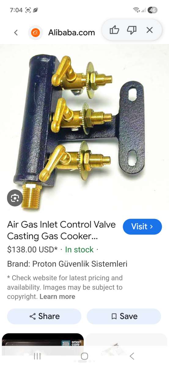

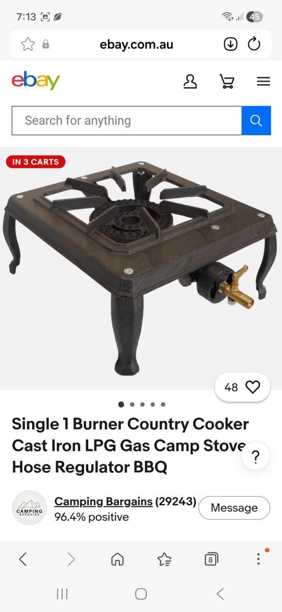

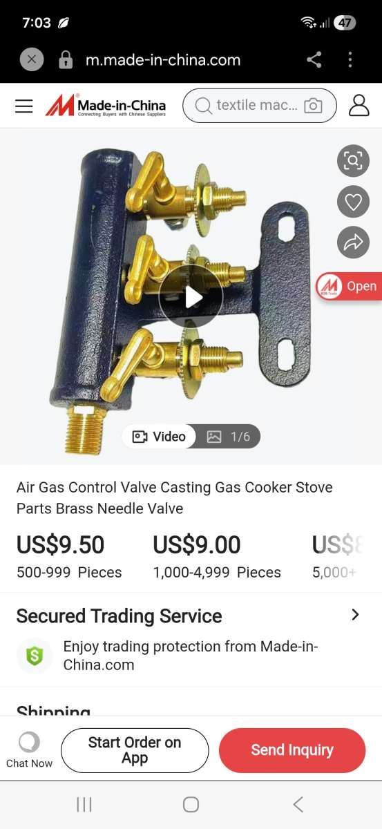

                          Safer to buy new valves, available on eBay, Aliexpress, Alabama, Made-in-China.com.
                          These burners complete are often listed as “country cooker”. Or camping stove or burner etc. China appears to be still churning out these vintage burners. If they work  why change it?
                          Screenshot_20260619_190431_Google (1)t9fjmt3u3r0zldj0plku2qj6acjpiu1kScreenshot_20260619_190308_Samsung Browser

                            Screenshot_20260619_191337_Samsung Browser

                                        On the other hand, I wouldn’t be to averse to buying in new China-made valves. The foundry mark on Dee’s original looks very Chinese to me.
