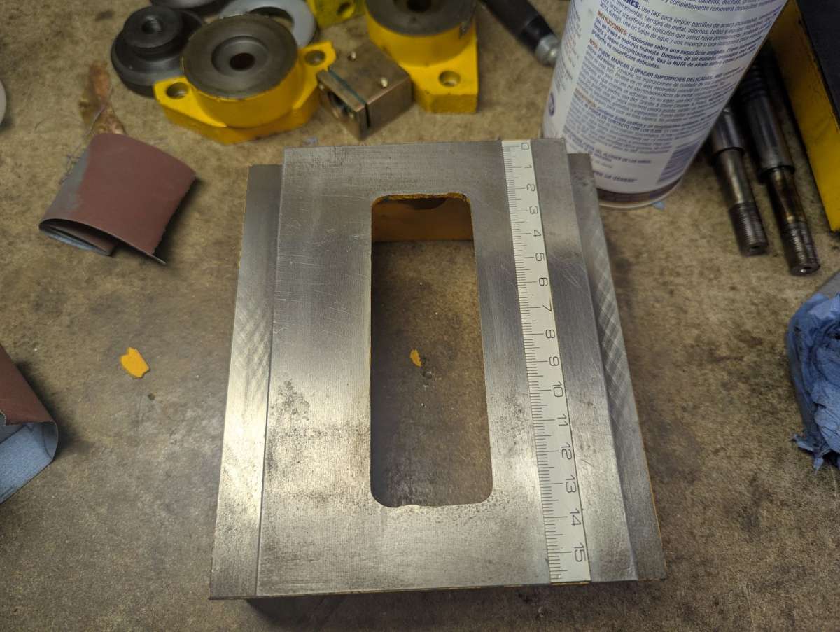

      Hello,

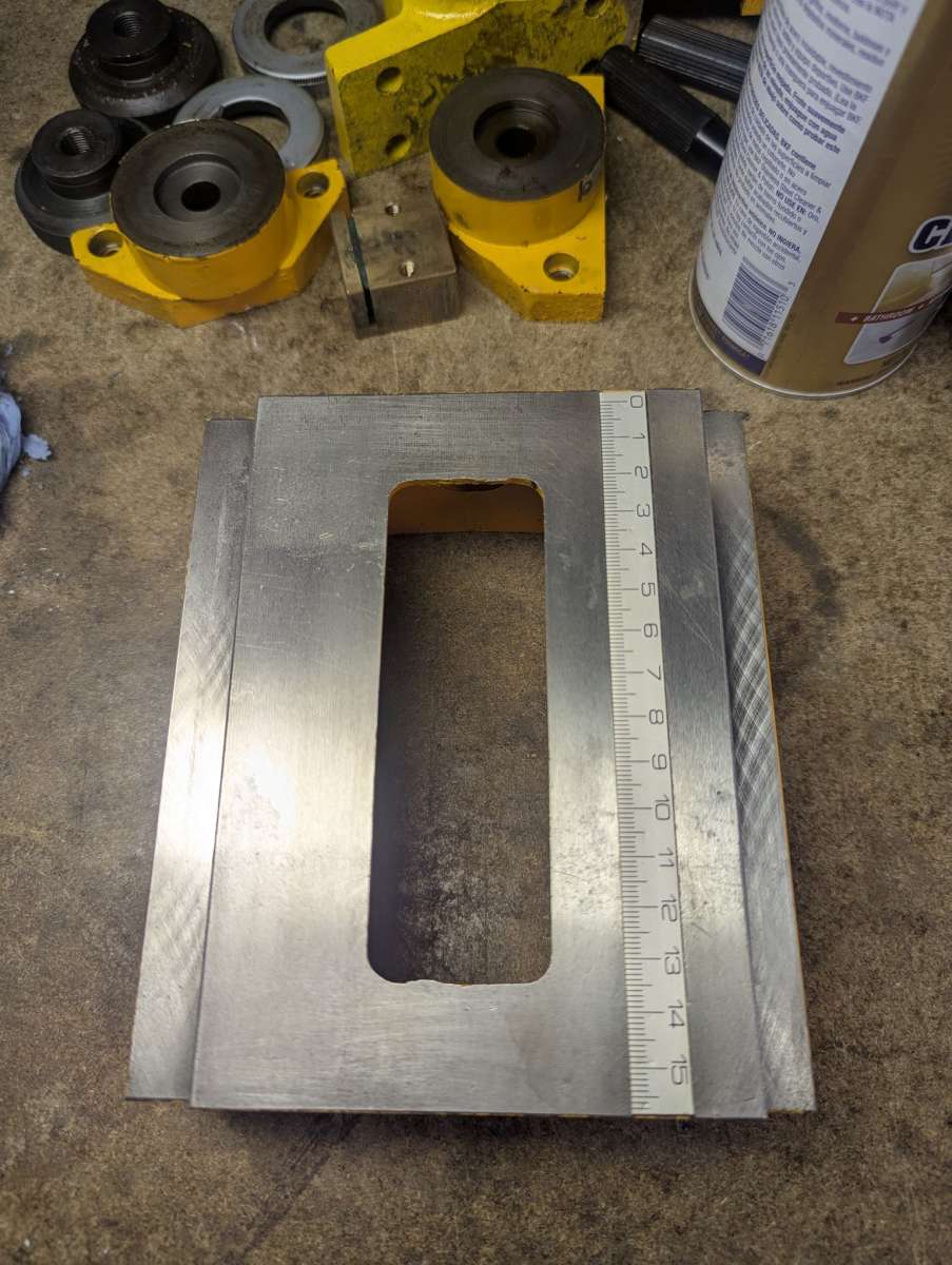

      I want to use this site more instead of Facebook groups, so here I will be documenting my work on my newly acquired Emco Compact 5 milling table.
      The first thing I noticed is that the table moved independently of the leadscrew in the X-axis. After taking it apart, it turns out the 2 bolts in the leadscrew nut were broken off. No other damage as far as I can see.

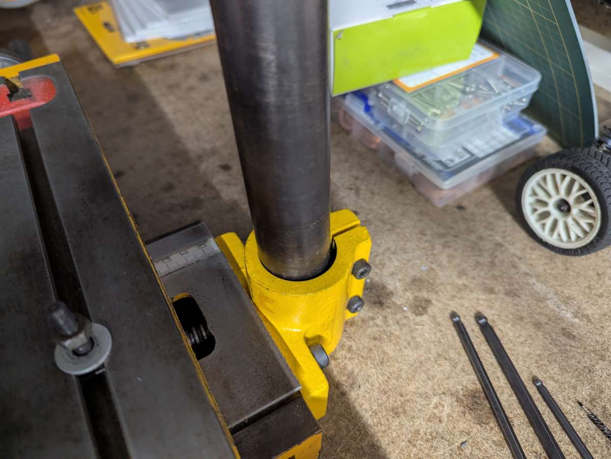

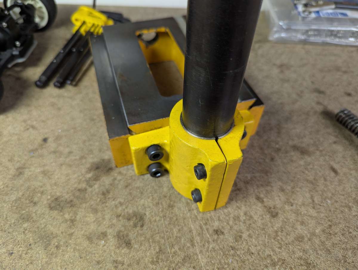

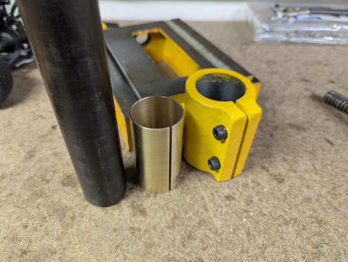

      I also had to buy the column support separately. After receiving it, I noticed the hole was too big (about 37.8mm, while the column is 35mm). I suspect this was bored out somewhere in its lifetime, as the hole was fairly round and straight. Because these are hard to find, I decided to make a brass sleeve to go in between the column and the support. This way I can still use it, instead of searching for months for a replacement. Seems rigid enough.
      Next step, further disassembly and cleaning.PXL_20260504_183327652

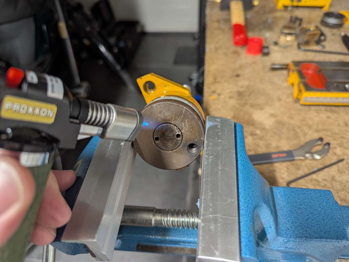

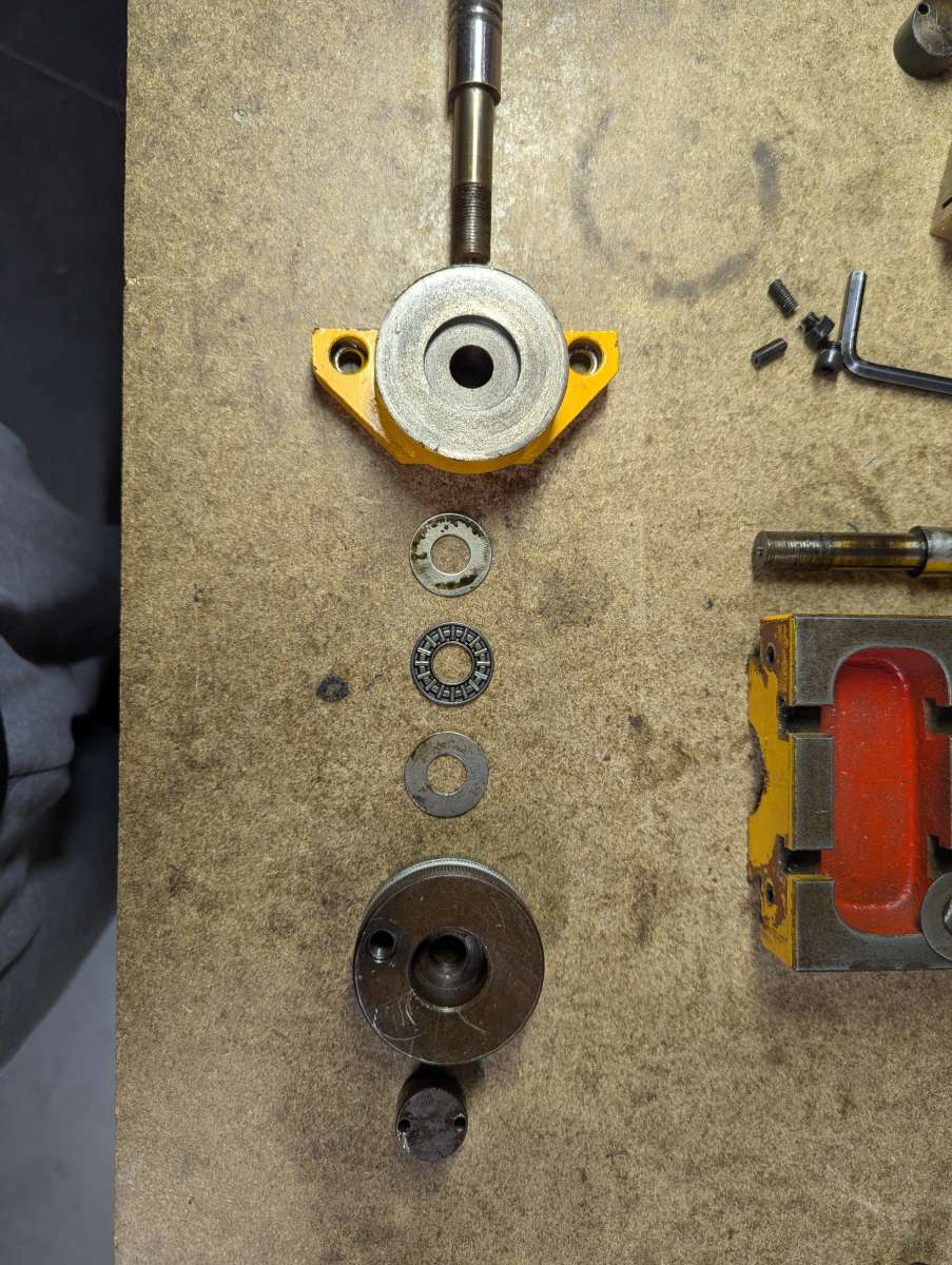

      #850585
      rikt
        @rikt

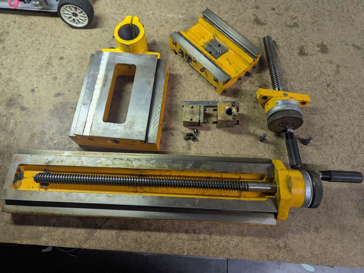

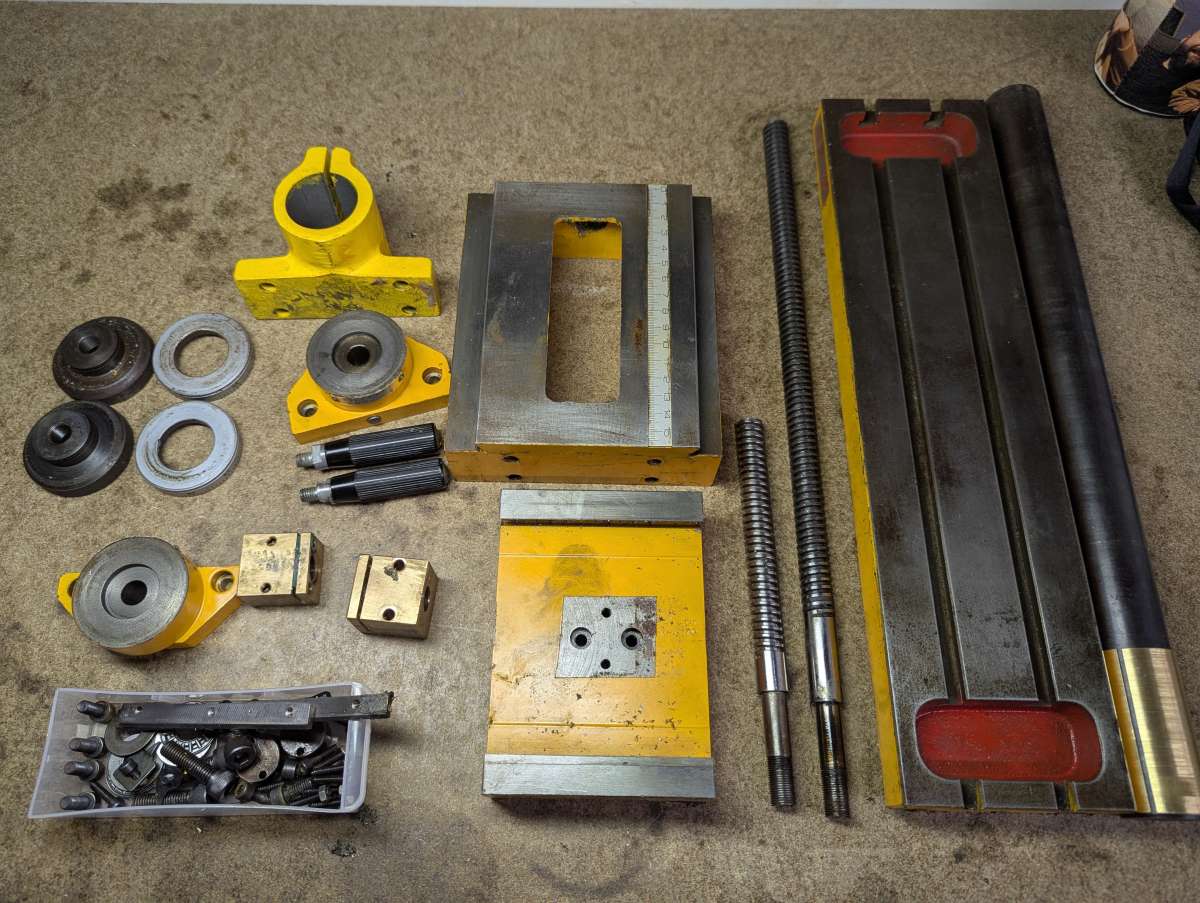

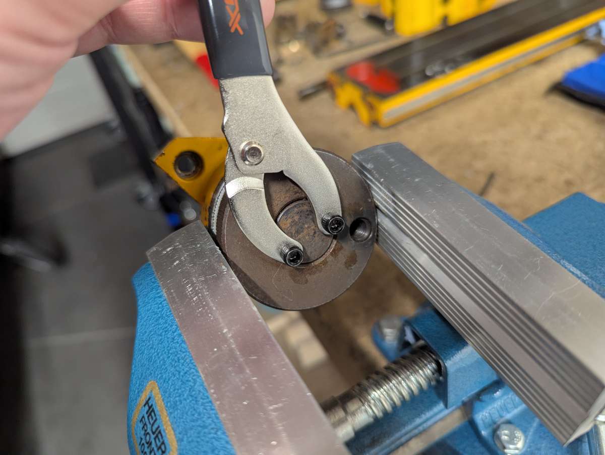

        Made some progress. The nut of the y-axis handwheel was completely stuck, it took a lot of soaking in WD40, applying heat, and a lot of force to get it loose. But I got it in the end.
        Now everything is disassembled, now I can begin cleaning everything.

        Nigel Graham 2
          @nigelgraham2
          Seems this machine had not just been neglected but abused by its previous owner!

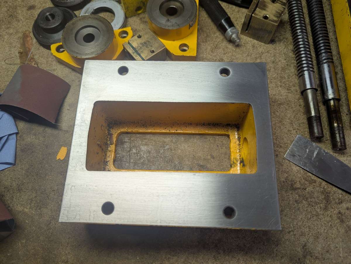

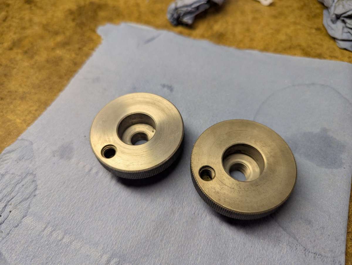

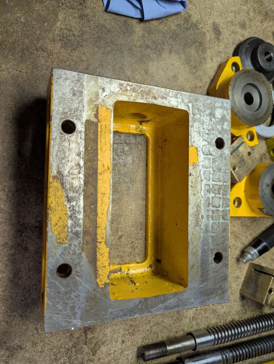

            Some progress,
            I sanded down the bottom of the base, the top has not been sanded of course but cleaned with Bar Keeper’s Friend, to remove dirt and rust.
            The intermediate body has also been cleaned.

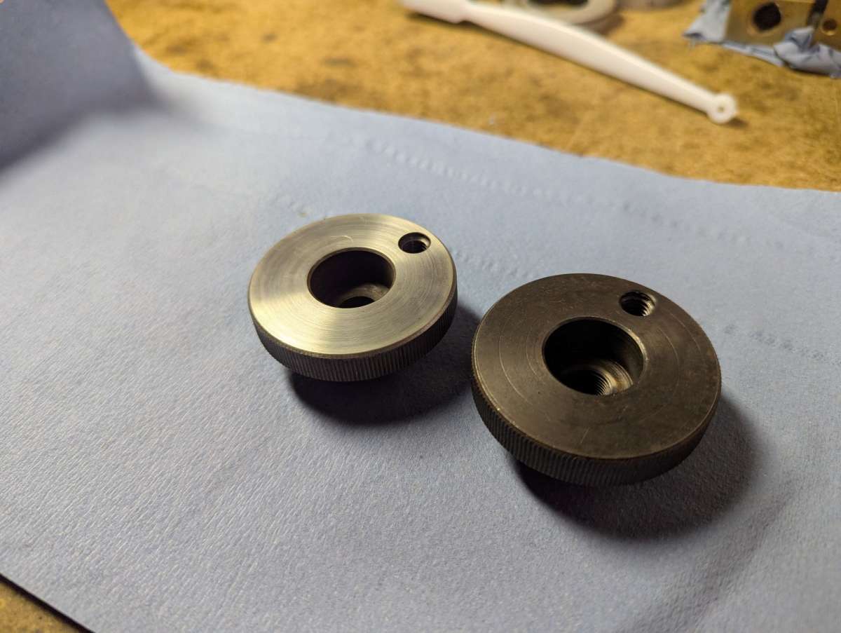

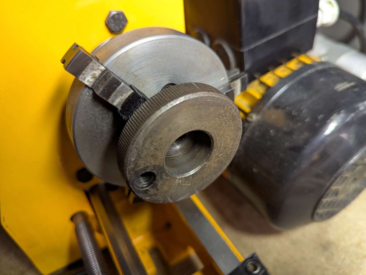

            I tried to undo the damage I did while disassembling the handwheel : I 3D printed some soft jaws for the lathe, and sanded away the scratches as much as I could.
            Both handwheels were then soaked overnight in Evaporust. Came out nice and clean.

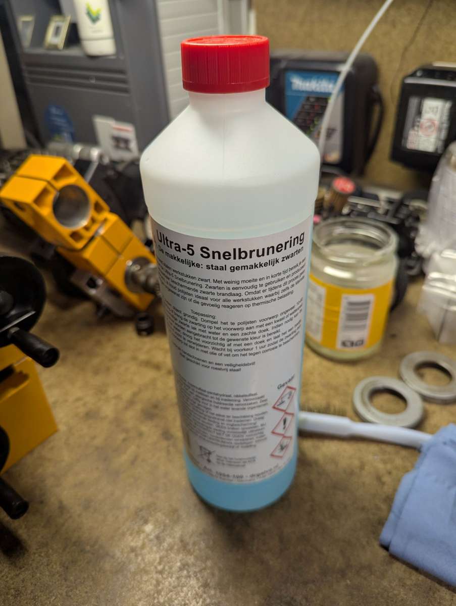

            I’m now planning to blue the handwheels again. I have some bluing chemical, but I have not been able to produce good results with this method. I read that this is mostly used for touch-ups. So any tips on hot bluing (and what I would need for this) are welcome.

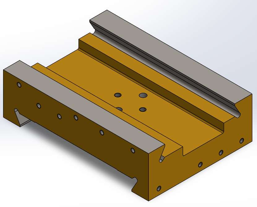

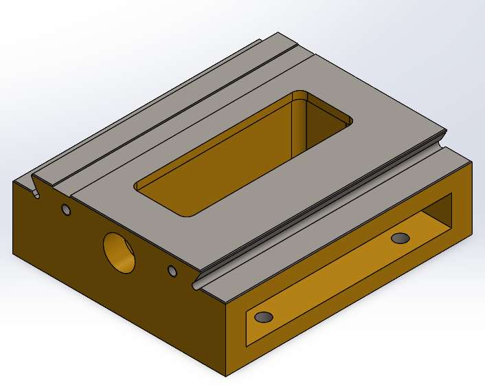

            I’m also taking my time to draw each component in CAD. When I have the complete assembly in 3D, I’ll try to design some accesories like mounts for DRO scales.

              Hello Rikt,
              I have had very good results with Jenolite Koldblak. This is as the name suggests a cold blacking process.

              Pete
                @pete41194
                I have the same Emco table rikt. These are quite well made and accurate. In case you don’t already know this, during reassembly make sure to leave the hand wheel support bracket screws slightly loose. Then move the table towards the hand wheels as close as you can and then fully tighten the cap screws. There not pinned in place for the correct alignment, so leaving the cap screws slightly loose will allow each feed screw support bracket to self align the feed screws to the center of the feed nuts. If it’s not done that way a misalignment is likely and you’ll then get binding and high rates of wear as each hand wheel moves close to each feed nut. It’s something I had to learn myself and that some may not know.
                And your correct that the cold bluing products are really meant for doing touch ups. But if the parts being blackened aren’t almost surgically clean, the results will be quite poor. Final cleaning each part in something like isopropyl alcohol and then not touching them with your fingers until there blackened should help. The hot caustic method is much more permanent and durable of course. But fairly expensive and more complex than many might be willing to invest in for just a few parts. Even maintaining the temperature within a very few degrees is quite critical while the parts are being blackened. And most hot caustic blackening methods I know of will also rust other items in the same location from the fumes. For those reasons and for personal safety, it probably should be done outdoors if possible. Depending on where you are, finding a gunsmith with the equipment to do proper hot bluing would be easier and cheaper.

                      rikt
                        @rikt
                        Thanks to all for the tips,
                        I did some more reading, and my cold bluing method was probably not as it should have been.
                        I’ve ordered a correct type of oil to apply after bluing, when that arrives I’m going to try again.

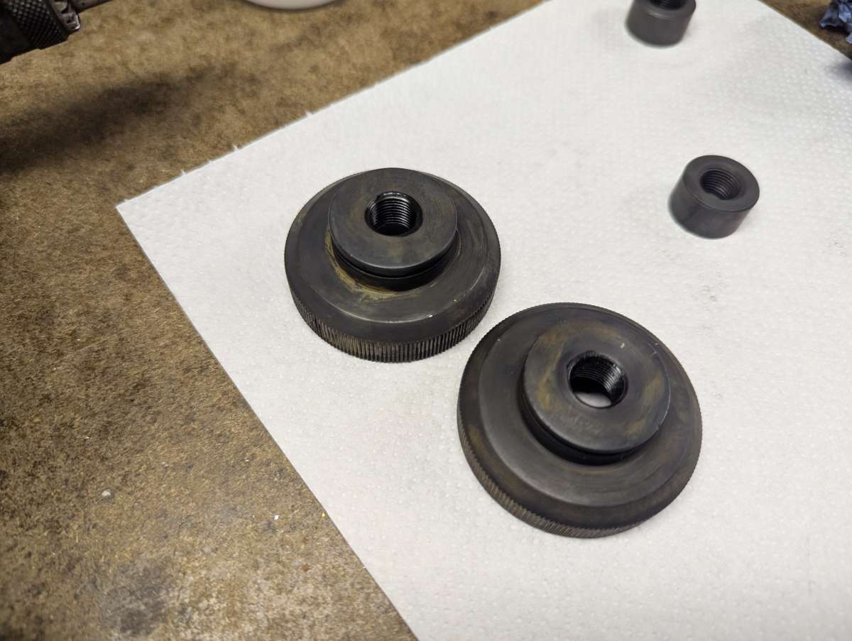

                            rikt
                              @rikt
                              It’s been a while since I worked on this project, this week I decided to revisit the bluing of the hand wheels.
                              I cleaned them thoroughly with steel wool and isopropyl alcohol after that, applied the cold blue and rinsed it off as per the instructions, dried it thoroughly, and dipped them in a special sealing oil.
                              No success this time either. I’m giving up for the moment. I’m going to soak them in Evaporust again to remove everything, and give them a light coat of oil for protection.
                              Maybe I’ll try again later with a different product, but I want to progress with the rest first.

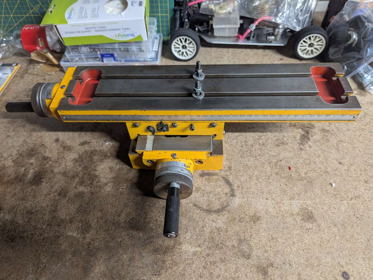

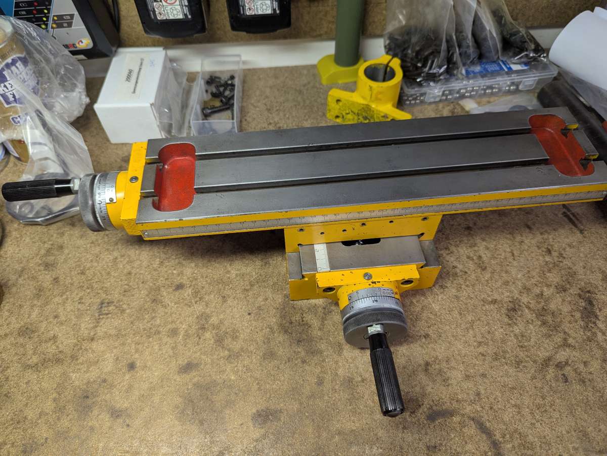

                              rikt
                                @rikt
                                The milling table is almost ready. Everything has been cleaned, oiled, and assembled.
                                I’m just waiting on new set screws for the gibs. When I installed one, it broke almost instantly. So to be safe I will be replacing them all.
                                When that’s done, I’ll install the column, and try to align everything. Got some more reading to do on that topic.

                                Pete
                                  @pete41194
                                  Correctly tramming the spindle true to the table probably isn’t going to be quick or easy. I’d expect to have to use some shims. Surface grinding / scraping would be more correct, but not many have access to or can do that scraping for a 3D alignment.
                                  Fwiw, I cut and glued a stack of 3/4″, or about 19 mm plywood together, and to the same length and width as the table base casting. Drilled the mounting holes to the same pattern the base casting has, then used long bolts to fasten it down to my bench top. That raises the Y axis hand wheel and makes it easier and more comfortable to use.
