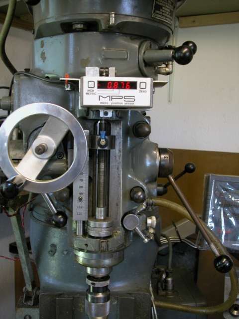

        Another vote for the Bobs pull wire scales.
        Just the job for a quill movement sensor on my Bridgeport. Unlike the usual digital caliper style bar and readout systems the wire doesn’t get in the way of using the stops and trips system. Repurposed from another application hence wire coming out of top.
        I generally use it in conjunction with the stops for positive setting. If used live during drilling vibration can sometimes upset things.

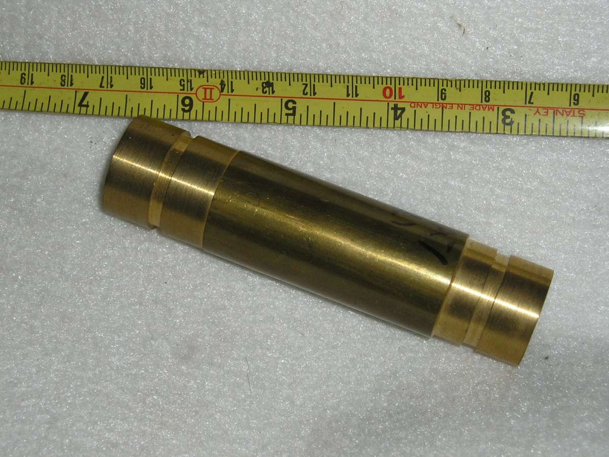

            As for +/-2 thou being very poor, looks like the usual users fooling themselves  problem again. At least I checked every sensor’s calibration before shipping, you think that Ortec and the modern cheap sensors get the same? There are resolution, repeatability, accuracy and precision, all four are important, you are just mentioning resolution.
            I had endless discussions on the exhibition stands about this, look at the photo. This is a simple piece of turning, but one part is machined towards the headstock, the other away, both using power feed. This twists the saddle, and unless you have a well set up lathe the difference in diameter can be many thou. So where is the poor accuracy of the readout in amoungst your machine?
