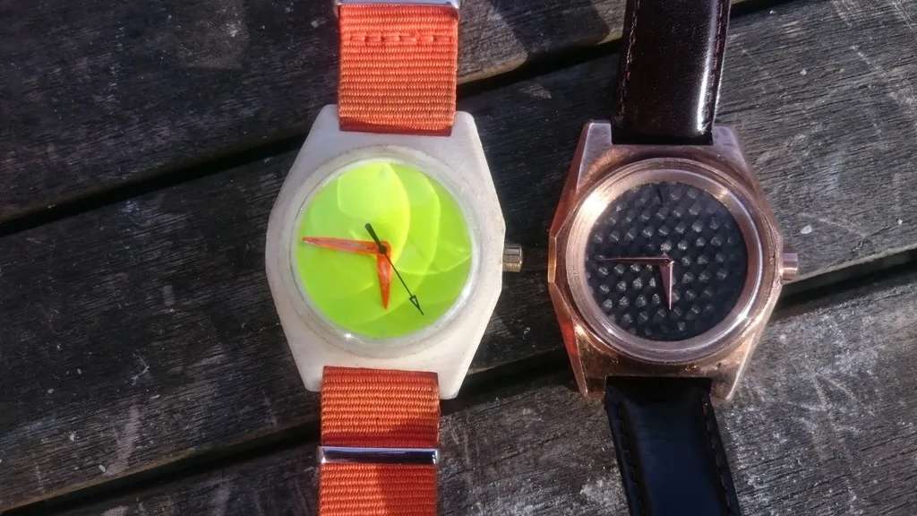

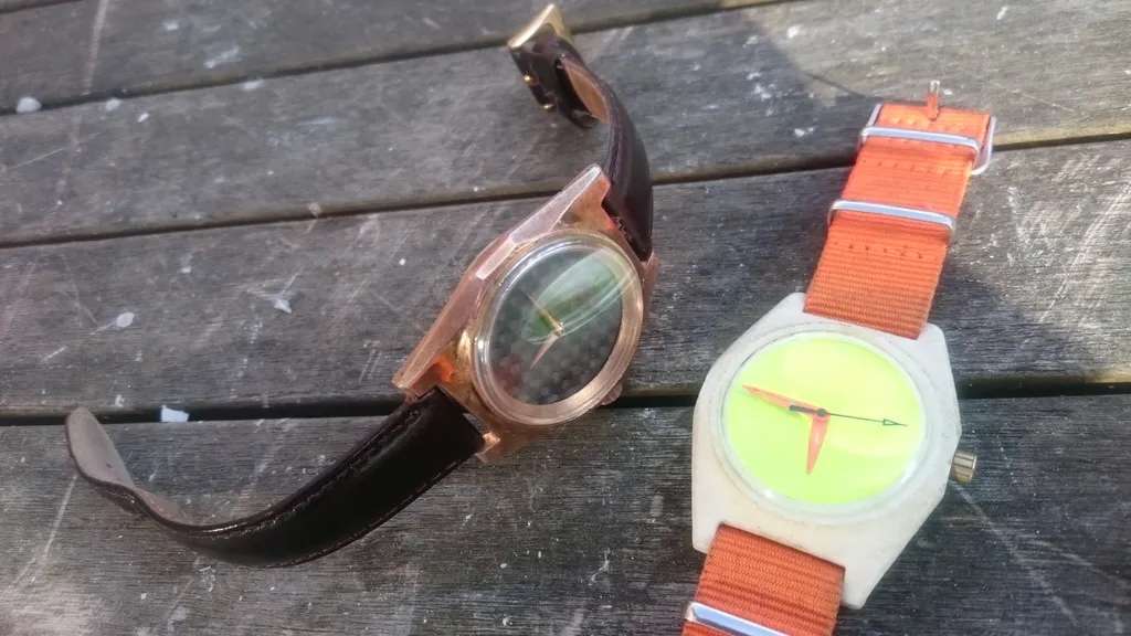

          Dave S
            @daves59043
            One of these watches is 3d printed, the other is a bronze casting from a 3d printed pattern made by scaling the first by the shrinkage.
            Both were printed on a reprap Huxley that I built in the early days of 3d printing.
            DSC_1969DSC_1970
            My ‘daily drive’ 3D Printer is now an X1C – immeasurably improved over the Huxley.
