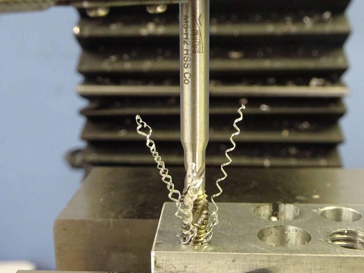

      #849054
        I tend to use spiral flute taps these days, they push it up out the hole
        Photo 179

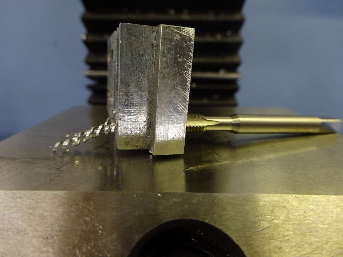

          #849066
            No problem on steel, it comes out much like you get when drilling
            For through holes you can use a spiral point tap as they will push the swarf ahead of them.
            In both cases you don’t wind the tap backwards to break the swarf, just keep turning.

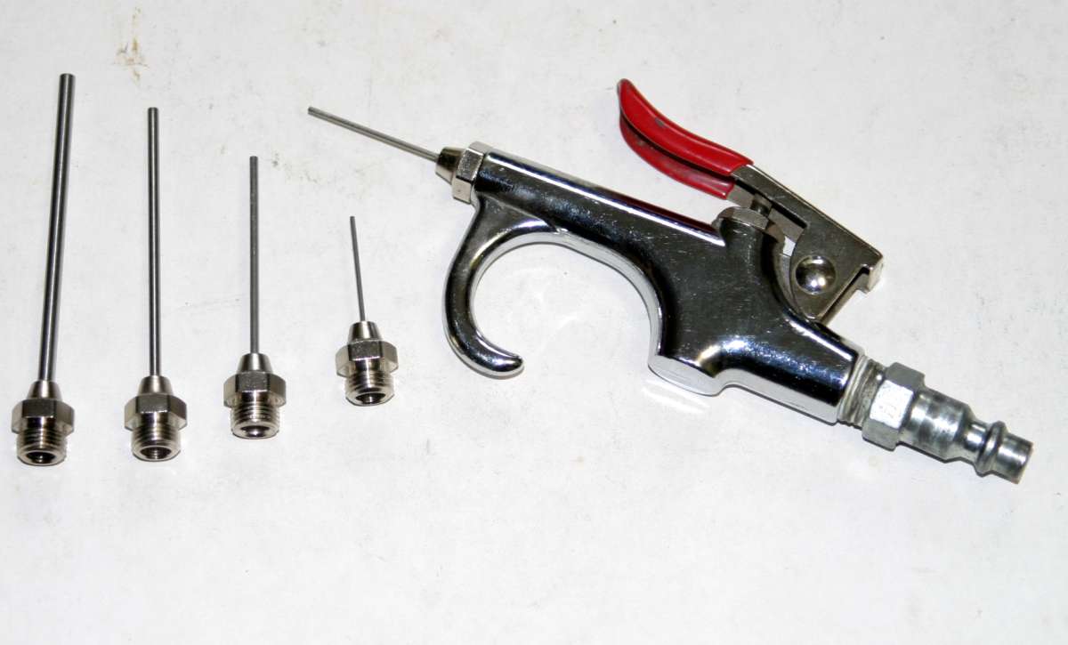

                        John Purdy
                          @johnpurdy78347
                          Here’s What I use to clean out blind tapped holes. Low pressure (25 PSI) and make sure the hole is facing away from you.

                              bernard towers
                                @bernardtowers37738
                                plpus one for that set up John and the magic 25psi
