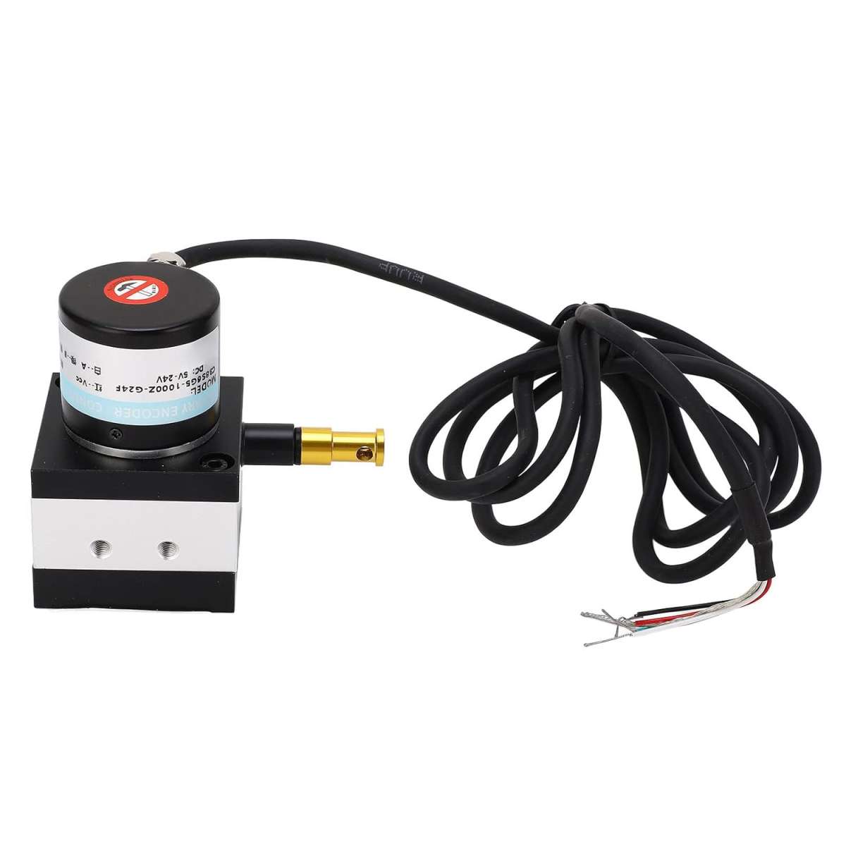

      A few years ago I made a DRO for Cross Slide of my Boxford AUD lathe. It uses a rotary encoder attached to the cross feed screw and as other authors have said, it takes no account of backlash on the screw.
      As far as Arduino code goes, I am not that bright and have been grateful to other’s contributions – albeit modified as required.
      I am now re-visiting the project and thinking of using a draw wire encoder attached to the cross slide.  I don’t want to use typical glass / magnetic slides as they are “bulky” and what is the fun in doing what is accepted practice ??
      What are your comments ?
      Bob
      This is the sort of encoder :-
      https://www.amazon.co.uk/Encoder-10-1200mm-Displacement-Industrial-Automation/dp/B0FYQTSW8H/ref=sr_1_11_sspa?crid=1NY8028XGF12R&dib=eyJ2IjoiMSJ9.QJMNxPQkY5suRr3lpL9zbtfYgD2bosajjgBH-kNQCHexRZX7aBX_kc6hVyYGQ8KGUBQFWf3GmtEG6RCGAZszurmiGHA-gCV3Cjtl8eEvFn0p3CKpA9wCWBXcPB0UbdOgjAPN7QrUSJ2GaM3HbcjrPSGzBbSOBC0VdXMjP90Nwr5dP85r6jCQNPgTshIVzvJFrXi_5ZU5K06F9nZz_ES1_hkZkOGKUfBKWdu9QImJAafTfp1nezVNmJdNiRgBHK27rk6ksPOESYJvjMCfb84WSgFavAUVRB2VgP6QhTfALUc.gduOE3qc0usmefv7AlR_lk9l6omqYBRsPNt2ZiaTGXk&dib_tag=se&keywords=linear+encoder&qid=1781622039&sprefix=linear+encoder%2Caps%2C126&sr=8-11-spons&aref=gmANk7Dwfa&sp_csd=d2lkZ2V0TmFtZT1zcF9tdGY&psc=1
      61LYoB9wjlL._SL1500_

        On Speedy Builder5 Said:
        What are your comments?
        The listing says 5v minimum but the sticker on that particular item says 8v minimum.
        Can you find a data sheet for a brand name version of it? That would give you an idea of how it would interface with the Arduino (how to convert the pulses per revolution to a distance).
        Similar items are available for less money from AliExpress (including a 500mm travel item, search “Cable Encoder E6B2″), and the page includes a table showing resolution.
        Saying that, you could probably calibrate it with a 1” travel dial indicator.

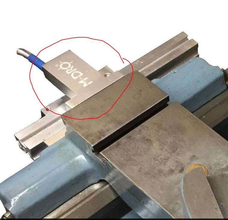

          These were produced commercially at one time to fit hobby lathes. They were nothing like as accurate as linear. Someone described in ME I think a way of fitting tape for a magnetic sensor underneath the cross slide which was extremely neat. One of our search engine gurus will no doubt come up with the reference.
          Edit: for some reason I think the draw string version was produced by z chap in the channel islands, but I might be hallucinating
          #852345
            Typical scales do not have to be bulky. A magnetic strip is typically 10mm wide and 2mm thick. A typical compact read head 35mm x 10mm x 15mm though you can get smaller. Suitably fitted under the cross slide they should not get in the way of anything.
            The cross slide part is just that tee-shaped bracket on the back of the topslide that houses the encoder. The other extrusion is prt of the other axis

                That particular unit only has a resolution of 0.3mm but a long travel of 1.2m. A shorter one might be a better choice.
                These are not high precision sensors.

                  DC31k – I think the label says 5v (not 8v)
                  Jason – There is this video on doing that – a lot of talk but by Video 4, I could see how it was installed.
                  I would still like to have a go at the wire job unless others think its a non starter.
                  Bob
                  #852351
                    The label reveals a bog-standard rotary encoder, presumably pulled round by a wire on a spring-loaded drum.
                    Link to datasheet.
                    relabel
                    It’s a 5-24V device emitting 1000 pulses per revolution.  How that translates to linear accuracy depends on the wire-drum’s diameter and whether or not a gearbox is present.  I can’t see anything in the advert giving the accuracy.
                    Several Rotary Encoder libraries available for the Arduino – this one might do.

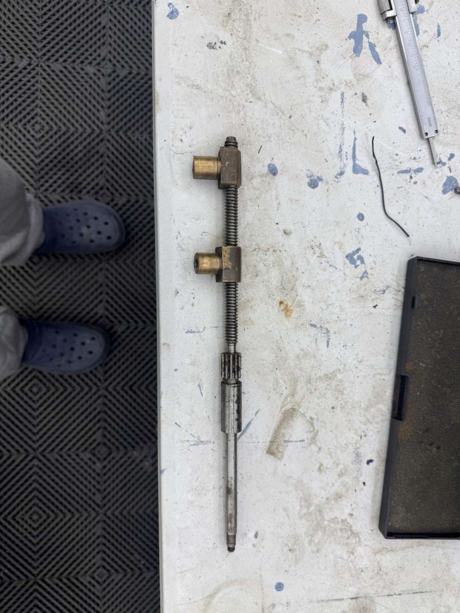

                      edit. By the way have you calibrated the current design relying on the perhaps worn leadscrew to compensate readings?

                        If 1000 ppr means from each channel, that is 4000 edges per rev  and quadrature encoders read edges. If the quoted 38mm diameter is the drum, that is 119.4mm circumference. You might have to add the wire diameter to be strictly accurate. Anyway, 119.4/4000 = 0.03mm resolution. Linear scales are 0.005mm. Or 0.0001 if you pay more, but that is getting silly.
                        The rotary encoders I have used had a 5v regulator built in, so you had to supply at least 6.5 to 7v to get them to work. If you want them to work off 5v you had to perform surgery and bypass the regulator. Of course that might not apply to these.

                            Looking and understanding the accuracy of this particular offering:- Designed with 0.25%FS linearity
                            If I have 9″ of cross slide travel, then (9 x 0.25) / 100 =0.0225″ possible error over the full travel ??  Or have I got it wrong.  OK, we don’t often need that sort of cross travel but even at 1″ its about 0.002″ possible error.
                            As Duncan says, backlash shouldn’t be a problem as we normally cut in one direction…But!
                            Bob
                            #852442
                            Robert Atkinson 2
                              @robertatkinson2
                              I used the “designed for” linearity “specification. to come up with the 0.3mm resolution. I was wrong!
                              Note that the “FS” is Full Scale so relates to the full length of the “string”. The model shown is 1.2m maximum so linearity target is 0.25% of 1200mm = 3mm So useless for this application.It’s safe to assume resolution is no better.
                              I’t not much but as it the only data given we have to use it. And it just what they designed it to meet. Actual performance could be vary different.
                              Not sure how I got my math wrong. I was expecting something in the sub-mm range.
                              Robert.

                                      I think that may have been the “Ortec” DRO?   I still have a couple of those in use, reliable and accurate.  One advantage of the Ortec was the size of the mylar(?) linear encoders, compact in cross-section compared with some of the more modern devices.   It was also there disadvantage, reading length was limited by what was available.
                                      At the time, early 90’s(?), the competition was the draw wire encoder and a mechanical counter.  The draw wire type had a reputation for inconsistency.

                                                Draw wire encoders (and potentiometers) inconsistency is almost always caused by poor wire management. If the lay of the wire on the drum is not level the cross overs or layering change the effective diameter of the drum. Kinks in the wire are also a problem and the only real solution is a new wire.

                                                  Plus minus 2 thou is not very good when compared with 0.005 mm from a magnetic or glass DRO

                                                      Perhaps I should look out for a New Cross feed screw for a BOXFORD Imperial lathe – mine has at least 0.065″ end float. If I can’t find one for a reasonable price, thinking of just replacing the screwed bit by grafting it onto the “non screwed” end. Ps, I don’t know why this photo has 2 nuts !!
                                                      Cross Slide Screw
