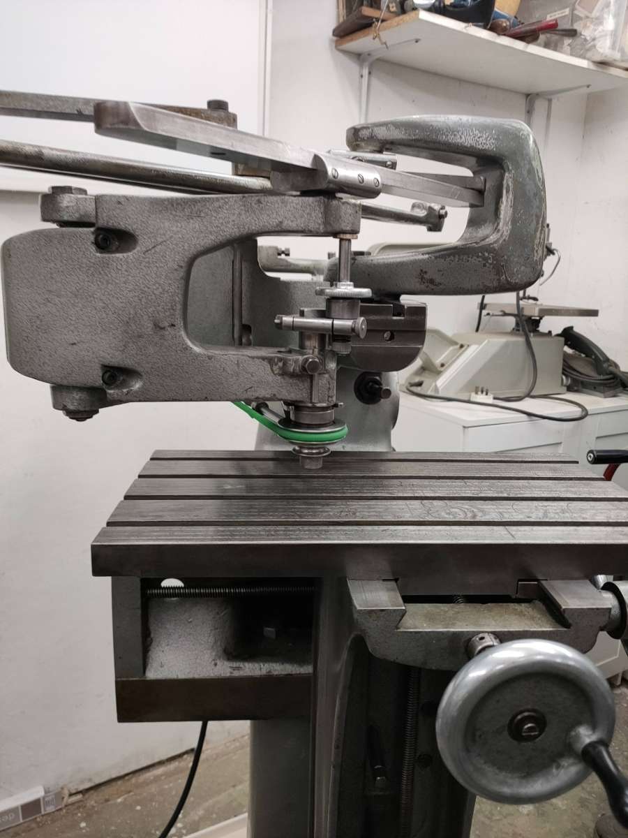

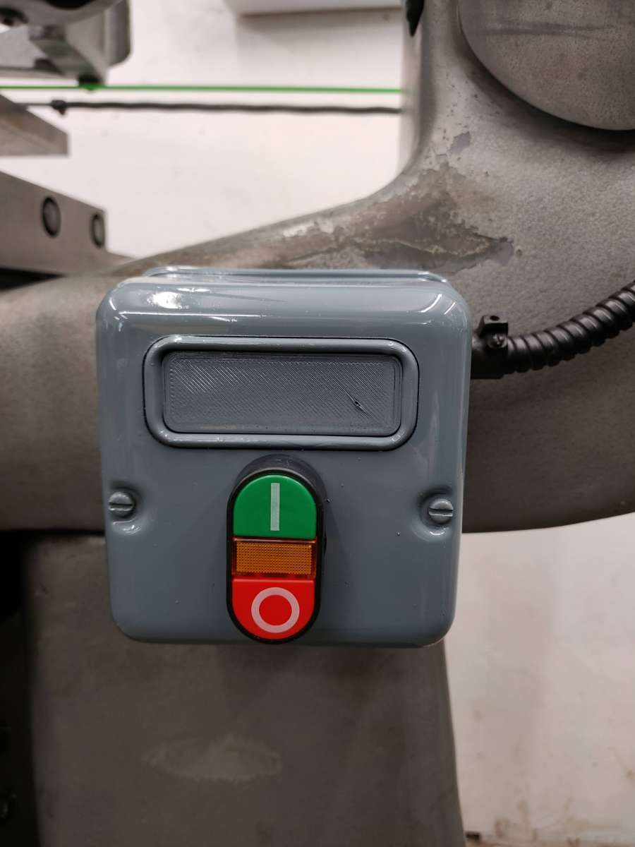

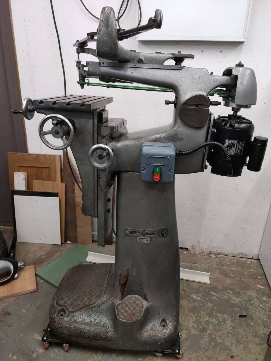

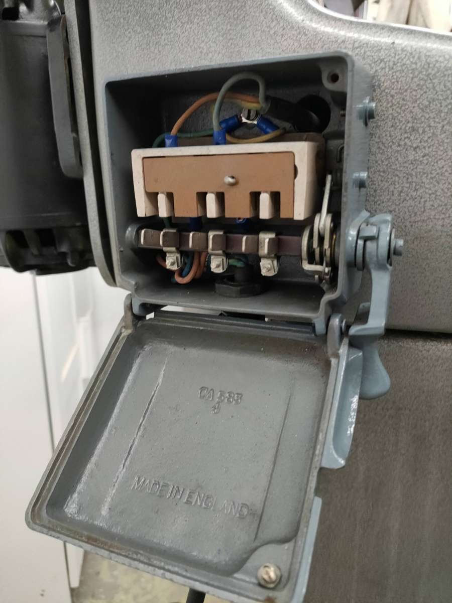

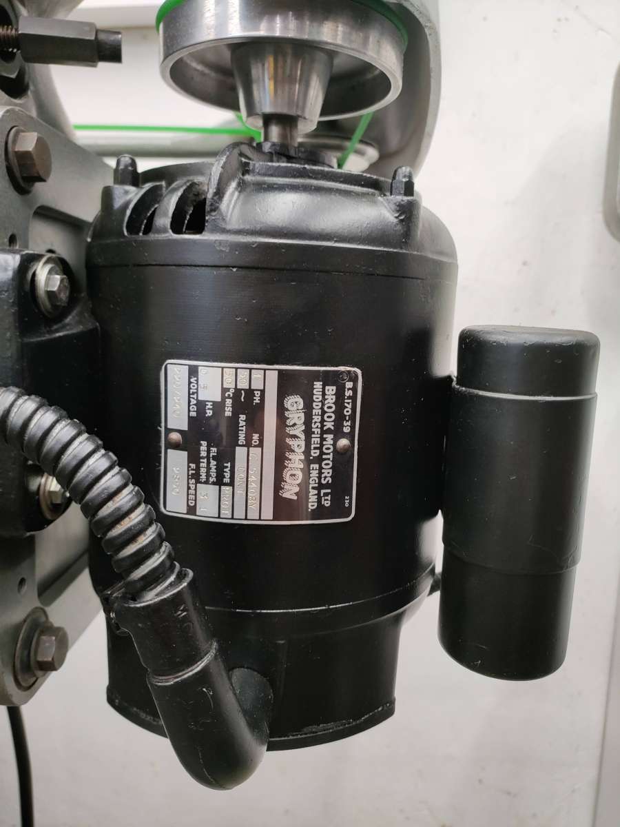

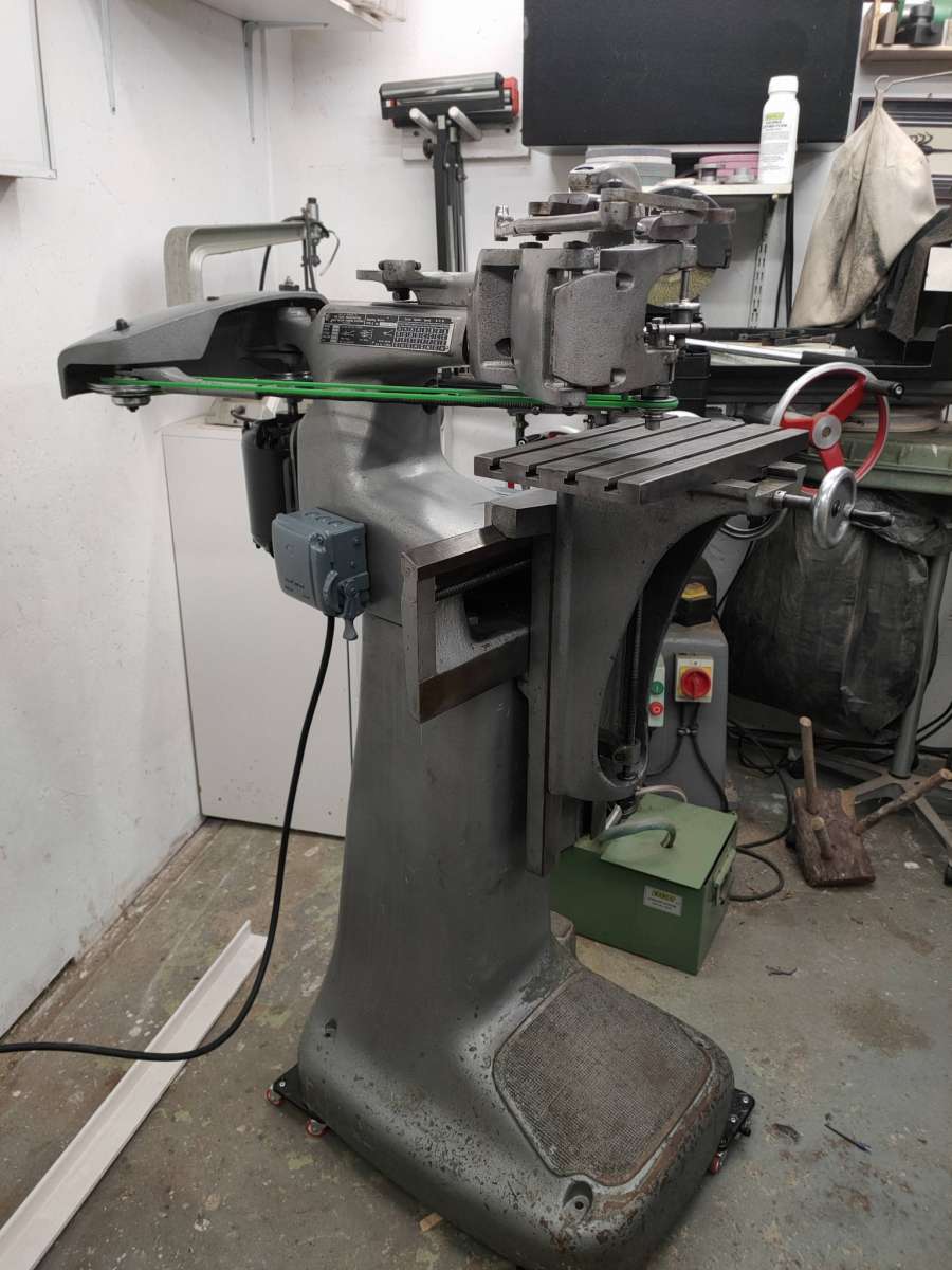

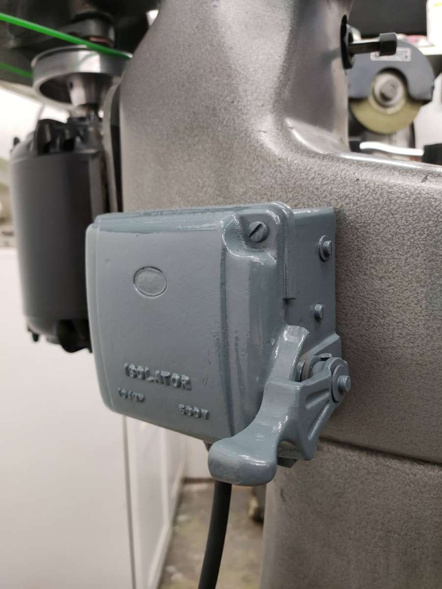

      I couldn’t resist this. Now cleaned up and tightened up with new wiring.
      I got to work out how to hold the tapered shank cutters in my Quorn. Or work out how to fit and ER11 spindle.

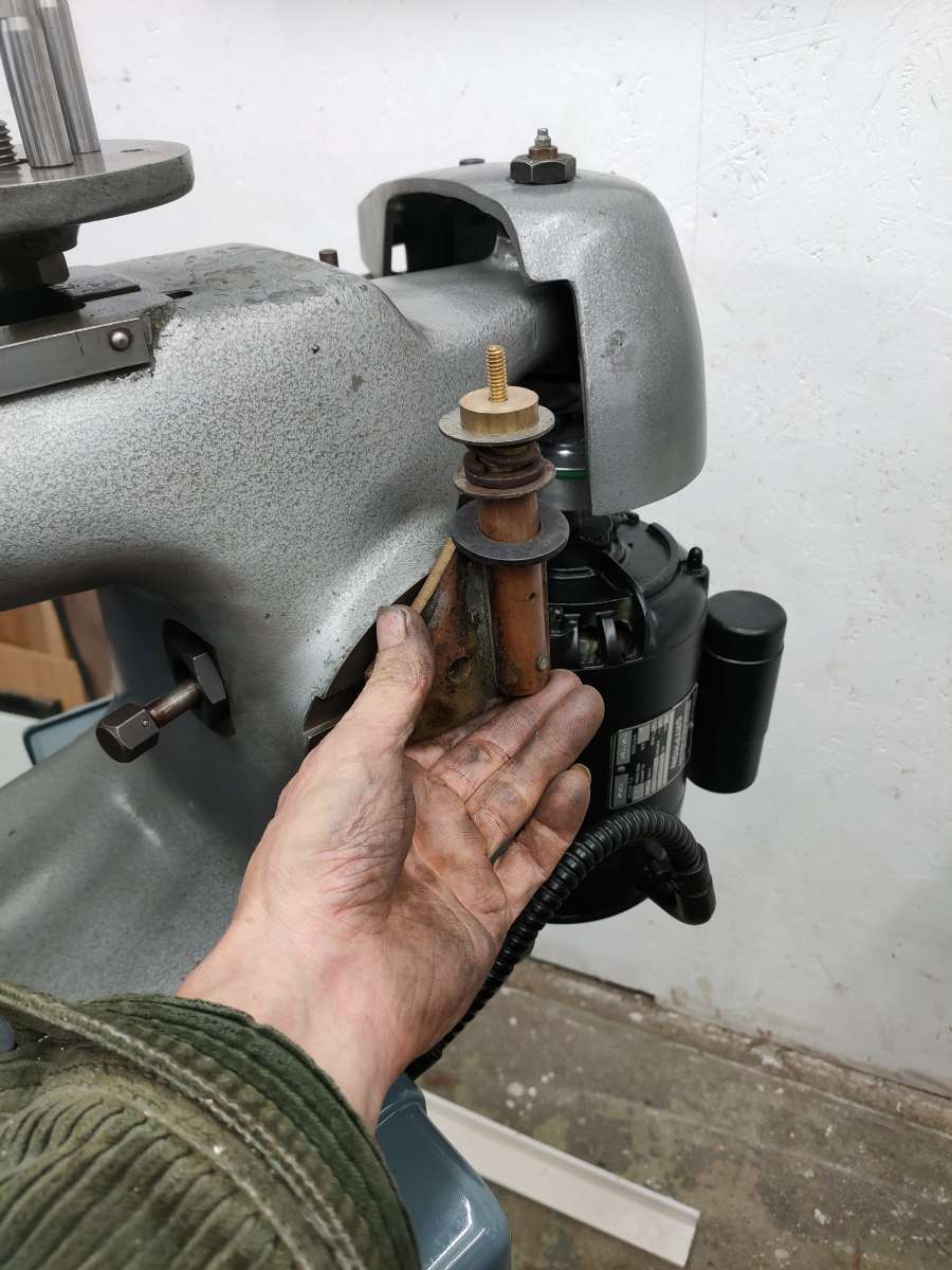

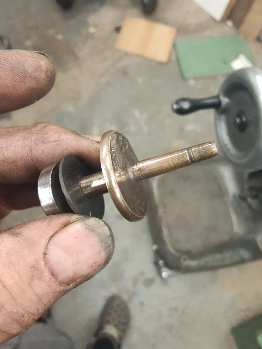

            I nearly los
            On Nigel Graham 2 Said:
            Mine had lost the spindle nose nut.
            I nearly lost the spring clip which goes under the nut. The most challenging bit of disassembly/assembly was the ball bearings in the pantograph – I really need new balls but couldn’t wait. I also need a new leadscrew and nut one day – the trapezoidal thread is now a thin triangle.

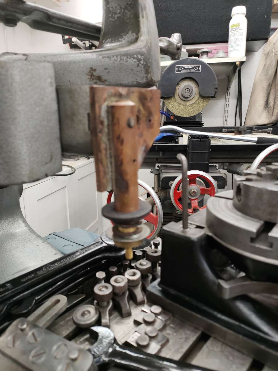

              jaCK Hobson
                @jackhobson50760

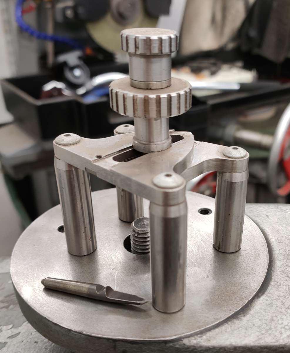

                Anyone know the taper angle on these cutters? My taper guage, which I thought would come in handy one day, is a little large.

                      My estimate on taper :
                      Minor dia: 4.08mm
                      Major dia: 5.57mm
                      Length: 22.8mm
                      Taper Angle: 1.8715 degrees
                      Taper: 3.267 %
                      I don’t think I can get a reamer for that, or bore it… so maybe I have to shell out for an adaptor

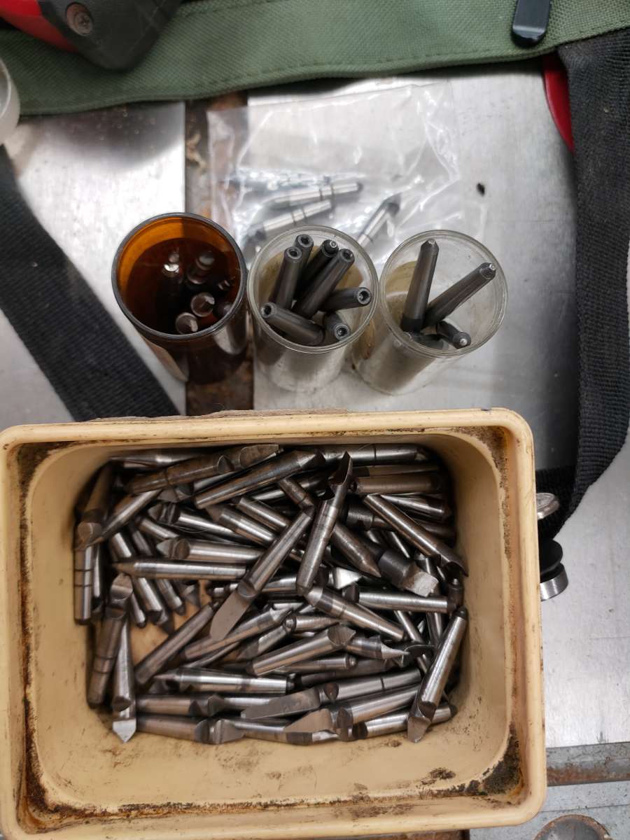

                            Thanks! But I have a lot of (mostly blunt) cutters:
                            On 3 June 2026 at 10:38 Michael Gilligan Said:
                            Jack
                            A man of your obvious ability could surely make a ‘D-bit’ reamer from the back-end of an existing cutter.
                            What I don’t have is a single taper shank that has something on the other end I can get hold of in a chuck/collet!

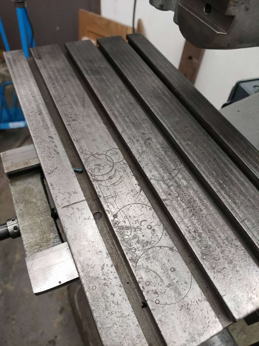

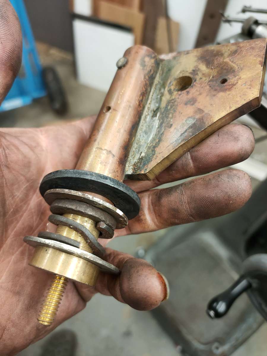

                            I found more bits… including the start of some home made attachments… not sure what the intent was
                            IMG20260603173922IMG20260603173950
                            And a brass tapered shank disc holder ? But the shank is not quite big enough to fit in spindle
                            Off to clean my hands now…

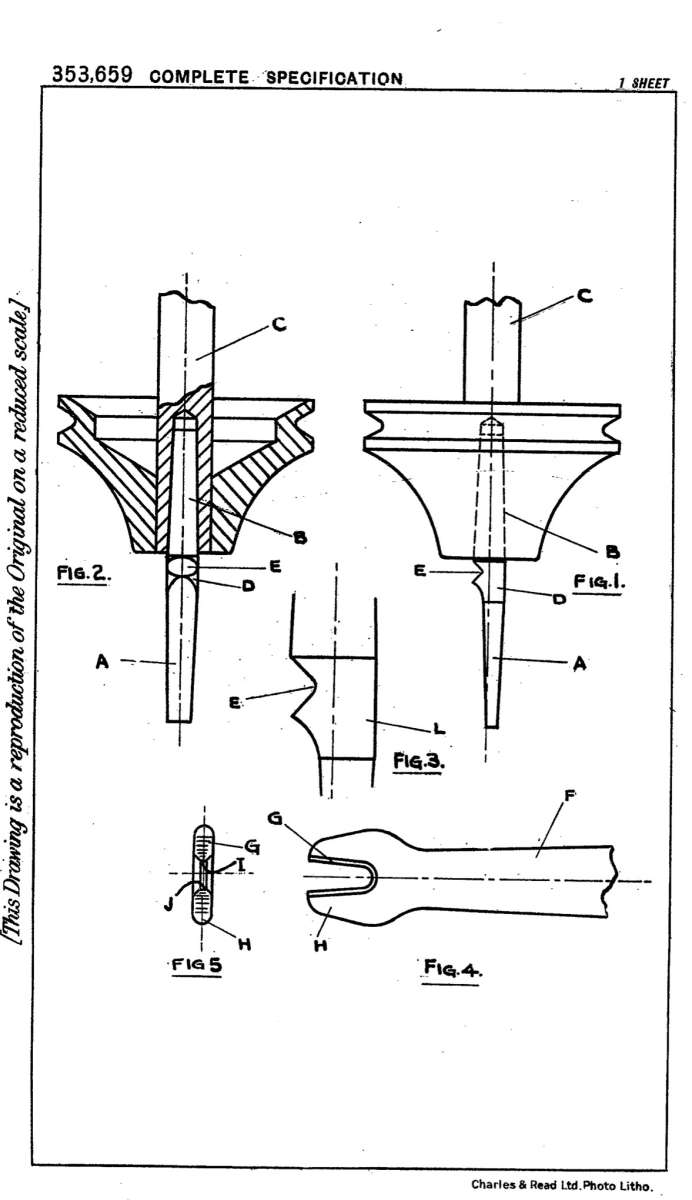

                                    It took a while for me to locate this again … mostly because it’s in the name of KAPELLA
                                    No dimensions shown, but it’s a useful reference:

                                    jaCK Hobson
                                      @jackhobson50760
                                      From the drawing I measure included angle of 4.129 deg. Taper angle 2.065
                                      Which is close to 7/8″ per foot

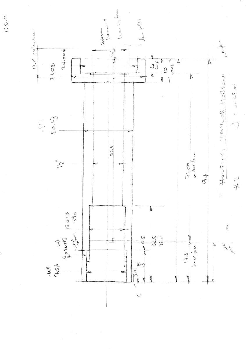

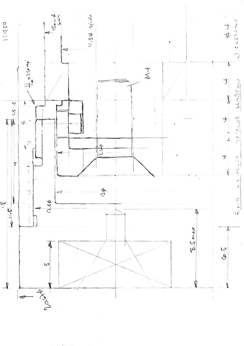

                                            Charles Jambon
                                              @charlesjambon

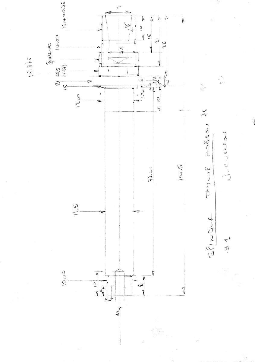

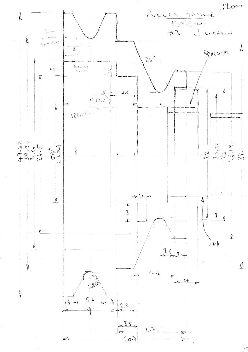

                                              I will have a look to see if I can find my design drawings for the E11 spindle. I do remember it was quite difficult to find bearings and wavy washers (to provide preload) that would be robust but still fit inside the overall envelope of the original spindle with its integral bearings.
                                              #851592
                                              Charles Jambon
                                                @charlesjambon
                                                I managed to find the workshop drawings for the E11 Taylor Hobson Spindle. They were done old school pencil on paper but trust you can see the most important dimensions. They are a bit of a cocktail of metric and imperial in order to get all the threaded items into a confined space and use available threading equiment where applicable. All threads were lathe cut and finished with a die or tap if available. The pulley is keyed to the spindle in a similar way to the original with a captive short flat key across a flat at the front end of the spindle. Not all the pieces are drawn up – in particular the spacers that support the wavy washers ( W61590) that provide the necessary preload. I found 15 N preload was about right but had to juggle the number of wave washers and flat intermediary washers to get the right set up. I also had to internally grind the wavy washers to clear the spindle because the standard washers have bores that are too small. It is well worth while calibrating the stiffness of the wavy washer stack (actually measuring with a load gauge and height gauge and not calculating N/mm using the standard formulae)  and measuring very carefully the shoulder and spacer distances to get the right preload. The bearings are standard thin race SKF 61901-2RS1 (12mm x 24 mm x 6 mm) and Dunlop 61700 -2RS (10 mm x 15 mm x 4 mm) and they have worked very well over many years. But the original Taylor Hobson design is by far the most elegant and I hope to regrind the races at some stage and get the old one working again – albeit with taper shank cutters.
                                                TH spindleSTH HousingTH PulleyTH End Closure

                                                jaCK Hobson
                                                  @jackhobson50760
                                                  Wow. Proper drawings!

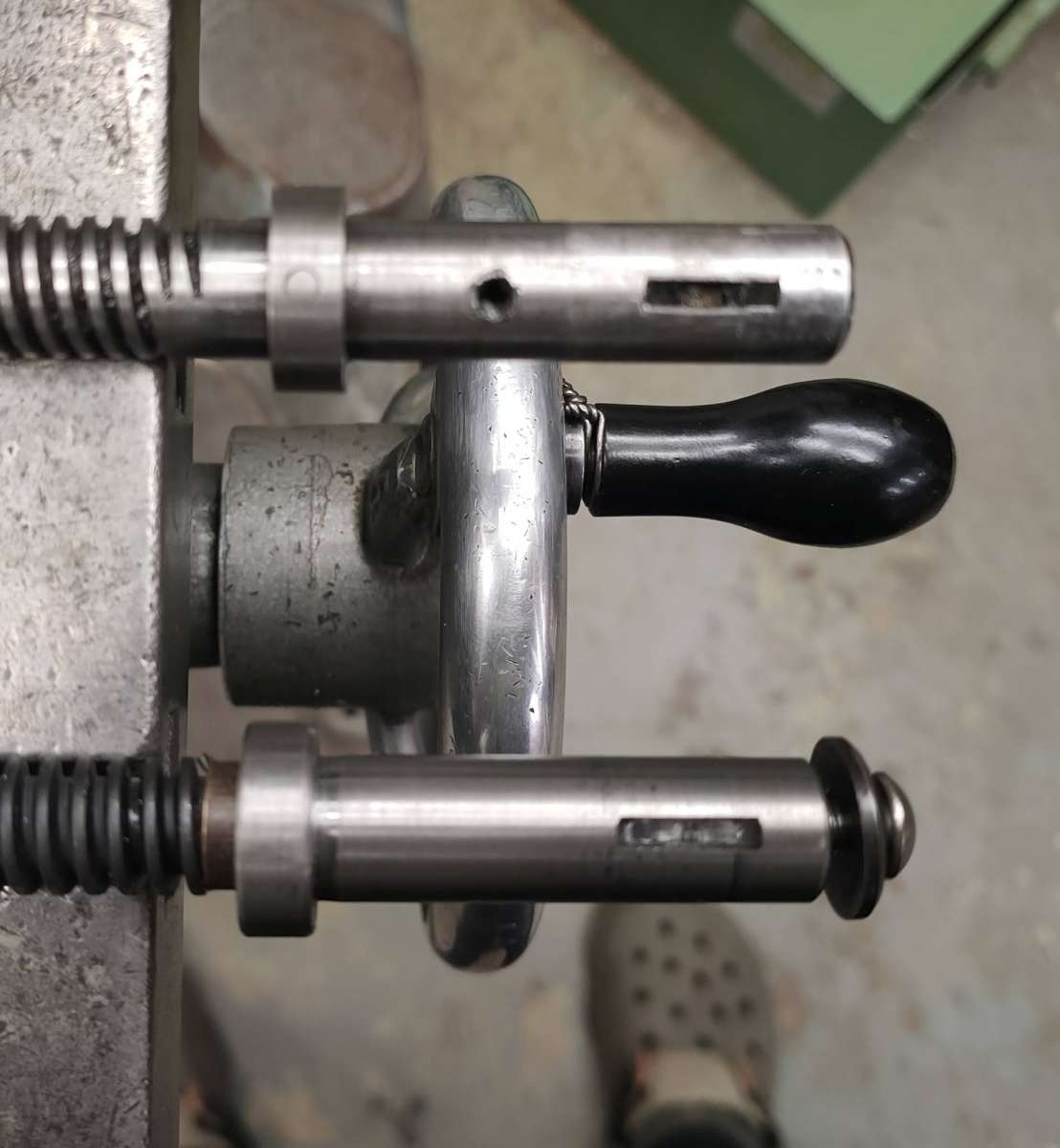

                                                    jaCK Hobson
                                                      @jackhobson50760

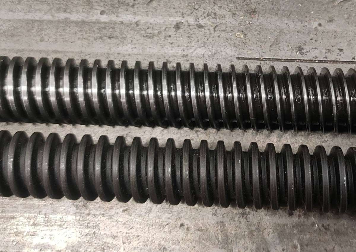

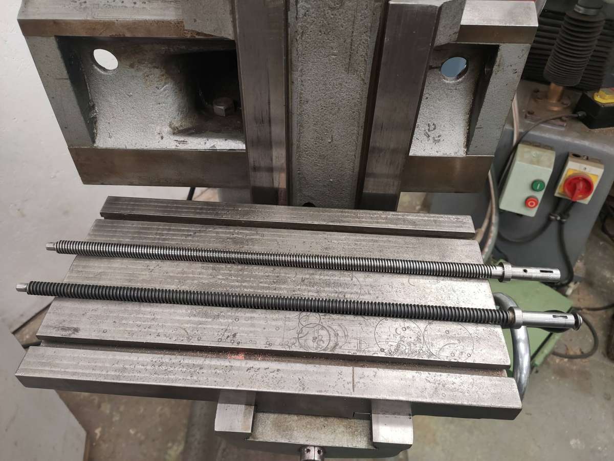

                                                      Threads were getting worryingly thin on the main leadscrew so I bodged a new one from std TR12 threaded bar off Amazon. Now to bodge a nut. I wonder how long a 100% infil PLA 3D print would last? Shame I can’t print delron.
