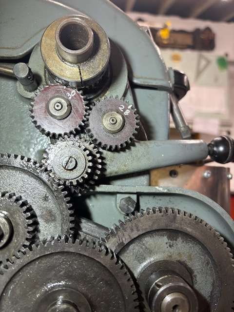

      On Graham Meek Said:
      When comparing John Purdy’s Tufnol gears in the photograph above and those on Julian machine they are nothing alike. Julian’s gears look to have been cut with an endmill by comparison. The teeth look more like the ones found in a clock.
      Regards
      Gray,
      Indeed. The teeth on John’s gears are much “meatier”. And in Julian’s original picture, the teeth on the Tufnol gears appear much thinner than the teeth on the meshing metal gears.
      I think I would buy a new pair of genuine Myford Tufnol gears.

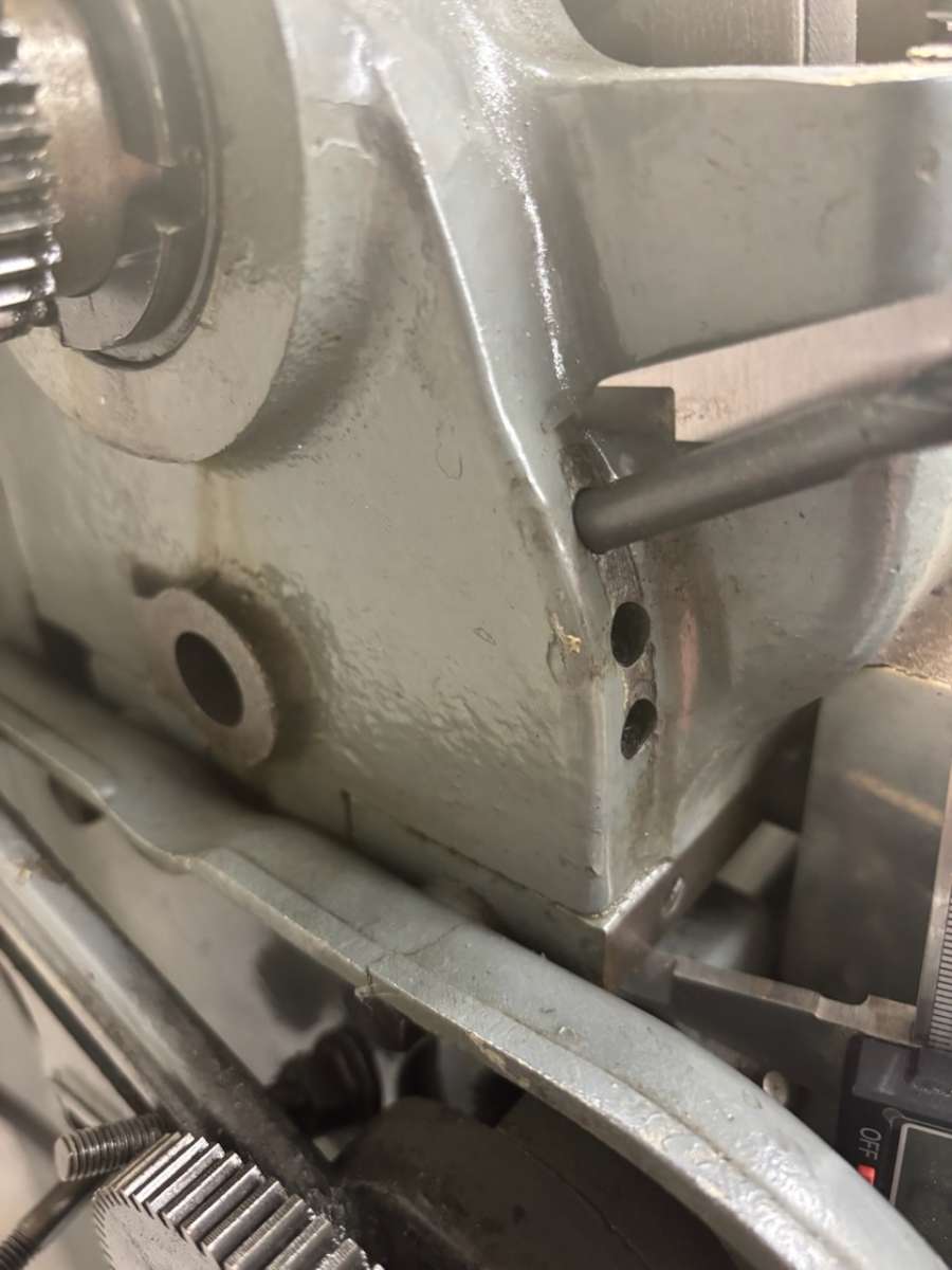

          Julian, in your photo of the three detention holes, Why is there a mark on the lower hole where presumably the detent pin should go (but doesn’t engage).  Is there a possibility that at some time ago, the lower detention hole was plugged and re-positioned ?

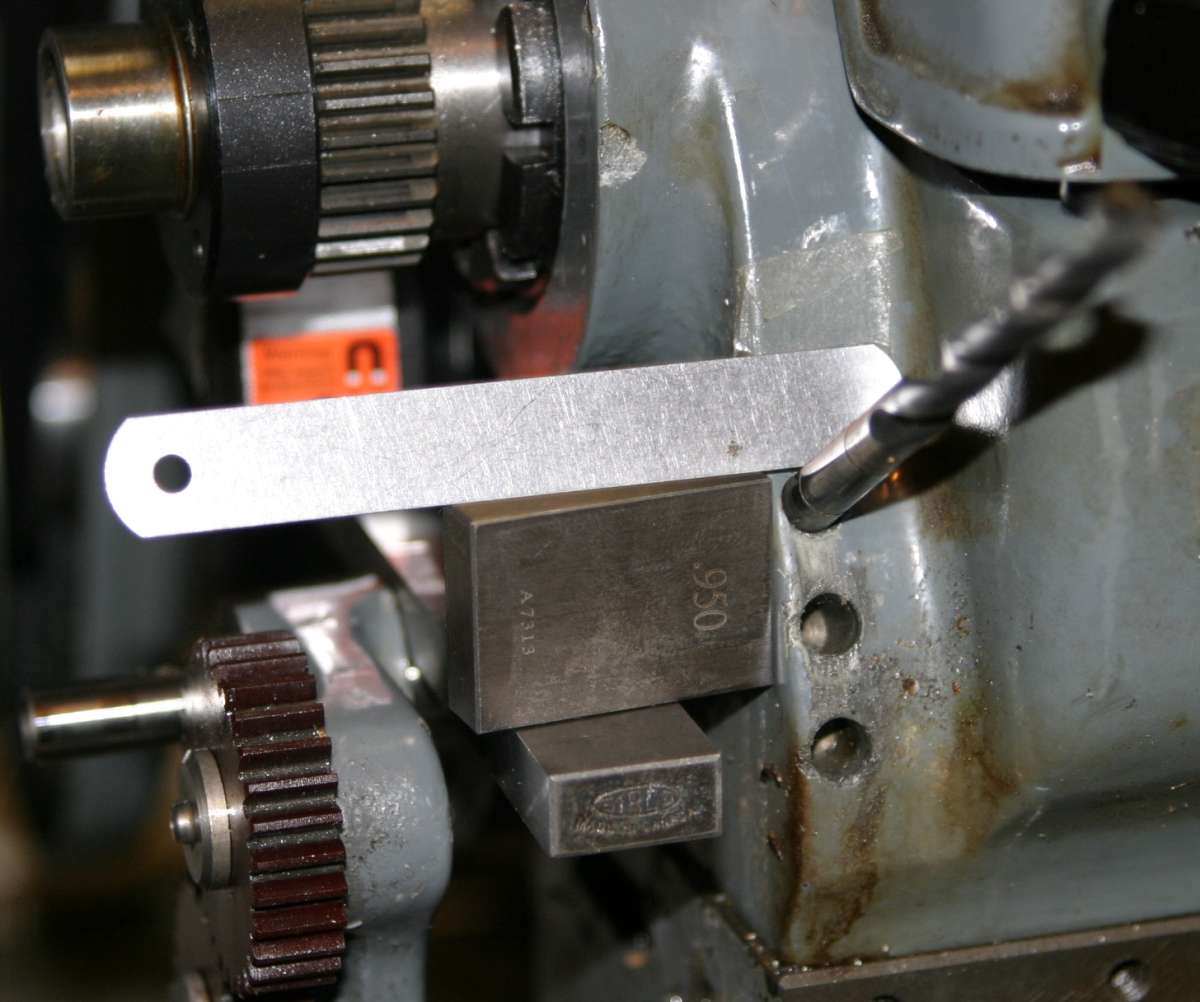

                  @julianj

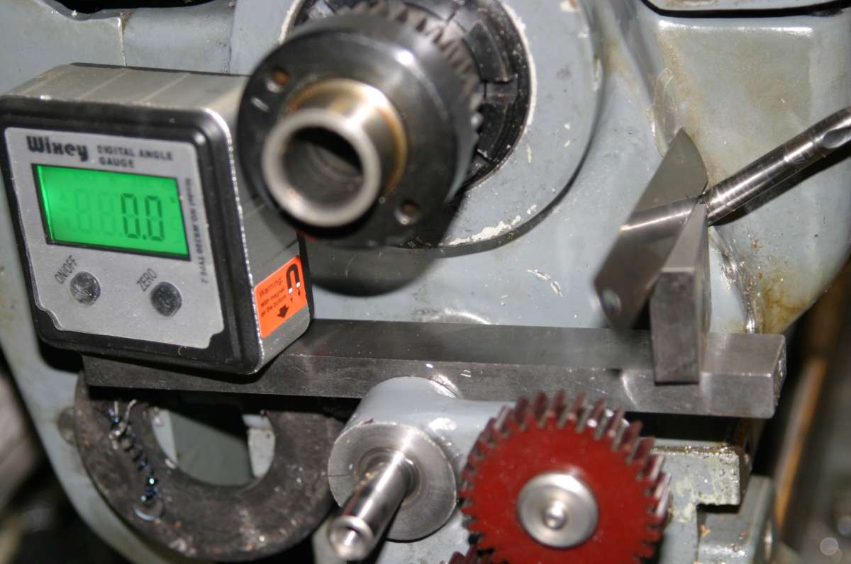

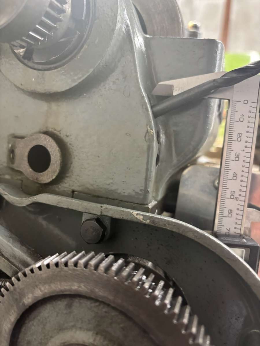

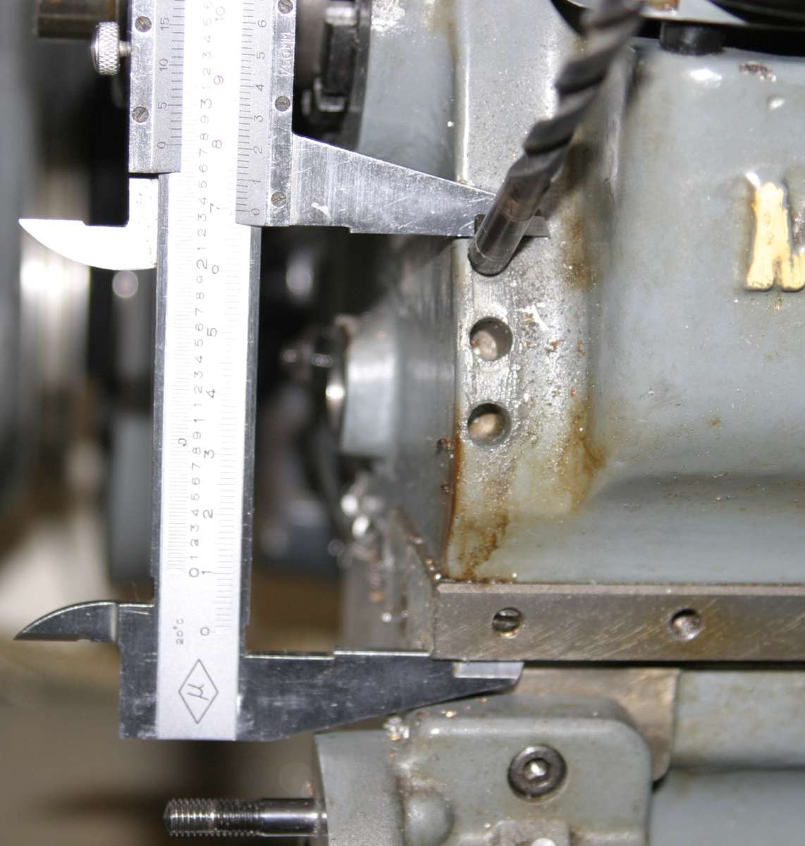

                  On John Purdy Said:
                  Julian
                  This is how I measured the 2.740″ distance from the bottom of the front bed shear to the top of the 17/64″ drill shank.
                  Dedent
                  John,
                  I am deeply indebted to you Sir… You’ve given me the solution !
                  Having looked at your photo & stewed on it for a couple of days, I re-measured the distance on my lathe as per your photo & my location holes are a good 1/4 inch lower than yours (standard?). The enclosed photo shows my calipers set at 2.740″. The photo isn’t really clear & it’s a little tricky to measure with the gear cover in place (I notice yours is removed in your photo) but…. there lies the problem !
                  I’ll be on the phone to Myford first thing in the morning to order new set of holes.
                  It’ll take me a little while, but I’m thinking of a couple of engineering solutions & will report back in due course!
                  My most sincere thanks to everyone that has contributed on this thread, you’ve all helped me more than you will ever know, I’m humbled by your generosity of knowledge.
                  Kindest regards to all,
                  Julian

                  John Purdy
                    @johnpurdy78347
                    Julian
                    Glad it looks like you have found the reason for your problem! If the holes were drilled using a jig as Graham Meek says he recalls in a previous post above, the only thing I can think of for the misplacement of the 3 holes is the jig moved or was not placed properly.  Doesn’t say much for Myford’s post assembly quality control. That should have been easily picked up if any even rudimentary checks were done.

                        alecs
                          @alecs
                          As an ex-toolmaker who made a few drill jigs (long ago!) I would be somewhat surprised if that bottom surface of the headstock was used as a reference when drilling those three detent holes. The critical references are the main spindle hole and the tumbler pivot hole. The headstock base surface is irrelevant to the tumbler operation and gear mesh.
                          And we know from widespread experience that the exact centre height on Myfords varies slightly from one lathe to another, indicating that the bottom headstock base surface was possibly machined to whatever it took to clean up the casting. So not a fixed reference surface for a drill jig.
                          I would definitely call Myford and discuss before any major surgery. Just in case there is some odd variation in tumbler dimensions between models, eras or even individual machines. In the spirit of “Measure twice, cut (or drill) once”.
                          #848261
                          John Purdy
                            @johnpurdy78347
                            Alecs
                            I agree with your statement that the bottom surface of the head stock is irrelevant to the meshing of the tumbler gears but it was a convenient surface to make a reference measurement from. I also agree that the centre height varies between S7 lathes, but we are talking here about ~1/4″. The centre height of my lathe measures 3.5036″, so only 3.6 thou high from nominal.
                            As a double check I have just jury rigged a set up to measure the distance from the top of the tumbler pivot pin to the top of the upper dedent hole in the head stock casting.
                            As can be seen in the pics below I have rested a 3/8 x 3/4 parallel on the upside down tumbler pivot pin, held it in place by a magnet and set it level to 0.0 degrees using a small digital level. I then compared the level of the top of the drill shank in the upper dedent hole to various gauge blocks sitting on top of the parallel. The top of the .950″ block ended up coincident with the top of the drill shank as close as can be judged by eye. So the distance from the top of the tumbler pivot pin to the top of the upper dedent hole measures 1.325″ (.375+.950) and I would guesstimate to +-10 thou or less.
                            Justin,  could you maybe make a similar measurement and see how yours compares with my measurement? This would eliminate the problem of using the bottom of the head stock as a reference to determine if the dedent holes are positioned correctly.
                            IMG_7980
                            .095

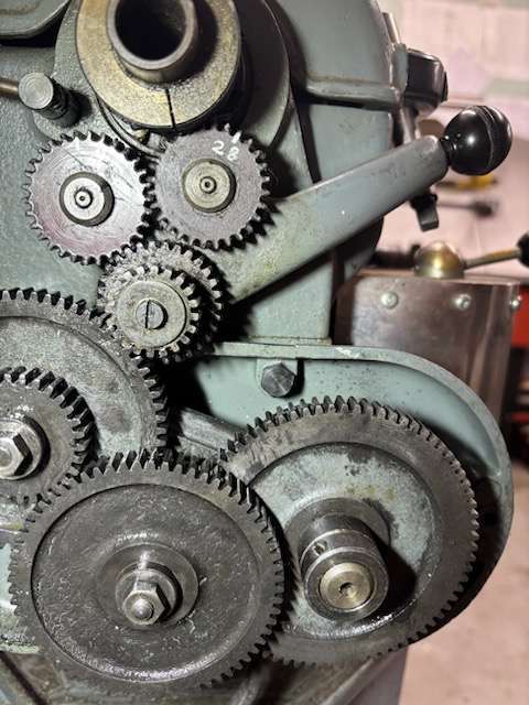

                                  The other possible reason for the miss match being parts swapping. Over recent years there have been a lot of Myfords broken for parts posted on Ebay so the likelyhood of a ‘bitza’ is quite possible.
                                  I don’t understand the reluctance of the OP to ring Myford and ask rather than continuing to fixate on holes drilled wrong on day one more than 50 years ago. Admittedly it’s easy to understand hole positions, but also easy to drop a lathe while staggering down the back garden path from the shed before loading it into a van with an oops I’ll have to get another lever off Ebay.

                                    looking at the pictures i noticed the change gear backplate has a crack, indicating a hard life or some form of impact.
                                    The tumblers gears 30T & 28T need replacing. Regarding the Tumbler reverse lever check for damage, has it been repaired, misplacing the gear stud holes.
                                    I use to visit myford on a regular basis and in deed the fitters used a jig for drilling the three holes.
                                    #848316

                                      Julian, I apologize, I don’t know where “Justin” came from. All I can think is that it was 11:30 at night and my cat was on my lap trying to climb onto the keyboard!
                                      I agree with all of the above comments, all I am trying to do is provide a means of determining if the dedent holes are correct so Julian can eliminate one possible source of error. I also consider the gears themselves to be most likely the problem.

                                            Swarf Maker
                                              @swarfmaker85383
                                              I have an S7 in excellent condition and my ‘Tufnol’ gears are fully formed and unworn. There is next to no backlash between the gears in either locked position.
                                              To prove my point regarding root diameter of the 30T gear, 4 thicknesses of copy paper inserted between the spindle gear and the 30T idler, reproduced the issue very clearly.  The lock could not be engaged by quite some distance.
