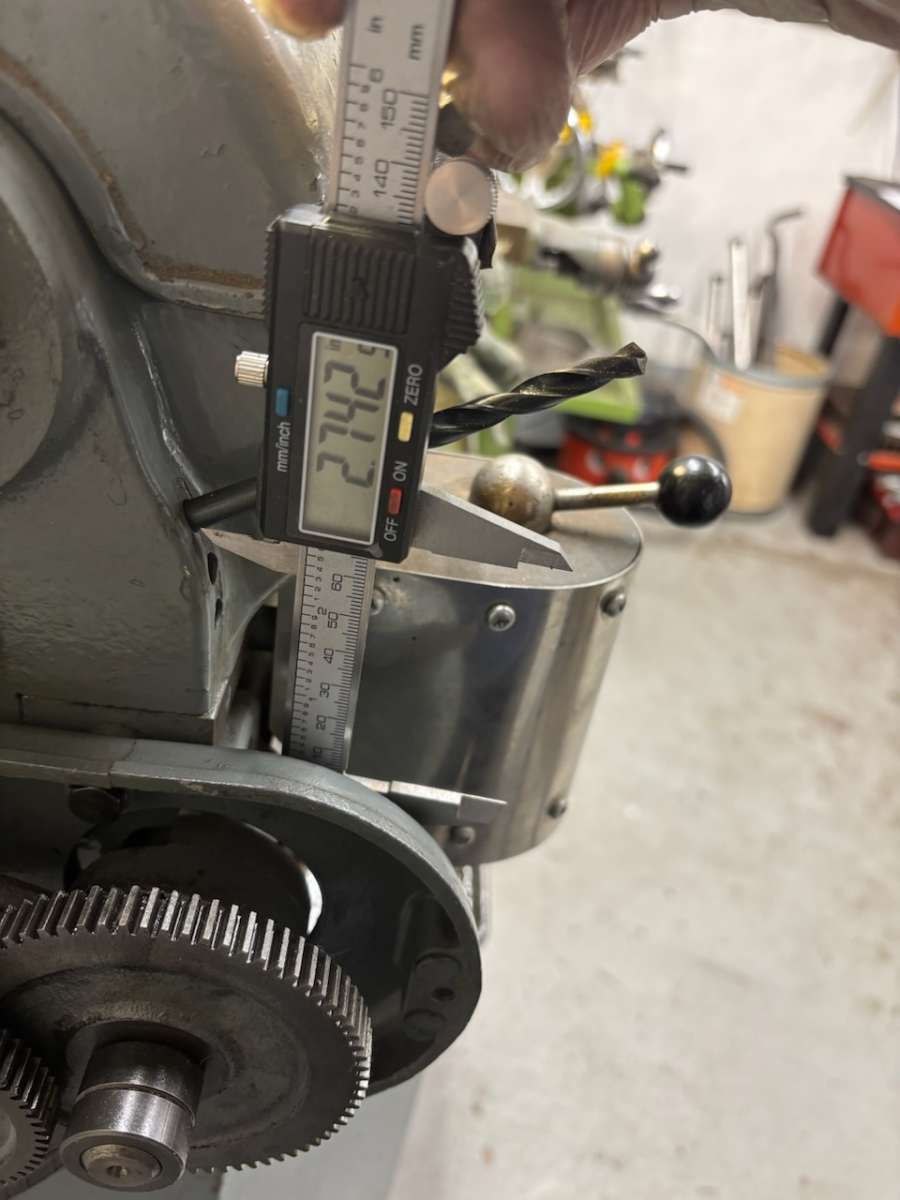

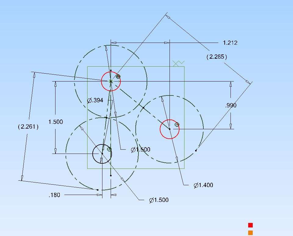

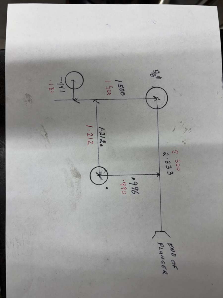

              On John Purdy Said:
              Julian
              I have taken the tumbler unit off my lathe and mounted it on the milling machine to take some measurments of the spacing of the various parts. I centred the 5/8″ dia pivot under the spindle and orientated it so the centre of the dedent pin was on the same line as the centre of the pivot pin. The readings were by eyeballing the centre of the gear pivot pins so may be +- a little, but should give you an indication of if perhaps the the lever has been changed at some point.
              Tumbler
              Tumbler measurements
              John,
              Thank you so much for taking the time to share the dimensions. I borrowed your technique (I’m learning so much from this forum!) & measured my lever in comparison to your drawing. My dimensions are in red & look to be very similar apart from the distance from the end of the plunger and also the offset of the bottom left tumbler gear shaft…..IMG_2961

                On John Purdy Said:
                Julian
                Here is another dim. you might check. On my lathe, 1976 S7B, the distance from the bottom of the front lathe shear over the top of a 17/64″ drill shank in the top dedent hole (it’s a nice snug fit) is 2.740″.
                Thanks once again John,
                Apologies but I’m a little unsure exactly where the ‘bottom of the front lathe shear’ is. I’ve enclosed some further photos but it’s quite hard to see in the images….IMG_2960IMG_2962

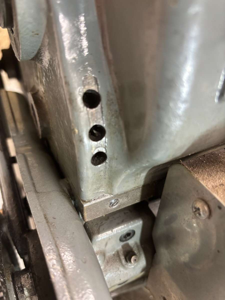

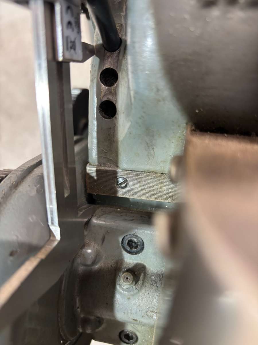

                  Thank you all for taking the time to help me out, I’m bowled over by the generosity of the forum members.
                  I’ve enclosed an image of the location holes & the witness marks made by the plunger demonstrate the issue.
                  I’m resigning myself to either ‘just living with it’ or possibly modifying the lever in some way…IMG_2963

                    Plotting the red dimensions in CAD there is very little difference between the pivot point and the PCDs that will mesh with the gear below so I doubt the 4thou would account for your problems unless as I said the gear has not been cut correctly gears

                      Ah ! That’s interesting, the witness marks on the headstock. I wonder whether when the lathe was delivered to Julian it was clouted, bending the lever ? Where abouts are you Julian ?    Noel.

                                    John Purdy
                                      @johnpurdy78347
                                      Julian
                                      This is how I measured the 2.740″ distance from the bottom of the front bed shear to the top of the 17/64″ drill shank.
                                      Dedent

                                        Above and slightly to the right of the bolt the is holding outer gearbox cover is a line. Is this a casting mark or is it a crack? If the latter, is it poossible that that the entire geabox cover has been pushed upward and is now fouling the tumbler gear lever?

                                          It looks as if the Tumbler Reverse Lever travel between correct meshing in forward and reverse could be OK – it’s just that the lever doesn’t engage in the holes.
                                          If this is the case then it would point to the lever locking pin being in the wrong position in the Tumbler Reverse Lever. Maybe this corresponds to the item intended for the ML7 Connoisseur which lists a different part number for this item  (73/1208) from that for the Super 7 (A1948/1). Frustratingly I have been unable to check that the Connoisseur uses the 28/30 tumbler gear combination. Somebody confirm or otherwise ?

                                            Really, the best bet here is to find what is any part-number is marked on the lever and the tumbler-gear cluster, and ask Myfords! May be an idea to note the lathe’s serial number, too.
                                            Examining the various replies and the photos I suspect more and more that a previous owner has fitted Myford replacement parts but the wrong ones for this version.
                                            The detent can’t be in the wrong position in the lever, but the lever might be the wrong one for the Super-7!
                                            The lever and tumbler frame will be Myford but might the gears be non-Myford? I don’t know if that would make a difference.
