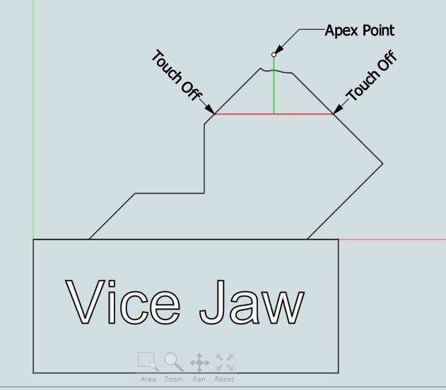

      I need to cut a 90 degree Vee groove in a block. The part set at 45 degrees in the vice since I don’t have a 45 degree cutter big enough for the Vee groove size.
      Problem is that I have blocked everything up accurately and need to find the theoretical point of the top of the workpiece to set my cutter datum zero point. I can locate center on X and Y easy enough, it’s the cutter height I struggle with.
      To make things even more difficult I have a tolerance of 0.02mm. How do I accurately set the Z axis cutter height?

          Hi Emgee, here is a picture, note that it is deburred at the point. Sure I can use trig to calculate the theoretical point, but that don’t help to actually set the tool height zero (as far as I know)
          The red is what I need to machine, the arrow shows that I simply can’t touch off due to the part being deburred already

            • Mill a small chamfer to replace the deburred edge.
            • Measure the width of the chamfer using a travelling microscope (to give required accuracy).
            • Multiply the width by 0.7071 to give the cutter height correction needed.

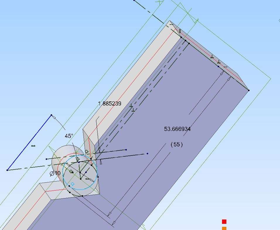

              On a job like this it is often better to start with oversize stock, cut the difficult feature, in this case the Vee and then bring the overall down to size.
              As you have it set up already I would say rough out the Vee to give a decent size notch. Place a ground rod (cutter shank) onto the horizontal cut & touch off on the top of that. Then with a bit of additional trig you should be able to work out how much lower the cut needs to go in relation to the short edge of the block.
              In the example below the finished position of the rod is 55mm from the end, as you say you can set X then with the rod resting against the finished X face and roughed Z face measure the length, subtract from desired and the cut should be 1.414 x the difference between measured and desired. You can use more decimal places if you want teh accuracy such as 1.4142136
              height

                                    If you mount a tool in your mill chuck and ‘touch off’ from any depth along the end face and the top face, then half that distance will provide the centre distance between the two faces. If you then raise the tool by the same amount it will be precisely positioned over the missing apex point.

                                        I like Blowlamps suggestion due to it’s simplicity. However, I have just thought … what if the block was to be set at 30 degrees? how would the center be found and the theoretical point be found?

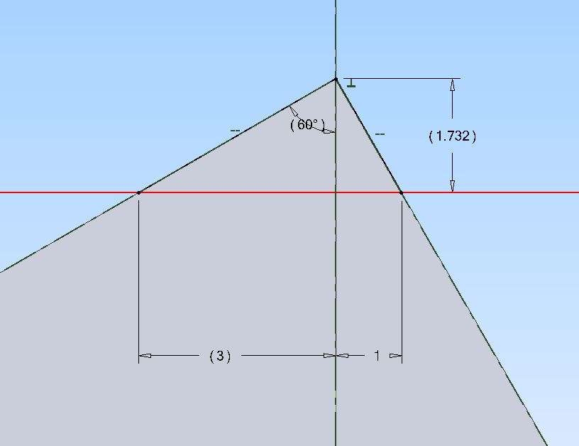

                                              JasonB I just tried blowlamps suggestion on a 30 degree block. I drew it in CAD. Using blowlamps suggestion I cannot find any way to locate the center, even using trig?
                                              Yes, The red Vee groove is what’s needed to be machined, it’s not a feature already there.
                                              Sorry to throw a spanner in the works with the 30 degree angle, lol
                                              #822201
                                                30deg works out quite easily.
                                                Take the triangle formed by the two toch off points and the missing tip and split that into two right angled triangles.
                                                The proportions horizontally will always be 1/4 and 3/4 for 30deg so move the tool over 1/4 the actual metal to metal distance plus half it’s diameter to put the spindle over the imaginary corner.
                                                Trig of the smaller right side 30/60/90 triangle will give the height to the corner, you know the bottom edge length is 1/4 of the total and you know the opposite and adjacent angles so that is more than enough but will always be 1.732 x (distance/4) as the Tan of 60 deg is 1.732 x 1
                                                You could also work the height from the larger left side triangle using tan 30  x 3 which equals the same height

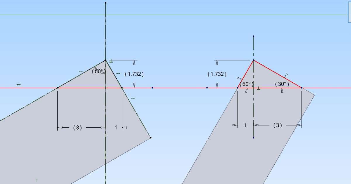

                                                    Edit I posted this before seeing your reply, will add a bit more in a minute.
                                                    I should say that the same trig applies if the work is 30deg from vertical or Horizontal just reverse it round.
                                                    corner 2
                                                    For angles other than 30/60 draw it out as I have and set one of the horizontals a 1unit long, the CAD should work out what the other horizontal is and this will give you how far to move the tool horizontally (X axis)

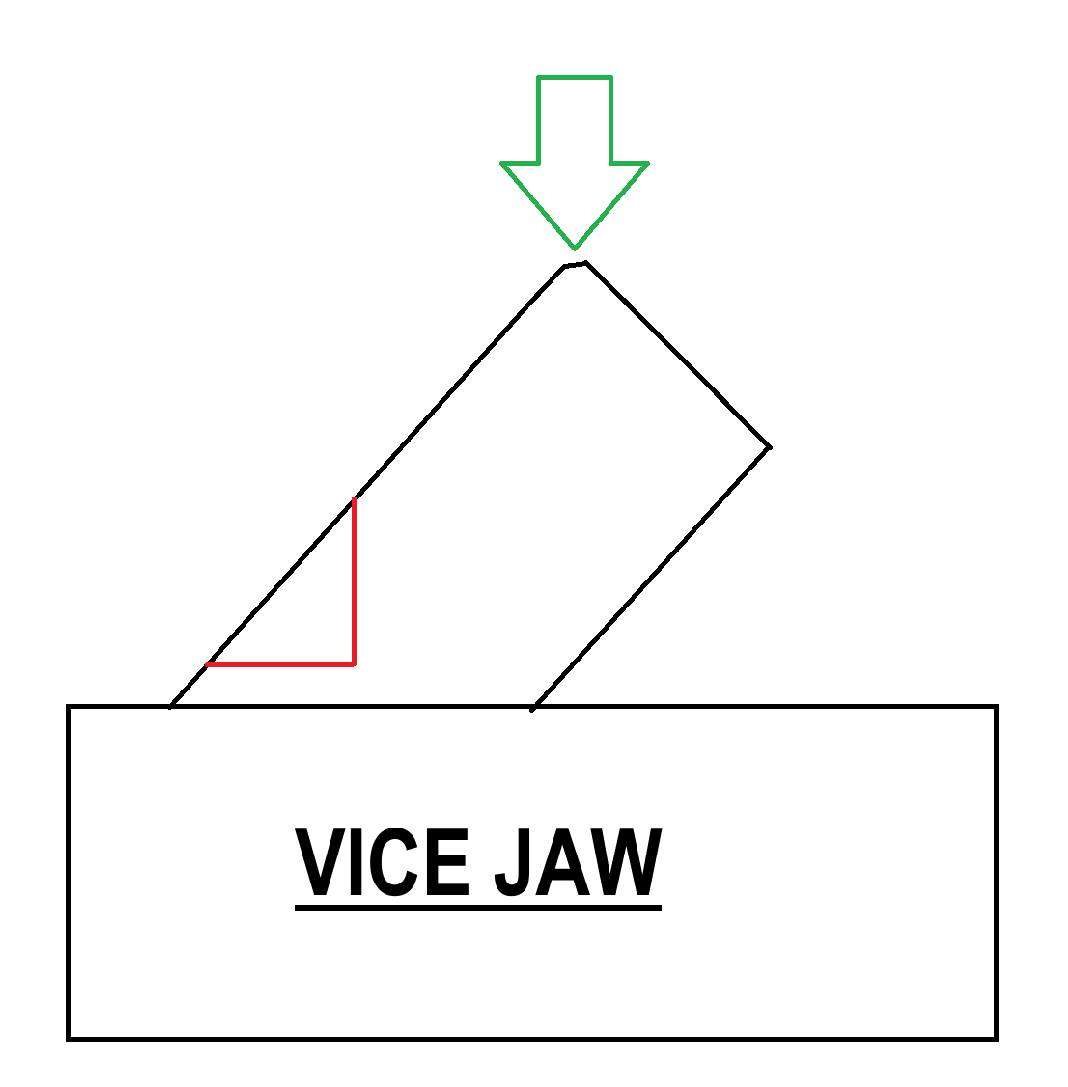

                                                      Try this: Clamp a flat to the under edge that is sloping up to the right in your diagram. Sit a clean good square block (or other known shape) between that and the uppermost surface. Actually a round might be best. This gives you an new good top point with an offset that is easy to calculate from the size of the workpiece and the size/shape of the block.
