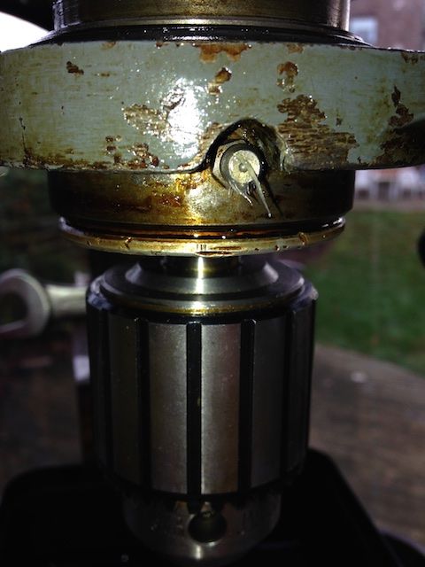

I cannot attach the grease gun to the nipple on the quill, number 82? The nipple is enclosed, and the gun attachment is too big? I've taken the gun attachment apart and it is obvious that I cannot file or turn it down, it is very thin. The photo below is the nipple in question:
I feel I'm missing something really obvious, I've searched online for 'small' grease gun heads but all I can seem to find are regular grease gun heads on small capacity bodies?
