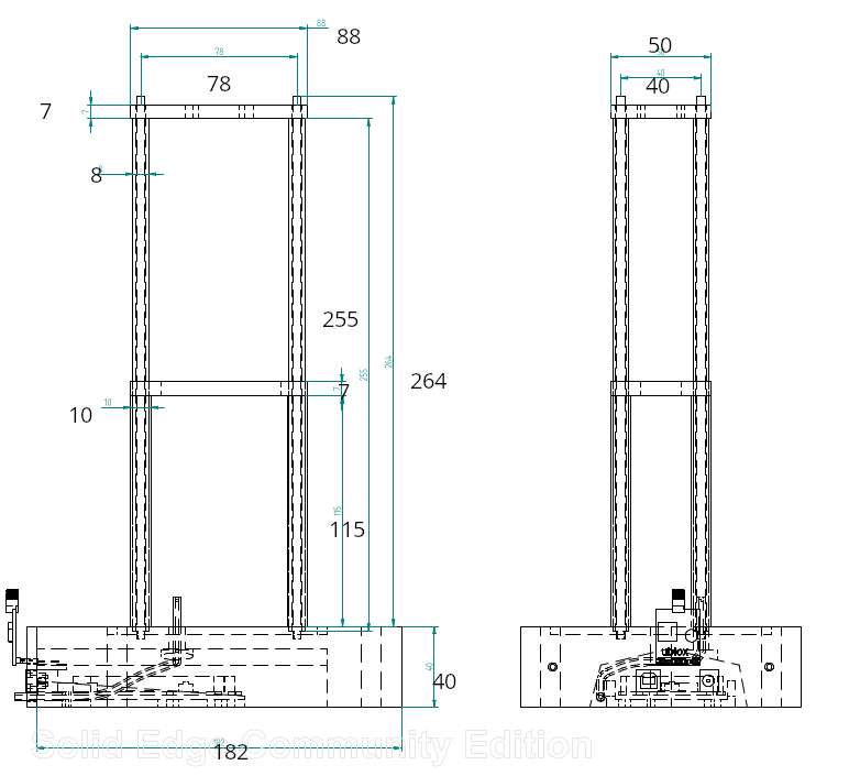

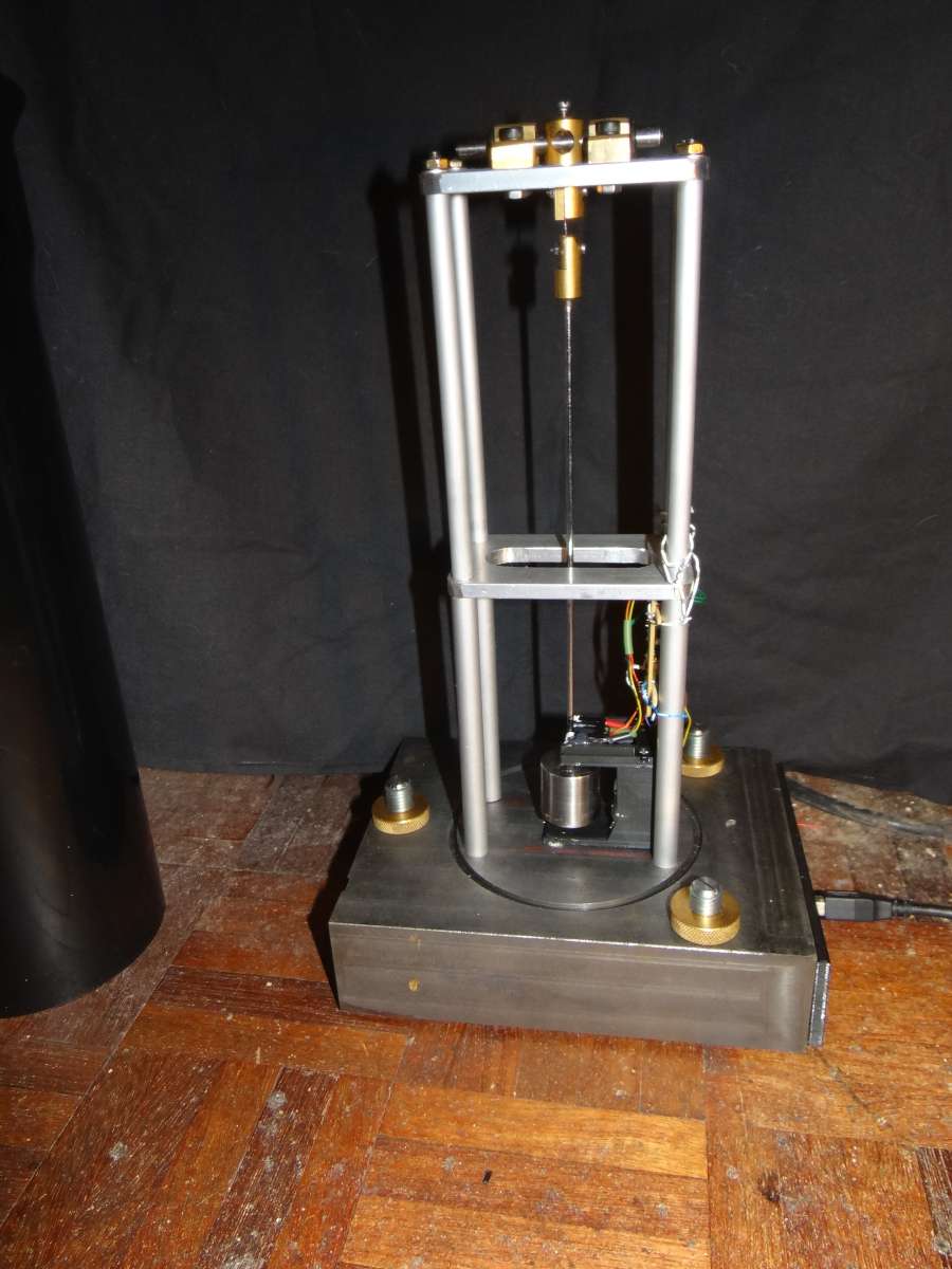

        The stand:
        DSC06987
        Drawing:
        Screenshot From 2025-11-11 21-51-31
        Description.
        Four 264mm long M4 studs are screwed into the base, in a 70x40mm rectangle.
        The studs are sleeved by four 8mm diameter tubes, forming the inner pillars.
        The inner pillars are recessed 2mm into the upper platform and the cast iron base.
        The 8mm pillars are sleeved by sliding fit 10mm diameter tubes, the outer pillars, up to middle platform level.
        The top platform is pulled hard down on to the inner pillars by the studding.  The M4 studs are under strong tension and the inner pillars are strongly compressed.
        The outer pillars are loose.  They and the mid-platform resist bowing.  The middle platform is a tight fit on the inner pillars, but not otherwise fixed.
        The top platform carries the pendulum suspense.  An axle allows the pendulum to hang straight, and the spring holder can be slid along the axle to align the rod with the photo-interrupter at BDC.

        #824070
        duncan webster 1
          @duncanwebster1
          What’s the bore of the 8mm tubes
          #824076
            Whoops, 1mm
            And it’s seamless Aluminium.  Alloy unknown, not soft, and it machines OK.
            Ta,
            #824090
              May we presume that 1mm is the wall thickness, not the bore ?
              … or have I completely lost the plot ?

                  #824103
                    Thickness!
                    And speaking of being thick, I’m wading through this topic to make sure all the sugary goodness is extracted, and it’s exhausting.  My brain being reduced to mush explains the mistake.  Either that or the weather.

                      #824111
                      duncan webster 1
                        @duncanwebster1
                        Assuming
                        1. 8mm tubes are rigidly fixed to top and bottom plates
                        2. 8mm tubes are rigidly fixed to centre plate
                        3. tie bar is rigidly fixed to top and bottom plates
                        4. 10mm tube is a tight fit on 8mm tube so it adopts the same shape, but slippage occurs at interface
                        5. top centre and bottom plates are rigid
                        I make the overall stiffness to be ~600N/mm. For comparison, a 75 OD 1mm wall tube would be ~5300 N/mm. I don’t think I can readily post a SMath document here, if anyone wants a copy send your email via pm.
                        Assumption 1 is reasonable, the others less so. I’d expect the real stiffness to be lower
                        The actual side load is (mass of bob) * g * tan(half angle of swing), so pretty low
                        If I were to set about something like this, I’d have 4 big squat pillars at the base to allow access to the gubbins at the bottom and a tube with a flange top and bottom to support the top gubbins. You then need a cellar to put it in (fairly constant temperature) and a foundation taken down to bedrock. Don’t hold your breath
                        #824115
                          Good to have some baseline figures, Duncan … Thank you
                          I note, and respect, the inevitable raft of assumptions.

                                  #824161
                                    Hard slog today, mostly bringing the Design Overview up-to-date, whilst trying to get the micro-controller to measure Q correctly.  Nearly finished, 27 pages…
                                    Q now working on the microcontroller so I was able to make a few impromptu tests.  In short:
                                    • Putting the clock on the floor doubles Q provided I sit very still and don’t touch the table.
                                    • Touching the table, typing etc, reduces Q by about 10%.  I guess force travels down the table legs into the floor. The nearest leg is only 600mm from the clock.
                                    The floor is teak panels on concrete.   Other parts of the house show the concrete was smoothed with scrim, to which thin vinyl tiles are glued.  The teak panels are on top, probably with a thin underlay, so not unambiguously solid.  Maybe leaning on the table tilts the teak panel underneath slightly and the clock moves.
                                    Need to write a Python program to graph the log.
                                    Decided my house is no good:
                                    • Utility room: Quarry tiles, but full of vibrating white goods and a pesky cat.
                                    • Downstairs bog:  carpet. too close to hall
                                    • Hall: carpet.  too busy
                                    • Kitchen.  Laminate floor on concrete with thick underlay.  Flexes when walked on.  Busy.
                                    • Dining Room:  I’m set up on the dining table.  Busy
                                    • Front room:  Busy. Maybe behind the telly.  Busy
                                    • Garden shed:  maybe – would have to be cleared out.  No power, but could run on a battery.  Might be in wifi range.
                                    • Upstairs, bendy wooden floors and carpets
                                    Next, look at Duncan’s maths, and have a go at how to set the clock.
                                    #824167
                                    duncan webster 1
                                      @duncanwebster1
                                      Screw a substantial bracket to a wall, or even better a strong triangular shelf in a corner sat on 2 bearers screwed to the wall. That is assuming you have brick or block walls
                                      #824174

                                          #824255
                                            On SillyOldDuffer Said:
                                            Looked at Duncan’s Smaths sums.  They quantify how much the pendulum’s support will flex due to swinging the bob.   Though the answer is ‘not much’, tiny movements cause trouble.  I will have to look at ways of stiffening the support structure.  Won’t be easy in the space available. […]
                                            Dave … I regret to say that ^^^ probably underestimates the scale of your challenge.
                                            Duncan’s stiffness figures [and caveats] seem entirely reasonable, but they are orders of magnitude too small for your intended purpose !
                                            I have no doubt that motion of the pendulum support needs to be limited to a few tens of microns if significant interference with your control system is to be avoided.
                                            Ref. The Huygens experiment !
                                            Although domestically difficult, I suggest you seriously consider finding space for a 400mm cube ‘Concrete Lego Block’ to be placed on a solid floor, with a truncated pyramid framework atop.
                                            #824309
                                                We’re agree!  But, with respect, I’m not underestimating the challenge.  The issue is acknowledged.
                                                I’m not rushing to tackle pendulum support because so many other aspects of this clock are still under investigation.  The physical clock is designed to fit into a small space as an experimental platform.  I’m deploying technologies and techniques not available to Shortt, notably deep statistical analysis of clock performance and their application  to a novel method of compensating  pendulum defects that might deliver significantly better accuracy.
                                                As the approach won’t fix gross mechanical errors,  it’s necessary to address them.  Not my main priority though.  At this stage I’m more targetted on running experiments, which is why this thread is about measurement, though thread drift is welcome – loads of good ideas coming in.  There is no actual evidence that the pendulum support significantly interferes with the control system, therefore fixing it is low priority.  When the clock is fully loaded with software, located safely on a rigid platform and evacuated, I’ll do a learning run.  Like as not that will reveal errors attributable to structural wobble.
                                                This clock isn’t a one-off.  There was a prototype, followed by the Mk1.  The Mk2 is a work in progress, still on the launch pad.  Pretty sure there will be a Mk3, but it won’t happen until I’ve thoroughly milked Mk2, good bad and ugly,
                                                Unless!  I’ve nearly finished the Mk2 Clock Overview, about 30 pages of description.  Should be ready for publication tomorrow.  John and Duncan commented on the draft, causing several upgrades, plus changes due to this Topic.  Lego blocks are listed in Annex E.  More comment is welcome.
                                                I’d be delighted if someone else used the Mk2 Overview as a springboard to an improved clock incorporating their ideas.  For example, if Duncan or John saw any value in Arduino code that takes commands from a PC, maybe telling their clock to measure Q, then they can have it.
                                                Can’t claim the Overview is an easy read!
