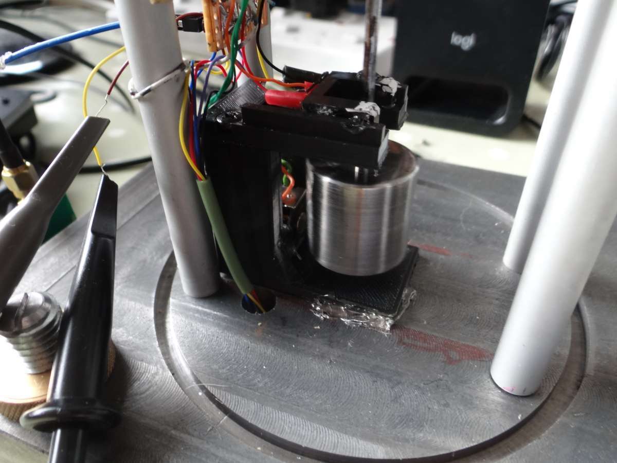

        Quick report.  I got the Q code to run on command.
        • Accepts command – OK
        • Stops impulsing – OK
        • Per beat calculator call – OK
        • Reports answer when amplitude reaches target – OK
        • restarts clock – OK
        Correct answer – NO!  Q=0, the calculation is wrong.  More work.
        During testing noticed that my pendulum was taking a suspiciously long time to decay.  Another bug. I assumed setting impulse to zero would result in a zero length pulse.  Nope, the code turns the electromagnet ON, then starts a timer to automatically switch it off when the impulse is complete.  Unfortunately that emits a short pulse during the time it takes to start the timer, about 70uS.  A 70uS pulse isn’t enough to keep the pendulum going, but it sure keeps it swinging for a long time.
        Cure: when testing Q, the code mustn’t turn the electromagnet on at all.  Pesky details.
        Arduino aficionados will have spotted a 70uS delay means I must be using digitalWrite().  digitalWrite is notoriously slow because it does beginner friendly error checking.  I’ll change to one of the faster alternatives that trust the me to get everything right.  What could possibly go wrong…

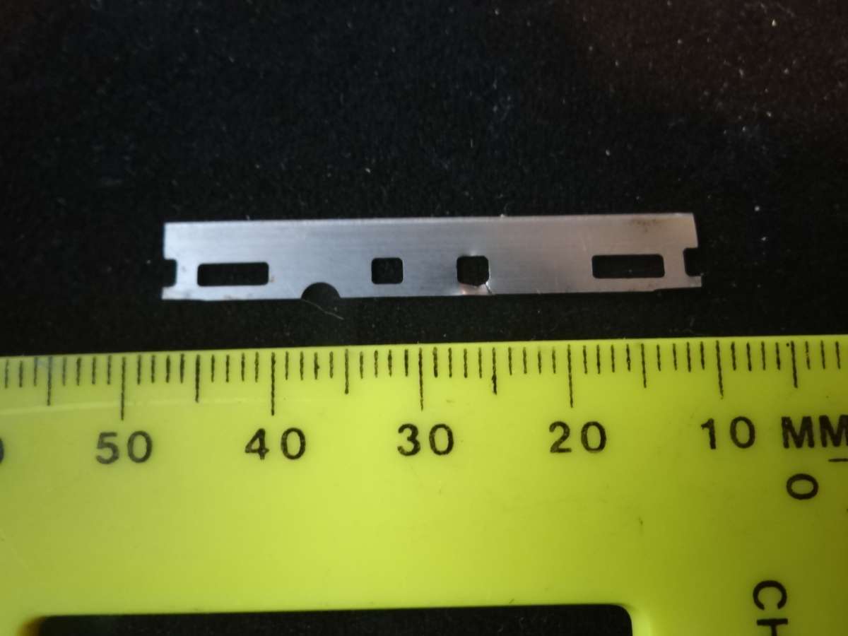

                Yes, and it’s chief suspect.  Earlier I used a modified disposable razor blade successfully until I broke it.  The replacement blade came from a different brand, so the steel might be unsuitable.  Both stainless, but apart from that, properties unknown.   Possibly the replacement is only hardened on the edge.  I didn’t think to test it.

                  Can you spare a feeler gauge finger? A razor blade’s stiffness may vary across its width which might induce twist.

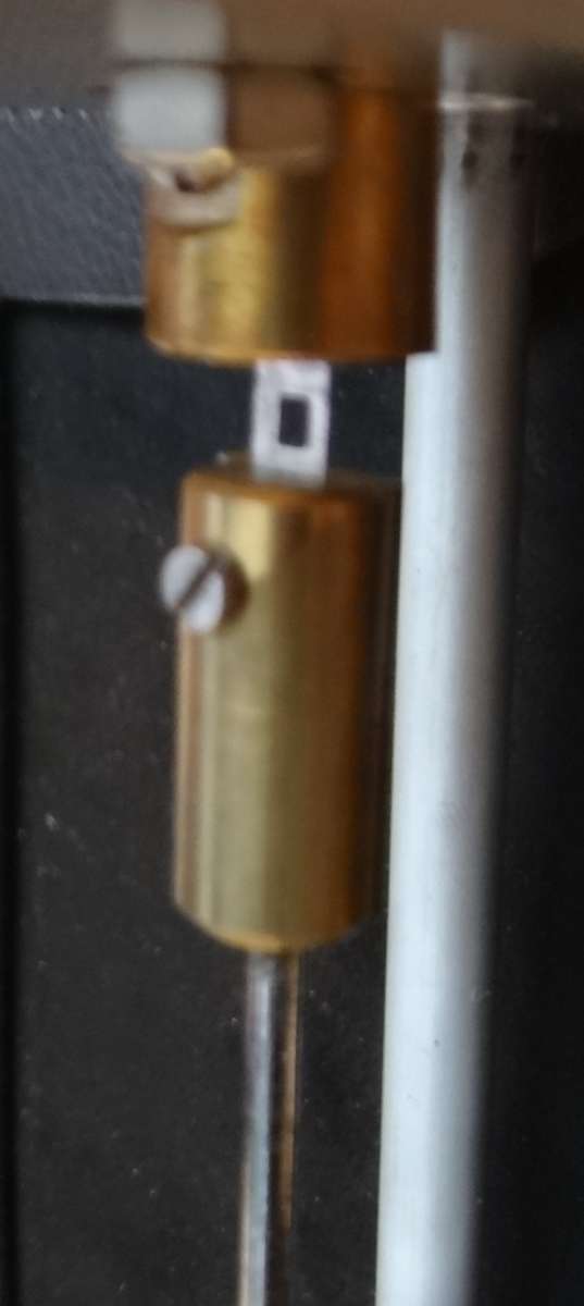

                                Here’s a photo of a similar blade.  Came from a triple-bladed razor, and the holes and notches punched in them are different.
                                DSC06981
                                I ground the edge off with a Dremel, taking it back so the spring is symmetric about the holes, though I didn’t do a good job.   The blade is 0.1mm thick.
                                In the clock, the blade is fitted such that it flexes across one of the square holes, so the amount of metal bent is rather small, 2x 0.94mm!
                                DSC06982
                                Passes the twang test, so springy.  Bending back with pliers, the example returned to straight up to about 270° before snapping cleanly.   Hard and brittle – on the face of it, an OK spring.
                                There’s a thin hair caught on the bob, plus detrital dust.  Might be that.

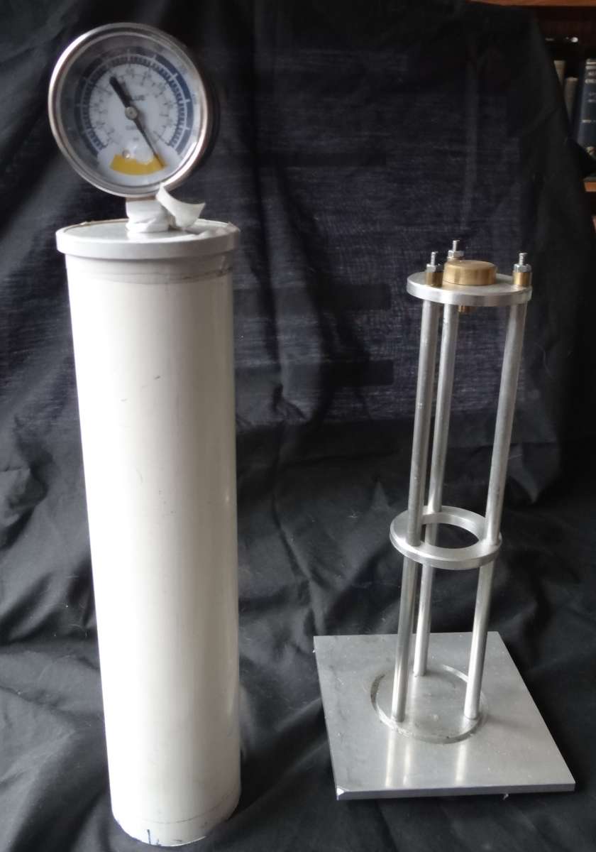

                                  Yes, except the much heavier bob.  The clock is designed to swing the pendulum in a vacuum, which constrains it’s size and weight.   I’m hoping a small pendulum in a vacuum will out perform a big heavy pendulum in air.
                                  My lathe can face the end of an 18″ long 4½” soil pipe without too much bother, bigger is problematic.  Ditto grooving the 180 x 150mm cast-iron block.  The support tower has to fit inside the pipe, leaving little space for a bigger bob.  Denser metal maybe but the extra mass may be too much for the existing electromagnet.  It’s all interrelated.

                                    I’m wondering how problematic it’s going to be in keeping the soil pipe from imploding once under vacuum. It’ll probably have over a thousand pounds distributed over its area and If it doesn’t retain a good circular cross section, then it might well collapse.

                                        Me too!  The base is locks into a groove, and the top will be reinforced with a 5mm thick Aluminium disc.  On the plus side, I’ve tested the prototype enclosure to below 600mb, and it didn’t bend noticeably.  Pipe dia 72mm, height 300mm, wall 2.25mm thick.
                                        DSC06983
                                        The maths is beyond me.  AI suggests “The cylinder will buckle (crush) at approximately 56 kN or 144 atm external overpressure. Use a safety factor of at least 3 for vacuum applications.”
                                        However, running the numbers for the larger pipe is bad news:  a standard 3.2mm thick soil pipe will crush at about 83% of full vacuum.  Might get away with it because my pump isn’t that good! Otherwise Plan B is to run the clock at reduced pressure, 800mB, 20% of full vacuum, maybe 40%.
                                        A 3.5mm thick pipe (heavy duty) should survive a full vacuum, though the safety factor is low.
                                        The standard for these pipes specifies ‘at least’ wall thicknesses.  Mine is 3.72mm thick, so has some extra margin over 3.5mm nominal.
                                        Don’t know how low my pump will go if all leaks are sealed and it’s left running for ages.   Very difficult to pump a hard vacuum, and I expect the PVC to gas long before I get near.  Holes might pull through the plastic long before I get there.   Using PVC because it’s cheap and available, not because it’s the best material.
                                        Yup, I’m expecting trouble!

                                          Can you suggest how that might be done?   The prototype tower had 3 pillars (see above), discussed on the forum, and I think Duncan persuaded me to use 4 pillars. (I thought 3 for kinematic reasons)
                                          The Shortt-synchronome uses the metal vacuum tube, not a tower, it bolts to the wall.  Hard to make.
                                          shorttPsupport

                                            Using four relatively slender pillars with single-point fixings doesn’t really inspire confidence.
