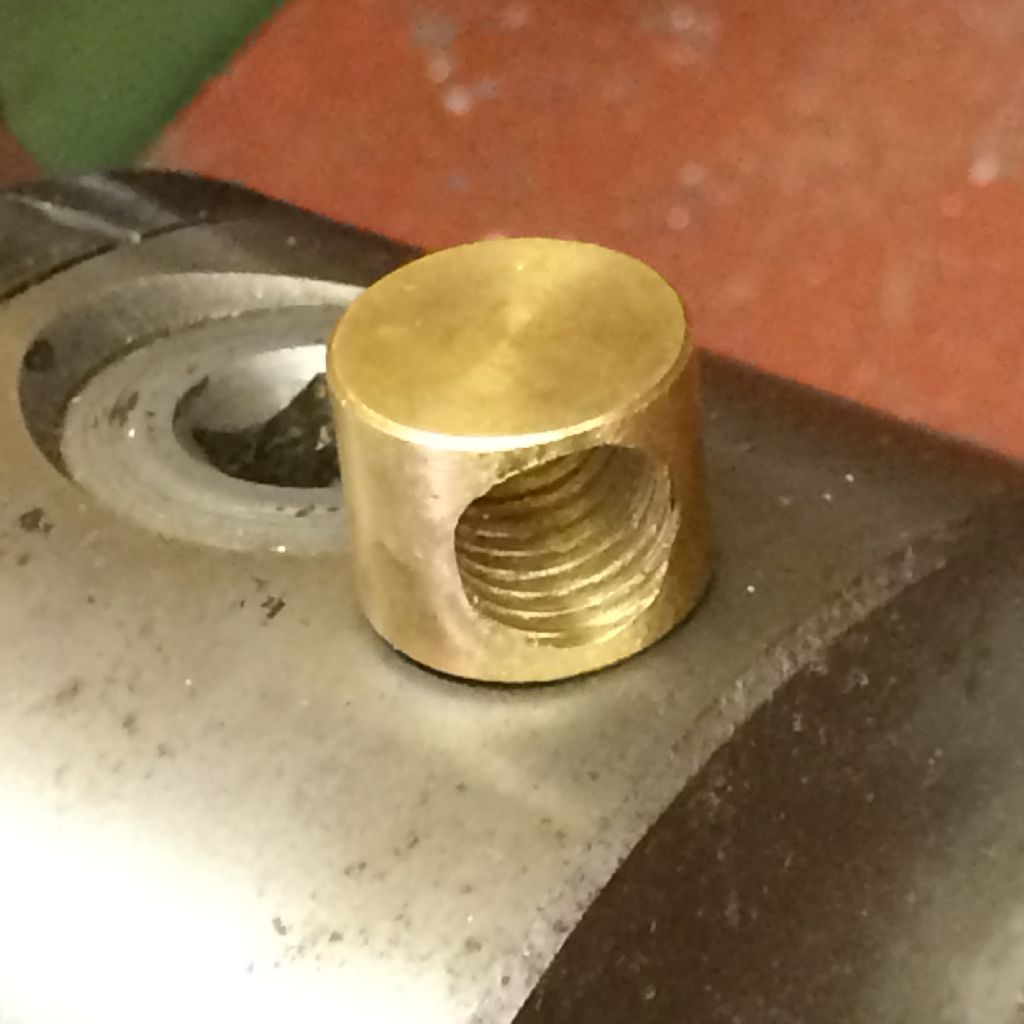

        hope some one can help, i have a mashtroy (warco) 220 lathe and the brass bush on the topslide has worn out, it looks like a acme type thread and is 10mm or 3/8 dia and the tpi is 18. Does any one know of a tap that is suitable to make a new bush or maybe someone knows of a replacement. Warco has been no help and i have emailed the original company who were helpfull but so far can not identify my lathe.
        Also any suggestion as to why this should wear out so quickly, my lathe is 15 years old but has had very little use, i know the bush is quite small but is this a common problem. any help greatly appreciated.

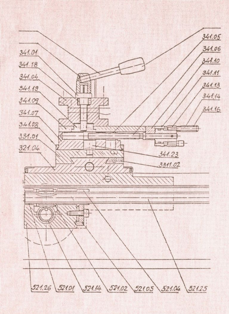

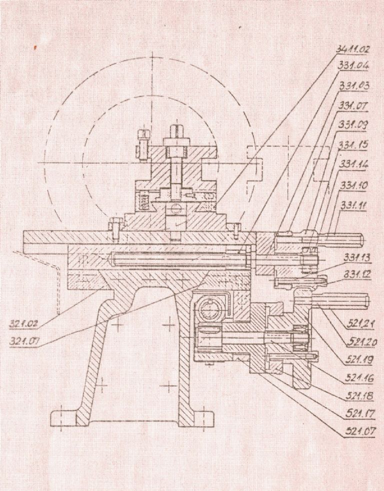

          Hi Dave, don't know if there is a suitable tap readily available, but I believe the Mastroy version is C210T. Below are scans of the carriage assembly with ID numbers which may help you source parts.
          Regards Nick.

              As you say the thread is acme this is presumably the feedscrew nut. 18 tpi would be useless as an imperial feedscrew as the pitch is not a useful subdivision of an inch. Almost certainly therefore metric (as my Warco 220 was). Try counting the threads against a mm rule, you should get a more sensible answer. Then you would need a suitable acme metric tap, maybe Tracy Tools may have one. The most likely pitch is actually 2 mm, but that would be more like 12.7 tpi. I can't remember actually what it was, actually I prefer to forget that lathe…
              hard to say why it has worn, but brass is not a good material to use for this purpose. If you made another one a bit of decent bronze would be better. What do you mean by worn out anyway? Are the threads stripped, or is there just a lot of play?

                thanks for the replies, it looks like a common fault on this lathe. John i will re count the threads in the morning and re post, The thread are nearly gone it started with a lot of play and quickly ended up as stripped. i think part of the problem is over tightening the 4 way tool post, it seems to put extra pressure on the top slide. 12.7 TPI or there abouts would make more sense as there are 10 tPI taps available.

                  Thread is 10mm x 1.5mm pitch trapezoidal IIRC. As you say, tightening the toolpost is a major cause as it forces the topslide to bend, tightening the gibs up. A very thin shim washer between toolpost and topslide would help to reduce that.

                              Having replaced the feed nut I slackened off the gib strips, then tightened the toolpost fully. Having done that, the gibs were then adjusted to give a smooth movement. Not an ideal solution as you are now running with a bent topslide, however, since you will not be attempting to use the lathe with a loose toolpost, it does make it workable.
