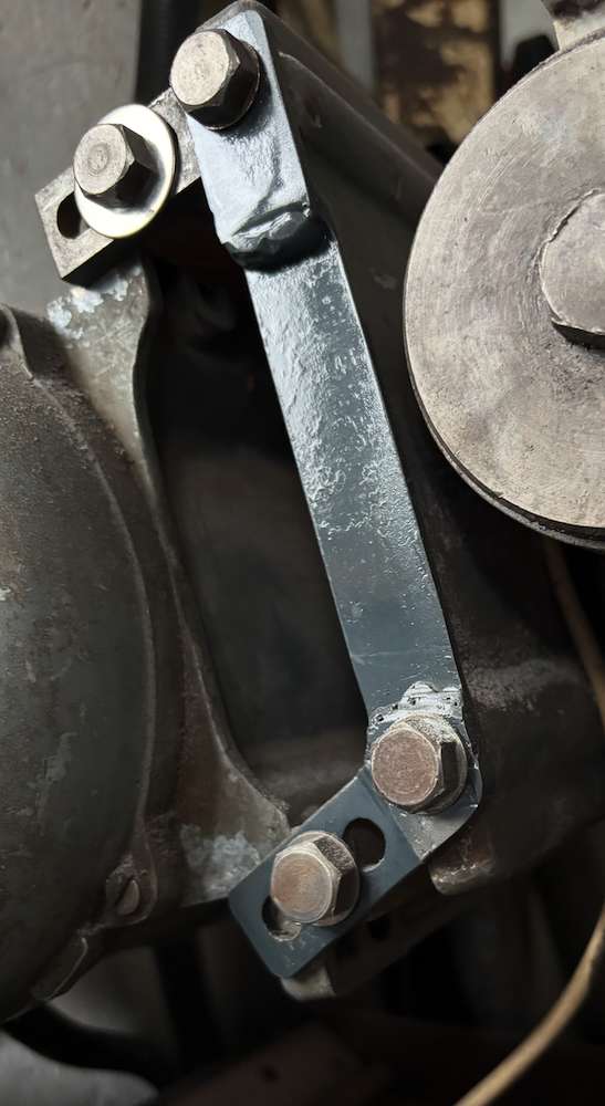

          I found getting the new belt to run true with the standard motor mount set-up of four short pivoting links a nightmare. I modified my set up to have a something closer to simple pivot set-up by fixing the angles of the lower arms and replacing the slot with three 11/32″ holes at 7/16″ spacing. The slot in the top arms allows a bit of twist if needed to get the motor and spindle shafts aligned.
          6) Motor Mount R
          Much easier to set up.
          PM me for PDF format drawing if needed.
