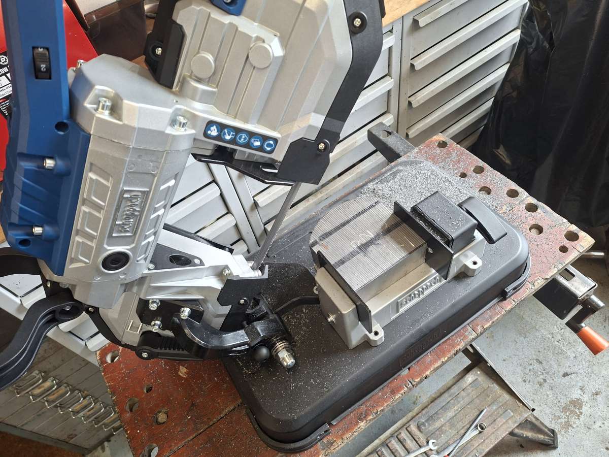

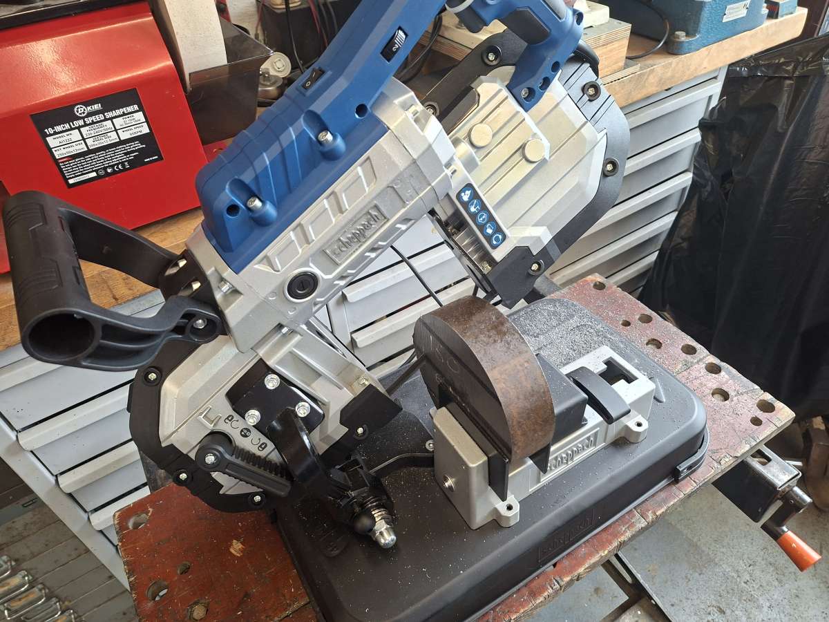

                                            Chris Kaminski
                                              @chriskaminski64716
                                              For those with small budgets and tiny workshops… one of these might do.
                                              Only £179 (delivery included) and quite capable out of the box.
                                              I don’t like the vice (especially for sketchy setups like in the first pic)
                                              but it went through 150mm dia lump of EN8 like through butterab
