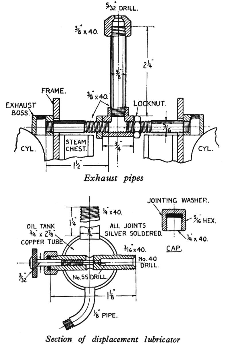

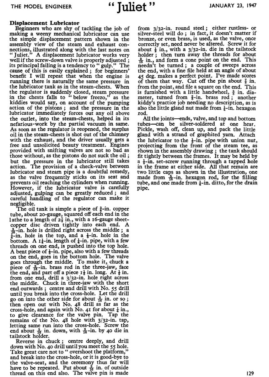

              Hi Beardy Mike, below is all I can find about Juliet’s displacement lubricator.
              PAGE018
              PAGE019
              Regards Nick.

                Wow, that’s excellent – looks a lot like what my loco has, although with a few tweaks. I take it that the 3/32 without a thread form stated should be taken to be bsw?
                Thanks,
                Mike
                #852982
                Nicholas Farr
                  @nicholasfarr14254
                  Hi Mike, seems like bsw is the only one that is standard for 3/32″ and perhaps that is why the thread form isn’t stated on the drawing, but I would still check the one you have, in case the builder choose something else.
                  Regards Nick.

                            Neil A
                              @neila
                              If the builder followed the instructions on the ME pages above, then the thread is most probably 3/32 Whitworth.
                              The clue is the No 48 drilled hole which is then tapped 3/32. The No 48 is the pre-metric tapping size for 3/32 Whitworth.
                              There is always a little uncertainty in what a previous builder used, it depends on the age of the build and what the builder had to hand at the time. I tend to use metric threads now, but that does not stop me using Whitworth if I think it appropriate.
