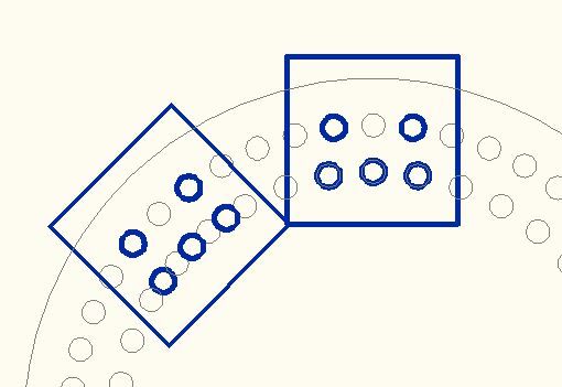

        I’ve ordered an indexing plate for my wood lathe. It has four sets of holes up to 60. I’d ideally like to go up to 72. Fortunately one of the rings of 5mm holes has 36 and there is space between them to add another hole. I did think it would be a good idea to make a small jig for drilling the holes accurately with a couple of 5mm pins and a hole in between. The problem is the new holes won’t be at the same radius as the existing ones if I use this. I don’t have a DRO on my mill and there is some backlash on the table. It’s not a deal breaker but do any of you have any ideas around this? I don’t have a rotary table.

                              2 of the 48 hole spacing is 15°. Use the existing 36 hole ring (10° spacing) to make a drilling jig for two of its holes and two of the 48 hole ring. Rotate the jig around 2 of the 48 holes and you should find the drilling jig is now in the midpoint between the holes and so can be drilled through in the intermediate positions you want. You now have a jig to drill the intermediate holes in the plate. Try it with a piece of card to understand this. It will require some pins to locate the drill jig on the plate.

                                      I've drawn up the concept of a drilling jig to show how this idea works.
                                      I've shown the drilling jig rotated 4 holes on the 48 hole ring to separate the two positions of the jig (I obviously made the pcd of the holes too small to give space between the Ø5 holes). I said in the previous post that a transfer punch could be used to avoid drilling in the existing holes but there are alternatives, depends on what equipment you have. If you have a metal lathe it is easy to knock up a small drilling bush to fit in the Ø5 holes with a Ø3 bore for a 3mm drill to do the initial holes. You would be able to drill one hole anywhere on the plate for a starting hole and then pin that to the plate to drill the other holes, pinning each hole as you go to avoid slipping between the plate and the jig as it is made. Note that you only need to use the existing holes once for spotting through so there will not be excessive wear on them anyway.
                                      I would suggest though that buying a few Ø5 ground dowel pins would be a good idea and a set of transfer punches will be of use in the future for other things.
                                      Martin C
                                      PS. It occurs to me you may need a Ø5 reamer in this process to make the jig holes hold the pins nicely.
                                      Edited By Martin Connelly on 30/09/2021 10:09:45
                                        Although not explicitly stated on the drawing that Vic shared … elsewhere on the supplier’s site, it is quoted as been 250mm diameter : so it does look like there is room.

                                            Thank you very much for your post Martin, and in particular for taking the time to do the drawing, its much appreciated. I did think of a transfer punch but I think the disk is too thin for that. I did also think of a bushing as I’d like the intermediate holes to be smaller anyway. I’m pretty sure I have a 5mm reamer. Once the disc arrives I’ll have a play on the computer to check things out.

                                                Ok, final update. I found a scrap of alloy and made up a jig plate using Martin’s idea and it seems to have worked out fine. Thank you again for that Martin, I certainly would never have thought of it!
