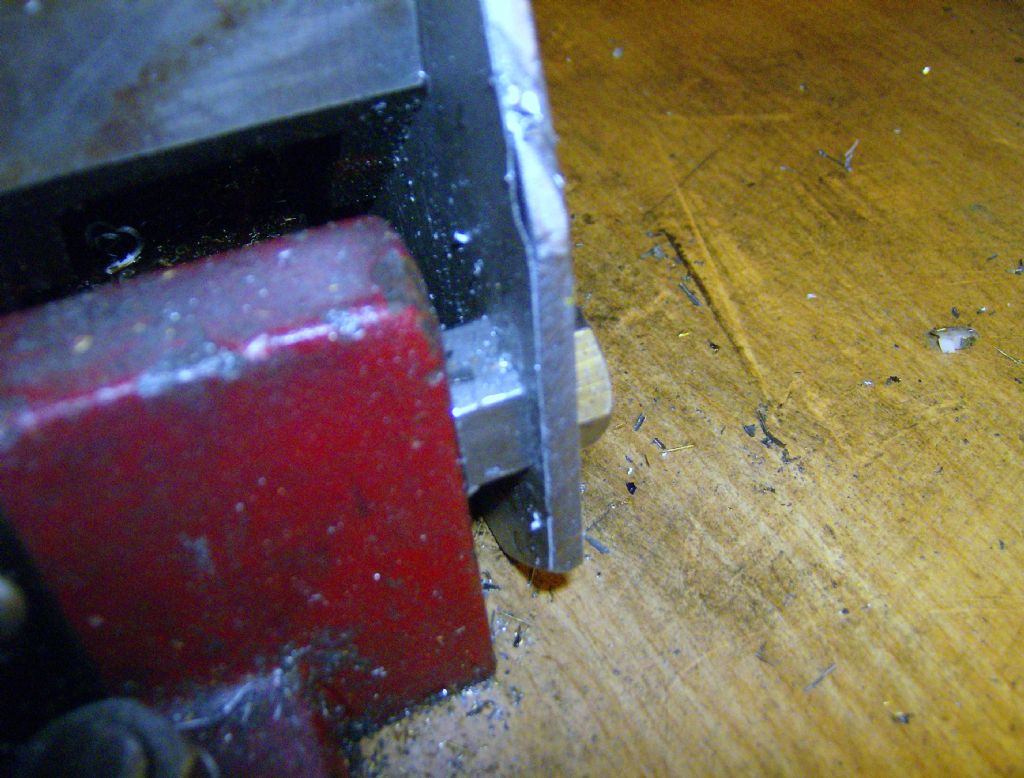

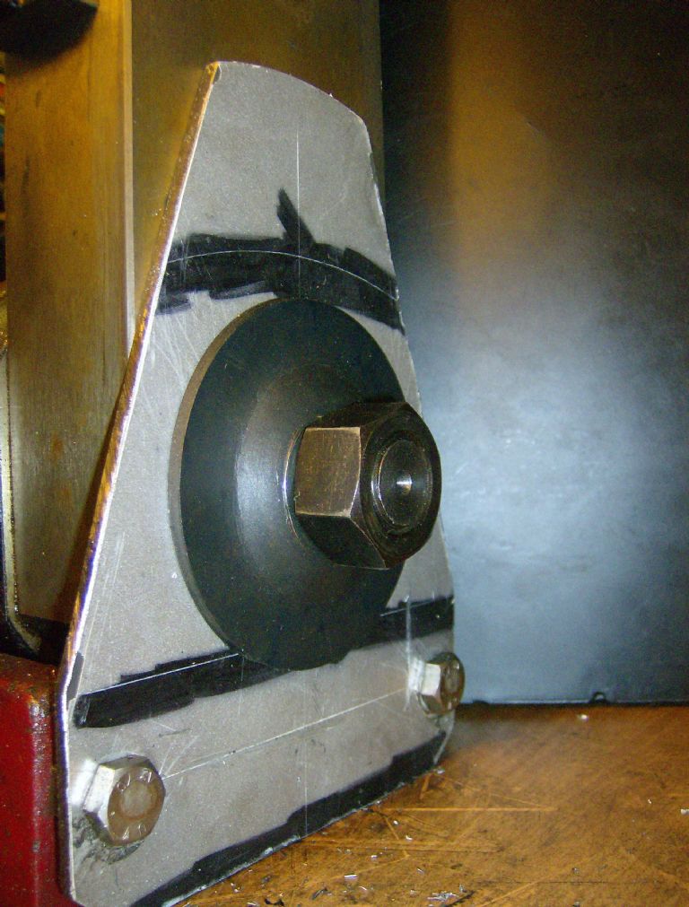

                Pic below shows the plate. 4mm thick, the screws are M12 and there are angled spacers to ensure it isn't distorted when snugged up.
                A taper pin could be fitted at the top of the plate, I haven't found one necessary but it could be beneficial.

                    Possibly, but the forces on the plate and are relatively small, it is a good 4" back from the (almost straight) line of screws around which the column pivots. Forces on the plate are tension (where it will be massively stiffer than required) or in compression. The two screws are 100mm apart and the vertical distance to the centre of the big nut is 60mm. The distance between the edges of the circular washer to the screwheads is about 25mm.
                    The amount of movement (without the plate) is probably only of the order of a couple of thou, with it in place I doubt any force that didn't break the machine would noticeably flex the plate.
                    #176854

                        The washer is original, the column pivots around the bolt.

                          Im confused (again!), if the column pivots about the main bolt how does the plate stop it from moving?
                          #176891
                            The bolt and spring washer is more than adequate for stopping the column tilting sideways (the supplied spanner is about 14" long).
                            The problem is that the bracket in front of the column that it bolts to is secured by three screws that are virtually in a straight line. The bracket and base also had poor contact on my machine and the combination of these two factors meant it had very little rigidity back and forth. Scraping the joint surface enabled me to eliminate a slight back and forth tramming inaccuracy and combined with the plate make the whole thing very much stiffer.
