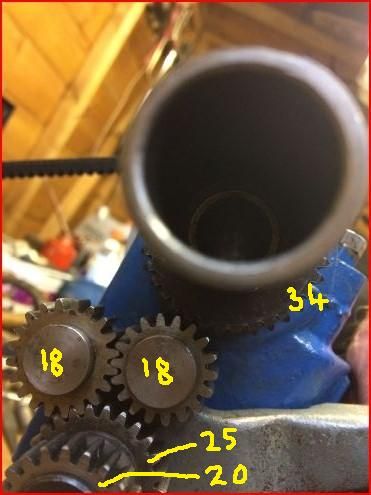

            Can you post an end on view of the situation so that it is possible to see the gears you have and count all the teeth?

              Brian, the earlier photos show 25T & 20T on the output of the tumbler with the 25T meshing with the smaller gears so the old setup would have been 30spindle / 25tumbler. This can't be recreated with a 34T so Carl would need 36T on the spindle and 30T on the tumbler to get back to the old 30/25 ratio.
              See post from 18th April at 1.02 and my reply after.

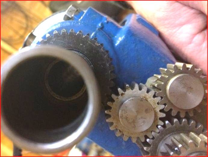

                Carl, while altering that picture above I was looking at your gears a bit more closely.
                Is the gear shown on the spindle the 30T or the 34T?
                My reason for asking is two fold
                1. It does not look to be the same gear profile as the others, maybe different DP or even MOD and a different pressure angle.
                2. If it is the larger 34T then it is not meshing with the tumbler when the lever is down as can be seen in this brightened photo

                  ​Thank you for labelling your picture, I saw those earlier but without a full view on the gears I was not sure that the final gear had 25 teeth. Carl had also talked of 30 teeth, I think in that position so you can I hope see where confusion lies.
                  ​The correct matching would then will be 25 T on the spindle, via the two tumbler gears [tooth count irrelevant except that they fit of course] driving a 25 T output gear which is currently mated to the 20 T gear drive to the change wheels.
                  ​What Carl now has instead is a 34/25 overdrive ratio to the change wheels, the screw cutting will be all to hell and the only ways it can be rectified is to either build in another correction of the opposite phase in the change wheels [ie 25/34] or find space in the geometry he has created by fitting equal tooth count gears top and bottom in place of the 34 and 25 T gears. Only then will his screw cutting tables will be correct again. There are other geometrical complications with axles positions for different sized idler wheels for the reversing action and the locking pin location to hold the mechanism engaged in neutral, forward and reverse, all of which might change.
                  ​And yes, now that you mention it Jason, there is something distinctly odd about the meshing of the spindle gear to the small 18 T idlers; I had spotted it too in your enhanced picture.
                  ​Regards Brian

                    Hi all just so as to clear the confusion I have created. the spindle gear is 34t and I believe to be MOD 1.25 it is not at its optimal position in relation to the 18t tumble gear I have decided to create a new tumble lever , it will be a v shape with the tumble idle gears fitted on opposite sides with a 34t gear on the tumble spindle so going back to 1-1 ratio I hope!!!!!
