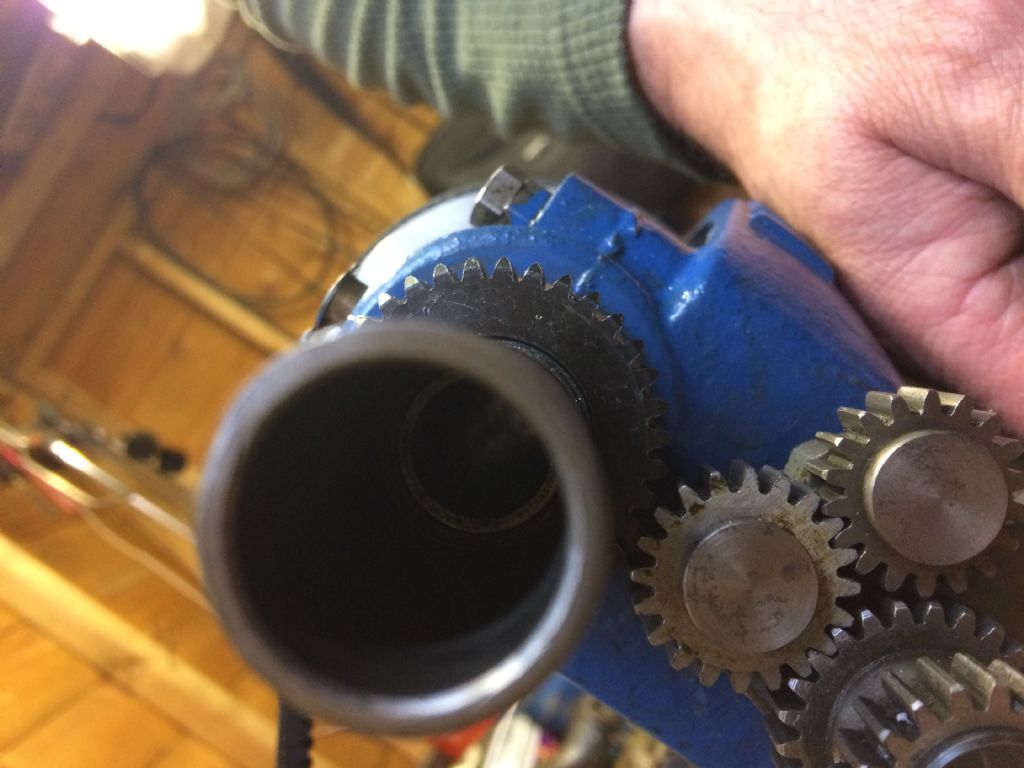

      hi all could someone help me with a problem I have on my ML 4/5 hybrid I have now fitted a tumble reverse but it is in a lower position than on the original headstock ,so I have had to fit a larger gear to the spindle instead of 30tpi it's 34 tpi what affect will this have on my overall gearing .

                                Hi all I have checked the tumble gears it's off a ML7 and they are 20t and 25t am I correct in thinking I only need to change the 20t gear
                                #293886
                                Carl Dorling
                                  @carldorling51660

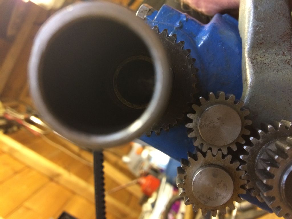

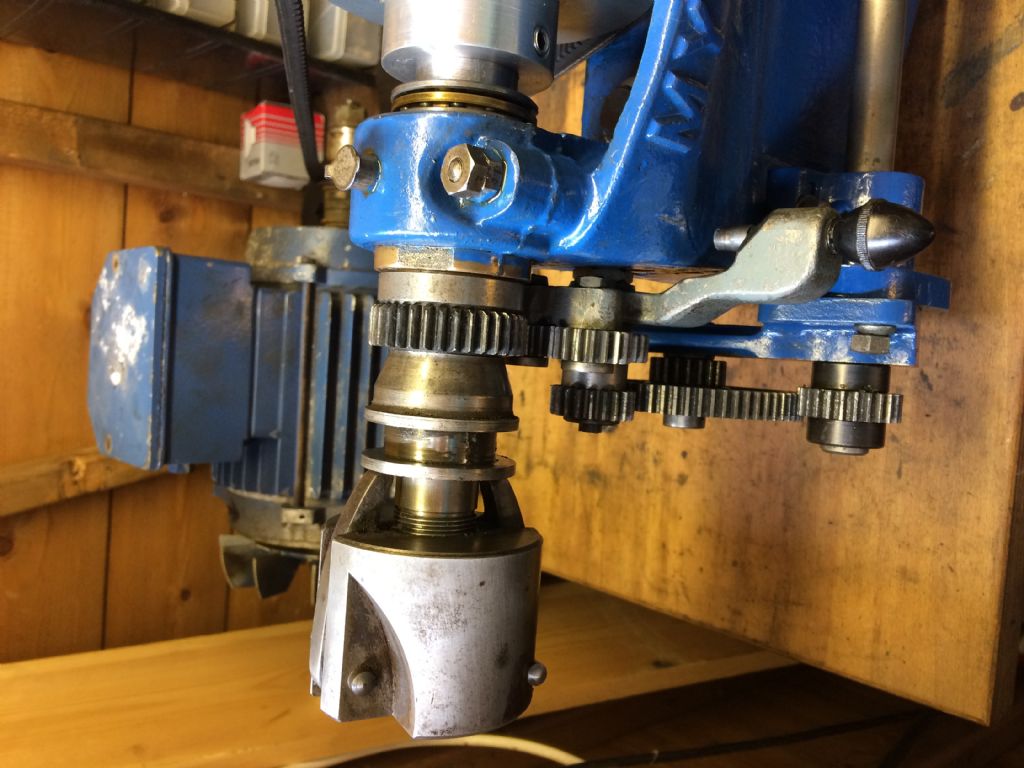

                                  img_0815.jpgimg_0811.jpgForgot to mention there are pics of the setupimg_0817.jpg
                                  #293887
                                    Looks like the 25T is the one that meshes with the two tumbler gears so that does not give an easy swap over
                                    Nearest whole number options would be 36T on the spindle and a 30T on the tumbler lower stud as this would give the same 1.2:1 ratio as the original 30/25
                                    Edited By JasonB on 18/04/2017 13:05:07
                                    Edited By JasonB on 18/04/2017 13:11:25

                                          ​Being brutally honest, yes you have, but to dump the useful tumbler reverse is a retrograde step. If you can reposition the tumbler reverse and fit equal tooth count gears top and bottom, you will be back as Myford intended. That will mean using two gears other than 34 teeth, it might mean creating a new tumbler carrier, but the change of headstock height has brought this about.
                                          ​That now raises a further question. Is the tailstock height now 'low' compared with that of the headstock? It is worth checking before you find out by trying to drill with it. Correcting that is a case of fitting a suitable height packer between the shoe and tailstock body.

                                            Before fitting the ML5 headstock I took lots of measurements it all lines up as it should 3 1/2" centre hight I tried using the existing pre drilled hole at the back of the headstock to locate the tumble reverse this is set to low which requires the 34t gear on the spindle so as you say it needs re thinking. As the lathe came minus a headstock I thought this would be a good upgrade?
                                            #293924
                                            Brian Wood
                                              @brianwood45127
                                              Hello Carl,
                                              ​Can you create another hole in the correct position to suit the tumbler reverse fitting with it engaged as it should be with the original 30 T gear? If so, that will solve this problem.
                                              ​As for my concern over tailstock centre height, I had assumed the ML5 headstock was of a different height to the ML4 version. I still think it would pay you to check that aspect again after you get this gearing sorted out

                                                Hi unfortunately it's too close to the hole that's already there ,I will need to rethink this as it appears not as simple as just gearing it down .
                                                #293930
                                                Brian Wood
                                                  @brianwood45127
                                                  Hello Carl,
                                                  Plug the first hole and drill again, I rather expected that since we are only taking about the difference 4 teeth makes to the true position. After that it should be correct.
