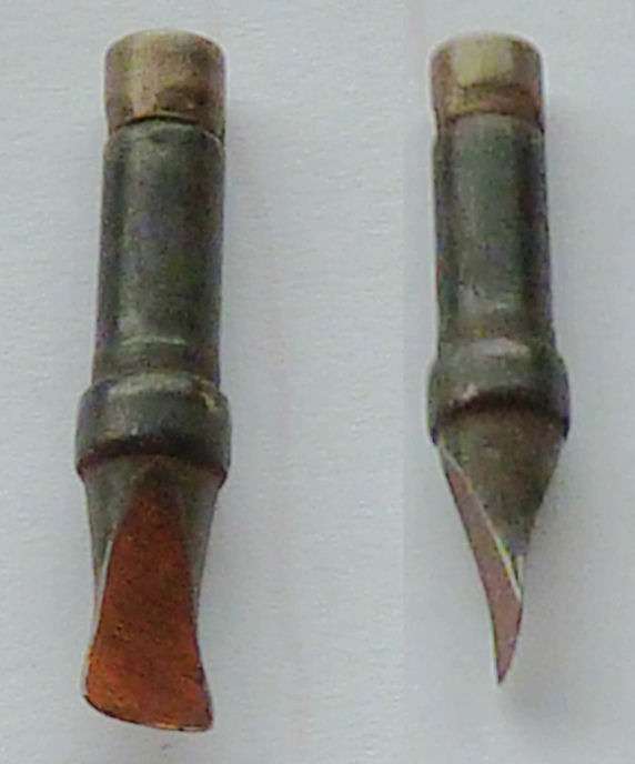

                I have had good success with the modified soldering iron tip shown below, of course heated in the soldering iron. Hold the soldering iron in a suitable clamp. Both ends of the belt material are straight cut, then briefly applied either side of the blade then slid down to meld together at the knife edge. This ensures the weld line is unoxidised plastic. Best make the belt a bit long to allow a couple of trial welds to practice aligning the edges. Trim flash with a sharp scalpel or with side cutters.
                SoldrTip

                  I choose some of this for an inboard 40 irvine glo after quickly loosing a rubber starting belt to fuel rot.
                  As above melted on a soldering iron only just the standard bit, works OK just stop heating before it goes black. I made a spare that I never used, resisted Castor oil methanol and significant tension.

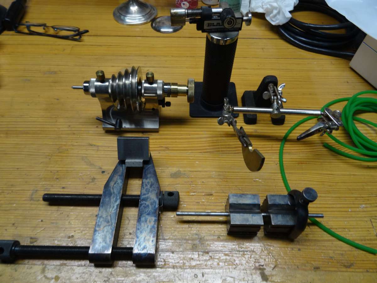

                    Hi, in my last day job, when we were on a shutdown job in a local factory, I showed their routine maintenance crew, how to joint their 3/8″ diameter round roller conveyer drive belt, just like this demonstration piece, using my scraper made from an old power saw blade, shown in the photo below.
                    Belt weld
                    I just used one of those Butane/Propane torches to heat the blade, held the belt on each side long enough, and then slide the ends off the side together, and held them in line until they cooled.
                    Regards Nick.

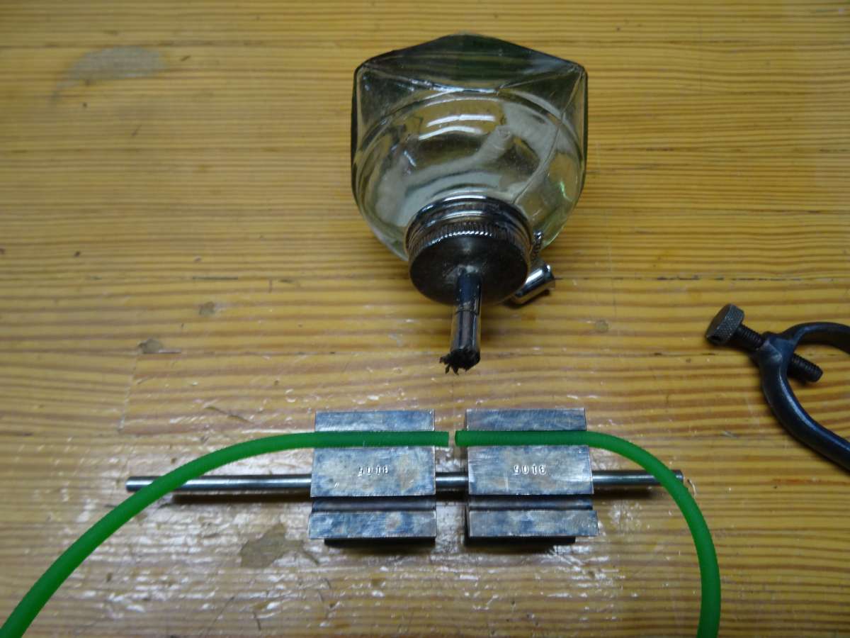

                      I’ve read that some are using CA super glue and they say it works well. So I have setup a couple of options, one for welding and one for gluing. And the glue and matched pair of vee blocks connected by a dowel would be a simple process and provide good alignment. Has anyone used the glue process and is joint strong enough for a watchmakers lathe?
                      DSC00850
                      #838820

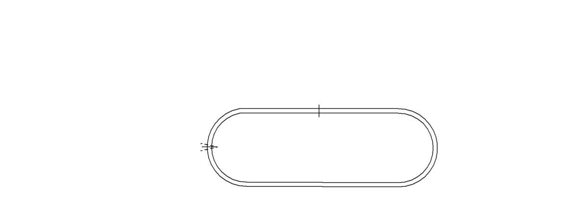

                                Not to be too picky but, from a purely mechanical perspective, I made the attached sketch to envision how a belt joint going around the pulley would be effected by a bending or unequal stretching force, and while the belt is straight, between the pulleys, there is obviously no bending force at the joint. And the smaller the pulley diameter the more the bending force. Now I have no idea what this does to belt life, but it would seem a fused belt would last longer than a glued belt.lathe belt joint

                                      I decided to use the vee blocks…great alignment and guiding to easily push the ends together with fingers. As I was trying to tweak the setup I noticed the clamp channels on the sides of the vee blocks. They are a perfect sliding fit for a 4mm belt, so using that with an alcohol lamp, it was very easy to get a strong joint.DSC00861

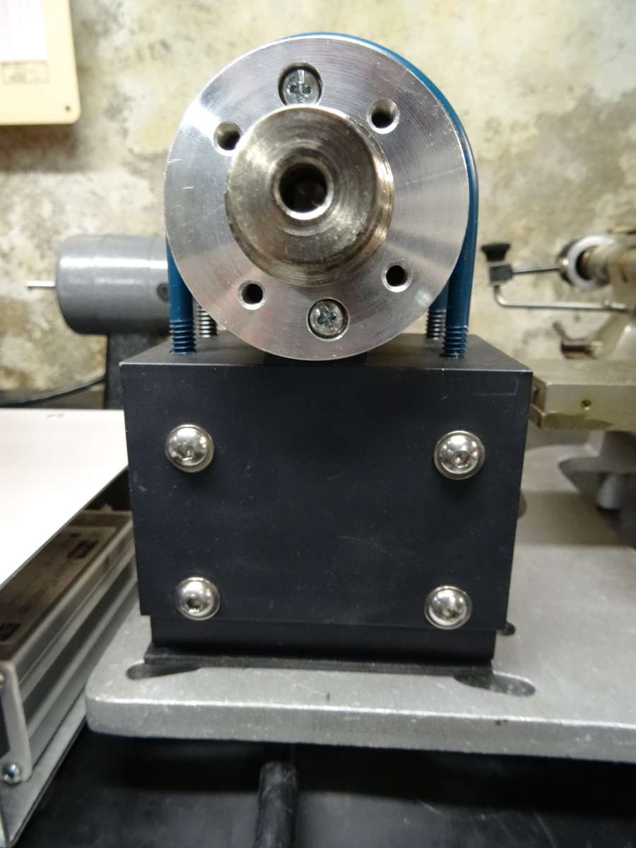

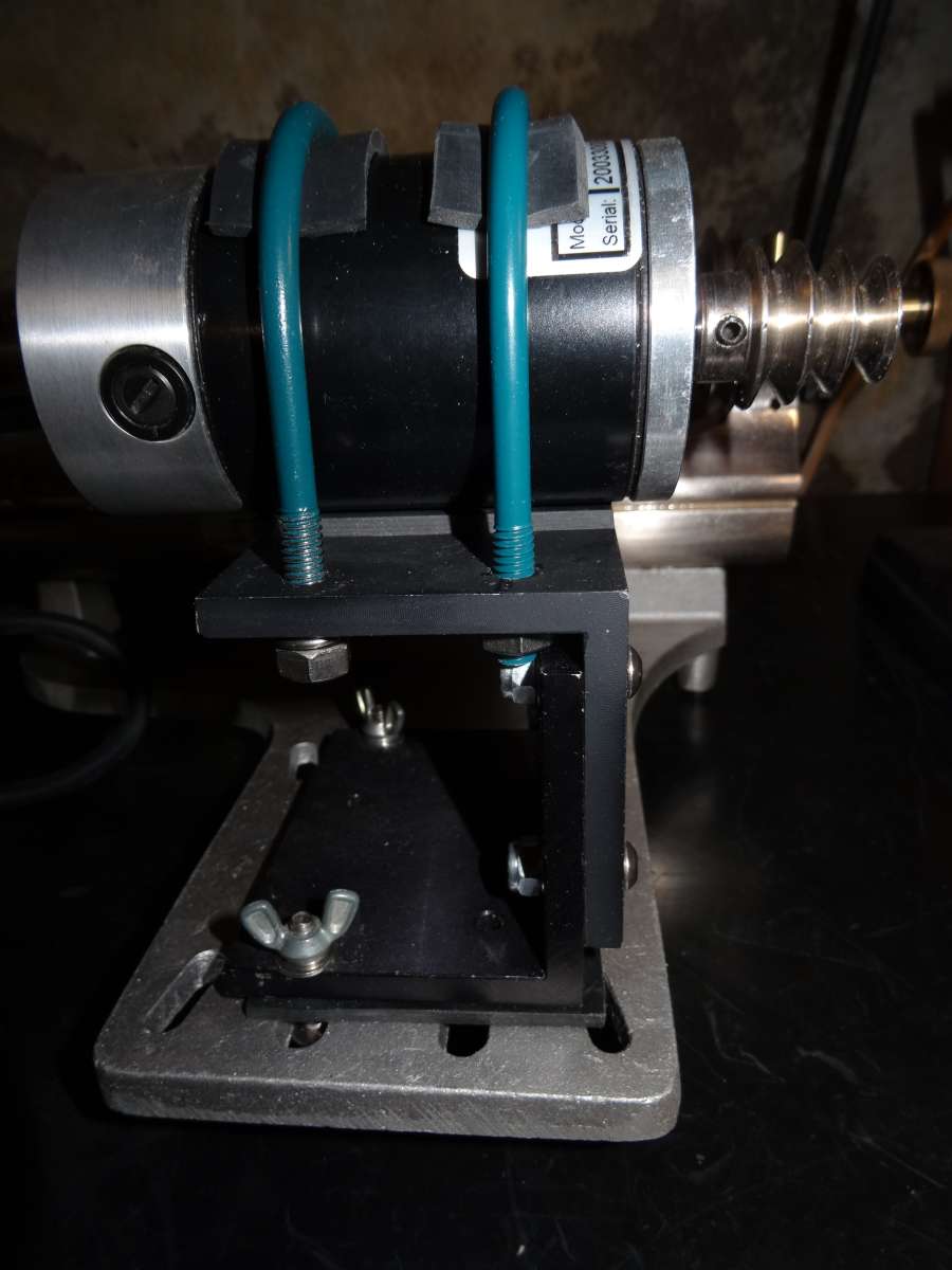

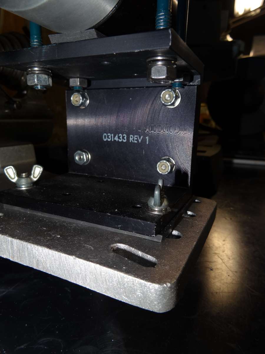

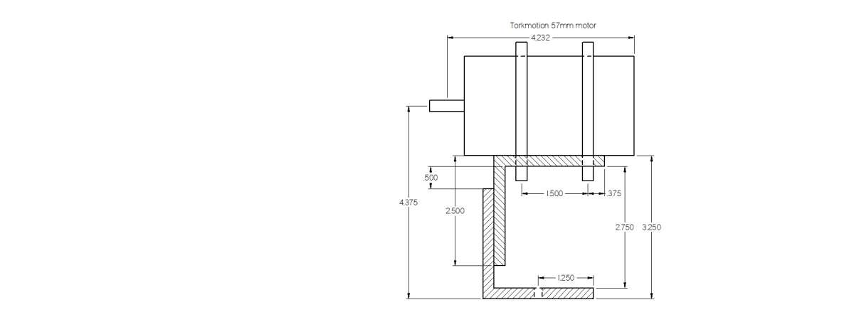

                                          I spent a few hours looking for a stand for my DC motor with no luck. So I built this stand using two standard L blocks, two U bolts, standard bolts, nuts and washers and some pieces of 1/8″ thick rubber. I drilled six holes in the L brackets, four in the top surface for the U blots, and two in the bottom surface for clamping the stand to the Borel base.
                                          To align the clamping holes for the L bracket with the long openings in the Borel base I placed the stand, with the motor mounted, on the base, put the belt on the motor and lathe pulleys, and moved the stand until the pulleys aligned and the belt was taught, and marked a spot so the holes, to be drilled, would be in the center of the long openings in the base, to allow movement so the belt can be kept taught when different pulleys are used.
                                          I also wanted the motor spindle to be close to the same height as the lathe spindle and using the four holes that came with the brackets got it within 1/4″ and the rubber pieces got it almost dead on. One piece of rubber was cut to match the foot print of the L bracket, and is between the Borel base and the bottom surface of the lower L bracket One piece is between the the upper L bracket and the motor, and two pieces are between the motor and the U bolts. I had to trim the threaded sections of the U bolts so just enough length would protrude through the bracket for the nuts. The result is a very quiet, vibration free setup.DSC00855
                                          DSC00859DSC00858

                                            The photo shoes how I assembled it, but the two brackets could also be positioned like the sketch, which will make putting the nuts and washers on the U bolts so much easier.DSC00858motor and stand
                                            #839113
                                            Henry Rancourt
                                              @henryrancourt22682
                                              All the dimension are for my particular assembly plan and lathe. If someone wants build a similar stand the dimensions would have to be determined based on their assembly plan and lathe.
