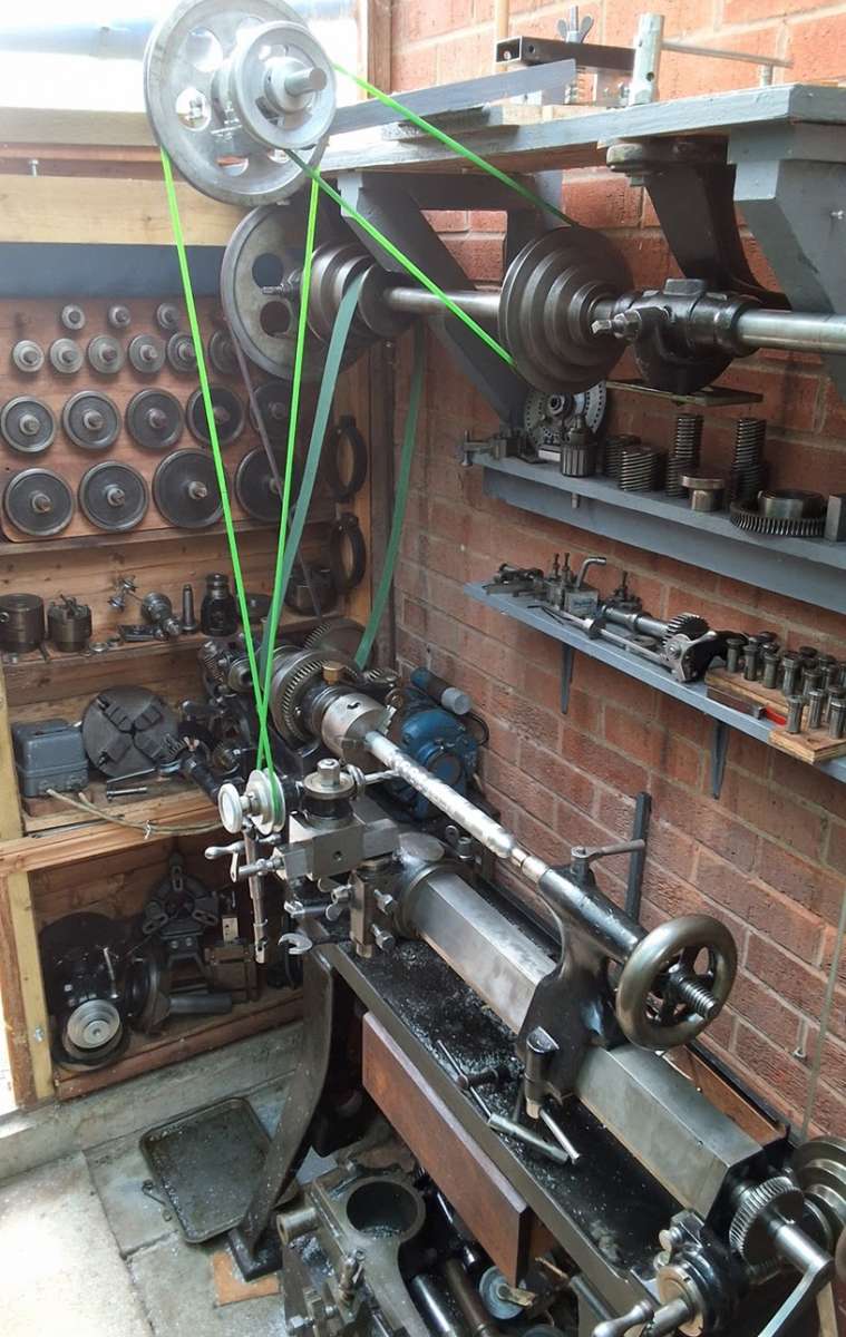

                                          vic newey
                                            @vicnewey60017
                                            I have three fusible belts on one of my lathes, one of the belts has to be joined in situ as it involves a heavy overhead shaft. I used a candle flame 🙂set in a suitable place and then thread the belt loosely over both shafts and hold one end in the flame for a few seconds and then put the ends together and hold steady for a minute or so. After practice l find it easy now and find they never break under high tension when being pulled onto the pulleys.
                                            A third round belt is at the tailstock end but that belt can be joined on the bench. the flat belt, slackened off in this photo is also joined in situ using Gorilla glue as a major dismantle job has to be avoided
                                            unnamed (1)
                                            #839652

                                              vic newey
                                                @vicnewey60017
                                                On renardiere7 Said:
                                                Looks like a very well equipped Pittler. Lovely.
                                                Yes, it’s a 24″ C3 and is cutting a coarse spiral on that photo, do you have one? I have made a number of videos of the lathe in action
