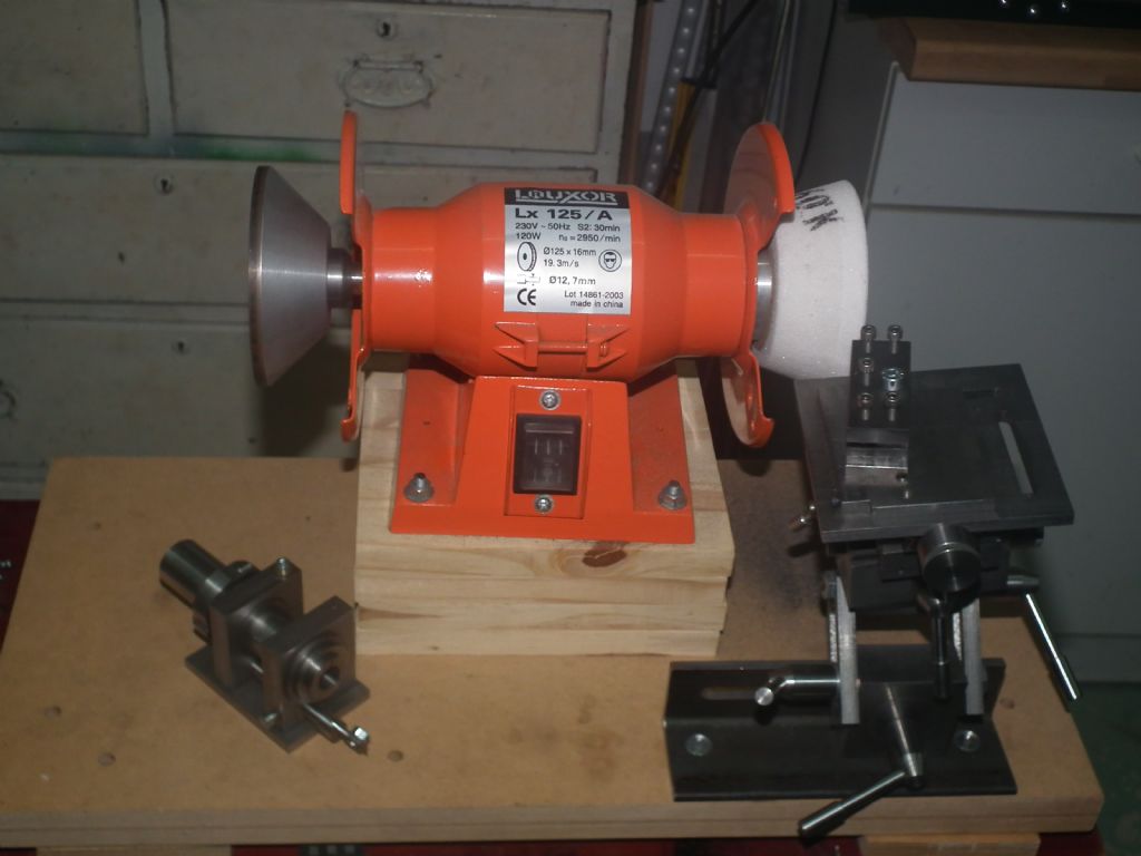

                    Mike,
                    When I was looking for a "good value" motor to drive my GHT pillar tool I ended buying a cheap, new 6" bench grinder for £25 and discarding the (horrible) grinding wheels. These grinders run at 3000 rpm which is a good speed for the Quorn and mine is pleasantly quiet in operation.
                    You could adapt the mounting to better suit the Quorn, getting rid of the base unit which currently houses the switch, opposite the lead.
                    HTH
                    Rod

                      How cheap is cheaper you ask.
                      Well when the parvalux that I had died, I enquired about a replacement, Parvalux quoted me £280, The motor from Hemingway Kits is around the £60 mark and is excellent quality, Fractional hp motors can easily be found for less than £80 so why do parvalux command such a high price (I ask the same question about Myford lathes!!)
                      I wouldn't bother with the cheapo grinder motors, having looked at these as a possible alternative, I discounted them as most of them are not reversible, or run horribly when reversed, they have poor quality bearings, badly of totally unbalanced rotors and vibrate like a anne summers party piece. (There's a reason they are £25 )

                        Posted by CoalBurner on 29/12/2014 23:58:12:
                        …they have poor quality bearings, badly of totally unbalanced rotors and vibrate like a anne summers party piece. (There's a reason they are £25 )
                        Perhaps I was lucky but that is not my experience,
                        Rod

                          Posted by Roderick Jenkins on 30/12/2014 00:37:11:
                          Rod
                          … I was lucky too, my very cheapo Draper grinder is near silent, vibration free and smooth as silk. Cost £29 (with the "horrible" grinding wheels)

                          Gray62
                            @gray62
                            Guess I've been unlucky then, I had a draper a Clarke and a B&Q special all had similar problems, when checked the rotor balance one them, one (I can't recall which was so bad that the 'balance drillings' in the end of the rotor didn't even match the out of balance point, Needless to say they all went back for a refund ( didn't mention I'd had them to bits). I have a larger machine from Warco and a Creusen both of which are excellent. The other think I noticed with the cheaper grinders is the significant lack of power.

                                #173957
                                  My £15 Clarke is smooth as silk, and is now part of a 'proper-ish' T&C grinder. The bigger Wickes grinder runs without any shake as well.
                                  Someone suggested getting a real Parvalux, one reason is they don't look nice anymore!
