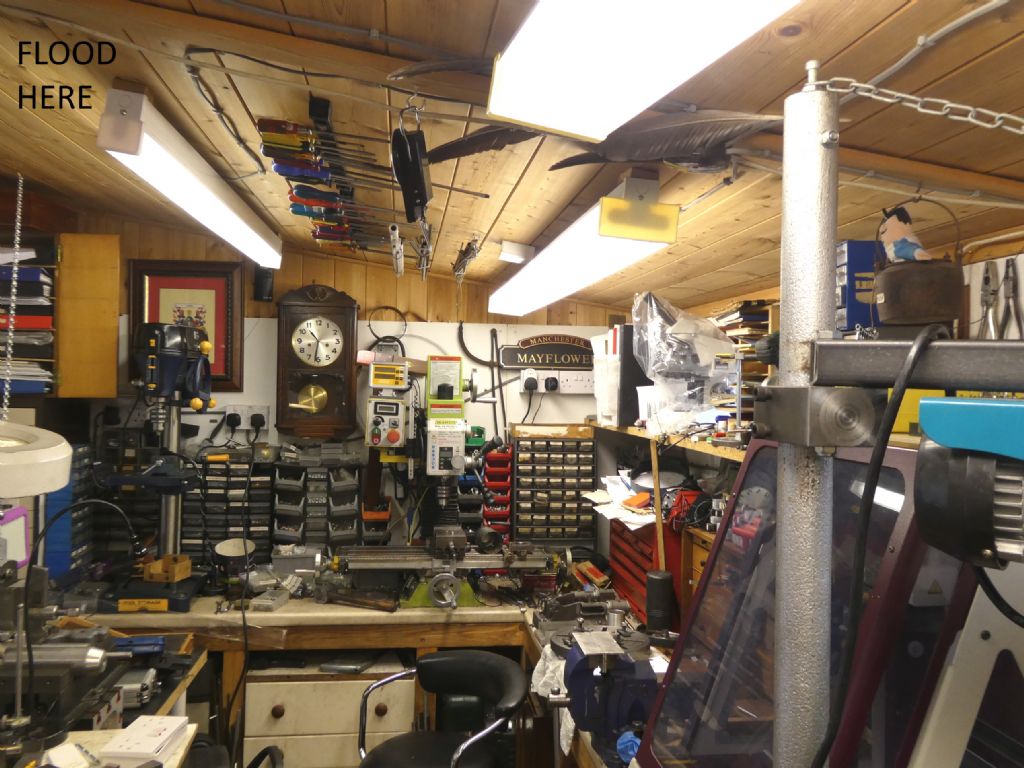

      My eyesight is not as good as it was when I installed 4x fluorescent ceiling mounted strip lights some years ago in the workshop so I intend buying one of these 30w jobs (or similar) to fix to the ceiling and brighten up the bench area. I have already tried a 10w version but it needs to be brighter. I think a 50w unit might be a bit OTT.
      **LINK**
      I can have it in cool white or warm white – not sure which to choose for best results. Any recommendations?
      The flood will be sighted as indicated at top LH corner of pic and will need to illuminate the bench area to the right of my bar stool.
      Rik

          I once went overboard with installing strip lights in a small operating room which lead to headaches from the heat and glare. LED strips would avoid the heat and it may well be that your tubes are aged and not as efficient as when new. Have you considered a head mounted lamp with/without magnifier?

            It's surprising just how much difference you get by painting the ceiling white. The cheaper foil plastic bubble insulation rolls are even better.

              At my clock club (EFHC) we have just recently replaced all of the flourescent tubes with LED tubes….it was straightforward conversion neding just the removal/bypass of the units own wiring. The light is vastly better/brighter and electical consumption about one quarter or previous. The tubes we chose are 'daylight' being about 6,400 degrees K….no flickering, no headaches, no humming, just clean, wide, even white illumination.
              Working at home, I have for the past 18 months been using LED 'pearl' bulbs which have ES 25mm fit caps and would never go back to tungsten, especially not halogen. In fact, I have thrown away all lamps, lights and anything with an uneven or specular light throw….it's plain white daylight colour, flat lighting from now on and MUCH better it is!
              For demanding turning jobs I put the pearl bulb ovefr the work and a piece of white paper on the bed of the lathe immediately under the workpiece…..surface detail is clear and edge profile also easily watched etc. Daylight light is the best for me as any 'colour' tends to upset my old eyes by converting the workpiece colour and spoiling my tired view.

                  As Bob,I find warm white = dull, fine for watching tv and low blue is good for bed time, but the detail seems less to me for a workshop.

                    cold white is better I think for workshop use – if you get dimmable LED lighting then you can adjust over a significant range.
                    My own preference is for LED panels 600x600mm you could get 2 in place of the single tube light; mount in a surface mount tray about half the height of that fitting – the LED driver sits on top of the panel in the tray – make them individually switched

                      I think you should be considering some worklights in addition to your background lighting. With ceiling lights you are always going to shadow the work to an extent. Have a experiment with some adjustable lights on stalks around your vice area. Really you need light in front of you when working on a piece in the vice or on the bench. For illuminating scribed lines when cutting in the vice a small metal mirror on an adjustable stalk works well. You just move it around until the reflected light catches the line just right. For more general lighting I have had good results in my kitchen with LED panels like these
                      **LINK**
                      A couple where you are thinking of the flood light may suit better, they are far more diffuse as they generate light from a much greater area. What you don't want is a mix of very bright areas and much darker areas. Really bright compact lights do tend to generate a lot of glare from reflections.
