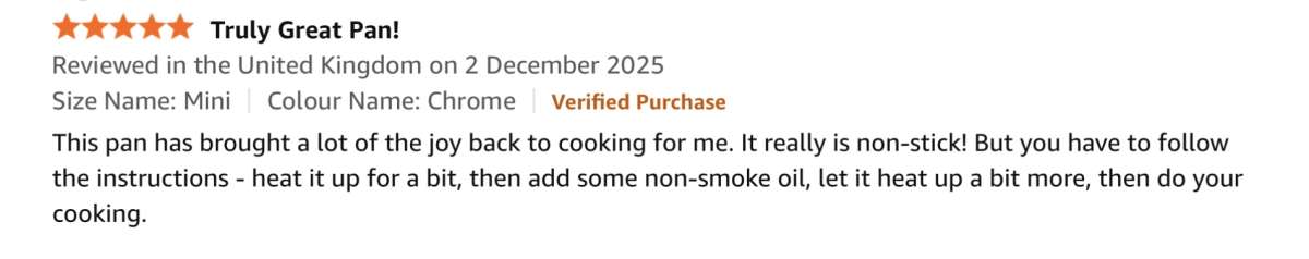

                                                  Vic
                                                    @vic
                                                    I’ve just seen this on one of the reviews. I use mostly butter for frying these days so it might not work for me?
                                                    IMG_6920
