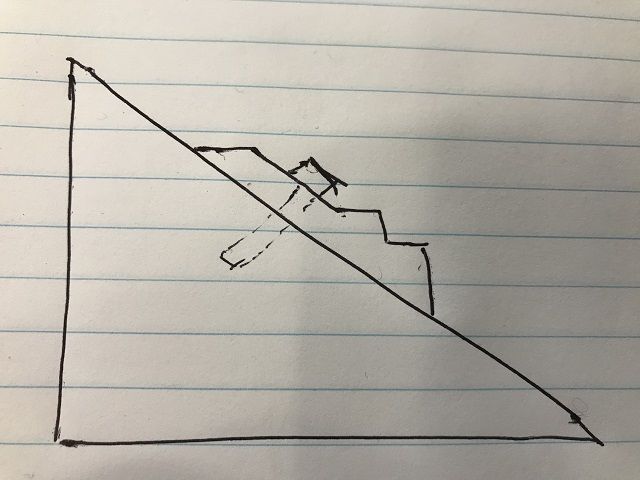

        I have been looking for an adjustable parallel support which I have seen several people on this site using. I have no idea what the correct name is. It looks a bit like the sketch below.
        The part held in with a bolt slides along the angle (in a slot) and can be clamped as required. The notch in the part that slides can be used to support objects whilst milling. The tool can be used at 90 degrees if a greater height is required.
        Excuse the quality of the sketch.
        TIA.
        Colin

          The thing that immediately comes to mind seeing your sketch is a planer gauge. As the name suggests, however, it is a measuring tool and not really designed for workholding.

              Step blocks give a similar result and are designed for supporting items for machining, not sure I would rely on a friction joint to hold up under clamping and milling forces

                It could be used if an additional means of locking was added to it. A back up tee nut and block would not be hard to make.

                  That was some very quick responses. I can understand how its used having googled with its correct name. The one I saw did look too god to be supporting work I must admit.

                    It could be either a planer gauge or a shaper gauge, depending on the size. Some were furnished with a scriber that fit the moveable part so it could be used for marking out. Occasionally I use mine with a sine bar. I set it to dimension with a mike, then use it under the sine bar instead of a stack og gauge blocks.
