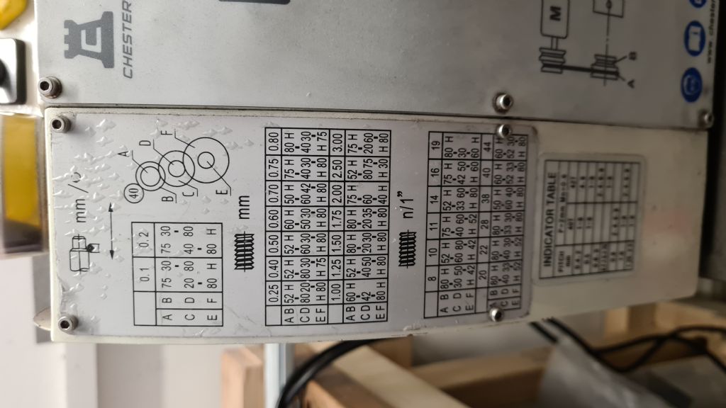

                            is it a metric lathe or imperial eg what are the handwheels marked as
                            Post a photo of the chart on the headstock then we can check the leadscrew from that.

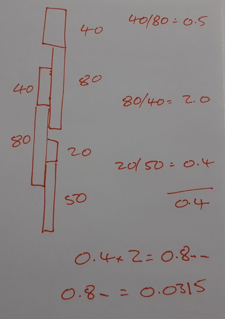

                                  #527297
                                    Yes, I'd just worked out a different 0.8mm which is probably as close as you will get with the gears you have only 0.00025" out per turn.
                                    #527298

                                      #527328
                                      Neil A
                                        @neila
                                        Jason – I think you have put the second 40/80 round the wrong way in your calculation, is the "Duffer Rule" catching?
                                        I have had a little go at this, it all depends if you can fit the train on the banjo.
                                        (40/40) x (20/60) x (50/42) with a 2mm leadscrew this gives 32.004TPI.
                                        As I have said, it all depends if it will fit on the banjo. I hope it does.
                                        Should have said, you may have to change the order of the drivers and driven gears to fit.

                                        #527331
                                        Lainchy
                                          @lainchy
                                          Ah yes, just checking and indeed…. that would be 40/80, 40/80, 20/50. I'm guessing it would still fit, given that it's on the chart. I'll take a look at this also Neil. Going to be tail end of next week to get the gears off.

                                                Brian Wood
                                                  @brianwood45127
                                                  Lainchy,
                                                  It has taken me a while to figure out the gearing drawing shown on the plate for your lathe, but the working elements are 30/75 which is 0.4. Multiply that by the leadscrew pitch of 2 mm and you get the threading pitch value of 0.8 mm which might be close enough for your purposes. The Far Eastern lathes do not make it as clear as they should in my view, which gears are used as idlers and even in some cases just acting as spacing collars, very confusing.
                                                  The top end gears shown on that plate are an idler of 80T linking the fixed spindle gear of 40T to another of 40T for a neutral drive up at that point. That 40T is coupled to the 30T that does the business
                                                  Neil has taken the calculations further forward to get as close as he has to 32 tpi and he has also gone to the trouble of working out the clearances needed to get the necessary daylight between all the gears
                                                  Regards Brian
