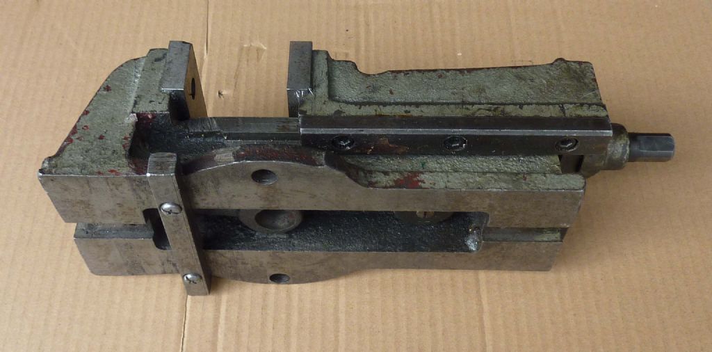

                                                  Paul Lousick
                                                    @paullousick59116
                                                    I have a 100mm (grey) vice on my SX3 mill and use the vice only. Very rarely use it on the swivel base. Also have one of the toolmakers vices but find it is not as useful for normal machining, takes longer to adjust for different lengths.
                                                    I would reccommend that you cut a slot in the base and add a key. It makes setup so much quicker. Just drop it into the slots in the mill table for alignment. (Note that squareness to the table should always be checked if you are machining precision parts).
                                                    Paul.
