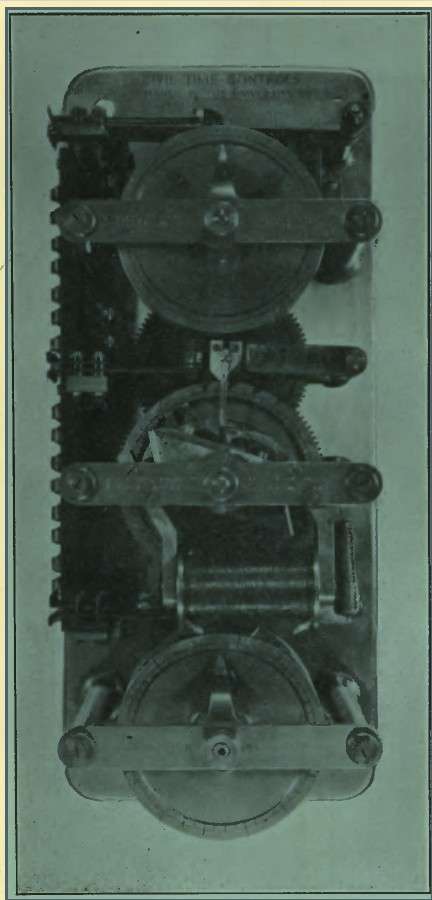

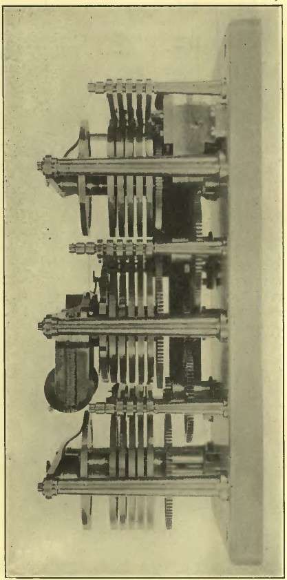

                                        Going back to Duncan’s original purpose, here are a couple of photos of the “Civil Time Unit” of Professor Robertson’s Clock at Bristol University.  The clock controlled the timing of Great George, in the bell tower of the Wills Building, chiming the hour.  To avoid annoying the good citizens of Clifton too much the chiming was inhibited between 2100 and 0700 and all day Sunday by this mechanism which is stepped every 30s by pulses from the pendulum.  Basically an electromechanical counter inspired by early telephone switches.  A similar mechanism controlled a phase lock system to trim the pendulum rate by syncing to a time pulse from Greenwich every morning at 10.00 GMT. An Arduino Nano is just a tad smaller – these units are ~250mm high! Nowadays the bell is chimed by some electronic system though I think it still uses Robertson’s chiming machine. Robertson’s own description of the clock and the machine is available at https://clockdoc.org/new/index.aspx/?moid=62981
