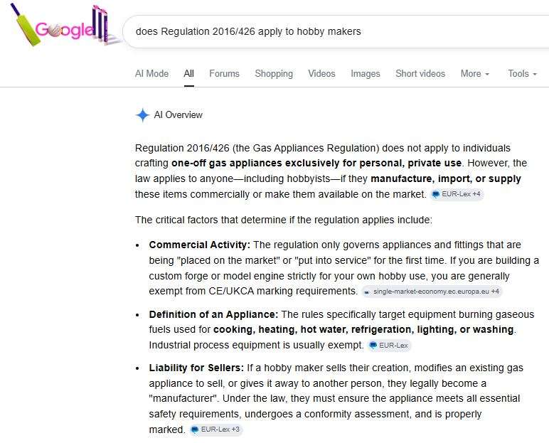

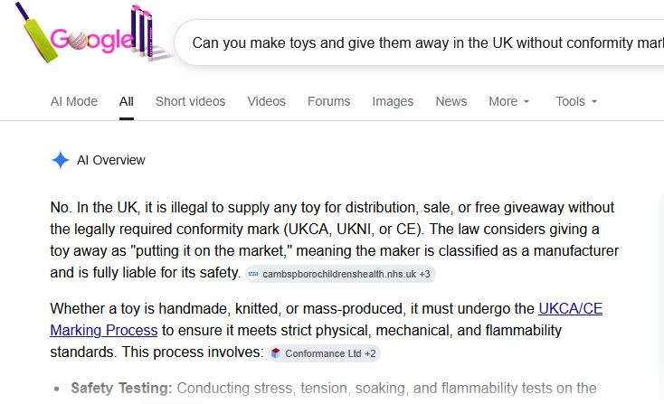

                              #854379
                                Interesting to see what AI thinks😉😉
                                google
                                Bullfinch have a bit that may be of interest. Seems blowtorches are not covered by that reg so if using one to heat your hot tube or fuel your engine then that would seem to be outside the reg. Unless you use a blowtorch to do your toast
                                https://bullfinch-gas.co.uk/safety-and-technical/10-safety-technical/72-ce-marking

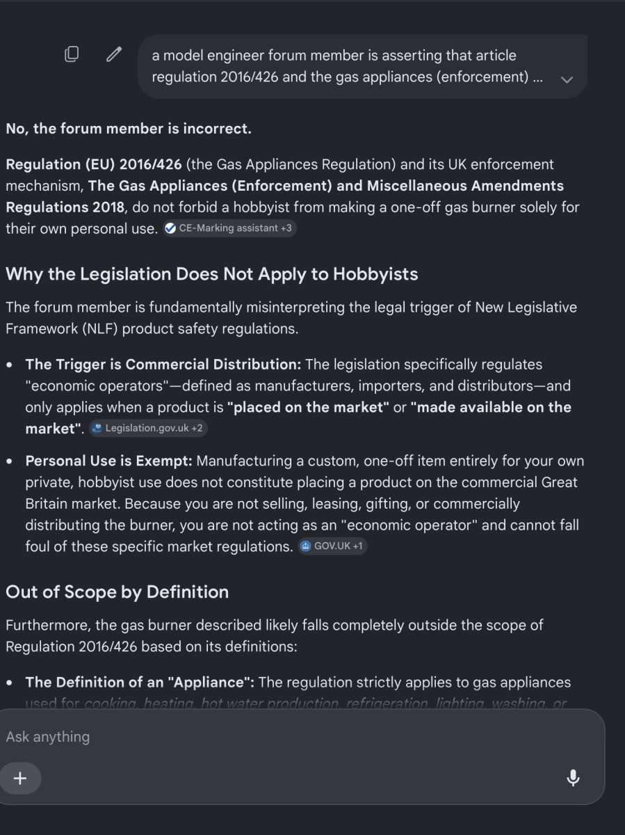

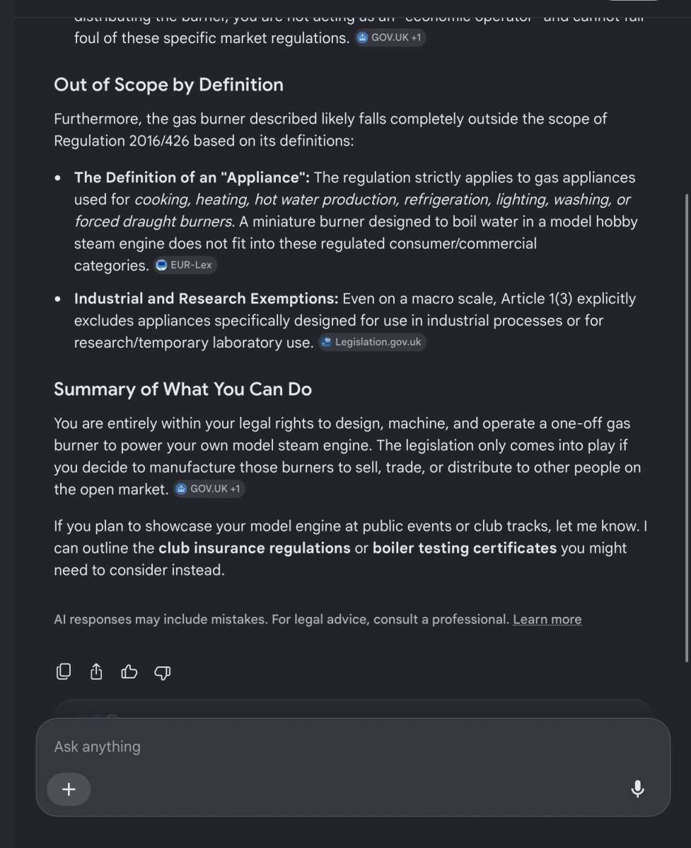

                                Bill Phinn
                                  @billphinn90025
                                  I searched, as Jason did, in several places, and, after asking the following question:
                                  “A model engineer forum member is asserting that “Regulation 2016/426 and the Gas appliances (enforcement) and Miscellaneous Amendments Regulations 2018: Great Britain” means a person is forbidden to make, entirely for their own personal use, a one-off gas burner to power a model steam engine, for example, without falling foul of this legislation. Is he right?”
                                  it came up with results like the following:
                                  IMG_2122IMG_2123
                                  #854386
                                    As I said , murky territory. Robert and Bill’s findings are hard to reconcile!
                                    In general, ChatGPT’s summary of the “economic triggers” approach is how I understand the intent.  Hobbyists, R&D etc are exempt from legislation intended to protect consumers. Hurrah!
                                    Not the full story though.  It ignores what happens when an accident, even on private property, injures someone else.  Then a different shower of legislation applies!  It’s why clubs insure model boilers against personal injury claims, which requires boilers to be inspected.  Basically, unless the chemicals are specifically banned, we can manufacture rocket fuel in our cellars but will be in deep trouble if the apparatus blows up and wipes out the neighbours.  Whether or not the apparatus is an appliance matters little – not if it caused injury.
                                    Personally, I favour kicking this kind of question into the long-grass and putting a car-park on top.  Reason is that, so far as I know, gas has never caused a significant hobby accident involving other people.  If it ain’t bust, don’t fix it!
                                    Unfortunately, the world is swarming with irresponsible individuals, and stupidities that hurt other people can’t be ignored.  Something has to be done to discourage Jackasses from causing accidents, and there are plenty of foolish folk about.
                                    We live in an imperfect world.  What’s emerging from the Grenfell Tower enquiry is horrifying. Apart from negligence, incompetence, unwise cost-cutting, muddle and over-complicated governance seriously weakened by under-resourcing, Grenfell has become the Metropolitan Police Force’s largest ever criminal investigation – corruption on top of everything else.

                                        Well the first thing wrong with the AI responses is that they are referencing EUROPEAN LAW not UK. Now they are basically the same but it shows the AI is not being dilgent.
                                        The exemption Bulfinch seem to be using is “use in industrial processes carried out on industrial premises” (3, 2) bullet one). That clearly does not apply to hobby use. The reason for this exemption, and the others, is that there are other regulations that apply. If Bulfinch are using this exemption then they should not be selling to consumers.
                                        I suggest that the use “hot water production” encompasses a model steam boiler.
                                        The AI responses saying personal use is exemt are clearly wrong as I said in https://www.model-engineer.co.uk/forums/topic/gas-tap-valves-vintage/page/3/#post-854365
                                        The regulation specficly mentions “own purposes” i.e. personl use, as being INCLUDED not once but TWICE.
                                        These free AI LLMs just scoop stuff off the web. It is a common misconception that personally made items or items that are not sold are exempt from the UKCA / CE regulations. With a very few exemptions they are not.
                                        Do you think it is OK to build your own car without reference to the relevent regulations and getting it approved?
                                        I hope not. Kit cars have to be independently inspected and approved.  The changes to regulations around cars killed off a lot of the kit car “industry” and a good thing as some were death traps.
                                        Similar reguations apply to trailers “IVA” https://www.gov.uk/government/publications/individual-vehicle-approval-iva-for-light-trailers-help-to-get-a-pass
                                        I hope all the loco transporting trailer home builders have done this. You don’t want to find out when you have an accident (even if not your fault) and the insurance compny won’t pay out and possibly you are fined.
                                        I’m a professional engineer and have been trained on CE / UK marking and have been authorised to make declarations of conformity for EMC, LVD, Machinery and Radio 3 companies over 30 years. I’m also authorised to make determintions of compliance with legislation for aircraft and UAS.
                                        If you are going to post screenshots of AI results at least include the reference links the AI has provided so we can check them.

                                          Best of luck quoting AI if you’re in front of the judge.
                                          The regulations Robert referred to (here to save you looking back), define a manufacturer as “A manufacturer is a person who has a gas appliance or fitting manufactured or has a gas appliance or fitting designed or manufactured, and markets that gas appliance or fitting under their name or trademark or uses the appliance for their own purpose. (my emphasis). No need to market it.
                                          That seems all encompassing to me.

                                            I also take issue with Bulfinch saying their gas torches don’t have to be, and are not, CE / UKCA marked. Even if the Gas afety regulations don’t apply thet torch still needs to meet any other directives. As  minimum this is the General Product Safety Directive.
                                            The OPSS seems to think it applies to blow torches, see this product safety recall,
                                            https://assets.publishing.service.gov.uk/media/620a4e4c8fa8f54915f43697/2103-0002-product-recall-blowtorch-flame-gun.pdf
                                            https://www.gov.uk/product-safety-alerts-reports-recalls/product-recall-yunhetu-yt-818-blowtorch-flame-gun-2103-0002
                                            #854409

                                                Bill’s AI sponse mentions the New Legislative Framework (NLF and commercial triggers. This still does not exampt gas appliances. For example consider the definitions from the latest NLF EU directives
                                                Gas:
                                                (17)
                                                ‘manufacturer’ means any natural or legal person who manufactures an appliance or a fitting or who has an appliance or a fitting designed or manufactured, and markets that appliance or fitting under his name or trademark or uses the appliance for his own purposes;
                                                https://eur-lex.europa.eu/legal-content/EN/TXT/?uri=uriserv:OJ.L_.2016.081.01.0099.01.ENG&toc=OJ:L:2016:081:TOC
                                                Toys
                                                (3)
                                                ‘manufacturer’ means any natural or legal person who manufactures a toy or has a toy designed or manufactured, and markets that toy under that person’s name or trademark;
                                                https://eur-lex.europa.eu/eli/reg/2025/2509/oj/eng
                                                So the gas regulations specifically prohibit “own purposes” but the toys regultions don’t. You can make your own toys but not your own gas appliance or fittings.

                                                Robert Atkinson 2
                                                  @robertatkinson2
                                                  Interestingly Google AI says you have to conform with CE/UKCA if giving homemade toys away.
                                                  Capture
                                                  https://ccst-cpc-app.azurewebsites.net/staying-safe-and-accident-prevention/toy-safety/
                                                  https://www.conformance.co.uk/handmade-or-homemade-toys
                                                  Which seems to contradict the “commercial trigger” interpretation.
                                                  I picked toys beause it is a common home making activity and is covered by guidance. Making Gas burners is not common.
                                                  Robert.
