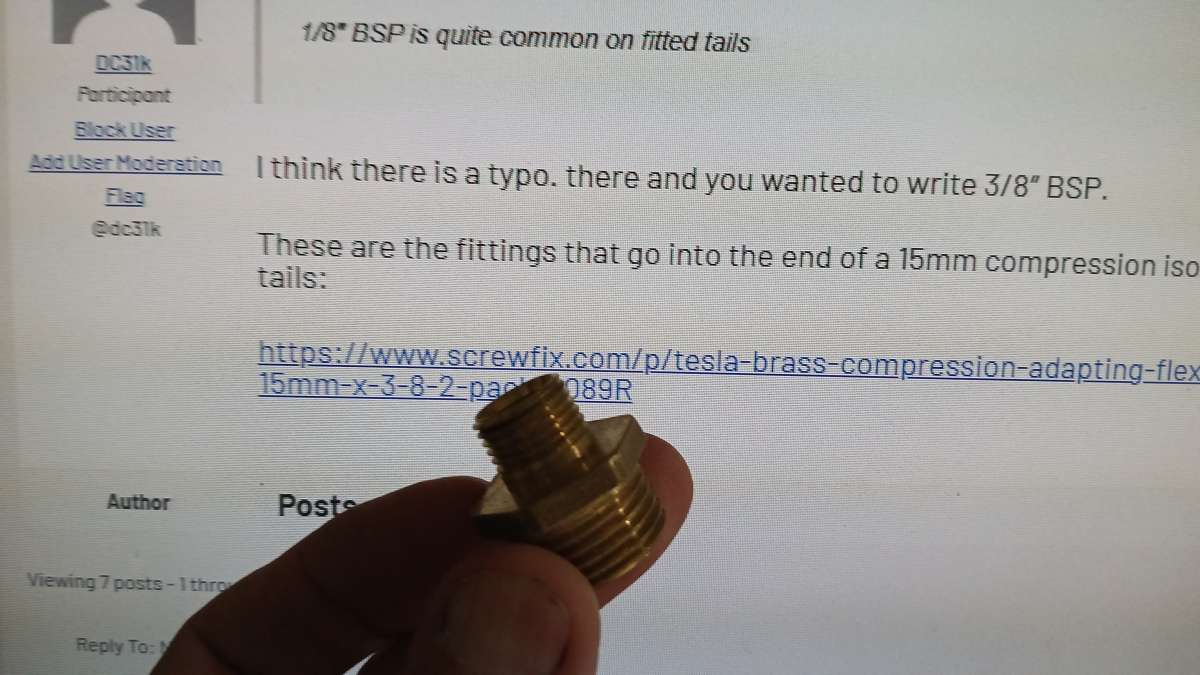

                DC31k
                  @dc31k
                  On JasonB Said:
                  1/8″ BSP is quite common on fitted tails
                  I think there is a typo. there and you wanted to write 3/8″ BSP.
                  These are the fittings that go into the end of a 15mm compression isolator valve to accept the tails:
                  https://www.screwfix.com/p/tesla-brass-compression-adapting-flexible-tap-connectors-15mm-x-3-8-2-pack/6089R
                  #854621
                    No as someone who earns a good proportion of their living fitting bathrooms and kitchens I mean modifying a compression reducer like this as it is harder to find 15mm to * BSP in the smaller sizes. 3/8″ to 15mm are easy to find so no need to use the adaptors you show.
                    It is when you have smaller female threads on the end of the tails that I modify a fitting like this, taking off the compression nut and olive from the small end and facing the end flat so it does not cut into the washer. That’s actually 1/4″ BSP but some of the high pressure basin taps come with smaller 1/8 threads, no good for UK gravity fed systems unless you pump them. I’m holding the end that would take the 15mm compression nut

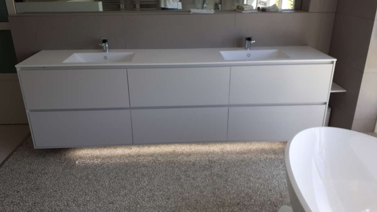

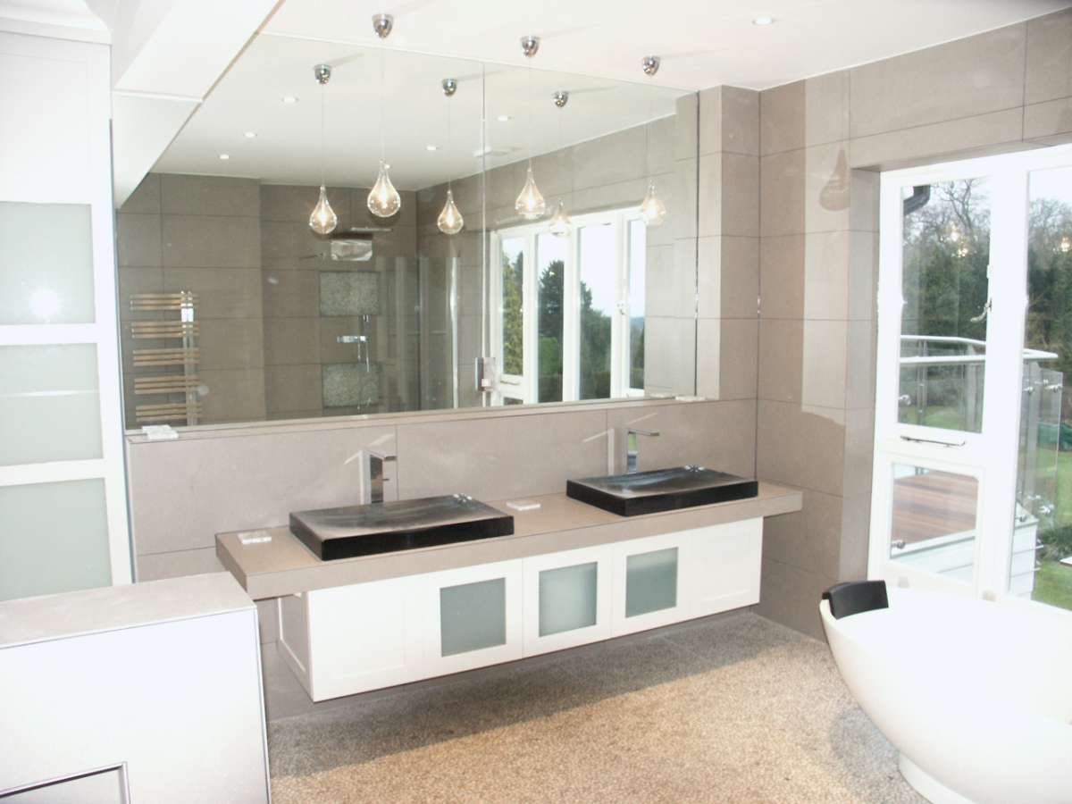

                    #854623
                      These two were 1/8G,  made to order from a Spanish firm, about 10 week lead in time and £1800 each. Horrible taps as they had a tiny “joystick” type control that was really hard to use with wet hands but the Client liked the look.
                      PICT0207
                      The solid glass basins were equally impractical as they could not be fitted with a plug just the custom grill type waste and you could only trickle a small amount of water otherwis eit splashed everywhere if too fast.
                      The counter is a single ceramic tile that was 1000 x 3000 again special order from Itally along with the 1000x 400 wall tiles . All are just 3mm thick. I did get my stone people to cut the larger tile for me as it was a bit big for my cutter!
                      They put up with it for about 18 months then had me back to fit taps I suggested and a one piece Corian top with two integral basins.

                      #854665
                      Bill Phinn
                        @billphinn90025
                        Jason’s clients clearly prioritised form over function…until they realised their mistake.
                        At least we can be sure it was fitted well in this case. Too often clients go into bathroom/kitchen showrooms, say “I want that”, and “that” ends up getting fitted by monkeys, and not trained ones either.
