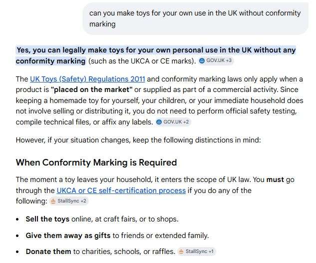

        On JasonB Said:
        But as we are generally not giving them to anyone maybe this question is more appropriate.
        own use
        I think you misread my post, it was a follow on to the previous one where I was using toys as an example of where you CAN make your own.
        The second post was to illustrate that in the “commercial trigger” used (wrongly) by AI as a reason why gas regulations did not apply was not applied by AI in this case.
        I’m pretty sure the disparity is due to the lack of information on CE marking gas appliances on the internet. Pretty much the only thing “picked up” by any of AI LLMs was the (incorrect) information on the Bullfinch website. I contrast there are lots of references to toy making and approval on the internet.
        I’ve seen this even before AI where one website would place a bit of incorrect information on the web and lots of other sites and blogs would pick it up and propagate the mistake. Often this even included poor grammar or spelling mistakes so you could be sure it came from the same source. One this sort of misinformation starts it is very hard to correct.

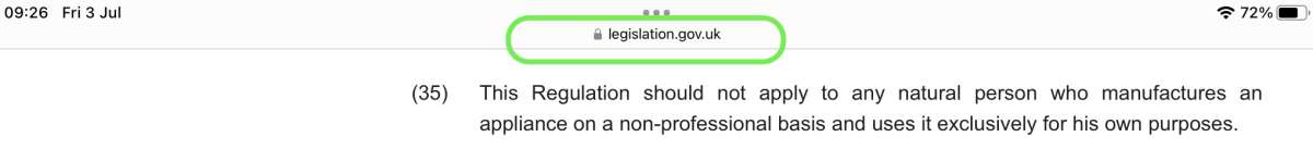

                  #854479
                    Robert
                    I gladly defer to your expertise in these matters, but I remain bewildered:
                    This screenshot is from the U.K government web-page
                    https://www.legislation.gov.uk/eur/2016/426/introduction?view=extent
                    IMG_1801
                    So what hope is there of “The man on the Clapham Omnibus” making the correct assessment of of reasonableness if/when a Model Engineer is prosecuted ?

                      #854514
                      Robert Atkinson 2
                        @robertatkinson2
                        Hi Michael,
                        Your link(1) is to the introductory text from the EU. Note it says EU at the top and has no amendments. The body(2) is what matters especially since we left the EU. It says UK at the top and has amendments.
                        The man on the omnibus would not be expected to have read the legislation. The question to him would be “Was it reasonable for a unqualified person to make a gas appliance that caused a leak and explosion that killed his neighbour?”. Note the past tense as the question is only asked if it comes to court.
                        (1) https://www.legislation.gov.uk/eur/2016/426/introduction?view=extent
                        (2) https://www.legislation.gov.uk/eur/2016/426/body
                        Robert.
