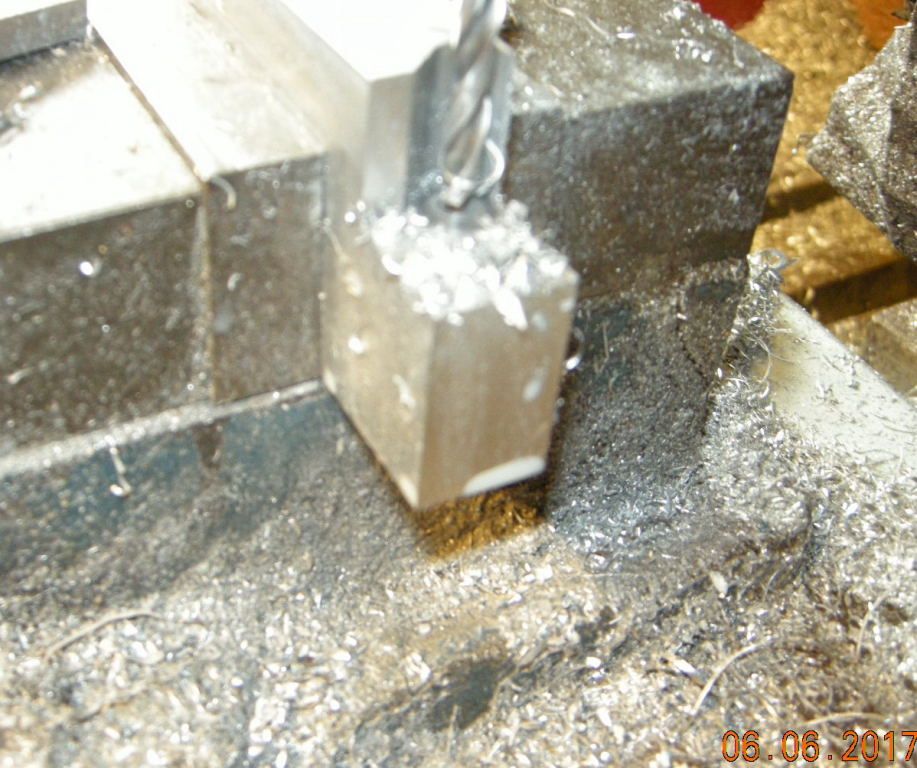

      I have a Vertex Toolmakers vice, similar to this, that open up to 100mm. I am very satisfied with the vice and haven't had any problems with the workpiece twisting. I don't take heavy cuts when using the toolmaker vice, but then I only have an Asian made hobby milling machine.
