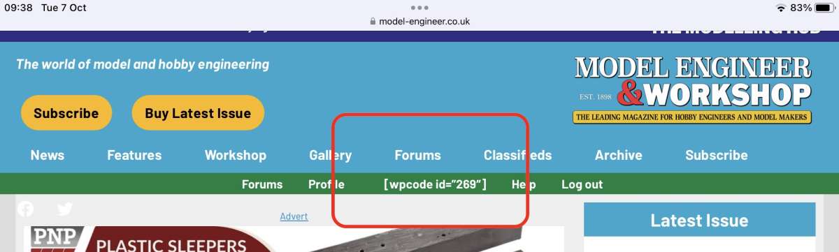

                More weirdness noted this morning:

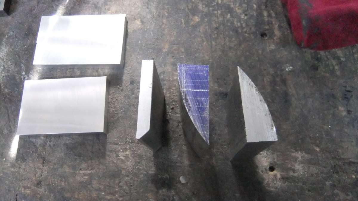

                      I thought that I had started a topic on my Rob Roy build. Anyway, could not find it so will post what I did today on it.
                      I have not done much to it while I was building the Farm Boy.
                      So I have made some of the linkages, which there are a few.

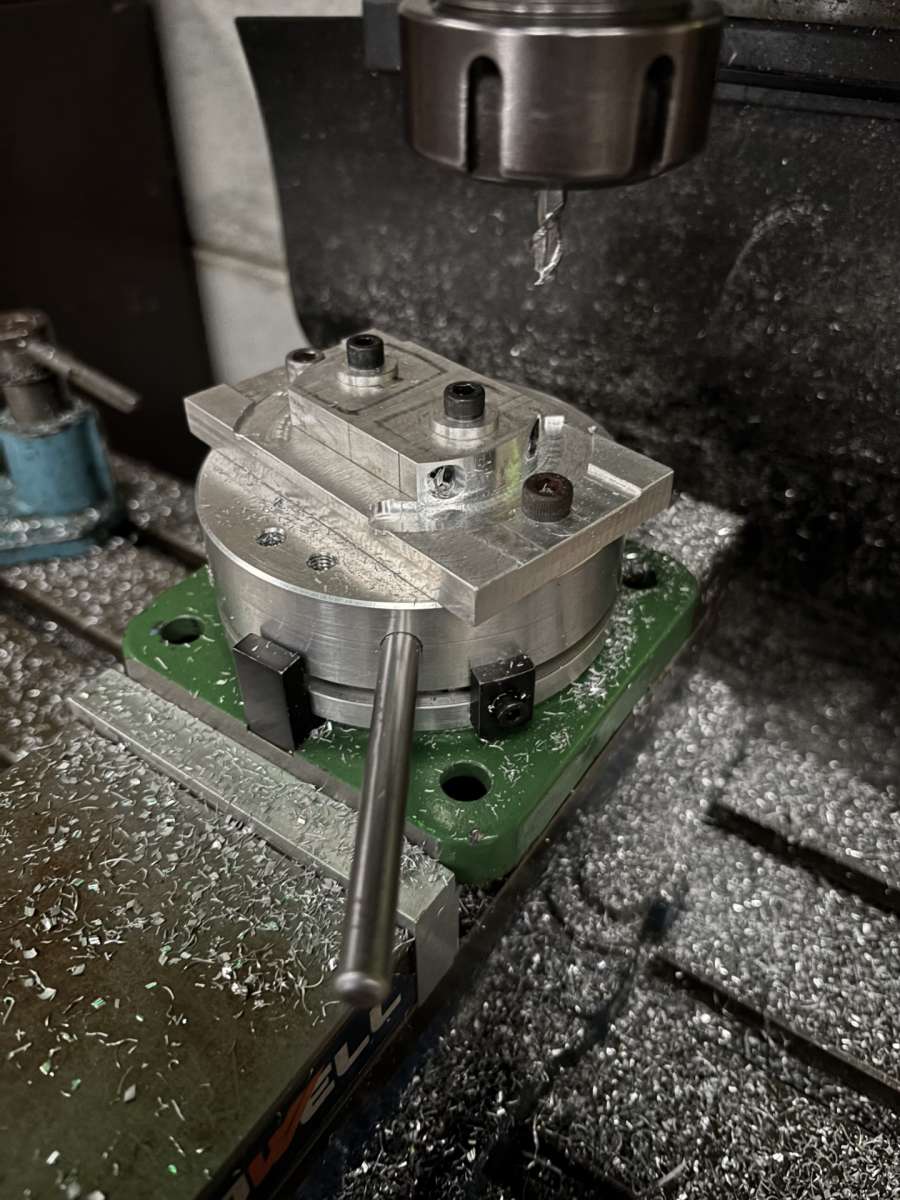

                      Started by machine some scraps of Ali into blocks on the left of photo. I knew that they would get used.
                      Making jig plates from scrap (2)

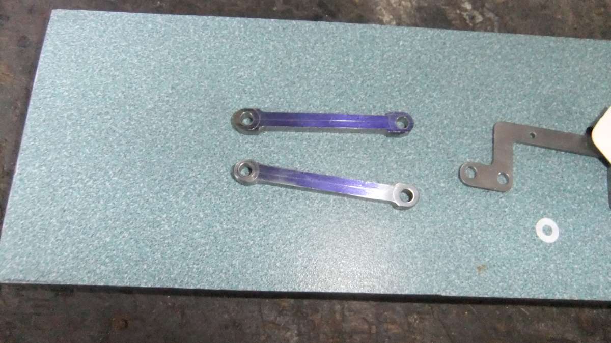

                      Start of the lifting link
                      Linkage started (8)
                      May remake these depending on how the ends go when rounding off
                      Linkage started (1)
                      Valve rod arms ready for the spacers yet to be made

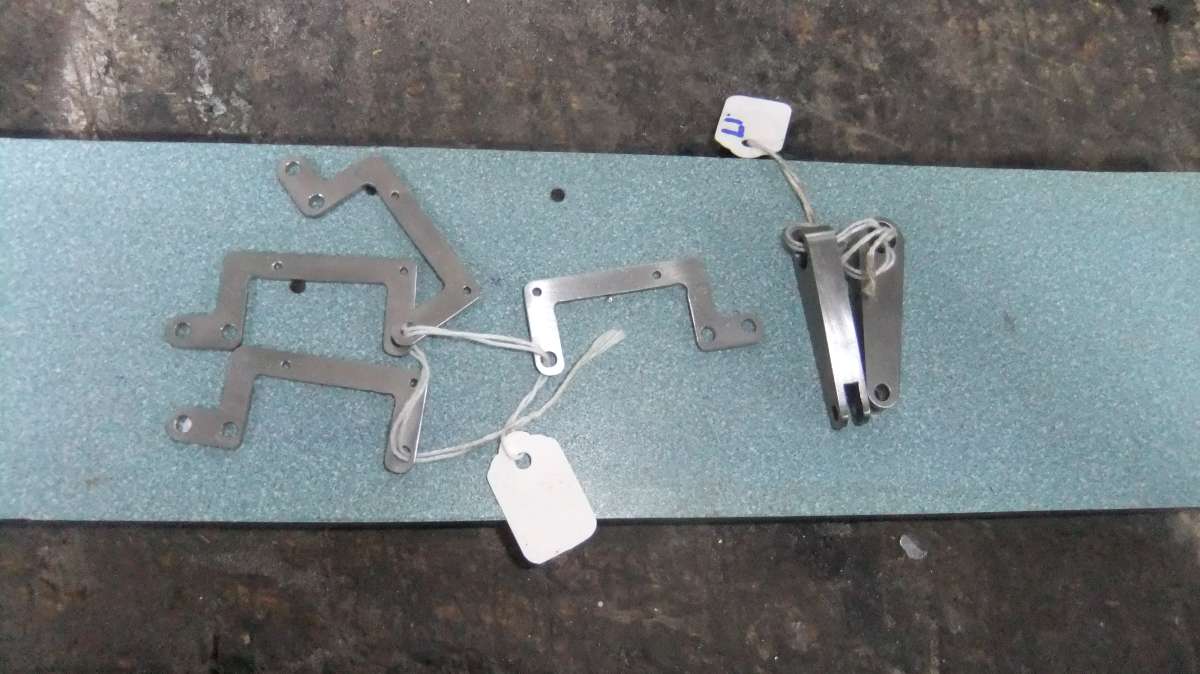

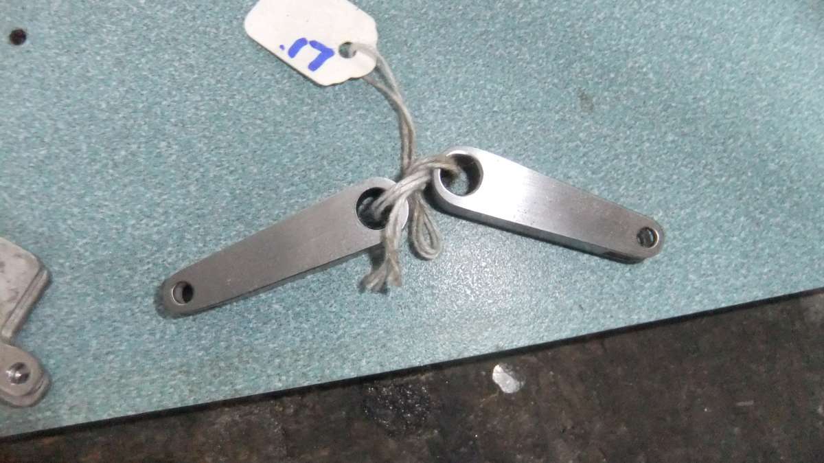

                      The two lifting arms. I tag parts as some later on look the same but with slightly different dimensions but only slightly saves having to measure them to confirm which is which
                      Linkage started (14)

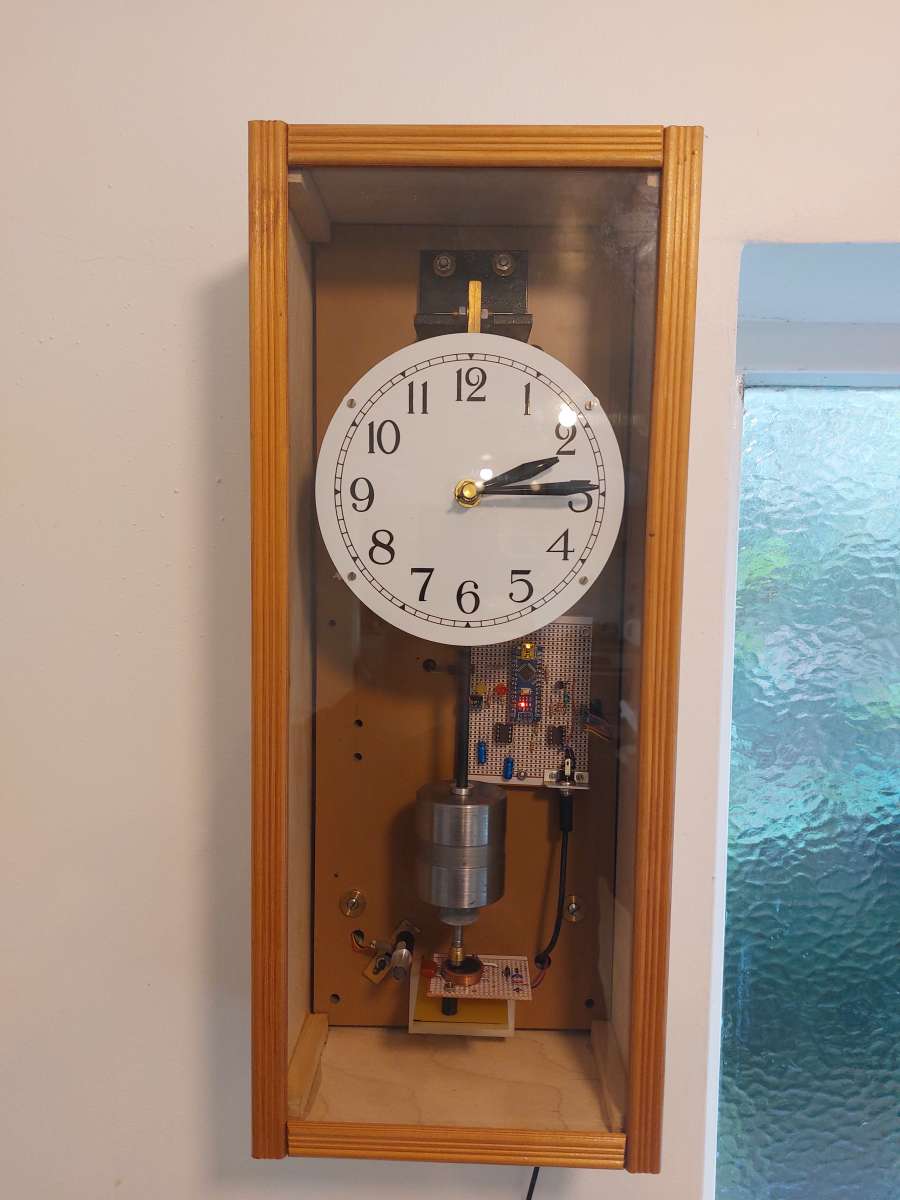

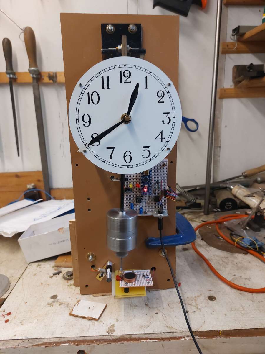

                          It all came together today, been running for 12 hours.
                          <p style=”text-align: left;”>20251021_131538</p>
                          #821098
                          Speedy Builder5
                            @speedybuilder5
                            Burning the midnight oil Duncan ?  But its great when a project comes together.

                              Duncan….can you tell us more about your project?

                                I just written it up for SMEE journal, if our noble knight of the blue pencil wants it I’ll send if to him after SMEE has had first bite. In brief, the black thing below the pendulum is a coil of many turns of fine wire, and there is a magnet on the end of the pendulum, so as it swings to and fro, a small voltage is induced. This voltage is amplified and sent to an Arduino, which puts a much higher pulse of current (although still only a few mA) through the coil, which repels the magnet and makes up for any losses to keep ir swinging. The silver thing off to the left is a Hall effect sensor, if that gets triggered by the magnet the next drive pulse is omitted, thus controlling the amplitude. The Arduino also outputs an alternating polarity signal which drives the motor from a quartz clock.
                                1. It has now been passed as fit for display in the house, so here’s a picture with the hood on,  just needs a big of white wire to make if less obvious20251024_141550

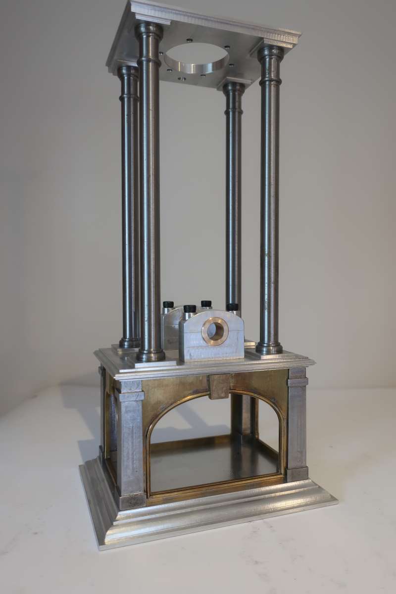

                                    Whilst waiting for a lump of something to turn up for the Vickers cylinder, I thought I’d make a start on the lower end with some pedestals – I’ll need to sit back and ‘consider these in context’ when more is done – I find it really hard to picture how an individual part is going to ‘work’ with other bits visually once it all done..
                                    Will these look okay if I fix the ‘lowers’ permanently to the base with a generous fillet round them..?
                                    I’ll update the Vickers thread once I make a decision..
                                    Vickers Pedestals
                                    IMG_2805
                                    #821741
                                      Fairly unusual to have bearing pedestals as an integral part of a “casting” like that. Back in the day it was easier to put the base in the planing machine and skim the raised pads flat. Then the separate bearing pedestals could be “fitted” as separate parts.
                                      So I would be more inclined to do without a fillet. You could mill a couple of mm off the bottom and as a slightly larger “foot” and then fillet the foot to the pedestal so they look like castings.
                                      #821759
                                      Diogenes
                                        @diogenes
                                        😁- yes, that makes sense and the ‘foot’ solution was one I’d considered, particularly as it’s an easy way out! Thank you!

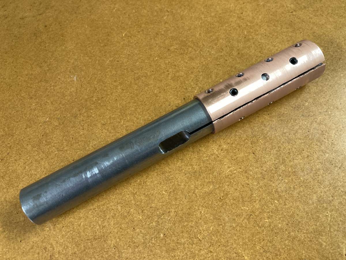

                                                Over the last few days I made a 1″ diameter Boyar-Schulze pattern internal lap. While it will come in handy for other jobs, the immediate need was to correct a bore that was very slightly oval, I think due to variability in the iron casting.
                                                Total shop time making lap: 9-1/2 hours.
                                                Lapping time to make hole a good fit: less than 30 seconds.

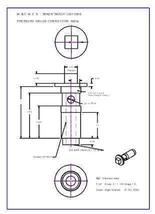

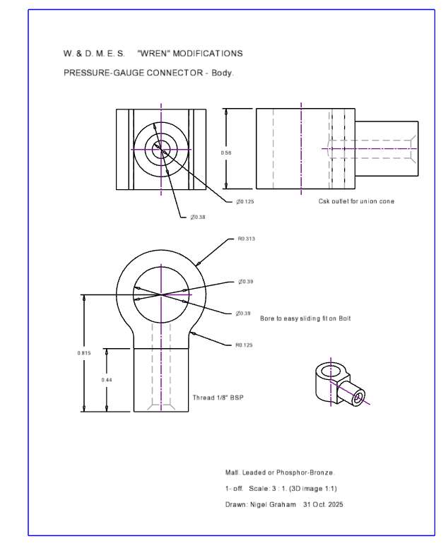

                                                      Felt a bit too cold and lazy to go in the workshop, but not too lazy to do a bit of designing!
                                                      Combined with finding how much Alibre Atom I can remember since last time…
                                                      It’s for the boiler connection for the pipe to the pressure-gauge on our club loco, a Ken Swan model of the Kerr-Stuart ‘Wren’. If you place the gauge where he did, replicating the full-size, you cannot easily see it when driving on a ground-level track as it’s up under the roof.
                                                      Someone had moved the gauge to a lower location but even that was back-cricking for some of our taller members, so I’ve found it a new home. One or two people had waffled about wanting girt big ‘oles cut in the cab roof, but having helped build the loco, I was not having that inflicted on it!
                                                      I had already made the bolt from a rough sketch, now need make the connector body, but I have drawn both parts  properly (ish) to add to the existing plan set. Yes I know real model-engineering drawings put oodles of other components on the sheet, all chain-dimensioned in sixty-fourths. Even combining both of these small items on one A4 sheet would be a bit crowded.
                                                      Nor do I pretend my technical-drawings would ever please the ISO-fans, but I had hoped I could create consistent centre-lines that span the elevations properly, and align those properly with each other. I am not worried about omitting screw-threads.
                                                      I created the bolt as a half-outline rotated about the axis, in drawing it, so the only added extrusion was the square.
                                                      I don’t know why I added the scale note about the 3D bit. It does not mean much, and it seems under-size on a test print.
                                                      The exercise kept me in the warm and out of mischief for some three or four hours. The hardest part was deriving the workshop drawings from the model. I’m glad there were no ladies present at times as my language was not always quite respectable engineering….
                                                      If the square looks small for the rest of it, that is deliberate, to limit the spanner size (hence applied torque).
                                                      Incidentally I was a bit surprised to find the pressure-gauge and vacuum gauge, both bought from the regular model-engineering retailers, have BSP connections. Presumably ‘our’ retailers simply buy them from industrial suppliers. I discovered too that the boiler has BSP bushes, hence my making all three joints the same.
