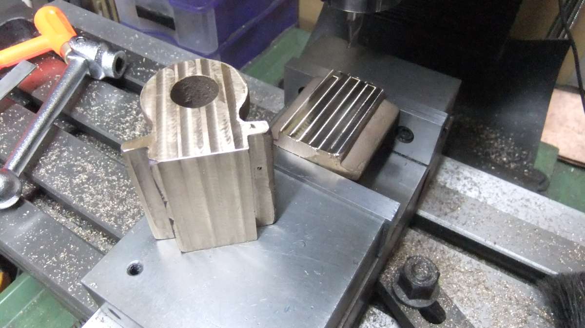

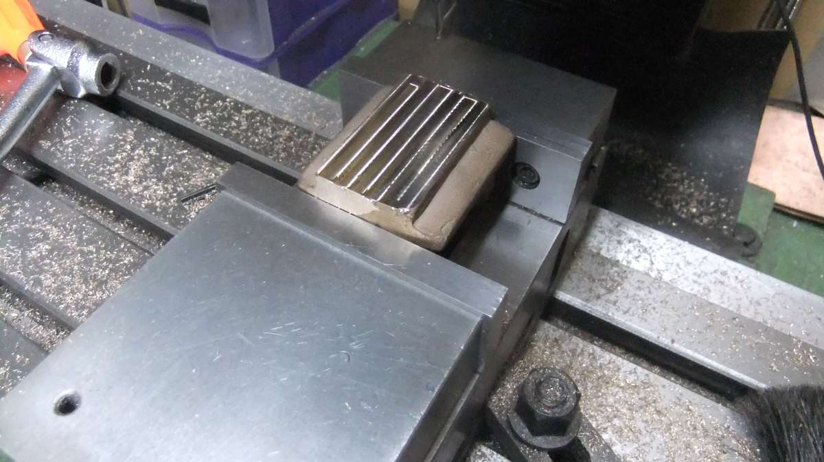

            Got back onto the cylinders of the Rob Roy as I stuffed up some measurements on the first set.
            Put in the mill vice and all I have achieved is to rough out some surfaces so that I have some reference flats to work from. They are still oversize at this stage but have got one squared up ready for some serious milling. I have used a small bit and light cuts as I am holding them on rough castings to start with, which you can see by the one in the vice.
            At least I will have some nice clean surfaces to work from and get a decent grip on so I can use a fly cutter for a better finish

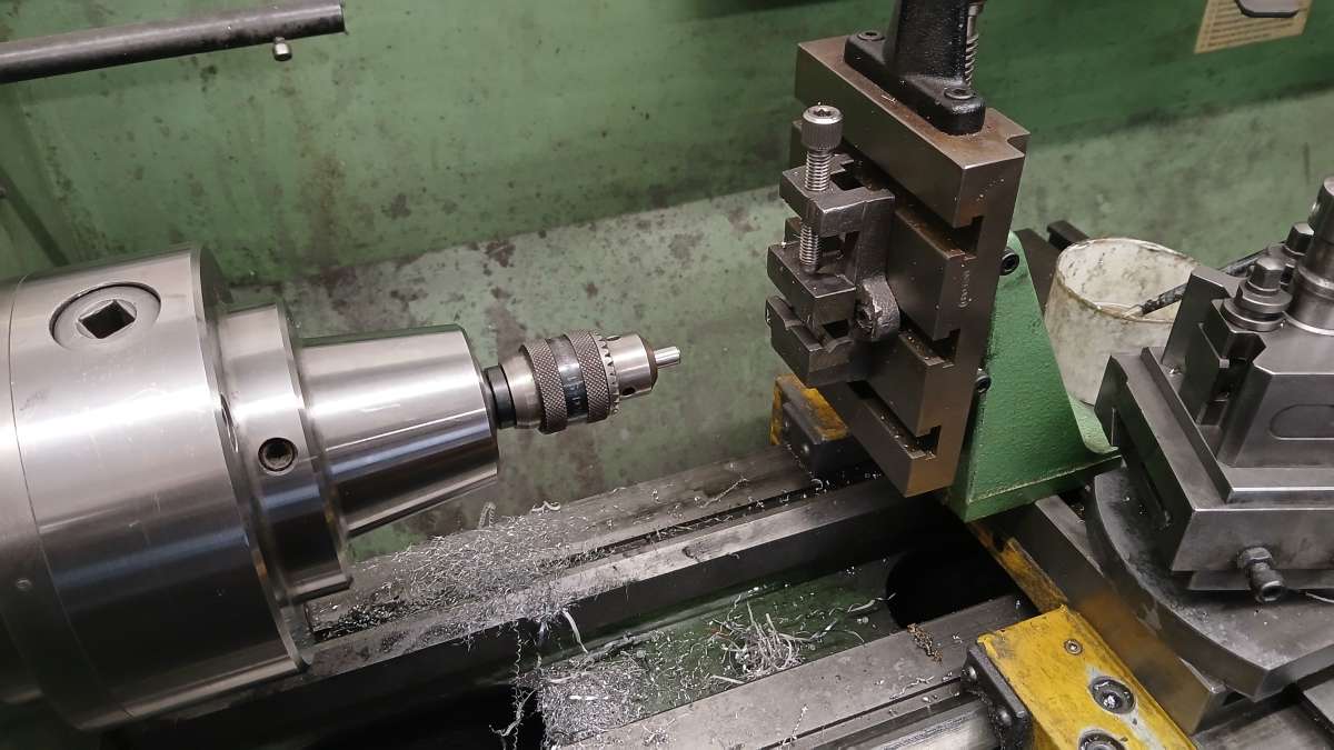

                          I went old shcool today and broke out the vertical slide just to illustrate that a mill is not needed for my V-Twin build. The small rear bearing block was all done on the vertical slide and seems to have gone together OK and a nice fit on some silversteel.

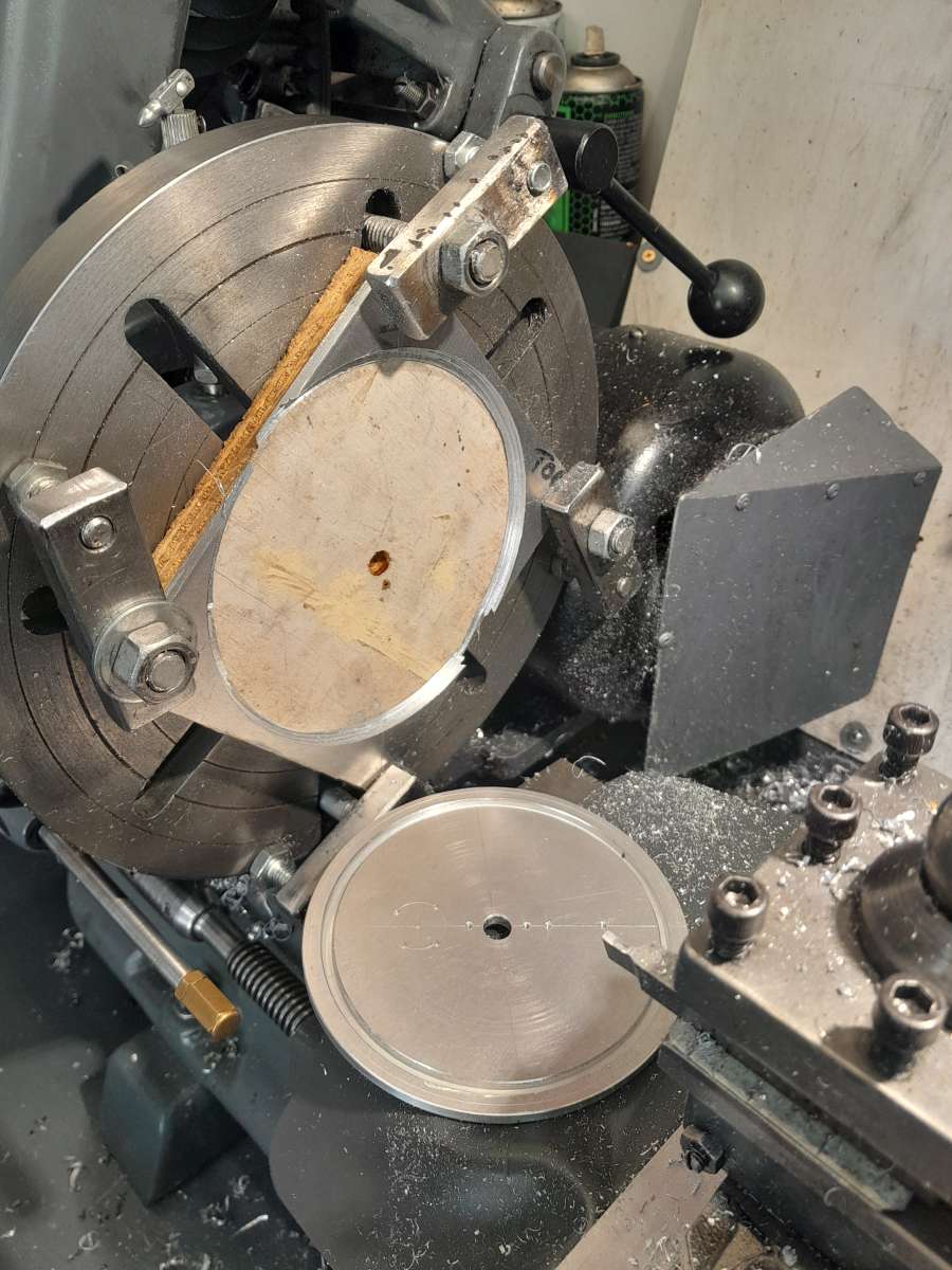

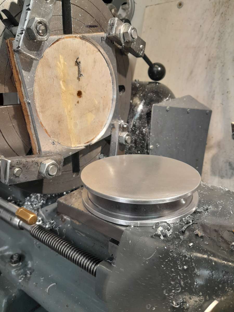

                              A bit of fun today trepanning two 100mm diameter aluminium discs to make a Jan Ridders coffee cup Stirling engine. It’s like parting off, but on a curve, so can be a bit nerve-racking, even in aluminium which can be a bit “sticky ” . WD40 to the rescue, once again. Plus moving the tool to one side to create a bit of extra clearance ad things progress.
                              All a lot of fun on a lathe (ML7) as ancient as I am.

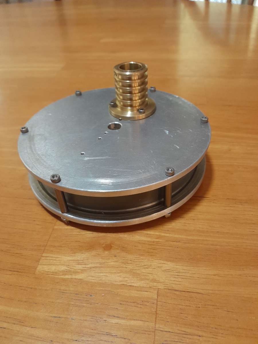

                                1. 20251110_123512
                                A bit more progress on the coffee cup Stirling engine. A piece of brass bar-end from the scrap box turned into the power cylinder with fins and all. Drilled, bored and reamed to 13mm ready for a graphite piston.
                                I hate tapping those little 2mm threads with my heavy machinery fitter’s hands. Always nerve racking. So I modified Jan Ridders’ design so the 6 stainless spacers are drilled 2.5mm right through with one long screw and a nut through each, instead of tapped 2mm both ends to hold two short screws each. Came up looking okay I think.

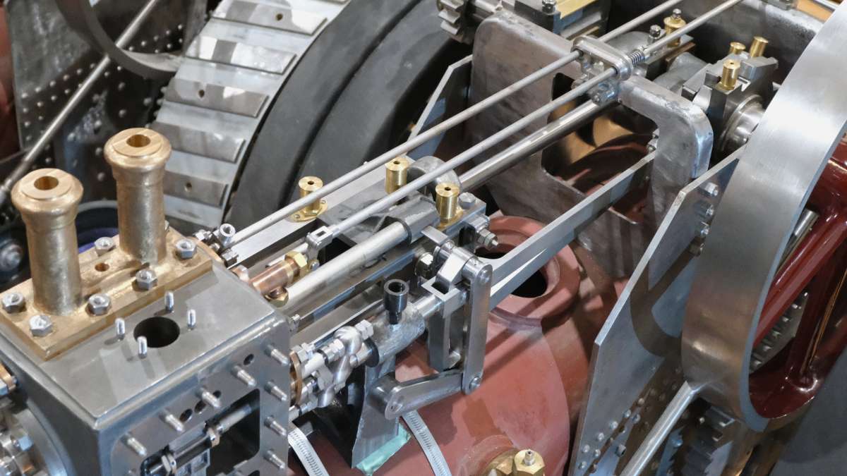

                                      Finally got the valve gear (to my own design) assembled on one of my engines:
                                      Valve Gear 1
                                      Initial tests indicate that all works as intended and that in the forward direction the steam lead varies from around 2 thou at 80% cutoff to 25 thou at 20% cutoff, as designed. Steam lead is also symmetric at each end of the slide valve stroke. So it seems that the equation given by Ashton to slightly lengthen the eccentric rods for equality of steam lead works. The extra length needed on my 12″ long eccentric rods was 3.9 thou.
