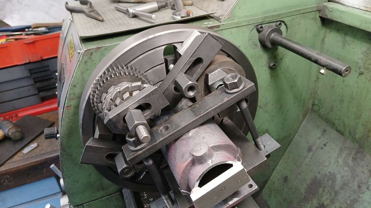

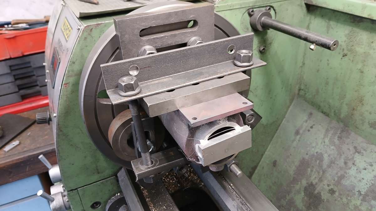

                                                  A bit of faceplate work made a pleasant change from the usual chucks and collets.
                                                  Boring out the far end of the Robinson HA waterjacket ready for the liner. 48mm dia x 100mm deep into the casting.
                                                  This is the neat view

                                                  And the not so neat one where I have added some clamps and a selection of carefully calculated balance weights!
                                                  20251004_141204
                                                  I decided not to push my luck and only took it upto 120rpm.

                                                    An impressive set-up, Jason!
