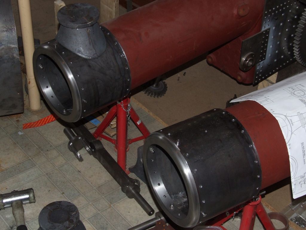

        I started by finish boring the second smokebox to fit the boiler:
        And the smokeboxes in situ; they're a light tap fit on the boilers so no bolts are needed to keep them as shown:

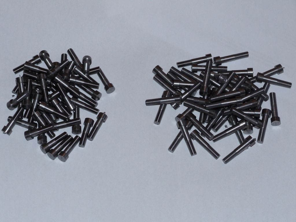

        Rather than use proper rivets to fix the smokebox to the boiler and to the front ring I am going to use threaded bolts with a rounded head. So I knocked out a number of these, at different lengths as required:

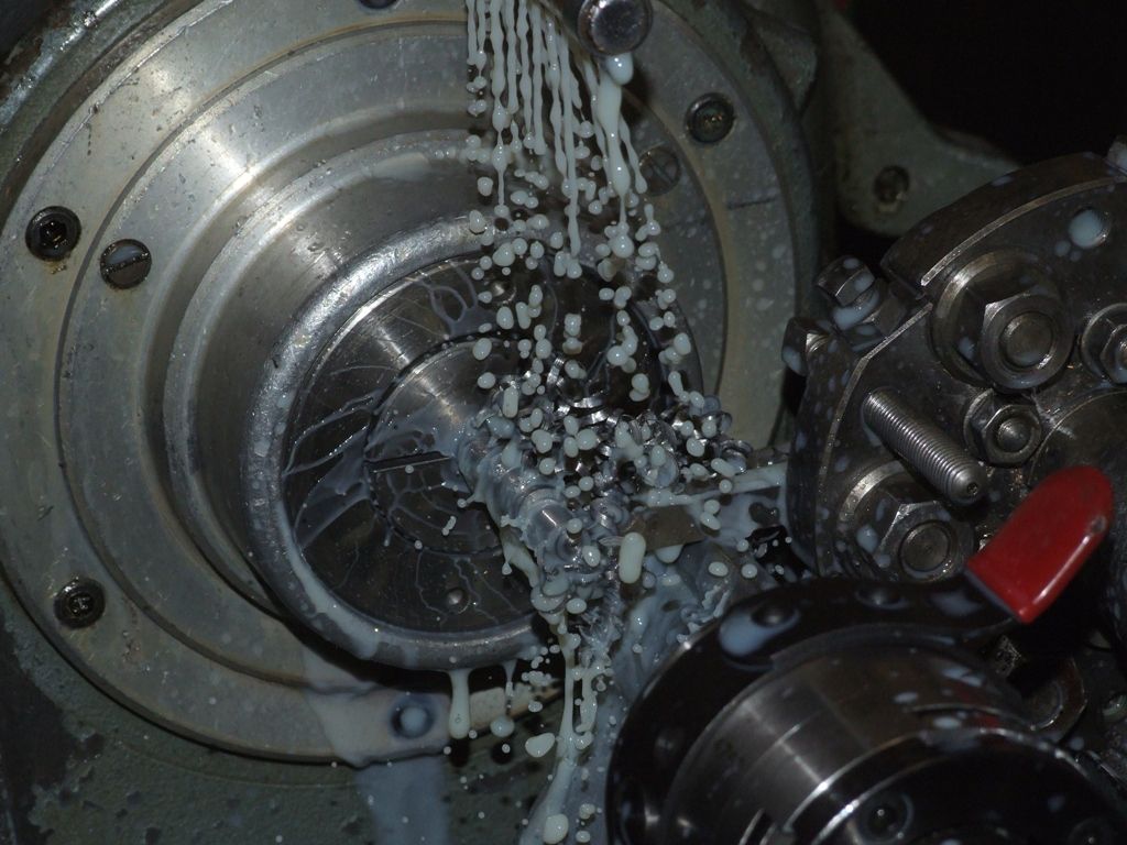

        Once I am sure I have enough of each length I'll make a form tool and set the Britan up for facing the head to length and rounding it to mimic a rivet. Here's one of them being reduced from 3/8" to 1/4" prior to threading:

          Its getting out of hand when you have to use axle stands for model engineering projects wink. That said it looks like you have a nice set of twins when its all finished.
            Possibly, but I'm not sure I'd trust them with a real car. I have had a glider trailer on them, one in each corner. But the trailer was empty at the time.
            Now that the smokeboxes are in place the engines are beginning to look big. And that's without the tender on the back. I may have to order a larger kitchen.

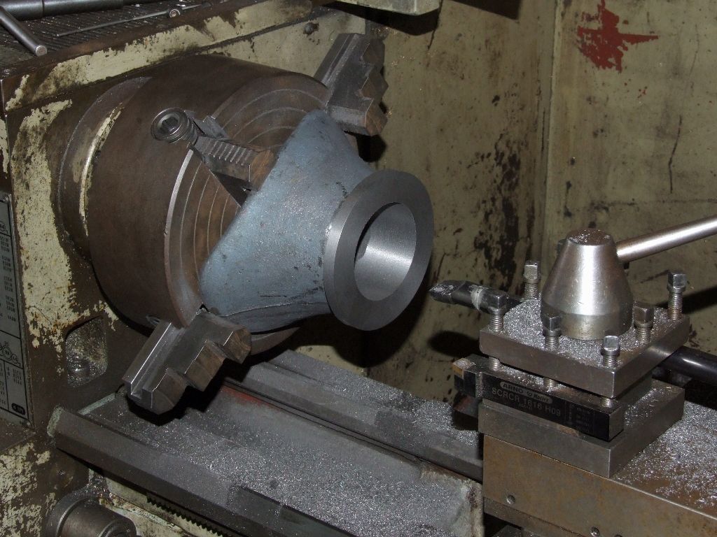

                      Now for some more examples of using a less than pristine lathe. smile

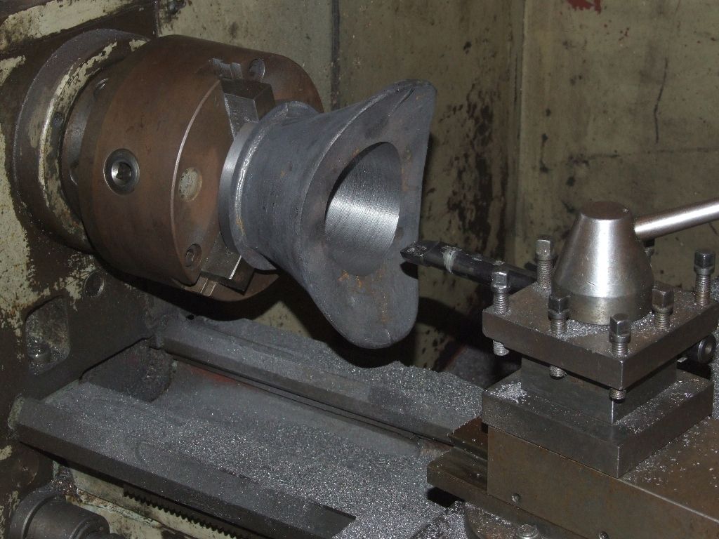

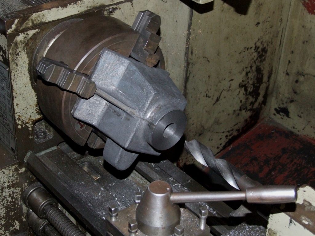

                      This morning is best not mentioned. This afternoon I've been machining the chimney base castings for my traction engines. First the flange was faced, turned to diameter and bored to size:
                      In view of the limited clamping I kept cuts to a maximum of 30 thou DOC and a feed of 6 thou per rev. Spindle speed was 260rpm for about 290fpm on the outer diameter. The other end of the bore was tapered in a rare outing for the 3-jaw SC chuck. Must be the first time in probably 6 months:

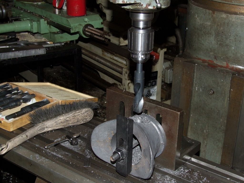

                      The holes for the exhaust pipe and blower were then drilled. This was all done by eye; there are no details on the drawings. The holes aren't even shown, let alone dimensioned. I consulted some pictures of full size SCC Burrells before deciding what to do:

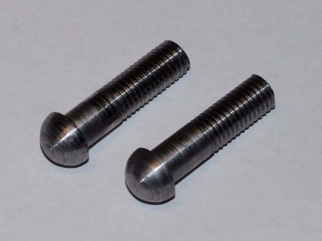

                      Finally I've hand ground a form tool and set the Britan up to make the rounded head on the "rivet" bolts previously machined:
                      I'll mull them over for a while before doing the whole batch. Not least because I'm otherwise occupied tomorrow as afternoon tug pilot.

                                    Andrew – just out of interest, when you come to use these, how will the bolt be held whilst you tighten the nut?

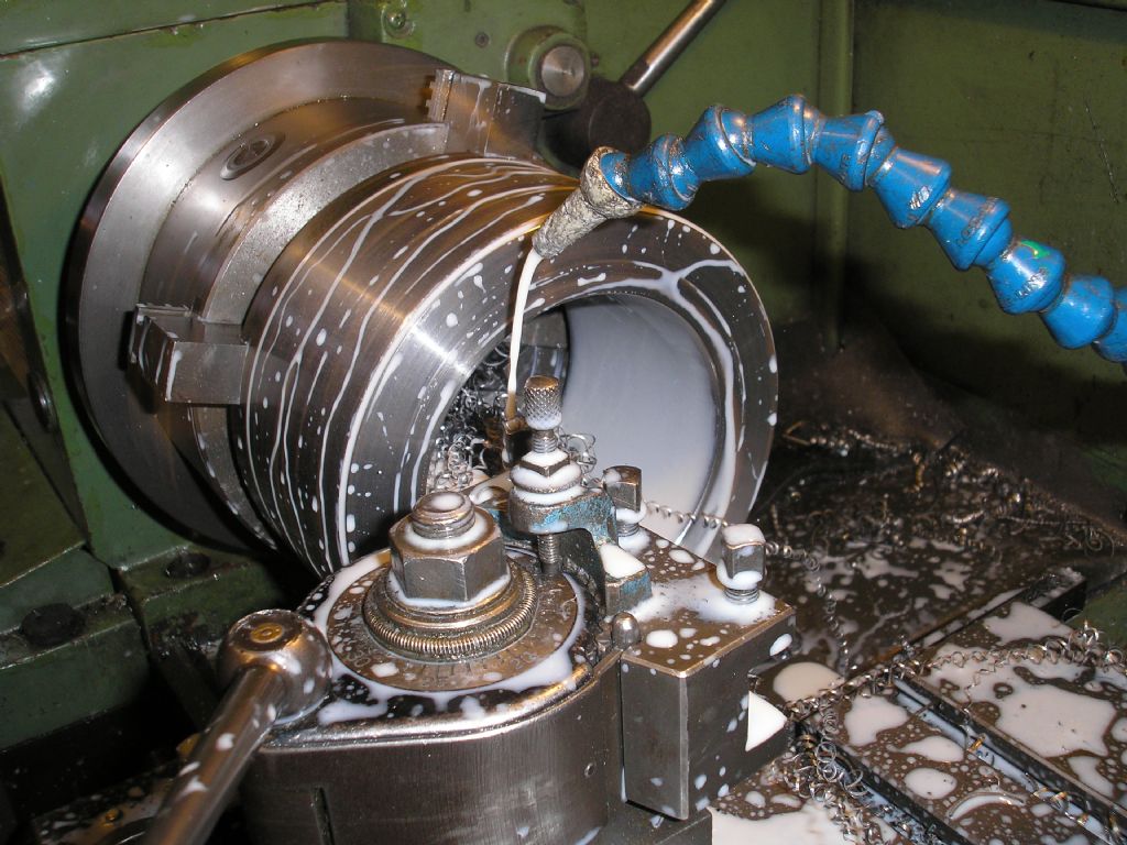

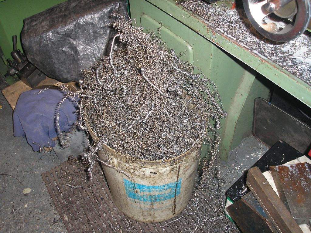

                                      Finally got back in the workshop to start on the cylinder will finish bore for the liner tonight then the part I enjoy profiling the outside and creating the exhaust ports.
                                      I think that is easy compared to when I see George another speed nut machining various car heads from castings on manual machines with the blueprint on the wall.
                                      Will change my nickname to Swarthy again after today looking at my bucket.

                                            For the ones I've fitted so far it hasn't been a problem. The bolts are quite tight in the holes, they often need tapping in with a mallet. If one nips up the nut it is often possible tighten a bit further with an "impulse" on the spanner. The bolts don't need to be particularly tight. There are 20 of them around the circumference and the loads are entirely in shear.

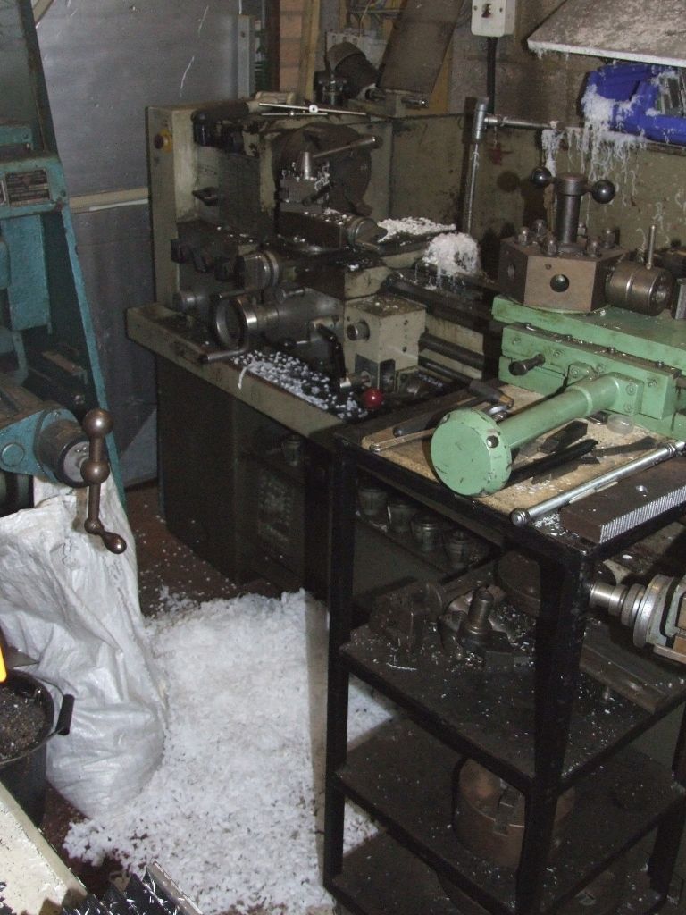

                                                    It's raining outside, but it's been snowing in the workshop this afternoon:
