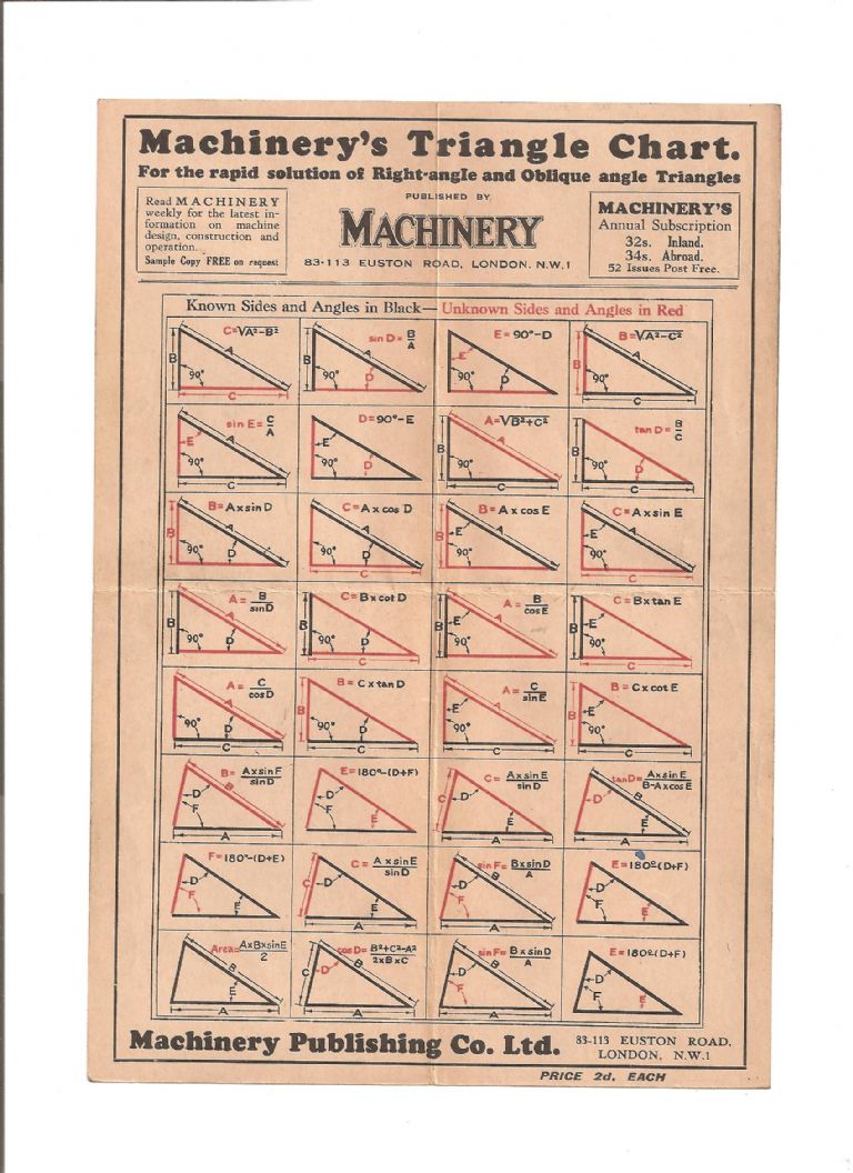

      Hi all
      I found this phamplet whilst looking throught my wife's grandads books and found it very usefull maybe it will be usefull to some of you out there
      Steve
      #30544
      Steve Butler 1
        @stevebutler1
        Machinery’s Triangle Chart

        Ralph H
          @ralphh
          Printed out a copy, I think that may be very useful.
          Thank you
          Ralph

            Roy M
              @roym
              I hope you all realise that this chart only works if you use logarithms!

                        norm norton
                          @normnorton75434
                          Who remembers being taught SOHCAHTOA at school?
                          It gives you all the formulae for the right angle triangles in that chart.
                          Sine of angle=Opposite/Hypotenuse; Cosine of angle=Adjacent/Hypotenuse; Tan of angle=Opposite/Adjacent.

                          mechman48
                            @mechman48
                            Posted by norm norton on 20/11/2015 11:00:40:
                            Norm
                            Now that brings back memories… logs, anti logs, … trigonometry, geometry, but, even being in the engineering business all my life, I honestly don't recall having to use, or the need for… quadratic equations, a right pain in the a**e that was
